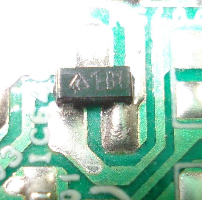

    Good pics, thanks. Can you read the part # on the tiny IC4901?

      Re: 40" Sony LCD KDL-40EX500 Seconds to black (6 blinks)
      I can't seem to find IC4901, did you mean IC6401 (If I'm guessing you tried to read it backwards? lol)
      I can't see it myself but luckily I finallly fixed my original camera and i think it can pick it up. I think it says EB1?

        #63
        Got a perfect photo of the label! =D
        What does that triangle symbol mean?
          #64
          Yeah that's the one. No schematics in the manual. Can't find anything for that device. But it definitely looks like a TL431...
            What exactly does it do?
              #66
              Voltage reference - regulates the outputs.

                #67
                So I have to replace it with a TL431?
                I've been looking around for an EB1 datasheet. Does this look like the one?
                  #68
                  Give it has three pins connected, but that device has only two, it seems unlikely.

                    #69
                    The right pin measures 2.49V steady as it cycles through the problem.
                    The left pin measures 10.84V steady only when the lights come on, when it goes off it goes unsteady between 10.20V to 10.77 V
                      #70
                      2.49V is good actually -- that's the reference voltage. On this picture https://www.badcaps.net/forum/attach...1&d=1359769688, is there 12.9V at the jumper near R6411?
