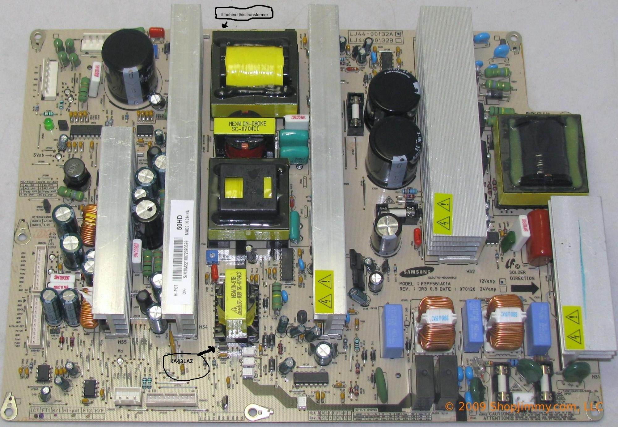

                  Re: vizio vp50
                  Originally posted by tom66
                  OK, anything at all with 431?
                  Looks like this:
                  U451...KA431AZ...H42 closest i got the rest is different numbers and some others look close but has flat backsides instead of half moon shape "er round backsides"....sorry bout that
                    #29
                    Re: vizio vp50
                    KA431 is good. Near the Va section? Between pins 1 and 3 you should measure approx 2.5V if it is working.

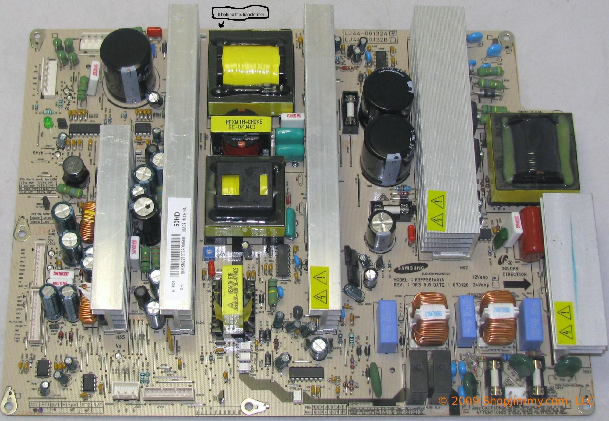

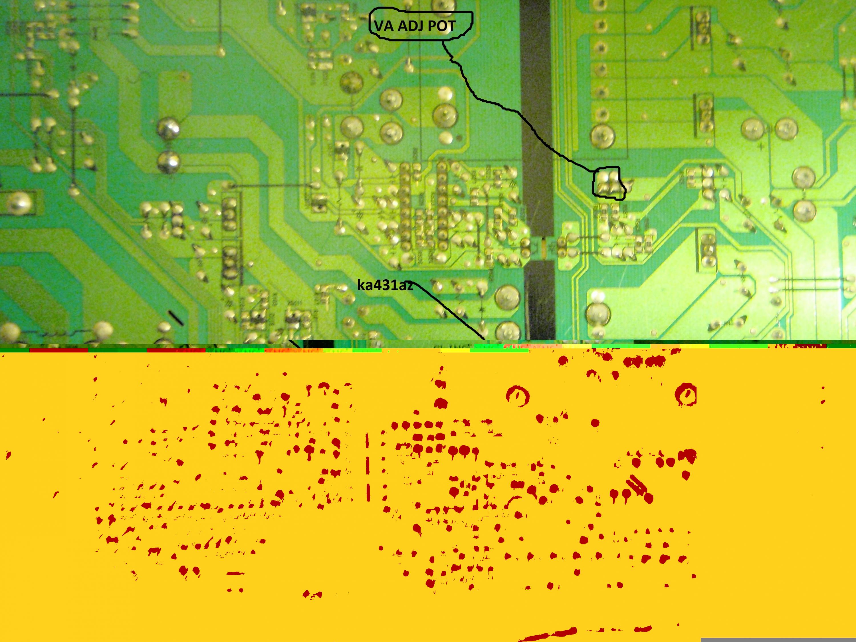

                      here where it located can't see in image but behind the transformer.....
                        #31
                        Re: vizio vp50
                        That is most likely for Vs, especially if Vs adjustment is near there.
                        See attachment.

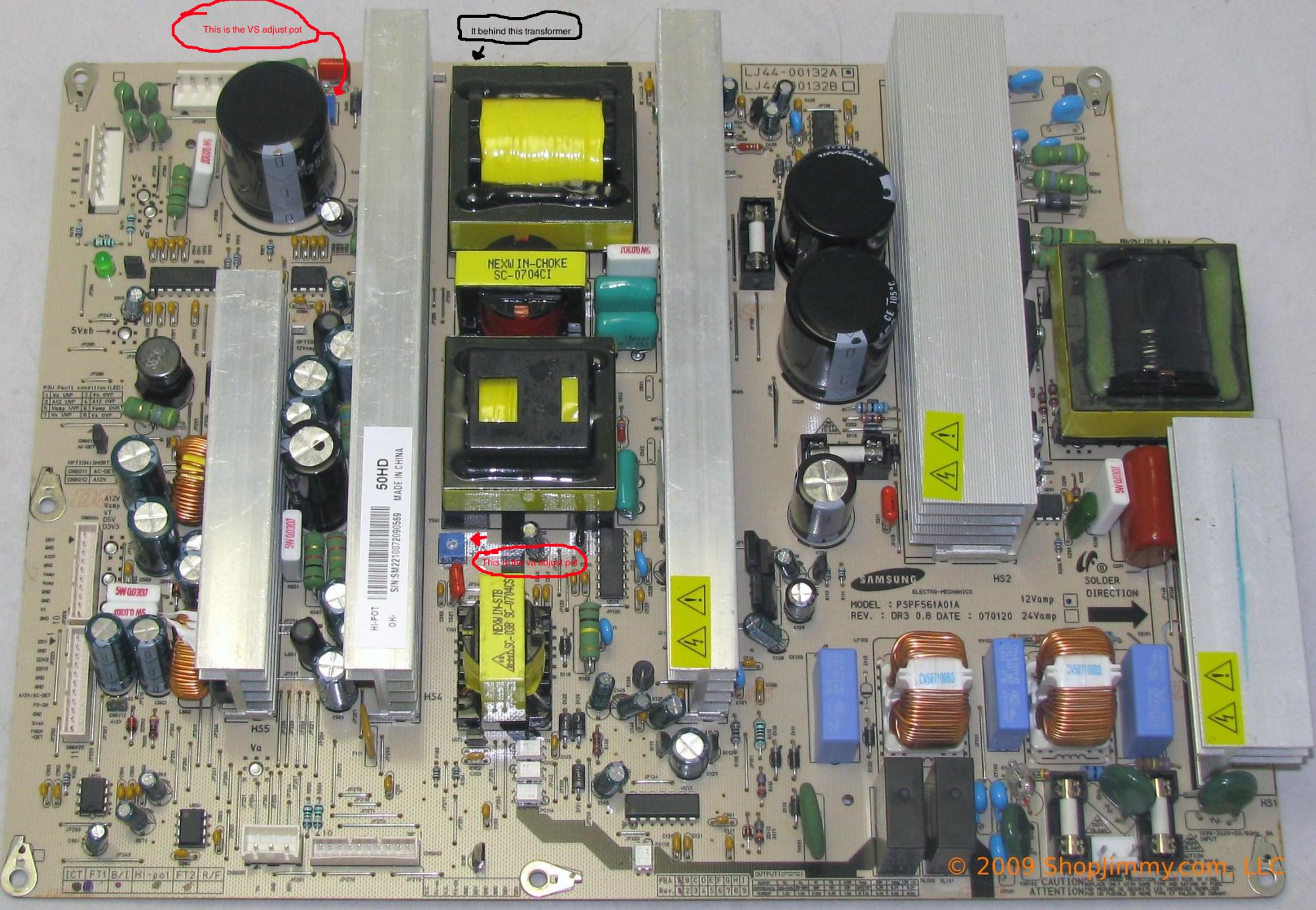

                          #32
                          Re: vizio vp50
                          Its VA pot, the VS is almost at top on left side of board
                            #33
                            Re: vizio vp50
                            We need to be looking for KA431 near Va pot.
                            Vs is good as far as you have measured.

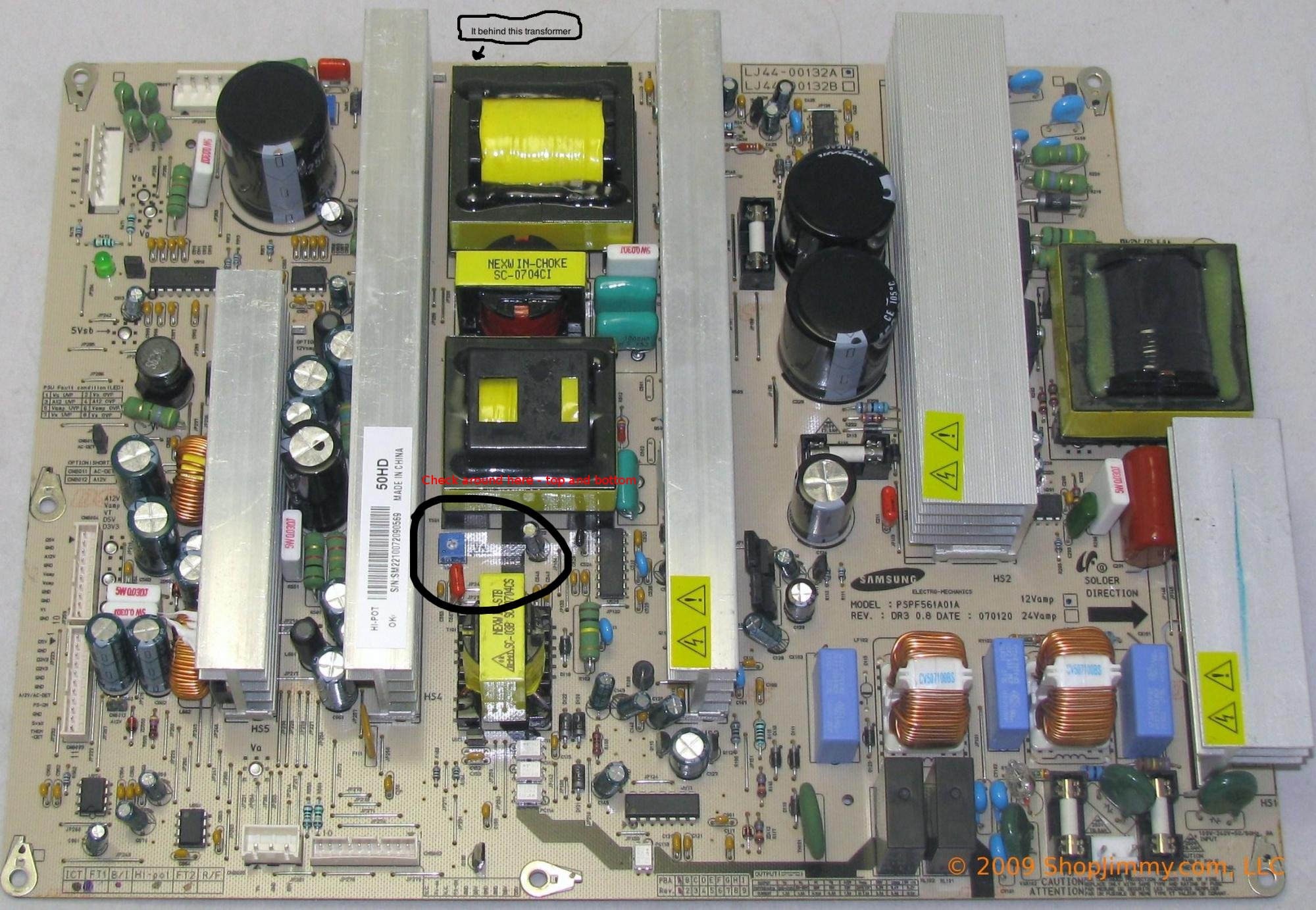

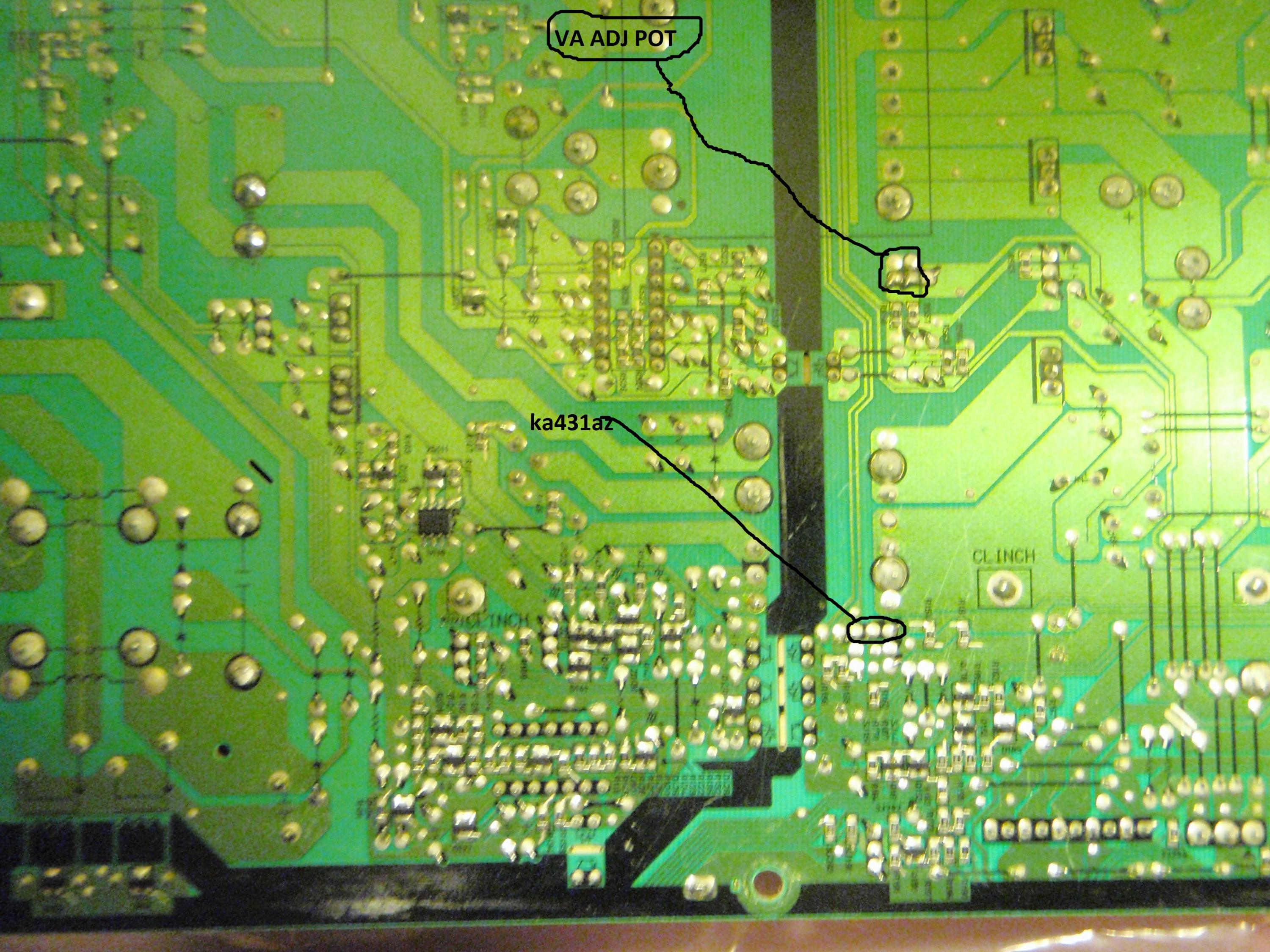

                              #34
                              Re: vizio vp50
                              okay i found another one same exact part number and it near va pot will measure stay tuned
                                #35
                                Re: vizio vp50
                                That may be for the main/standby supply.

                                  #36
                                  Re: vizio vp50
                                  okay the one behind transformer at top by VS pot measures 8.7 volts
                                  the one by the VA pot measures 1.3 volts....think we are getting somewhere..
                                    #37
                                    Re: vizio vp50

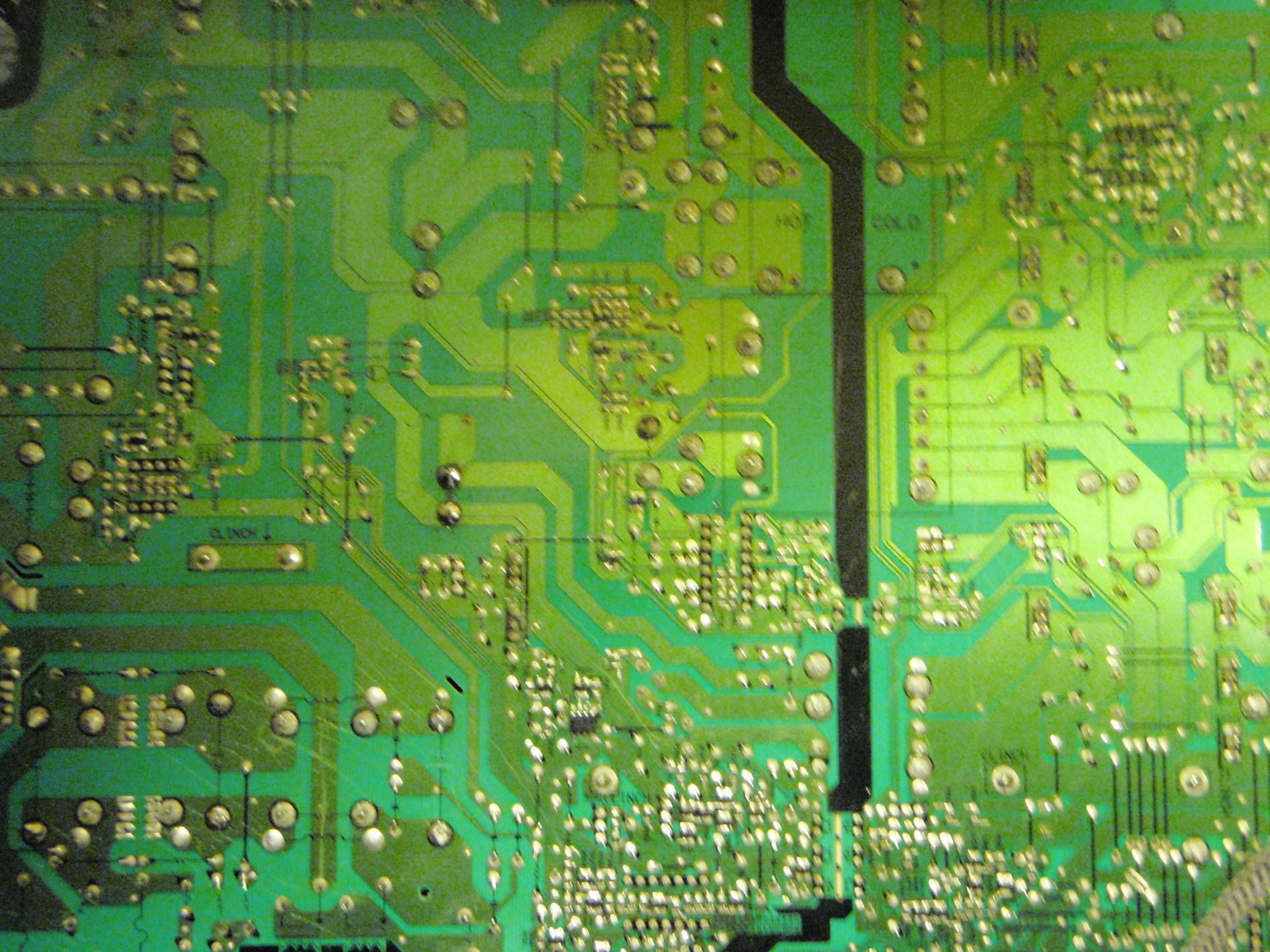

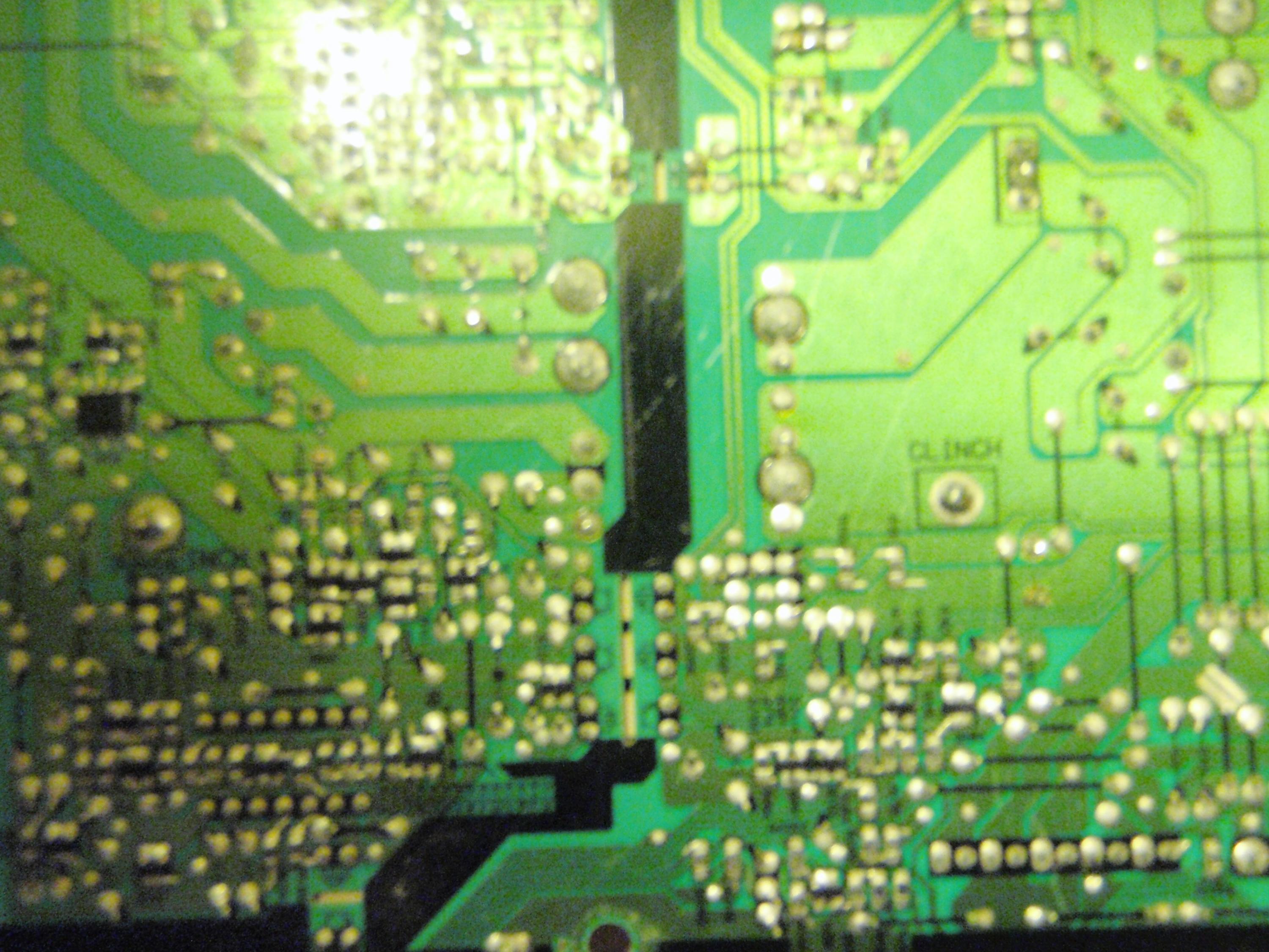

                                    Bottom of board pic necessary to determine if it is for Va or not.
                                    • heavymachines
                                      • Mar 2011
                                      • 1028
                                      #38
                                      Re: vizio vp50
                                      Here it is
                                      • heavymachines
                                        • Mar 2011
                                        • 1028

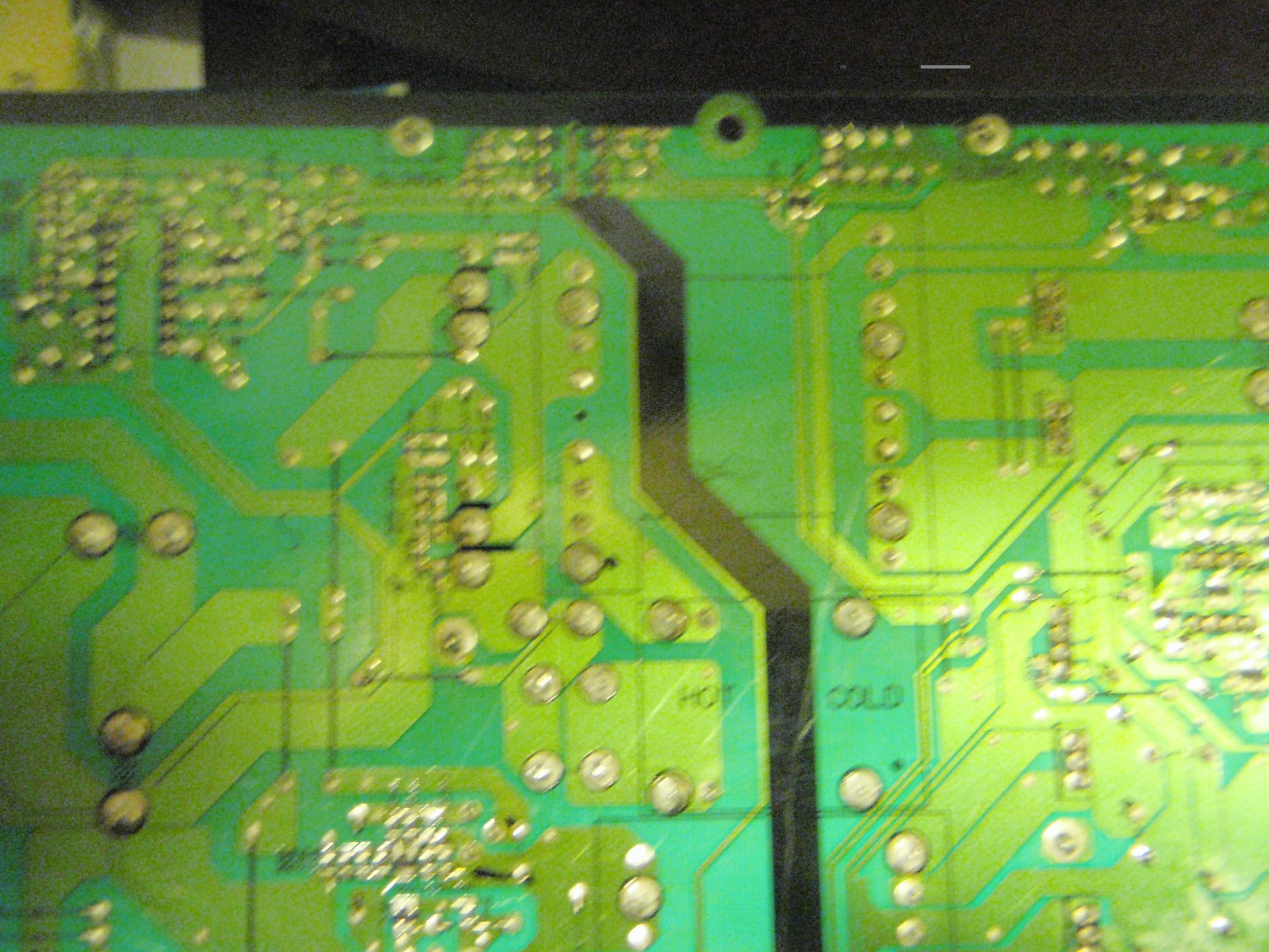

                                        #39
                                        Re: vizio vp50
                                        my bad here is more
                                        • heavymachines
                                          • Mar 2011
                                          • 1028
                                          #40
                                          Re: vizio vp50
                                          more
