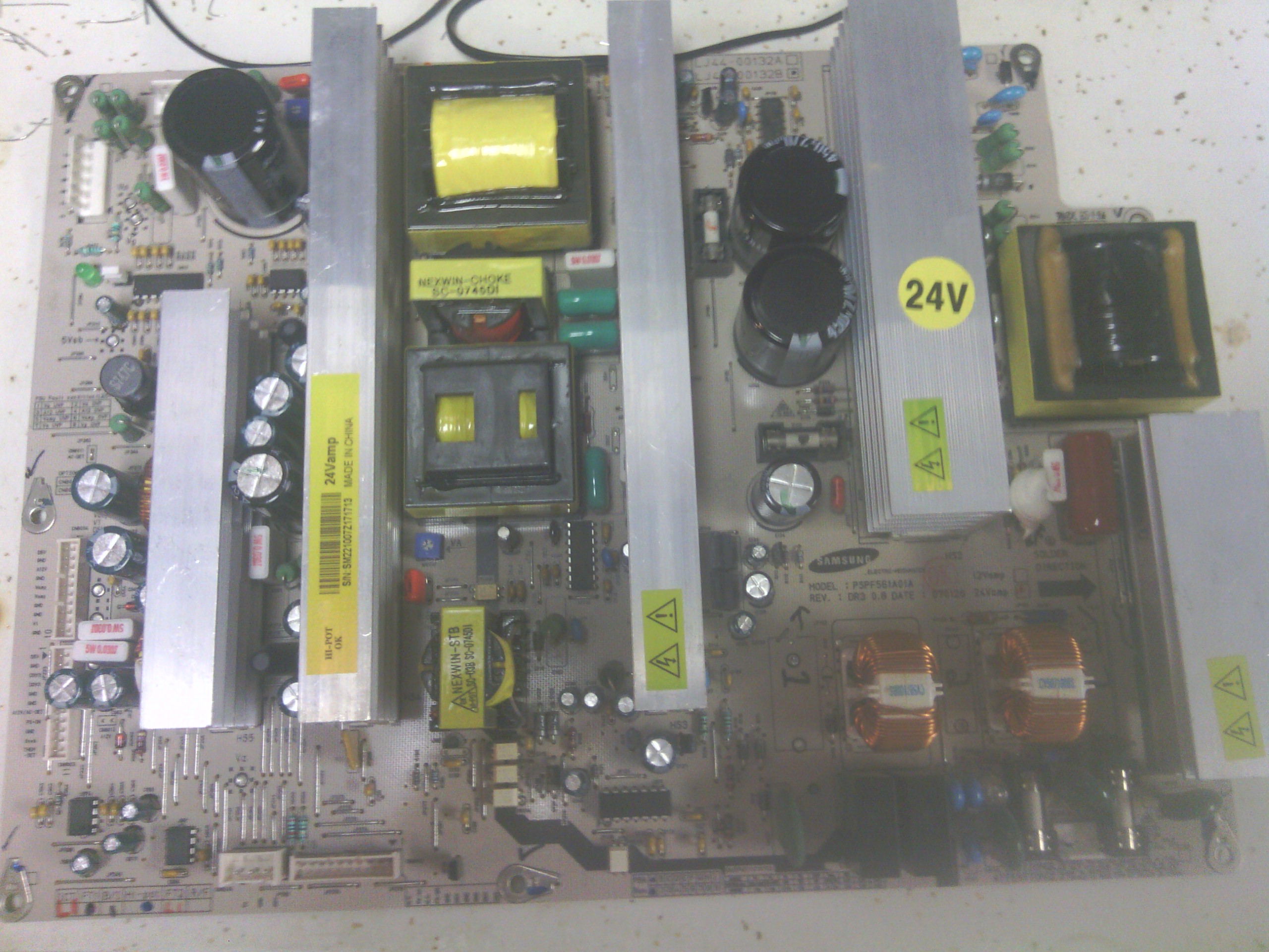

                      • heavymachines
                        • Mar 2011
                        • 1028
                        Re: vizio vp50

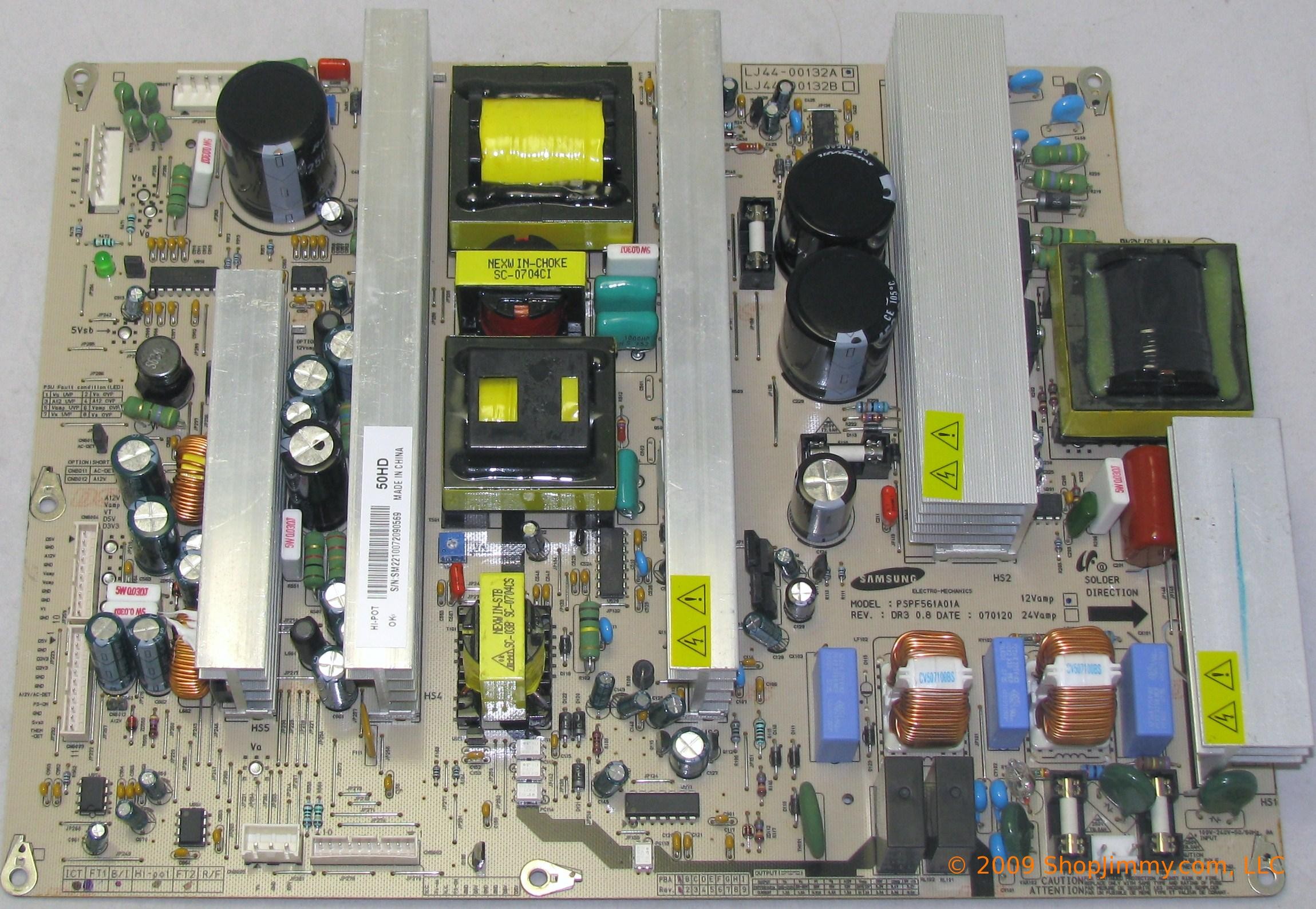

                        Here is it note where i marked 1,2,3 where the blue box capacitor is missing had a 42" vizio not work due to one of them being bad replaced one box and a regulator fixed the problem but this one is not burnt and esr shows 3.0 on the 2 470n k 275v and on the 220n k 275v shows 7.0 on esr i think it high but no sheet to know for sure ...on the 42 inch i worked on it was obvious because it was burnt....

                            better image of same board...

                                    Re: vizio vp50
                                    and i apologize for the pics it all i got don't have access to a real camera....
