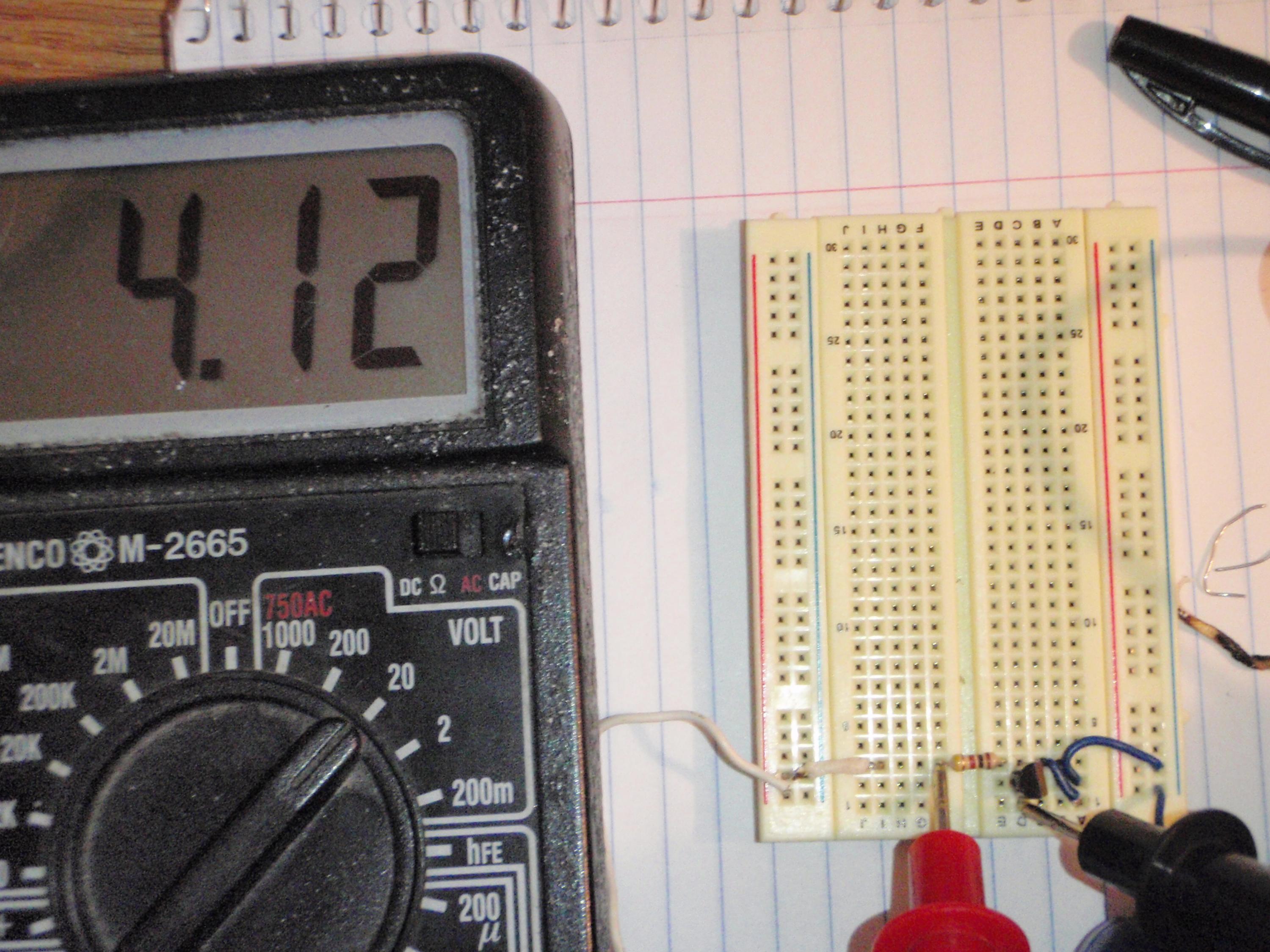

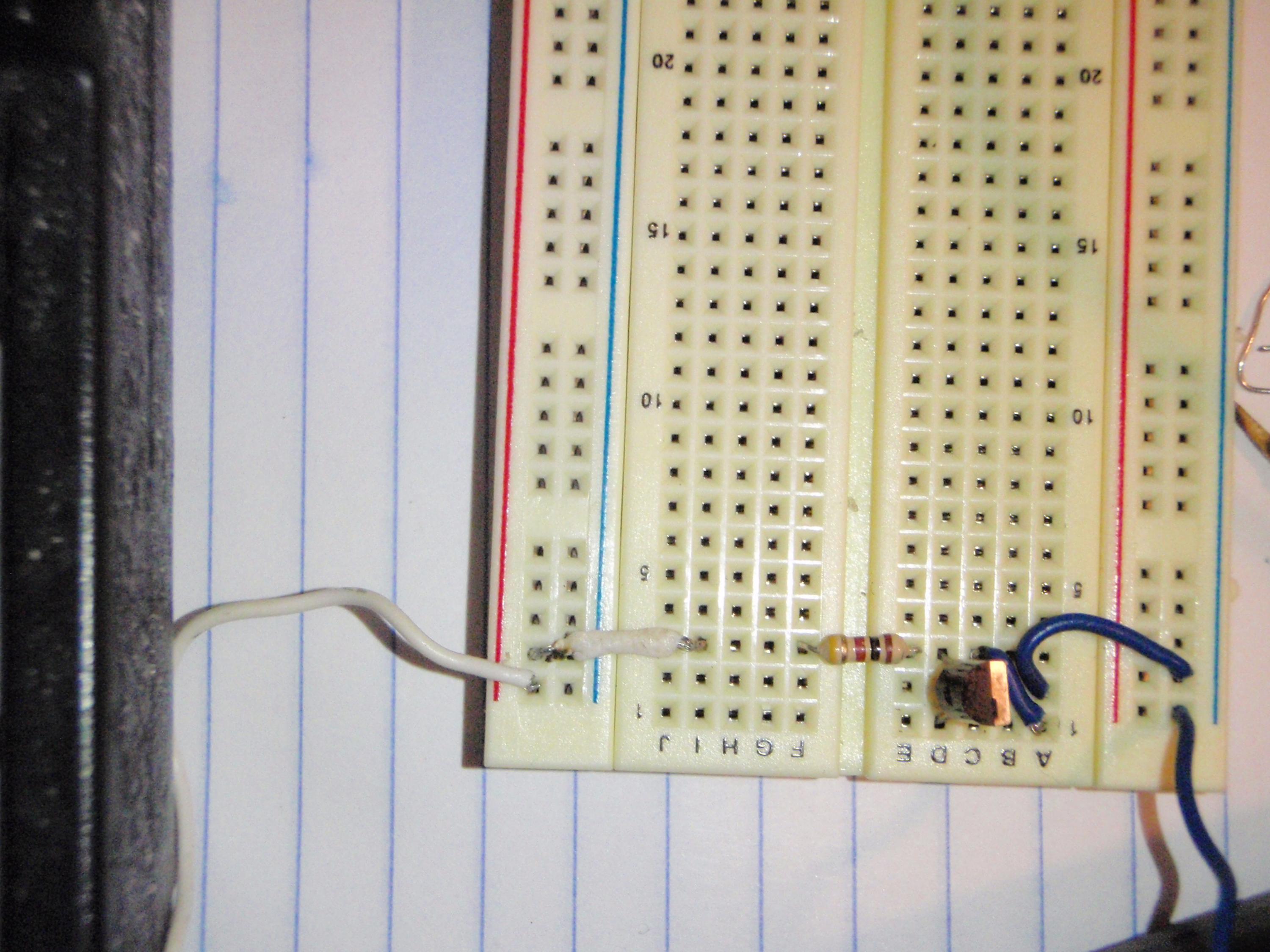

            Re: vizio vp50
            here is a pic doing the test so you can observe
              #86
              Re: vizio vp50
              Ah I realise I may be in error here. Just realised...
              Try moving the ref connection from 1-2 to 1-3.

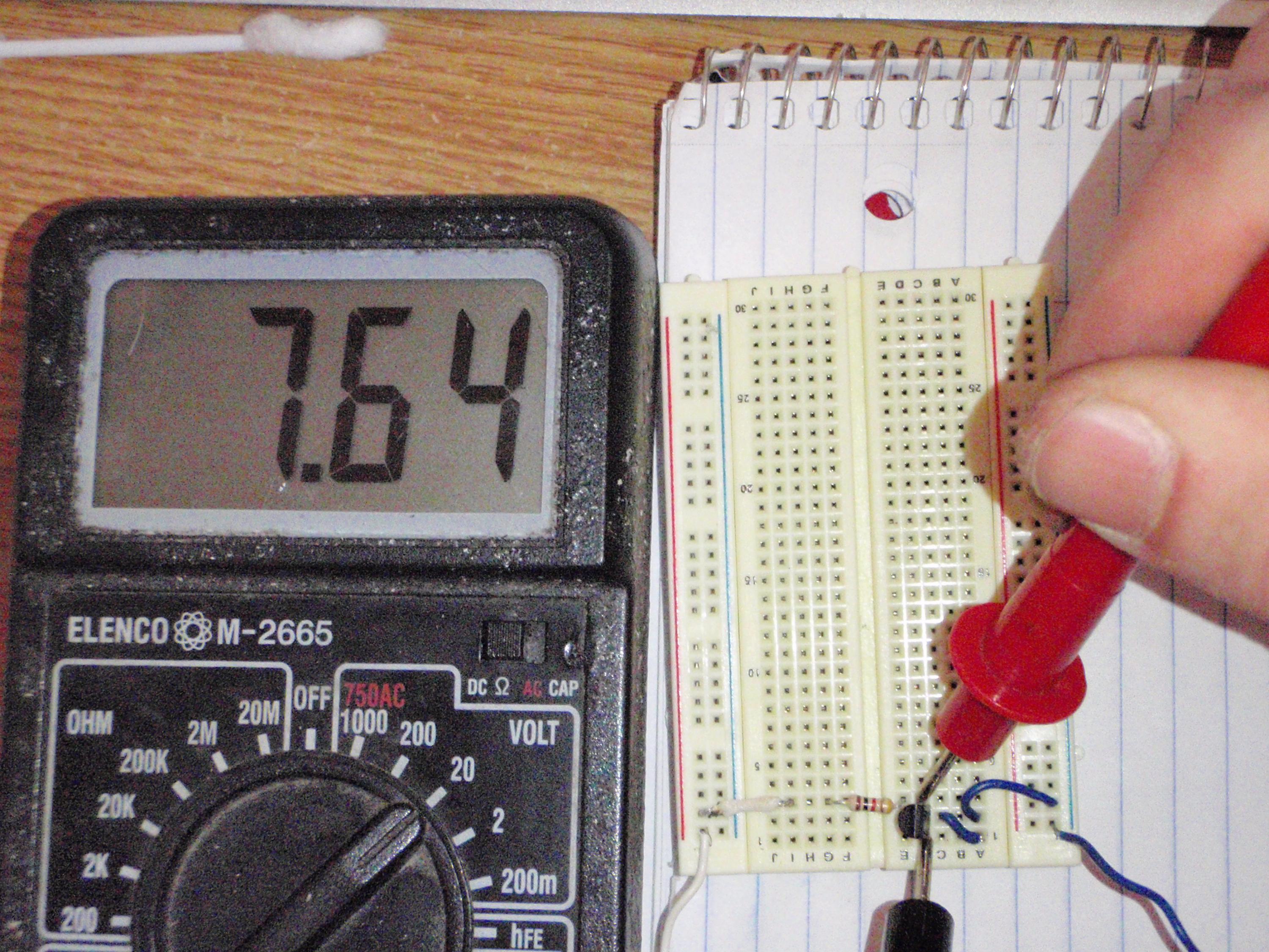

                    Originally posted by tom66
                    Remove the 1-2 jumper and move it to 1-3.
                    okay with all three tl431 i get
                    pin 1-3 0.00volts
                    negative probe to pin 1 and positive probe to resistor i get 4.97 volts with 7.64 battery input voltage...
                      #90
                      Re: vizio vp50
                      You want to do positive probe to resistor, negative probe to ground/battery negative.

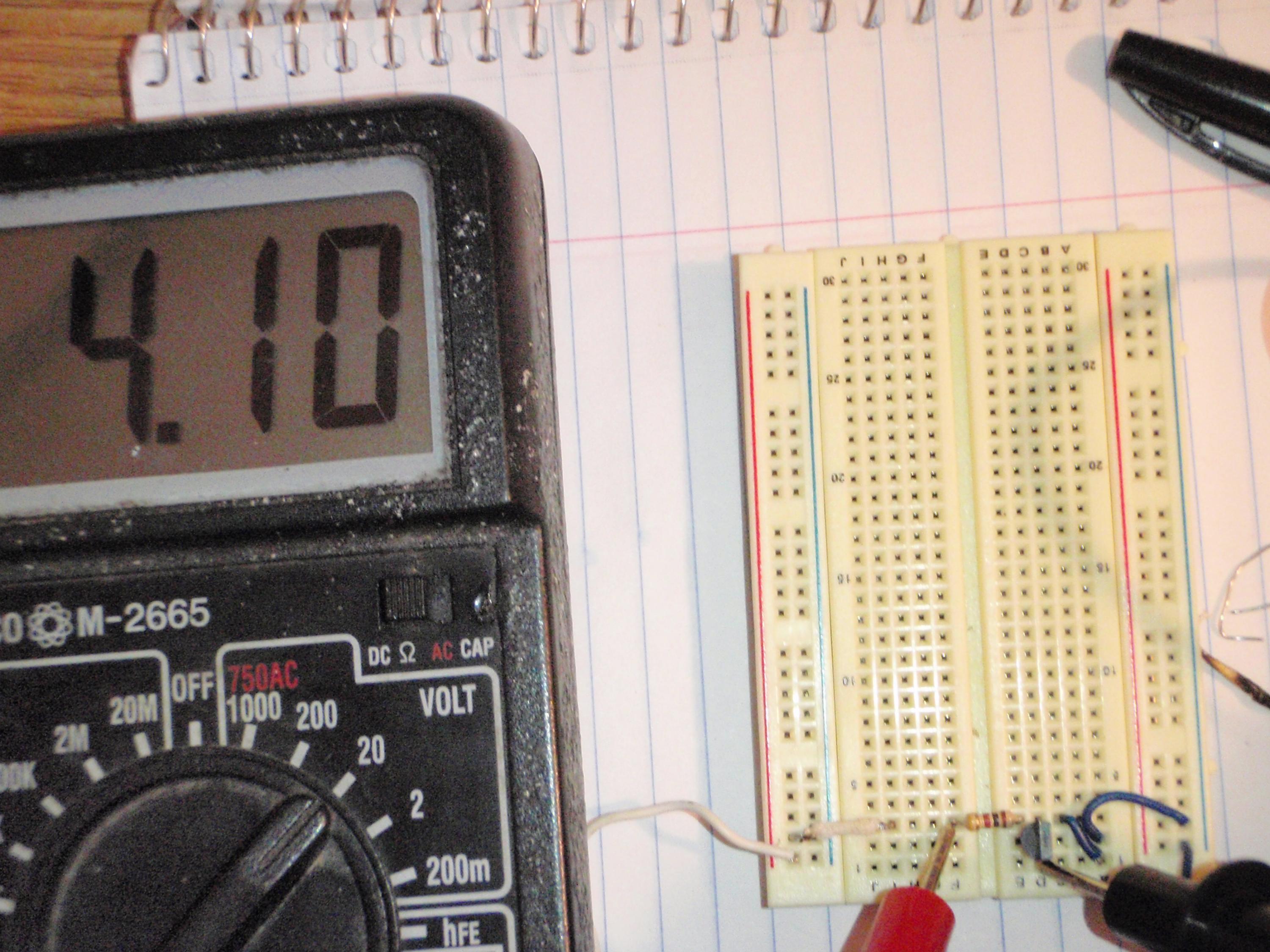

                                okay found resister brown-black-brown-gold-yellow measures 100ohms on dmm and voltage results are 6.74v input and 4.21v measurement at neg probe pin 1 and positive at resistor end
                                  #96
                                  Re: vizio vp50
                                  Either it's wired up wrong or the device isn't working, can you compare to the other devices, also what is the part # on it?

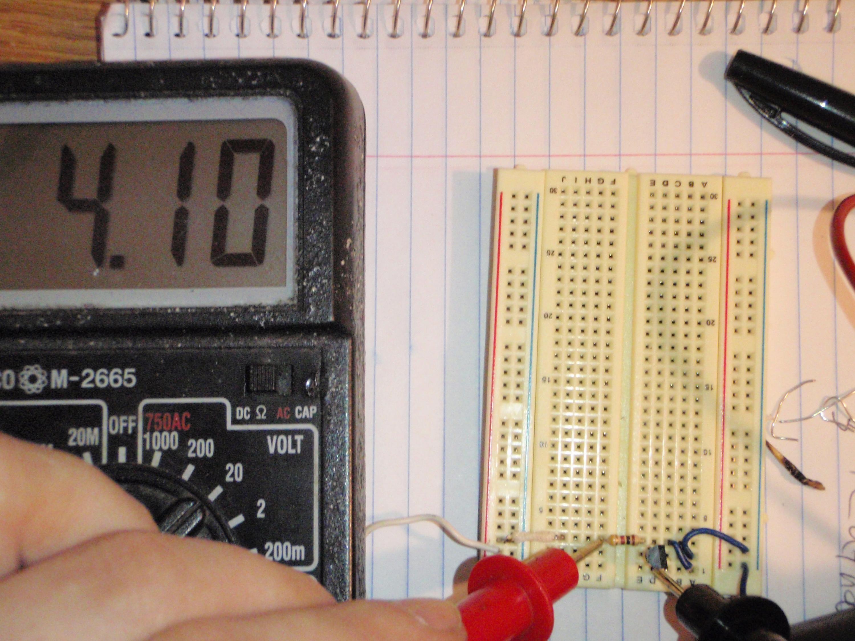

                                    ic #1
                                    utc
                                    TL431
                                    RMF
                                    ic#2
                                    KA
                                    431AZ
                                    ic#3
                                    HA
                                    431
                                    405c
                                    all shunt style
                                    all get same now around 4.10 volts
                                      #98
                                      Re: vizio vp50
                                      I'm suspicious of your meter battery. Can you make sure it's OK?

                                        #99
                                        Re: vizio vp50
                                        sure thing will go next door and get new one just for good measure brb
                                        • heavymachines
                                          • Mar 2011
                                          • 1028
                                          #100
                                          Re: vizio vp50
                                          okay got 2 new batteries measure 9.3 volts each now that same voltage is input for bread board now reads 6.65 volts
