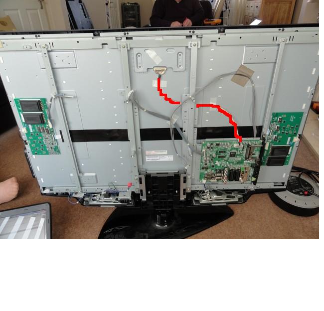

    Hi all, first time posting here hopefully you can help..
    I have a 42" LG TV around 3 - 4 years now and is now randomly turning on to black and slowly fading up to white with sound still working, no tv options show up when you press any buttons.
    It's an odd one as I could go down now and turn it on and it'll work all day and then turn off and back on and then black to white and again off and on and works.. been like this a few days now.

    I would take a look at the "LVDS cable". This runs internally from the main board (with the video inputs on it) to the T-con board, which is at the top of the LCD panel on most models. I have seen this when LVDS is loose. If it's not that, I'd consider the T-con itself.

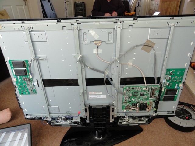

      I have a picture here not taken myself it's from another user on the board.
      Is the cable your talking about from the main board to the t-con board, is that the board that is connected to the screen itself??
        Re: LG 42LG3000 (White Screen with Sound)
        Its the red one

          Thanks to both of you, I will look into this now and take out the wire and reseat and if it's still the same I'll look into replacing the t-con.
