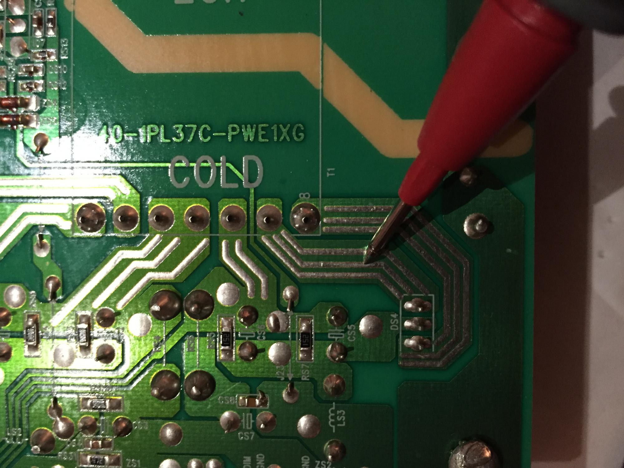

                                Also I've been meaning to ask, what are all these solder lines over traces underneath power supplies? Are they a type of shielding? Thanks to anyone in advance!
                                  #36
                                  Re: Looking for couple tips please
                                  They are bare copper traces covered with solder so the trace can handle more current.
