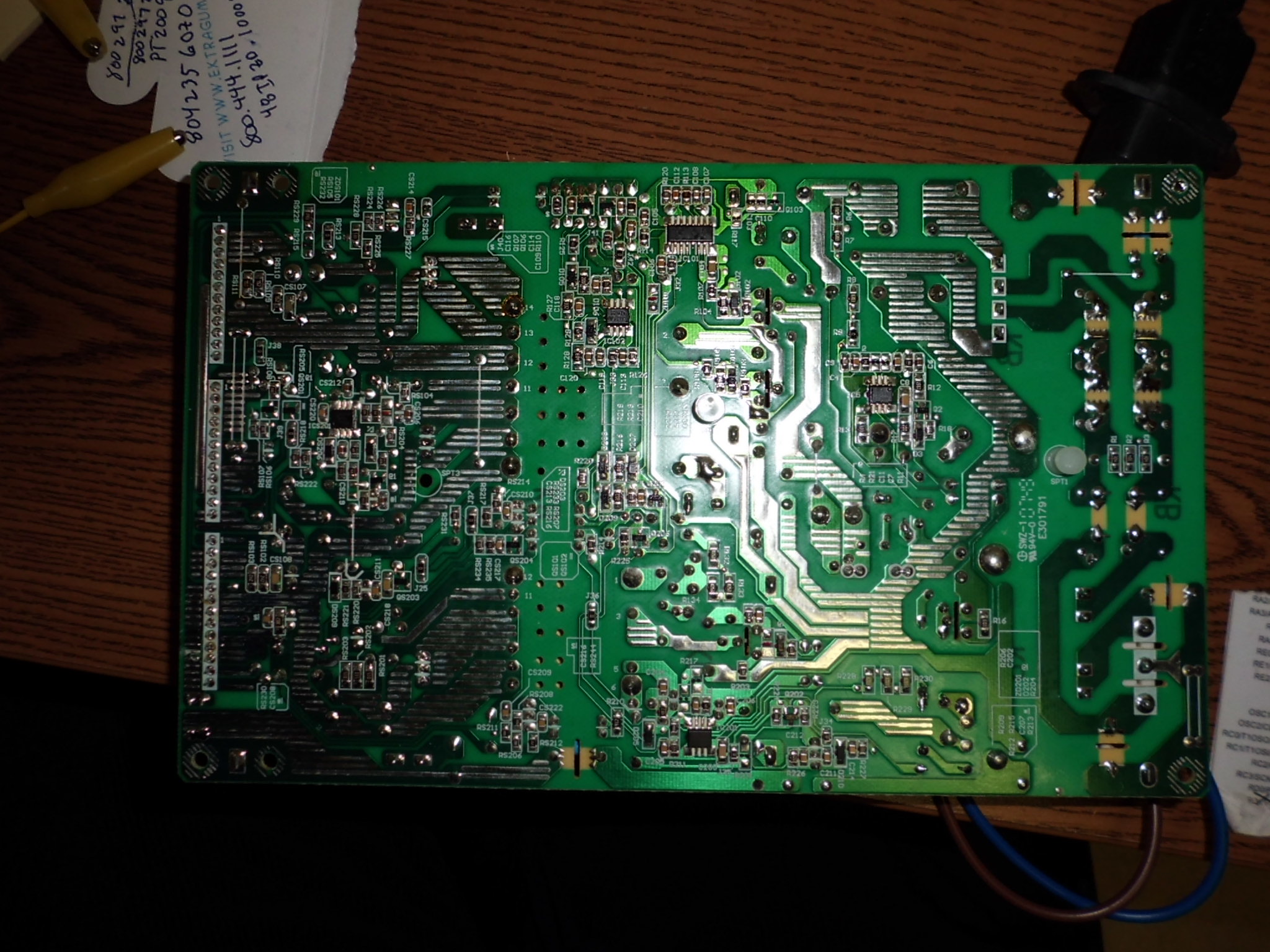

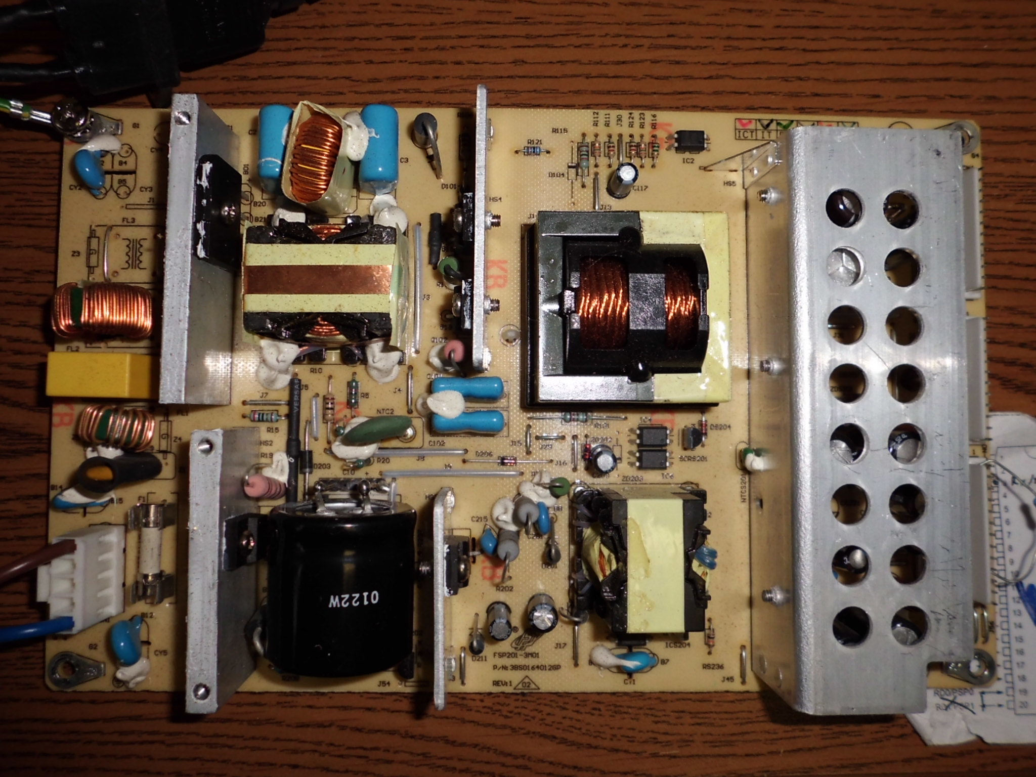

    Working on a Visio VW37L-HDTV20A that responds to PWR button in that VISIO symbol goes from orange to white, but no picture/sound. Exposed boards and did the following:
    1. Checked for obvious visible damage
    2. Checked fuses on PS, T-con and main board
    3. Verified 5V line = 5.13V steady
    4. Verified large filter cap has 163 VDC
    5. Disconnected PS and tied ON/OFF to 5V STBY using a 1K ohm resistor.
    6. +12V and +24V do not turn up (0.0 VDC).
    Suggestions on where to start? The power supply is model FSP201-3M01. Did a quick search on this forum and did not come up with any links.

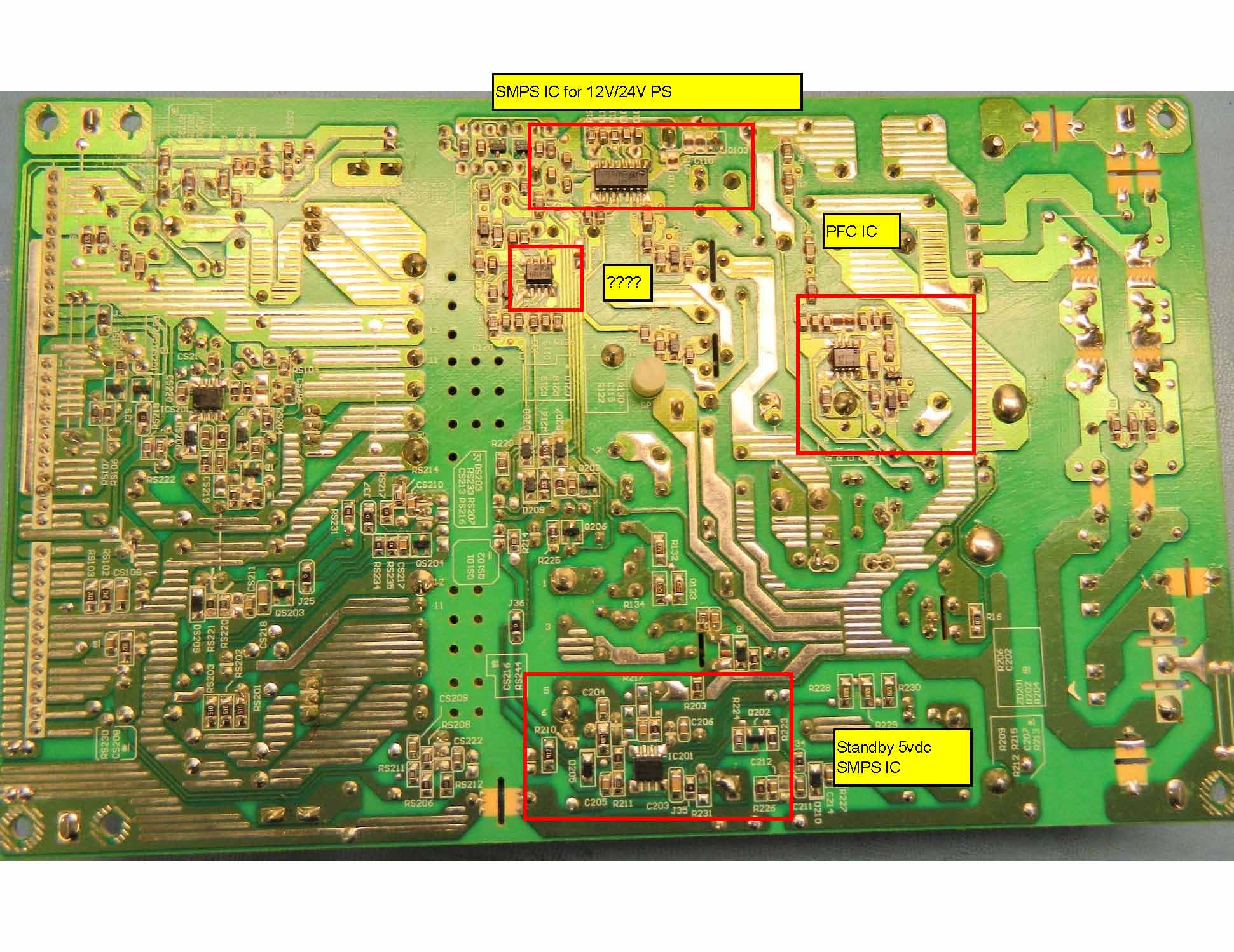

              Re: Visio VW37L-HDTV20A - no 12/24V on PS
              Then we will need the P/N of the PFC Controller IC and the SMPS IC, and the one with ??? to get the pinout so we can check and see if it has any voltages on them. This power supply is also used in the VX37.
              See if the picture matches your board.
              This is not going to be easy repair since I do not have the board in front of me to see.
              • ahickman
                • Jan 2012
                • 233

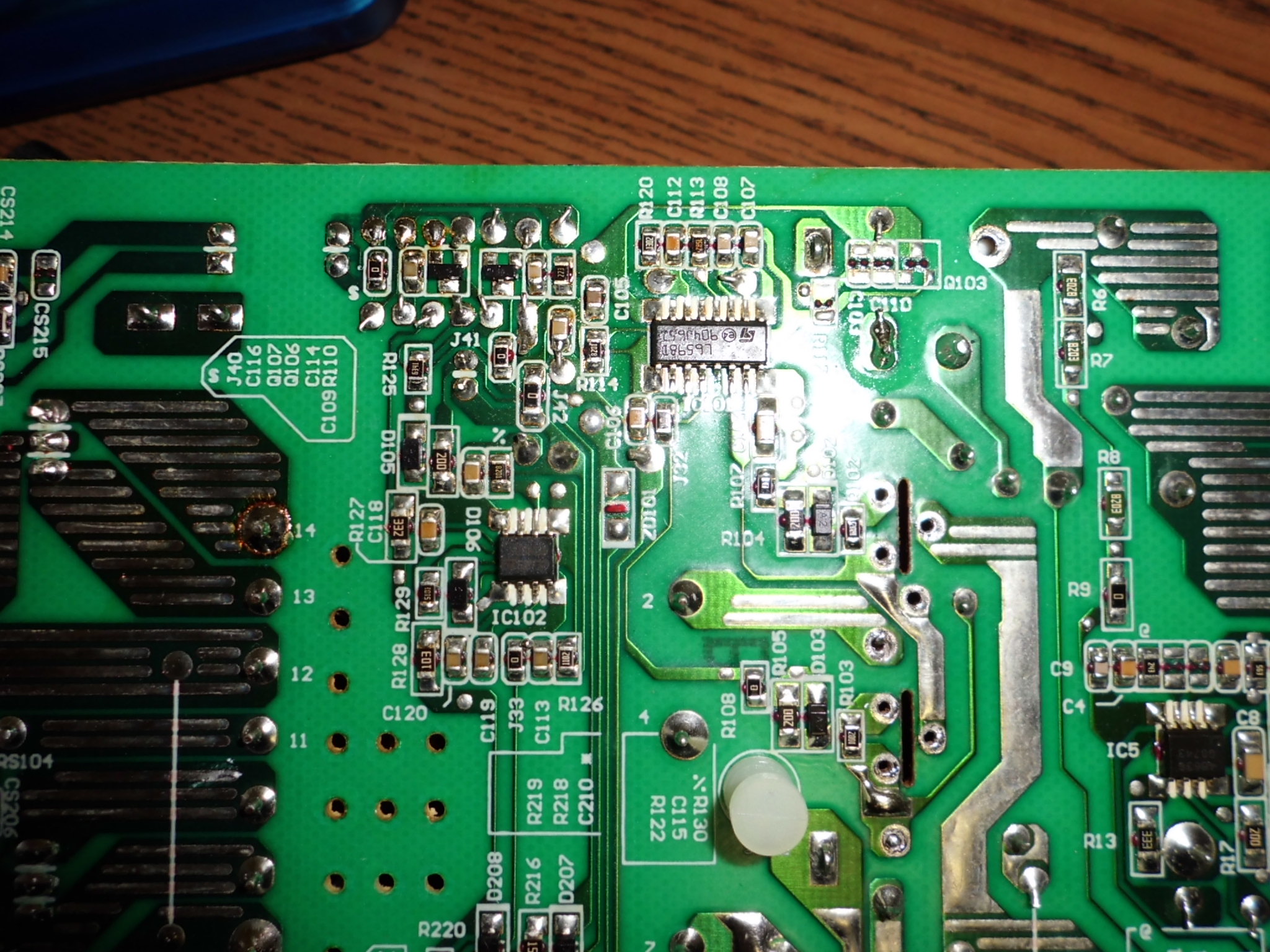

                Looks like L6598D 904J651 for the SMPS and 103AIW EZ737 for the PFC. The picture of your supply is identical to mine.
                    With the 1K resistor between 5VDC and ON/OFF, I got the following VDC values on the pins:
                    103AIW EZ737 IC
                    PIN 1: 13.10 VDC
                    0.30
                    2.50
                    0.00
                    0.00
                    1.60
                    0.00
                    PIN 8: 14.4 VDC
                    L6598D 904J651 IC
                    PIN 1 - 16 = 0.00 VDC
                      I will have to look up all those IC spec sheet first to see how they connected.
