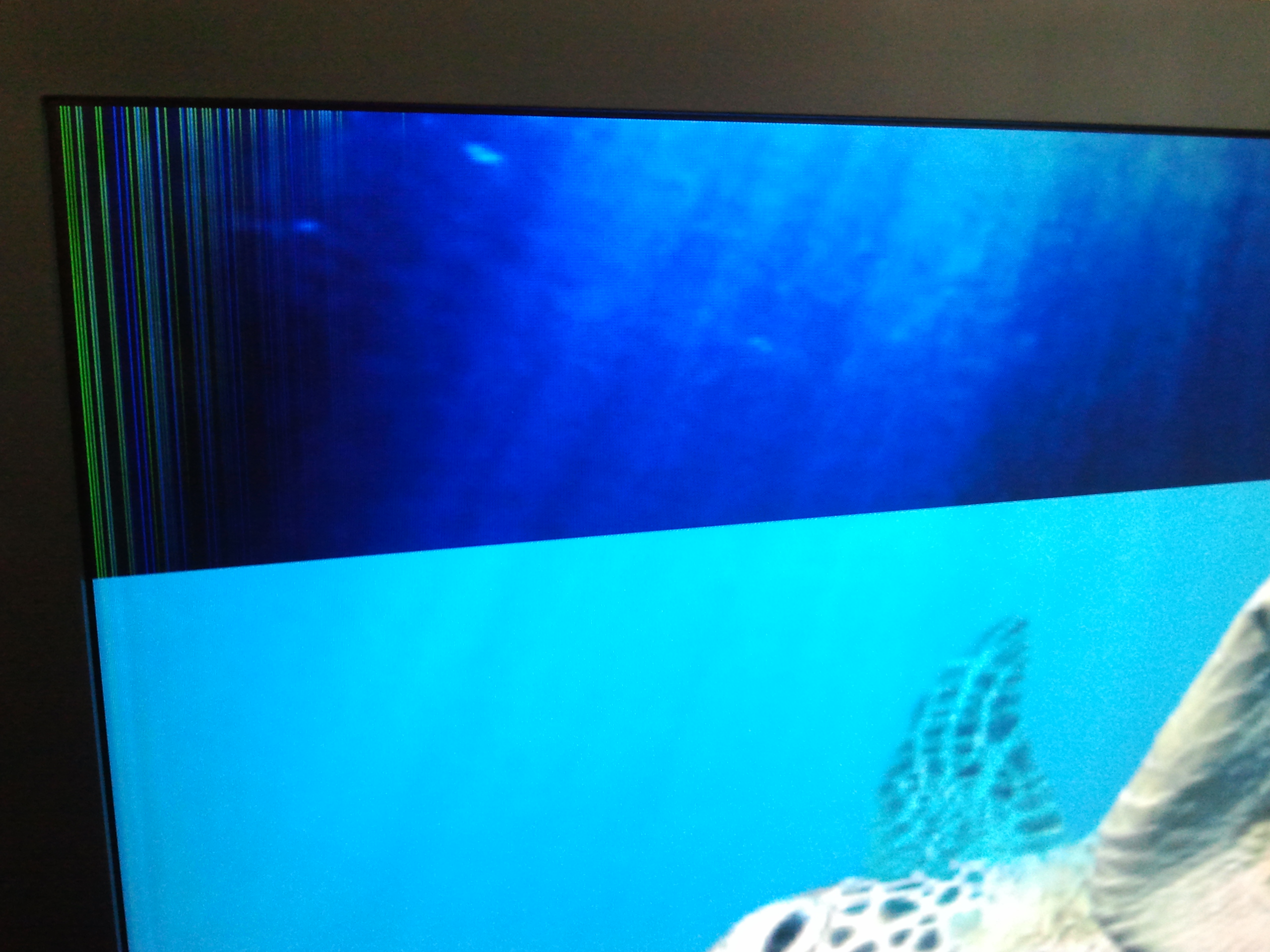

    I was thinking of picking up this TV, the guy wants $40 for it. He is telling me that it only has problems when using certain inputs, which I don't really believe because looking at the picture that doesn't seem to make sense.
    What concerns me are the vertical lines. That looks like a failing panel. Am I correct to make that assumption? or should I take a chance on this thing?

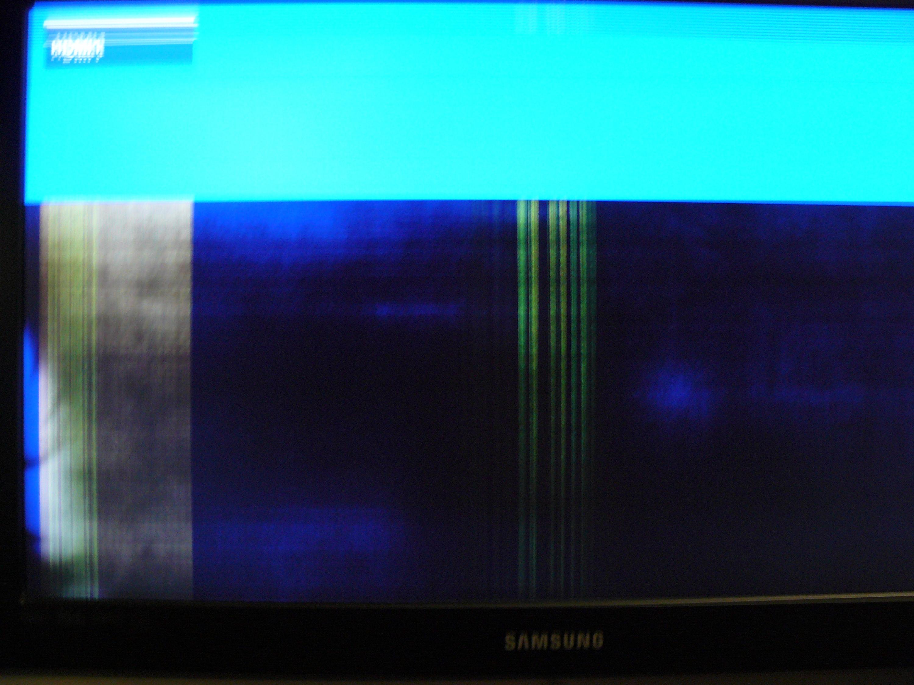

    here is an example of a 32" samsung that had a bad tcon board. The picture is blurry but you'll see it had lines in it too.

            I got the TV. The problem is on all inputs. The vertical lines disappear within 3 minutes. Once the TV warms up the horizontal anomalies go away also, and the picture looks great.
            I don't have time now to open up the TV, but when I do will post back with info and pictures if I find anything interesting

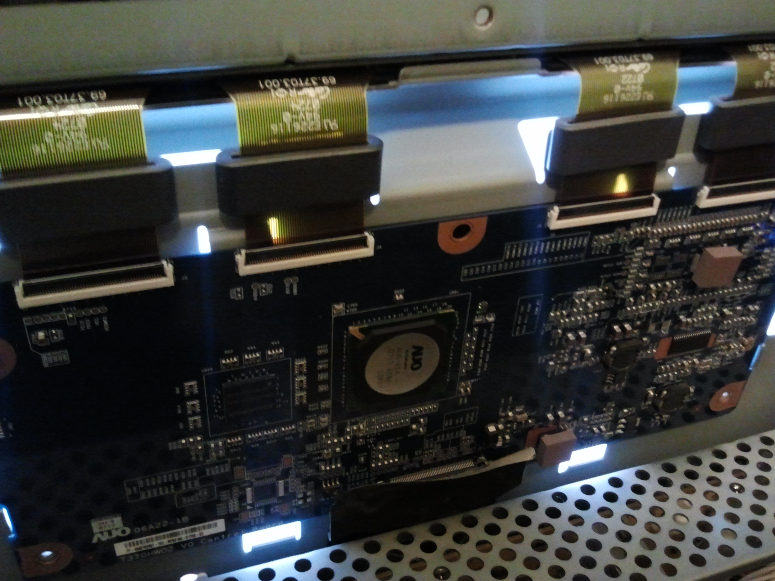

                    Ok, so I opened up the TV and reseated the connectors to the tcon and the problem persists.
                    However, I can make the problem go away if I twist the panel. This leads me to believe the problem is where the ribbon cables connect to the panel.
                    My question is, does anyone know if these ribbon cables are connected to the panel via a connector, or are they part of the panel like plasmas? I'm gonna have to take this apart all the way to the panel to find out

                      They are bonded to the panel. You can put something that is squishy yet firm and place that under the loose ribbon. Others will probably chime in on what works best.
                      **EDIT**
                      The ribbons in the picture you uploaded should have a connector. The 1" board that runs on top of the panel is what is bonded to the screen. Does the image change if you press on the ribbons from you picture?

                            So do these 4 cables coming off the tcon board go into another connector? I really hope they aren't attached to the panel.
                            It looks like I'll have to take this completely apart to have access to them
                            • johnboy1313
                              • Nov 2012
                              • 1959
                              Re: Vizio 42" LCD VU42LFHDTV10A Bad panel?
                              Those go directly to the boards that go directly to the panel. There are no removable connections.
