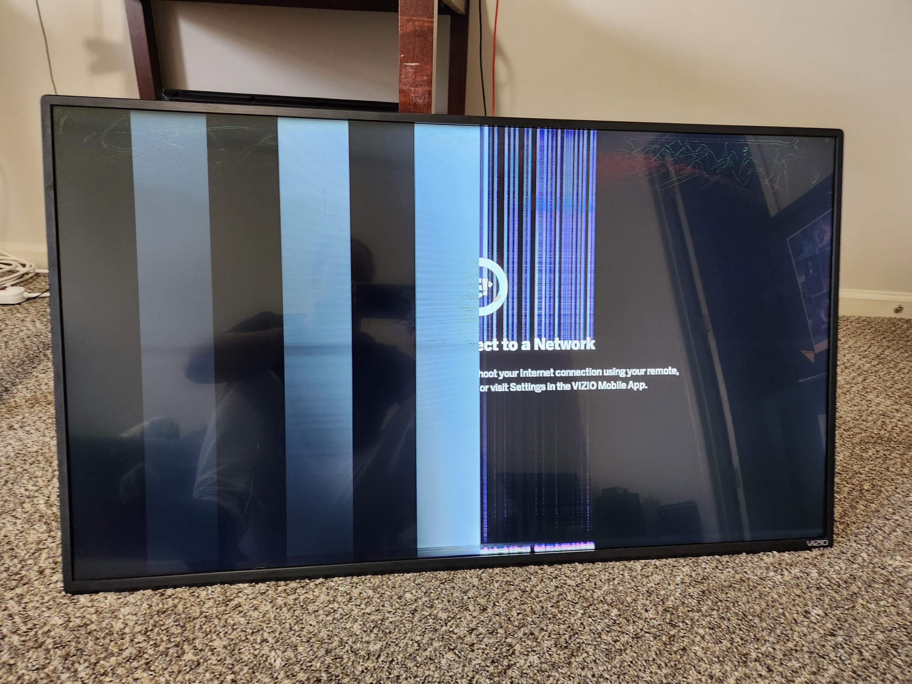

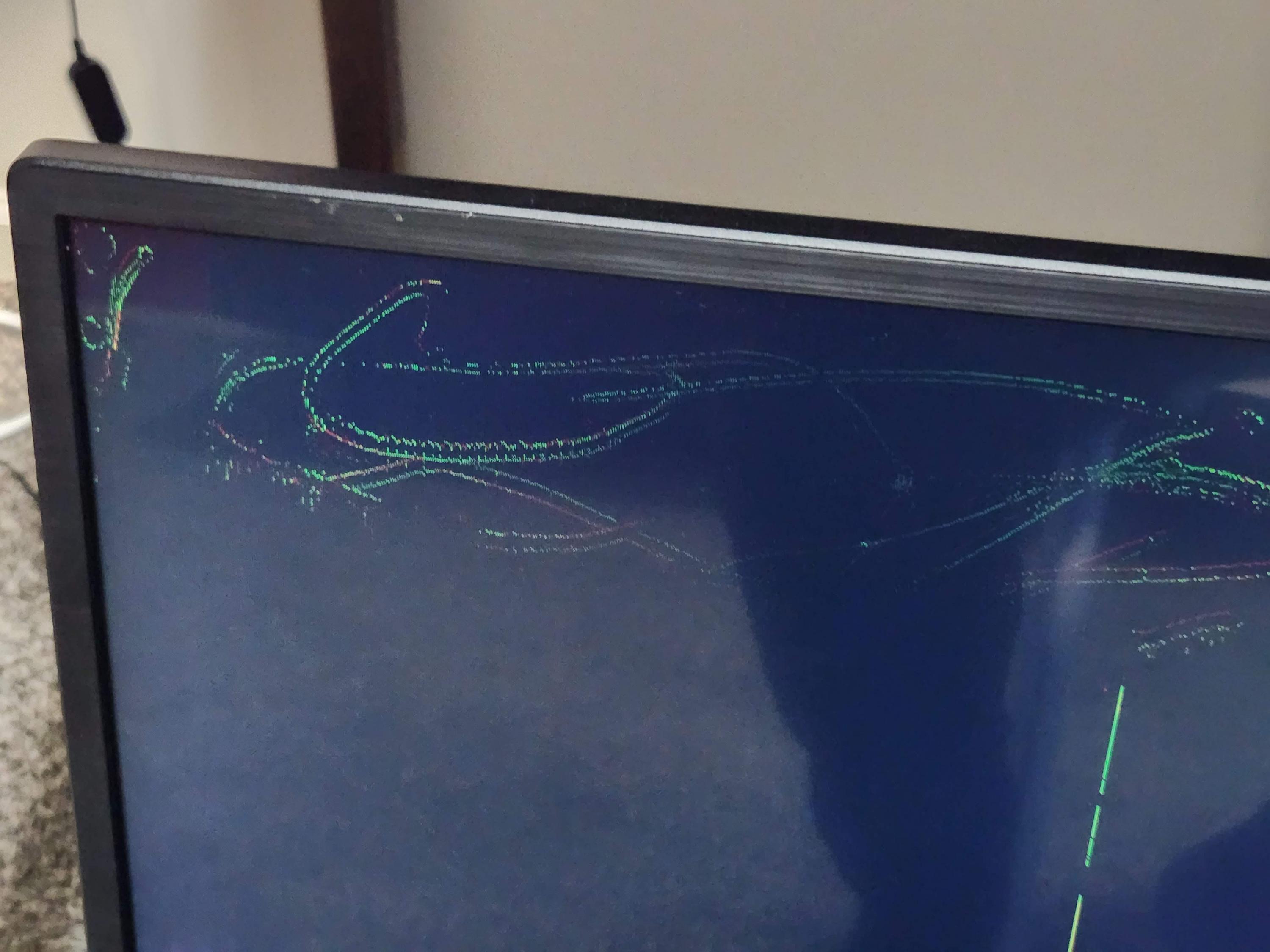

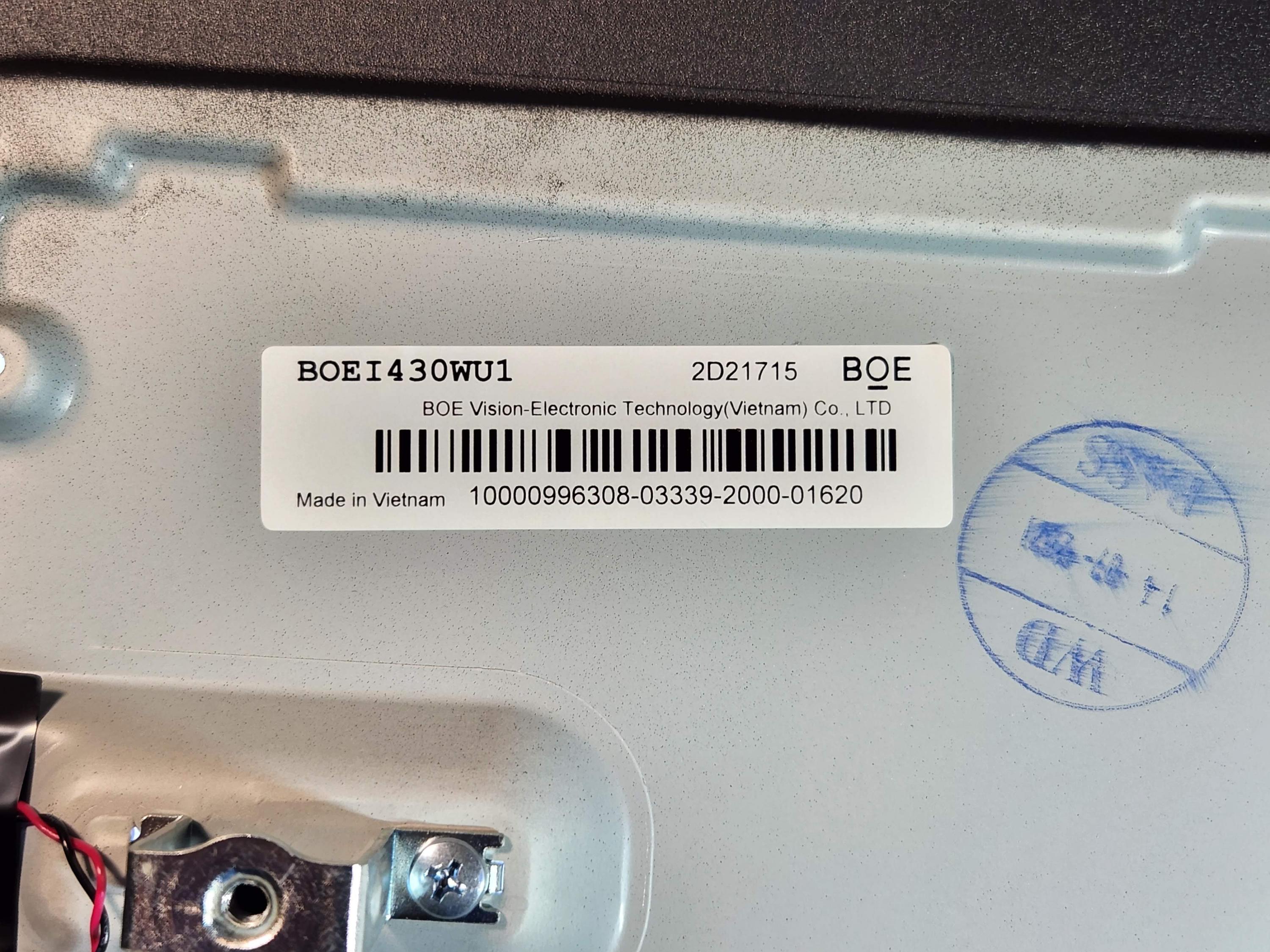

    TV Model: Vizio D43f-J04

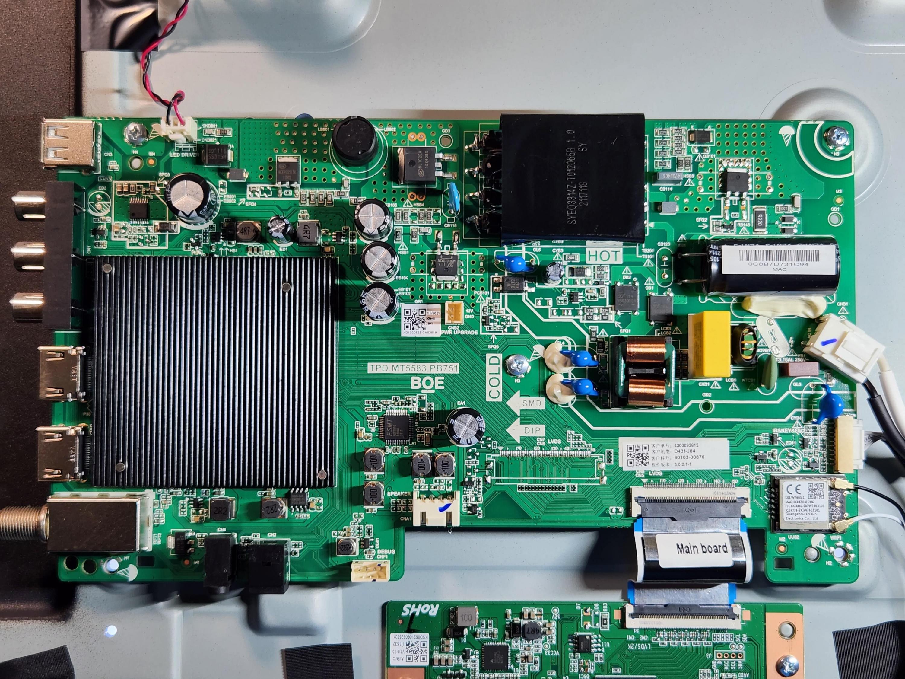

    Main Board: TPD.MT5583.PB751 (60103-00876)

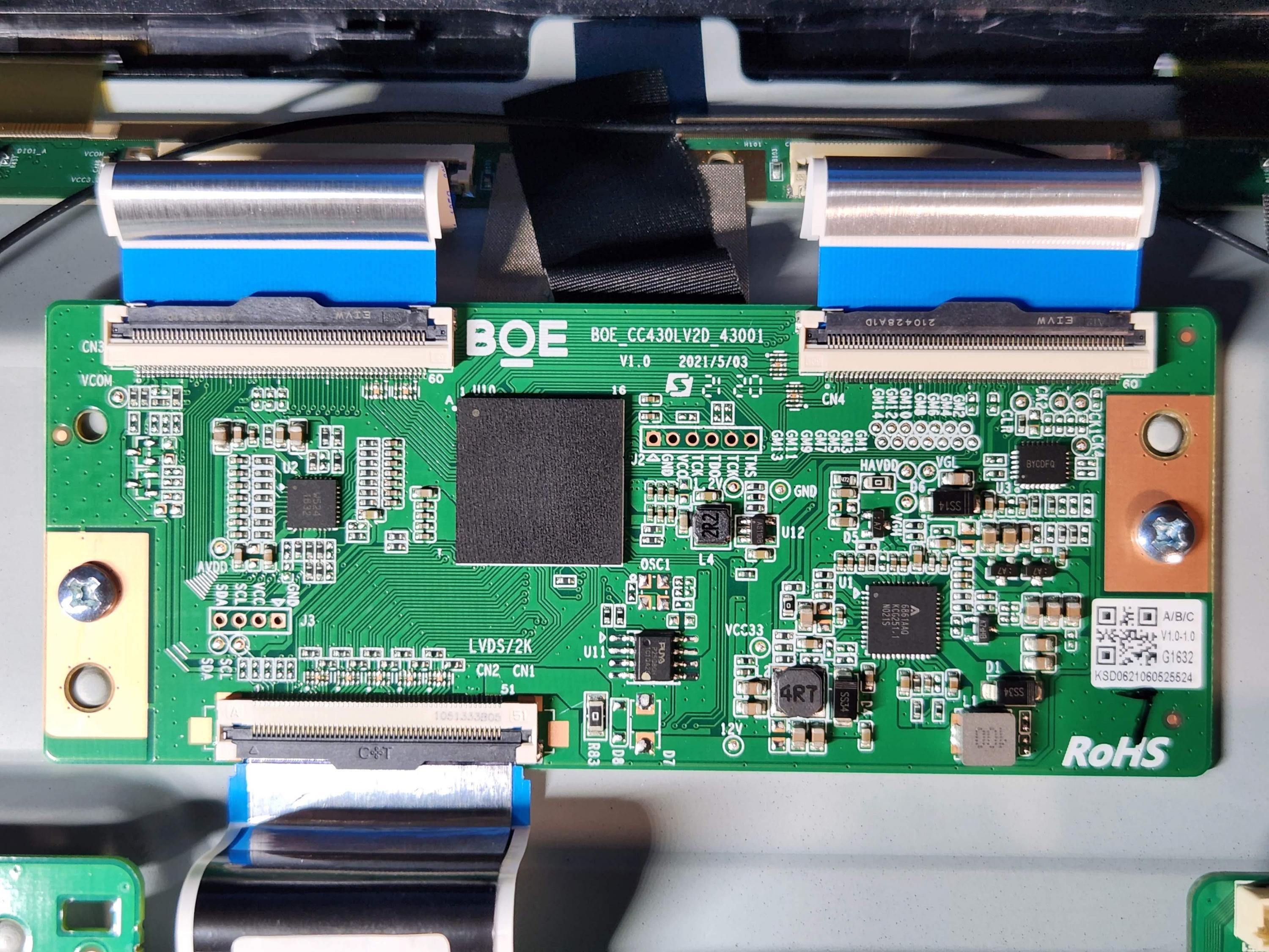

    T-Con: BOE_CC430LV2D_43001 V1.0
    Panel: BOEI430WU1
    The video of the defect is here: https://photos.app.goo.gl/fzfvmUqGXW3c1Nrg9
    This is a dumpster find, don't know if it was hit, there are no visible cracks...
    I though there may be something wrong with the panel voltages.
    Those I managed to find on the T-Con board. Does it seem normal?
    12V: 12.27v
    VCC33: 3.28v
    1.2V: 1.25v
    VGL: -5.87v
    AVDD: 16v
    HAVDD: 7.47v
    VCOM: 7.0v

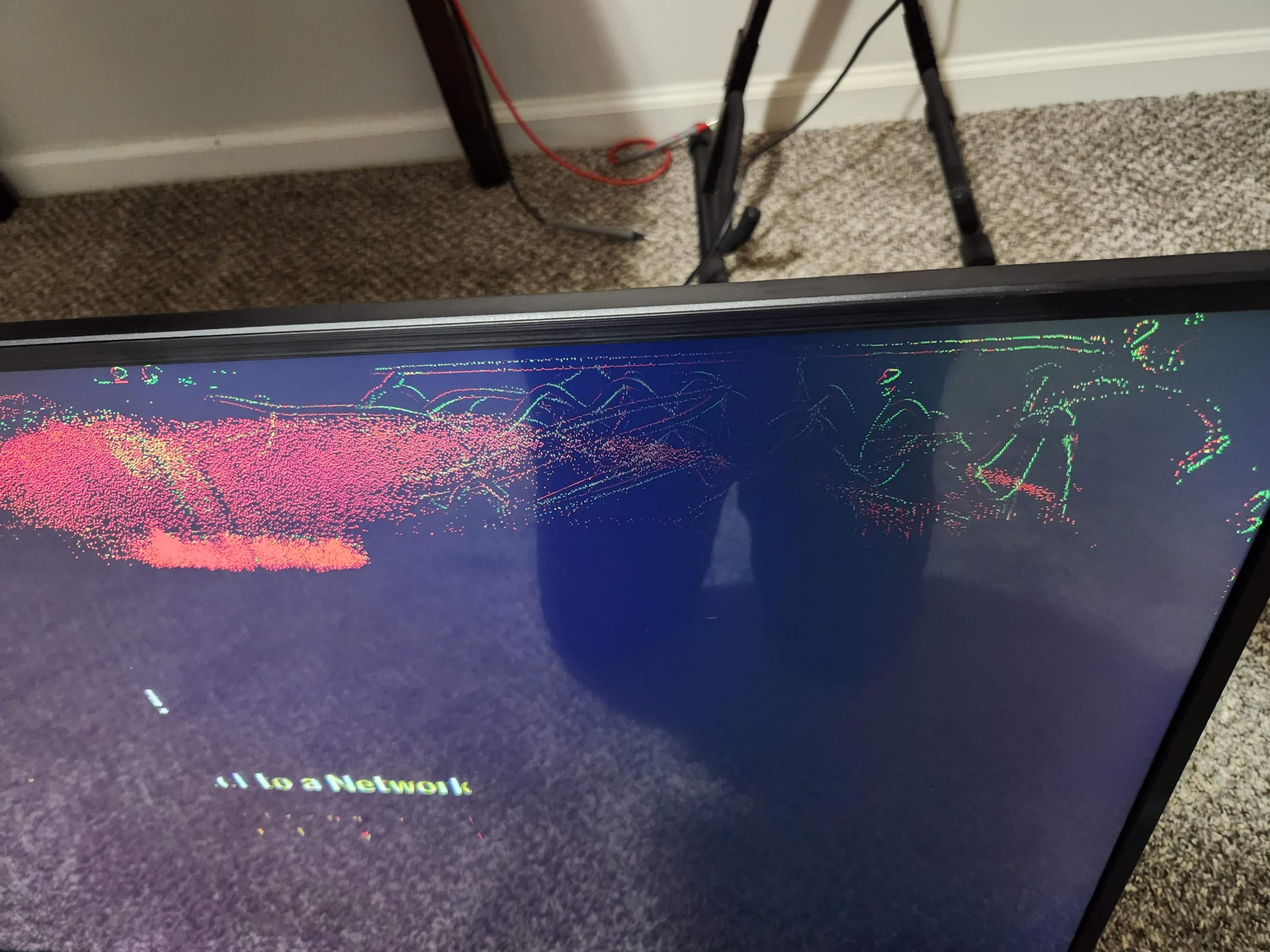

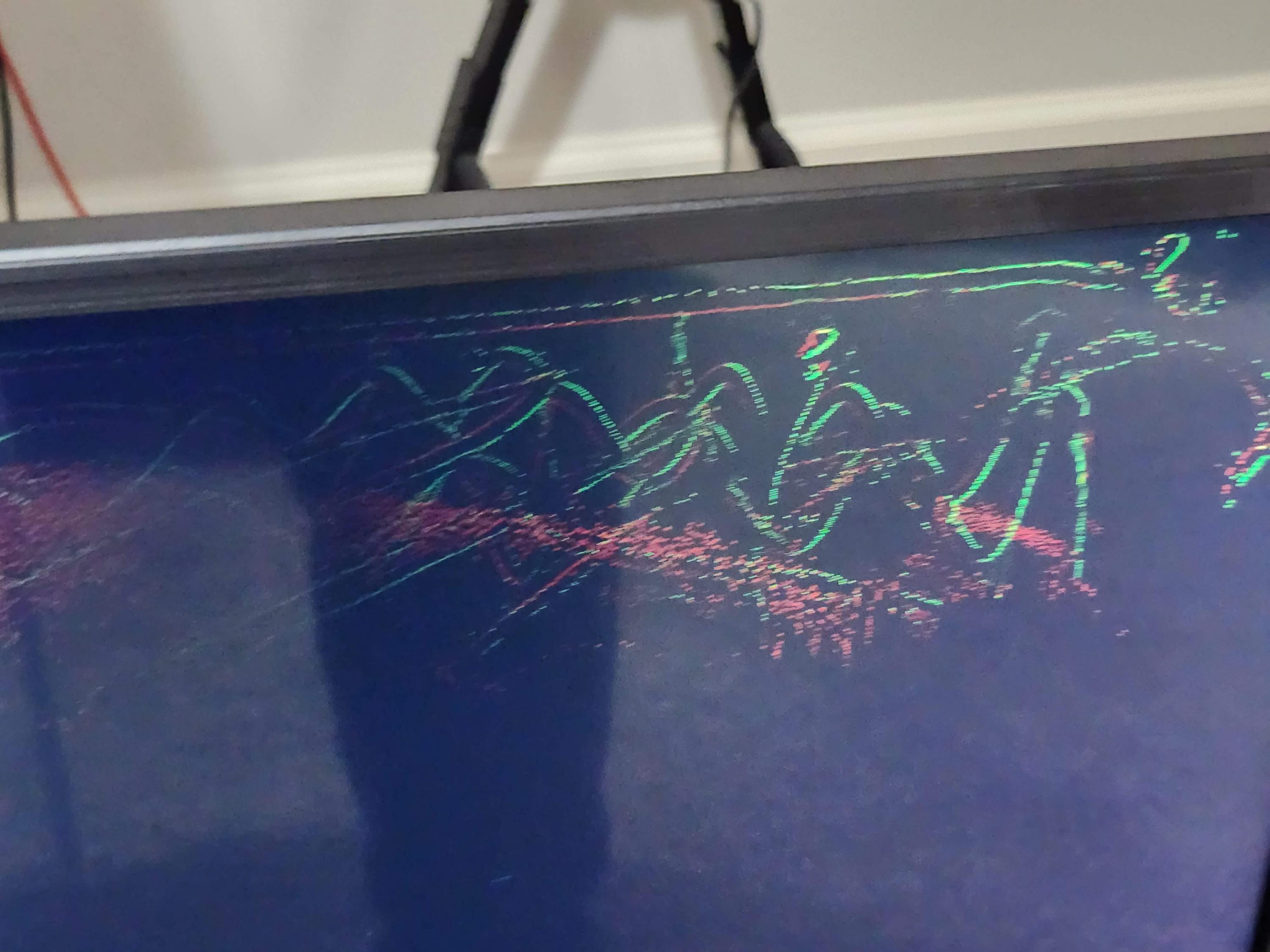

    The weirdes thing: when I disconnect all ribbon cable from the t-con the panel seem to partially remember and display the last image before turning off...
    Is this panel dead or there are changes it might be a t-con/driver boards issue?

    look it over very closely, seems like a cracked/broken screen, sometimes the crack is hiding under the bezel.

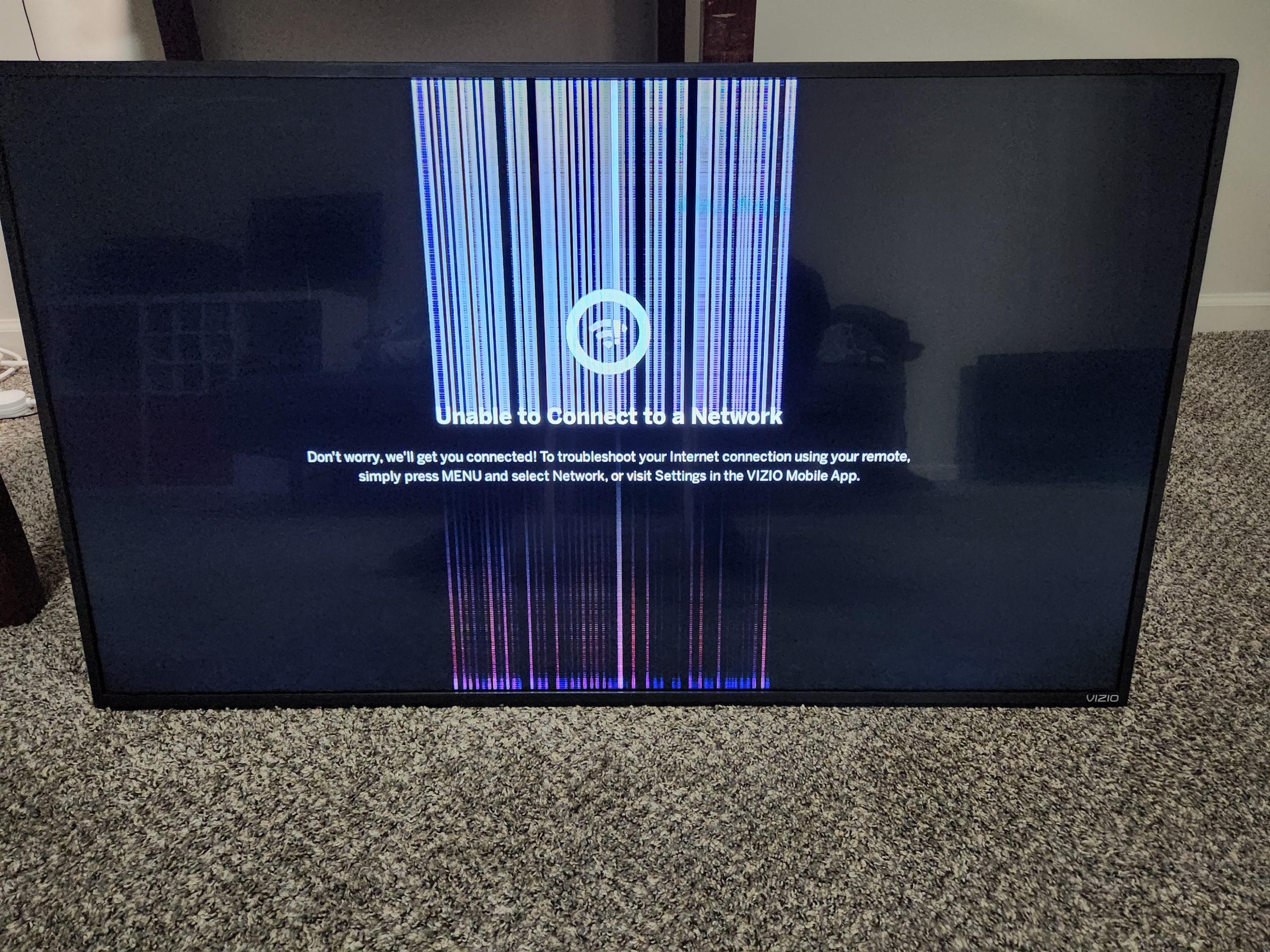

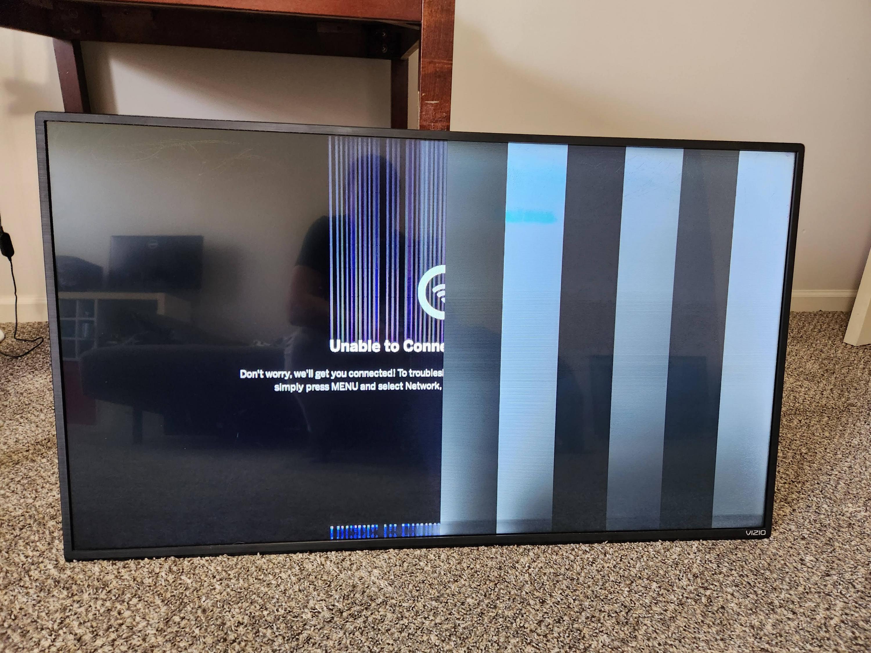

      Disconnect one cable from the tcon to the panel and turn on, what does the picture look like ? Put it back and remove the other,
      • NSkyLab
        • Dec 2022
        • 6
        Re: Vizio D43f-J04 is this panel dead?
        Right side ribbon cable disconnected:
        Left side disconnected:
        Can't see any changes...
        • nomoresonys
          • Jan 2013
          • 12104
          • U.S.
          Re: Vizio D43f-J04 is panel dead?
          ok after seeing that, I don't think it is cracked, wonder if it could be pressure damage from it having something leaning or sitting on the screen.
