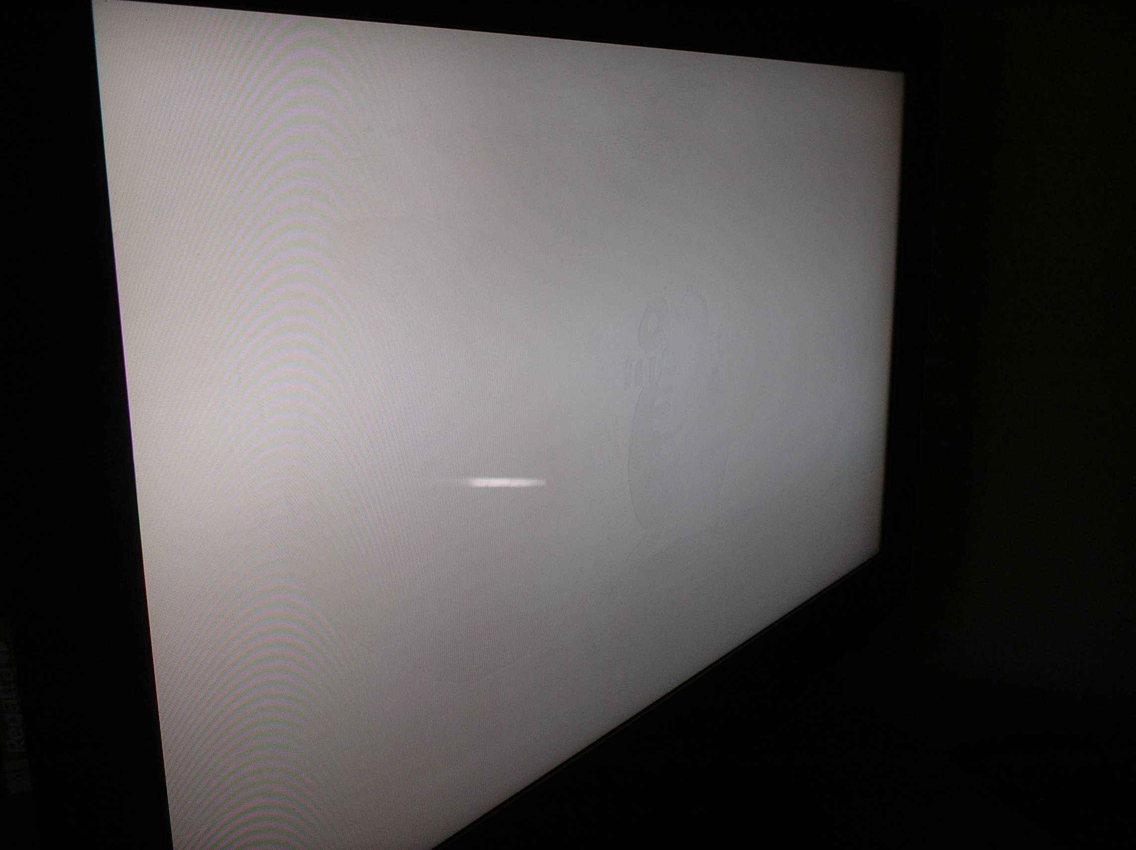

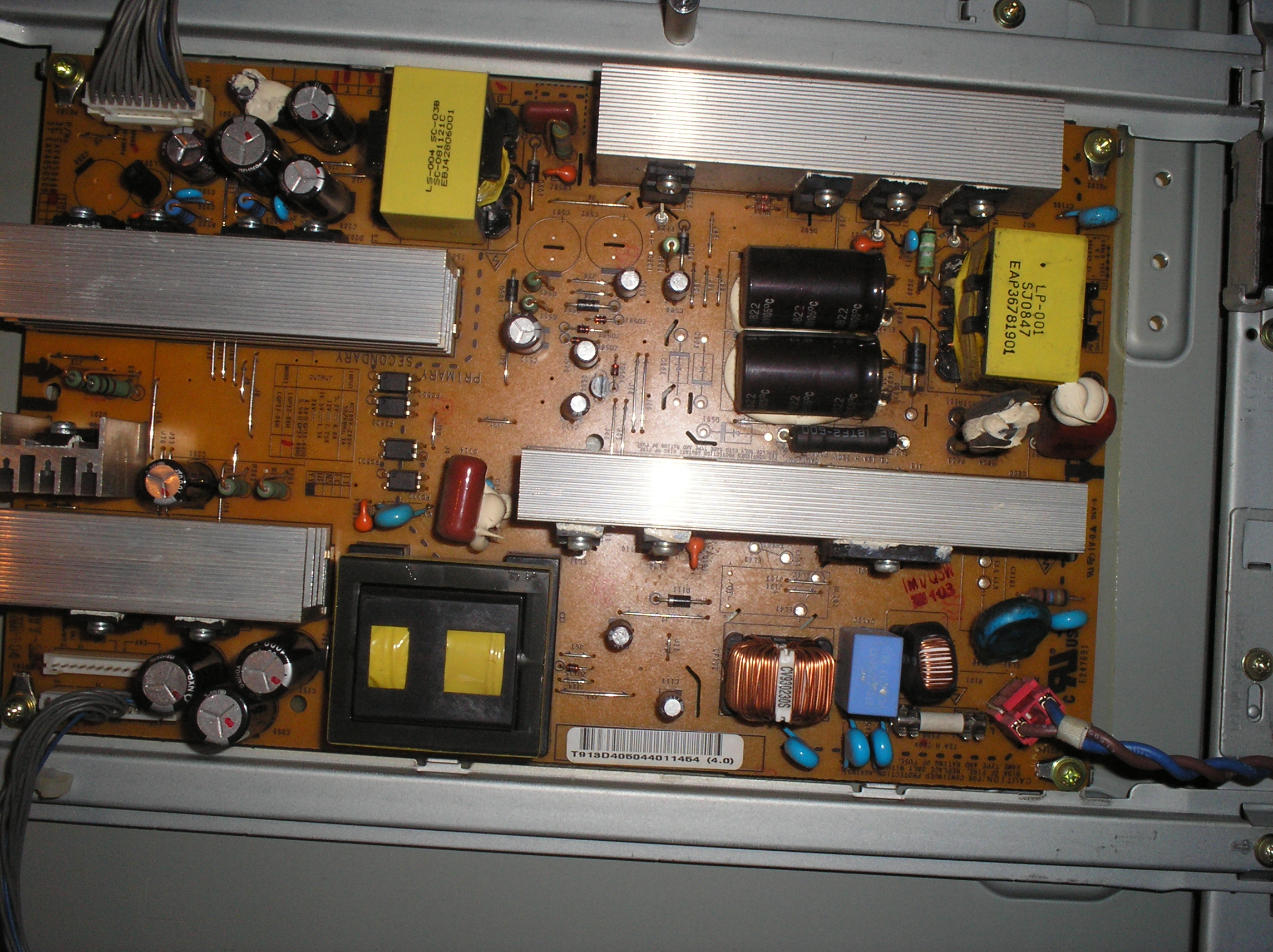

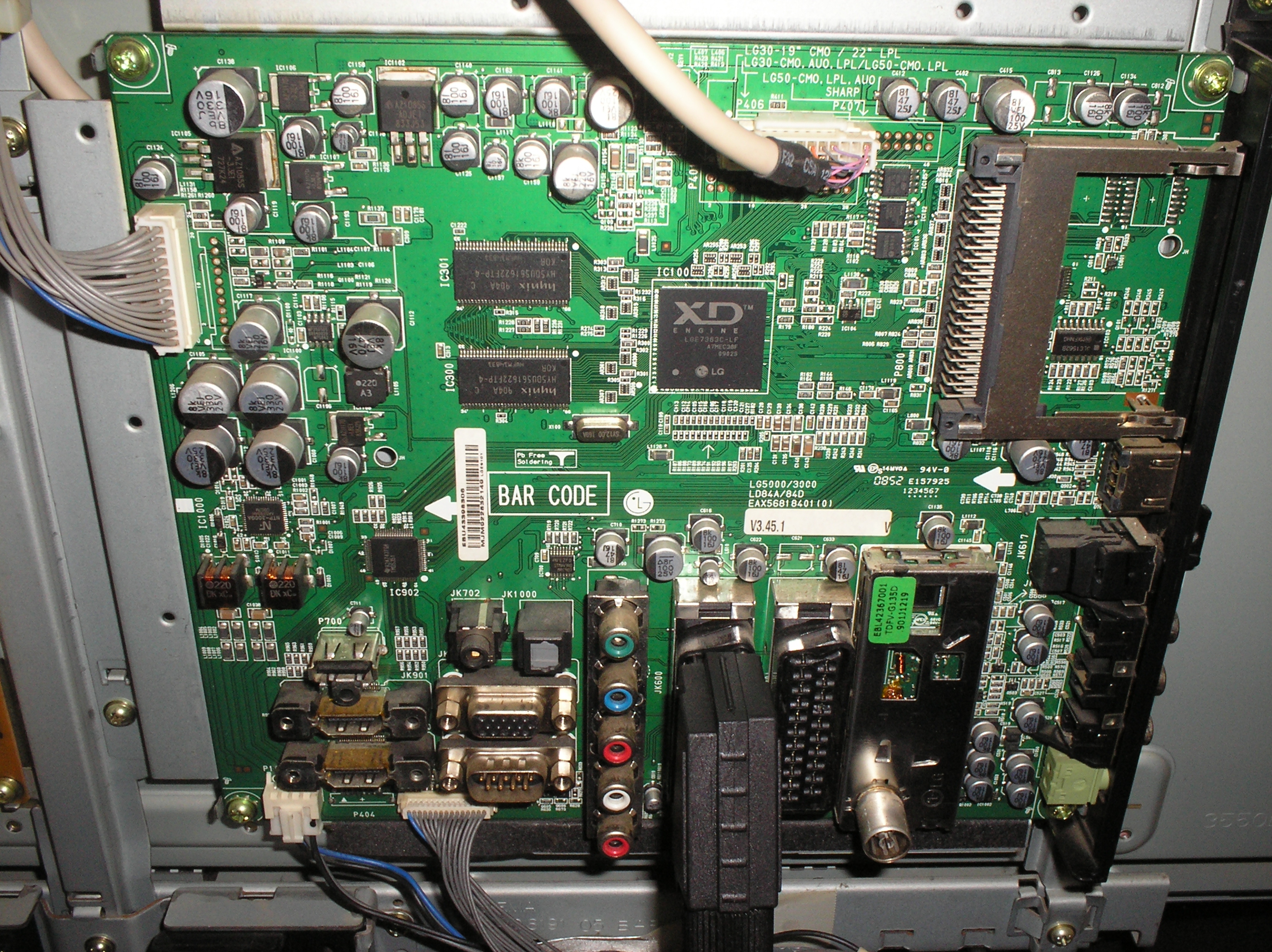

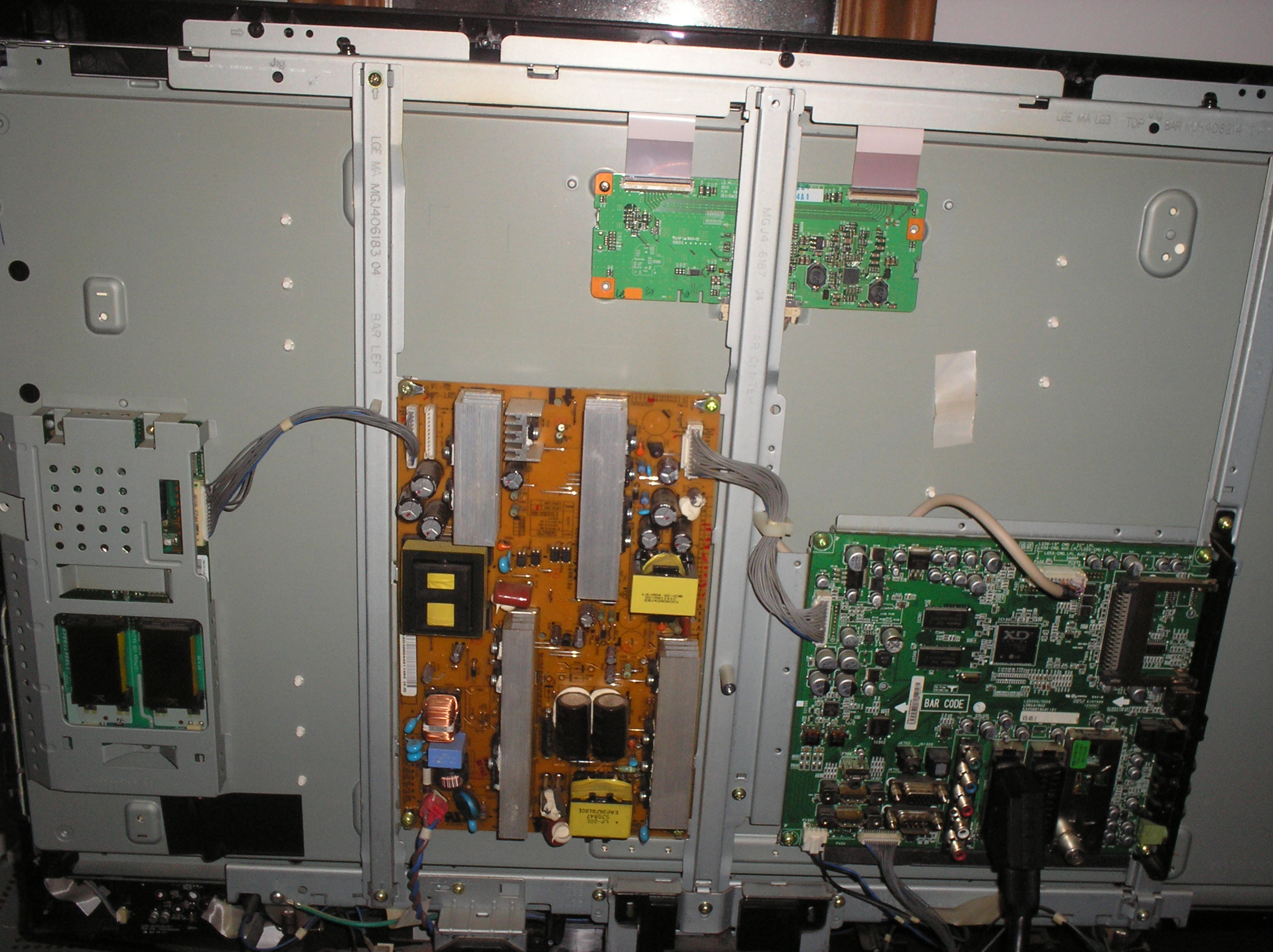

    Hi all well here we go again picked this up and thought a new t-con board would sort it but no luck, so heres what i have powers up ,backlight on, sound on, picture faint will run though all menus but all with no colour and negative image, I am running it off a dvd and it runs though both the scart sockets, here are some photos to start with any help will be very gratefully received thanks in advance

    Check for fuses on the tcon and clean the connectors tcon to panel.
    Perhaps a picture of the faded picture would help.

      Re: lg 32lg3000 white screen faint picture
      not a very good photo of screen to make it show i had to take it from the side, i get the same picture with the old and new T-con cards did clean up the ribbons when i changed the cards, will check lead and plugs t-con to av with meter next then pull the av board and have a good look at that
        This could be a bad panel. Not 100%, but we have seen faint dark picture indicate a bad panel before. It is sometimes fixable. The only board that could cause this in my opinion would be the T-con, but you have replaced that.

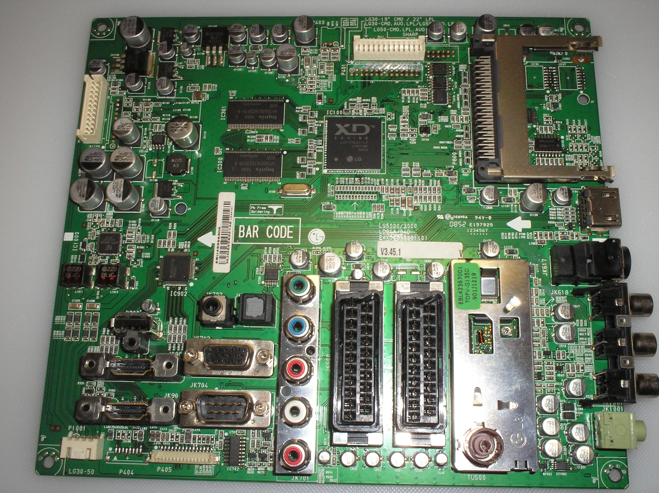

          had a look with av board out c112 (top left in line with white socket) looks a bit sad and some around it dont look to good, were can you get this type of cap have not replaced these before?
            The AV board could only produce this effect if the contrast etc. were set wrong but usually the menus/OSD are always visible even with wrong contrast.

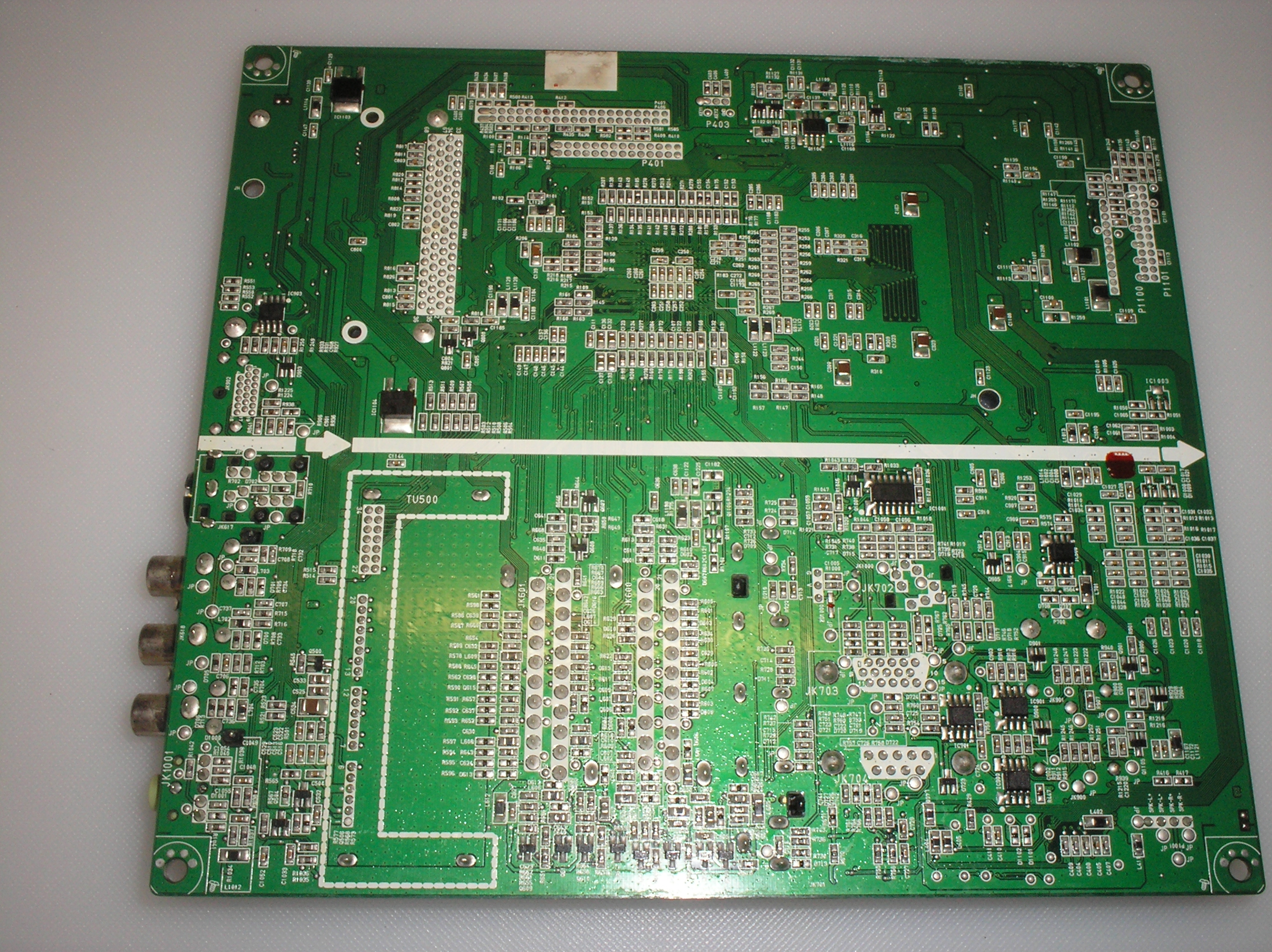

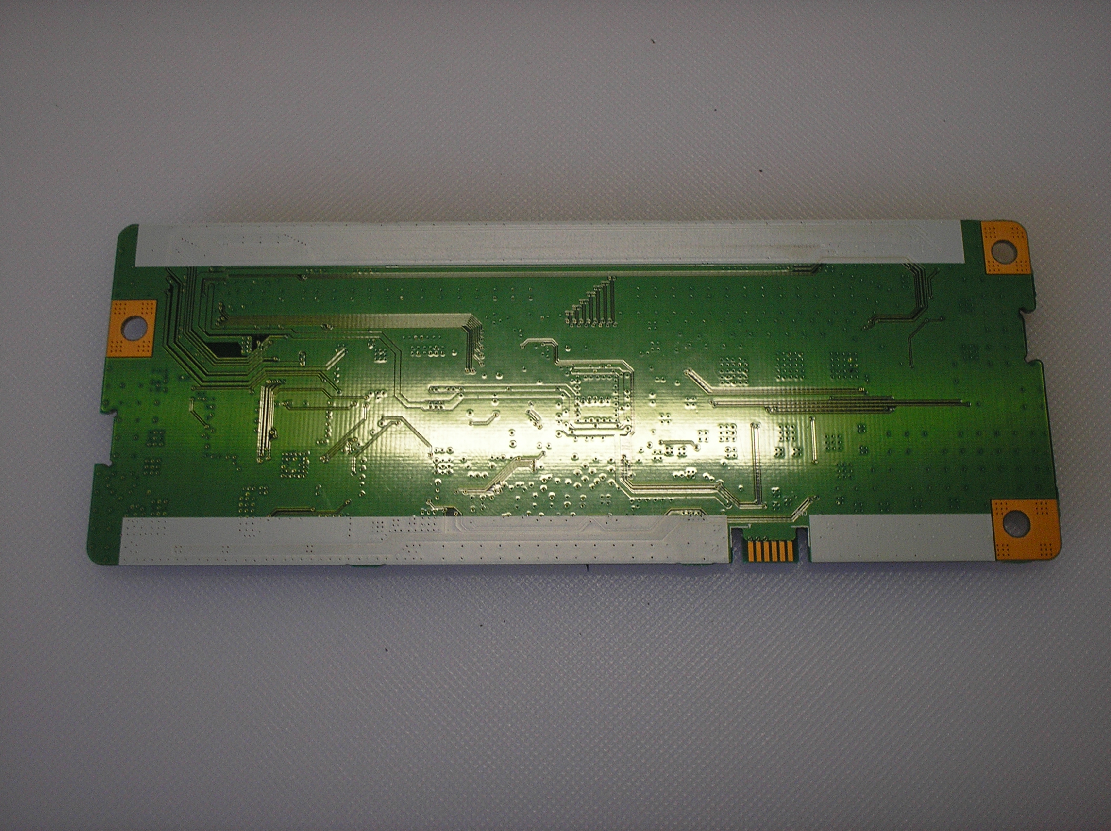

                          no the same washed out picture, what about the caps on the av board will these not be a problem i have found replacements Conrads have them,I will take photo of t_con board and post

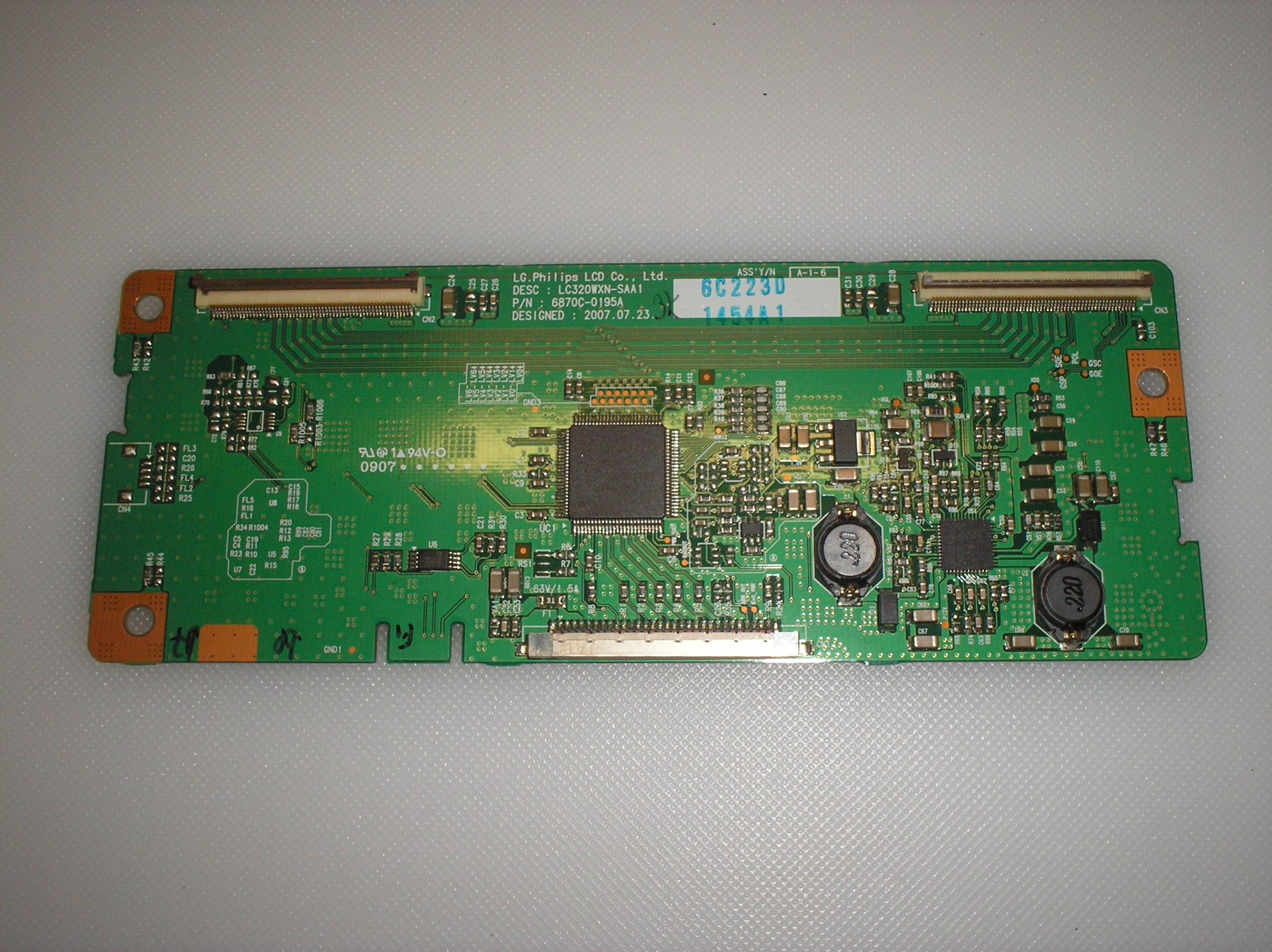

                            photo front and back t-con broard will have to refit boards to set before i can get service menu up
                                The fuse is at F1 - when you have it connected you can test the voltage. Cant see any marked voltage test points. I think they are all together just above the processor but the label doesnt have any values.
                                  He is getting some picture, so it cannot be the fuse.
                                  It could be low 12V/5V applied to T-con, would be unusual but it might be possible...
                                    Yes see were you mean lv0/1/2/3/4/5/6 lv0+/1+/2+/3+/4+/5+/6+ what about gsp.gsc/goe/pol/soe far right at top what am i looking for volt wise dc under 24 or more
                                      At fuse "F1" marked TK what voltage are you seeing either side of it?
                                      • flocko
                                        • Nov 2012
                                        • 1121
                                        • uk
                                        12.36v each side of fuse i had a look at the test points but there so small i think i would short them out if i put a meter on them
