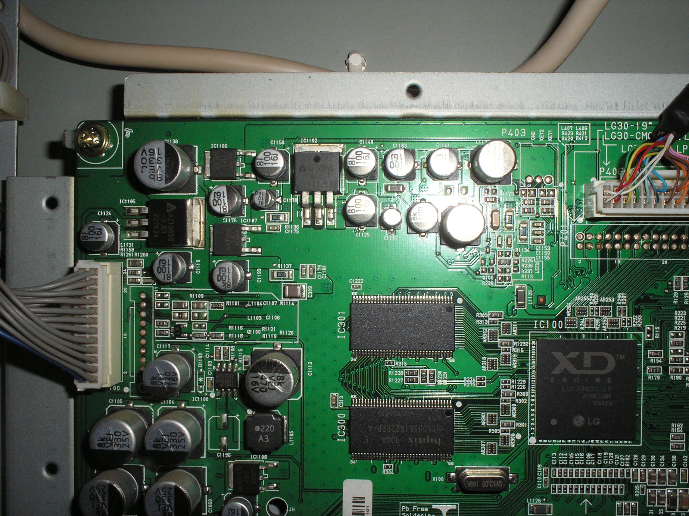

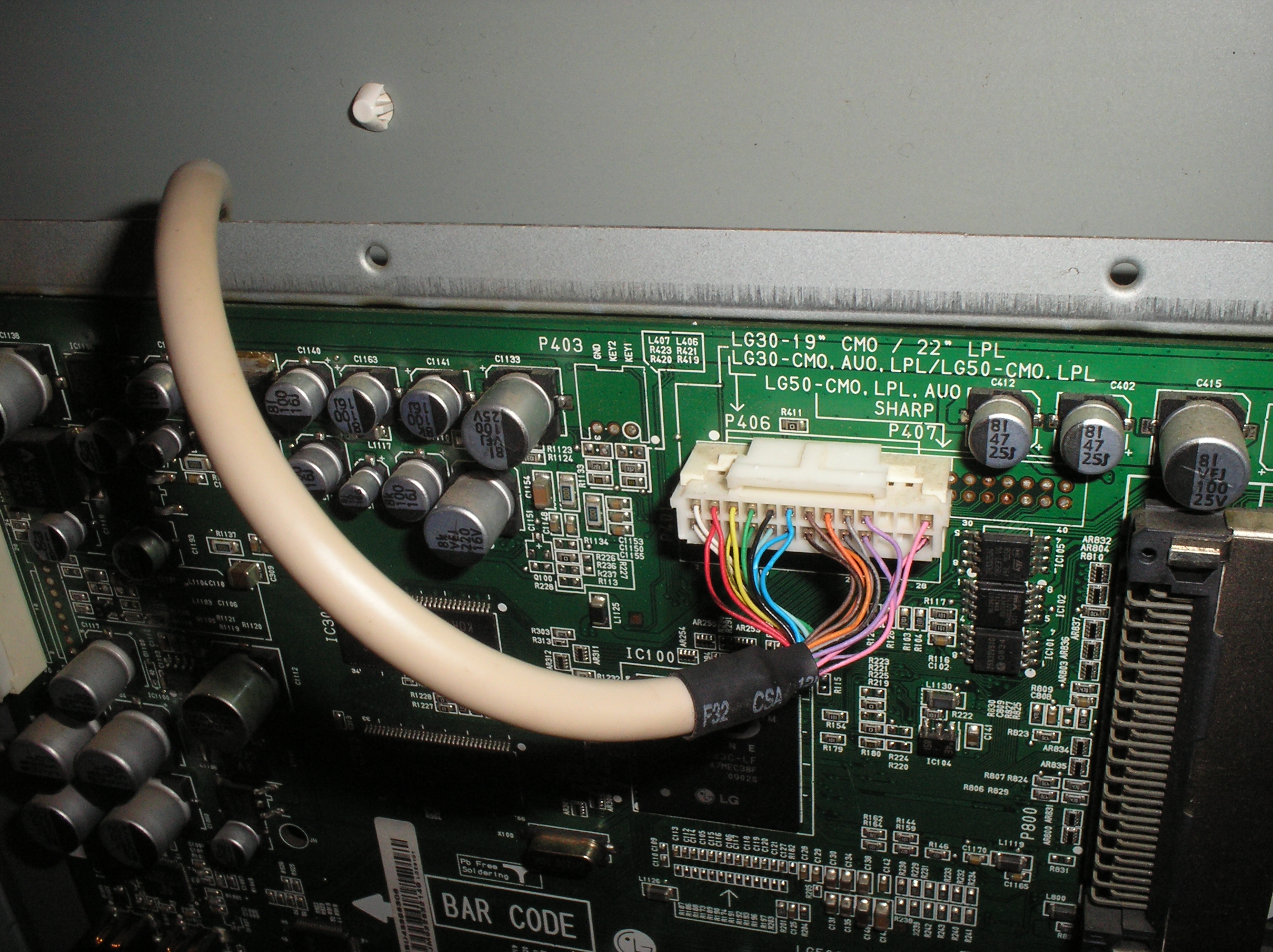

      not that i can see, You said about the 5v supply from the main board, That must be on the socket at the top as that is the only link i will see if it is marked up as my photo does not show it
        Re: lg 32lg3000 white screen faint picture
        photo main av board to t-con socket view from the top you can see the bottom in the other photo anything i can check here

                had the panel out all ribbons on ok all back now still the same, so does having 12v at the t-con fuse rule out the main av board and the t-con board ,the puffy caps on the av they would not be a problem then any thing else i can try thanks for you help with this
                  The AV board is unlikely to cause the distortion shown.
                  The T-con is the main suspect, but you replaced it. It is possible you got a faulty part. Can you exchange it for another?

                                Hi Tom thanks for sticking with me on this i have been reading though the posts for the dynex DX-LCD32-09 that has the same type of problem, he also has changed the t-con with no luck but what i did find interesting was the post made by momaka to check the caps near the voltage regulators on the video/logic board as i have bad looking caps in this part of the board do you think i need to change them.
                                  #36
                                  Anything's possible now. Check all the regulators on the main board. If it is the main board, I will be very surprised, but it could be I guess.
                                        voltages for regulators taken with reference to pin 2 ic1105 pin 1 3.2v pin 3 1.8v ic1102 p 1 2.4v p 3 2.0v ic1106 p 1 2.4v p 3 1.7v ic1107 p 1 2.4v p 3 2.5v ic1108 p 1 1.7v p 3 1.4v
                                          #40
                                          Not sure you have the right method there - read this
