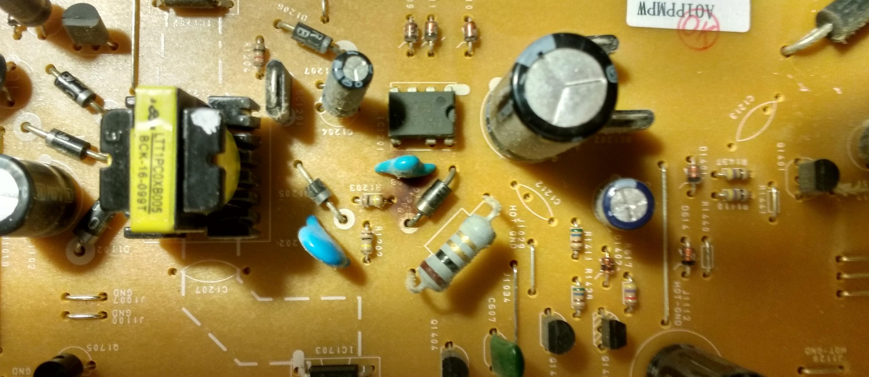

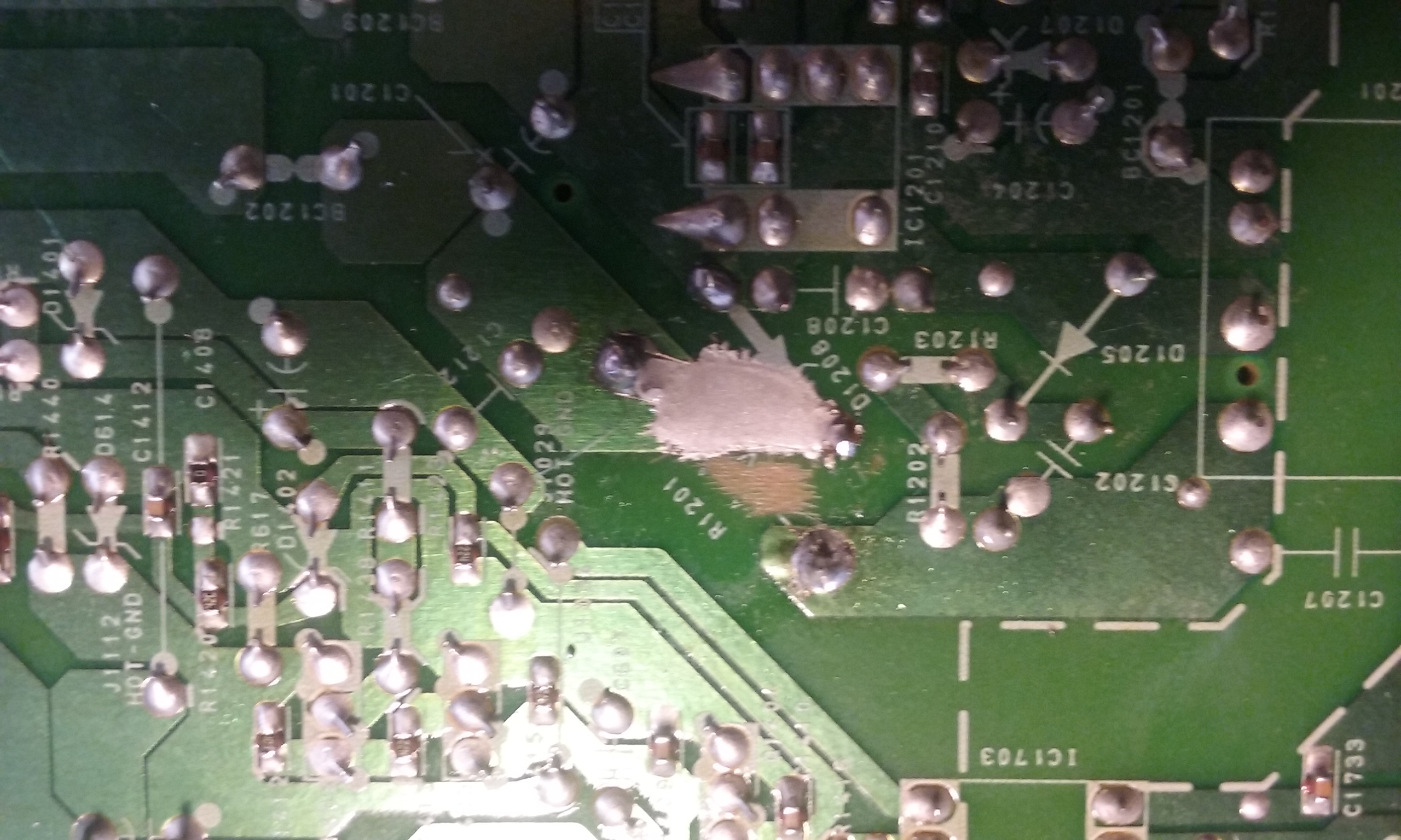

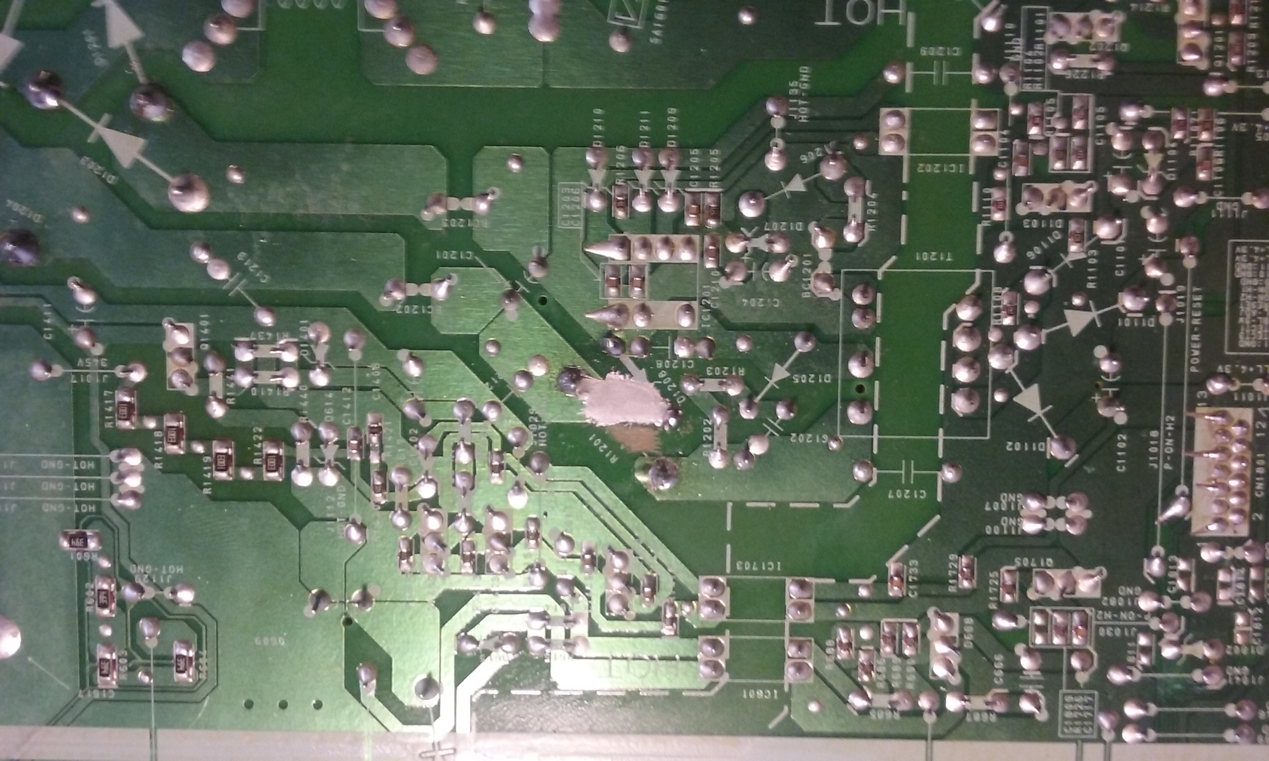

              I was looking over this thread since I'm working on this exact problem. Here's what I found when I first looked over the PS board.. On D1208 as mentioned in this thread, there were heat signs on the top side of the board. On the bottom side, you can see the solder is missing on one leg of the diode.
              So my question is, do you think part of this problem is caused by cold solder joints on the diode D1208? I intend on replacing the diode, I'm just curios if anyone else has found something like this?
                Re: Emerson LC401EM2F
                That is the snubber diode for that STBY SMPS IC, it looks to like there was cold solder joint so it heats up due to contact resistance. I would replace it.
                    Are you getting the STBY Voltage?

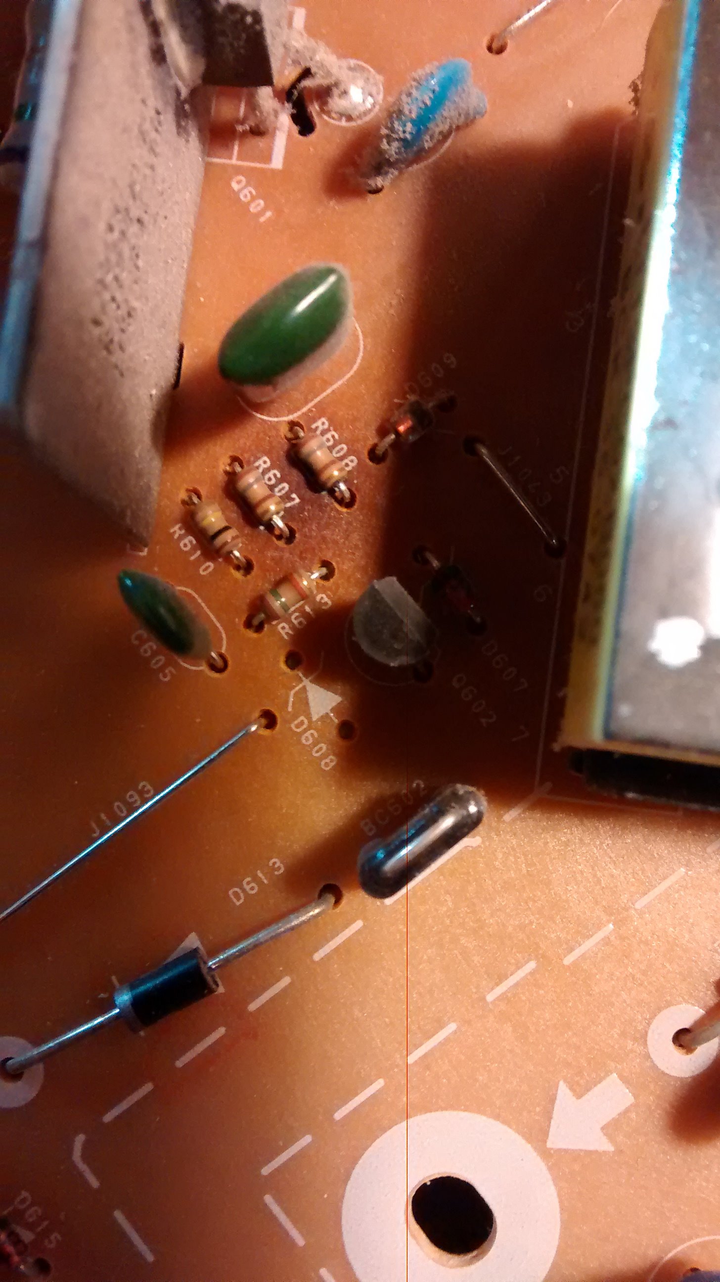

                    Hi Bud, I'm not getting anything at the moment. I've got a diode ordered and waiting for it to arrive (should be here by Tuesday). I thought I'd replace it and then see what I have. Once I get a new one I'll post any new findings either way. It also has a brown heat mark around resistors R607-608-610-613. Would this be from the diode, possibly indirectly?
                      I cannot tell from the pictures as to what those resistors are used for.

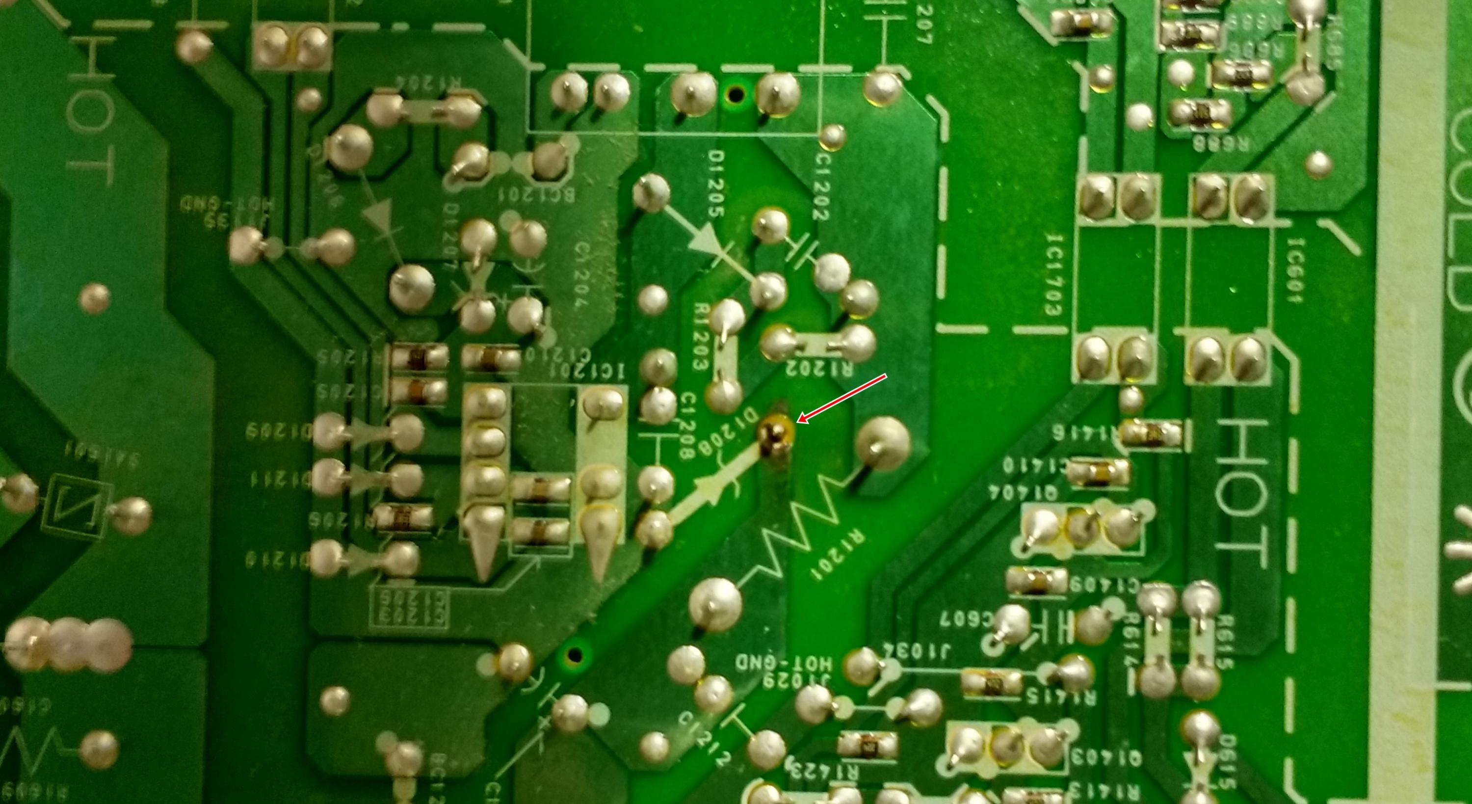

                        The fusible resistor R1201 which you should check to see if it is OK, it is 1 Ohm resistor.
                        BTW, the connection of the Zener Diode D1208 does not match the diagram in post 1, it is not snubber diode, the snubber diode per board layout is D1205 along with the the C1202, R1202, R1203 which form RCD snubber network.
                        The circuit should work without Zener D1208 in place.

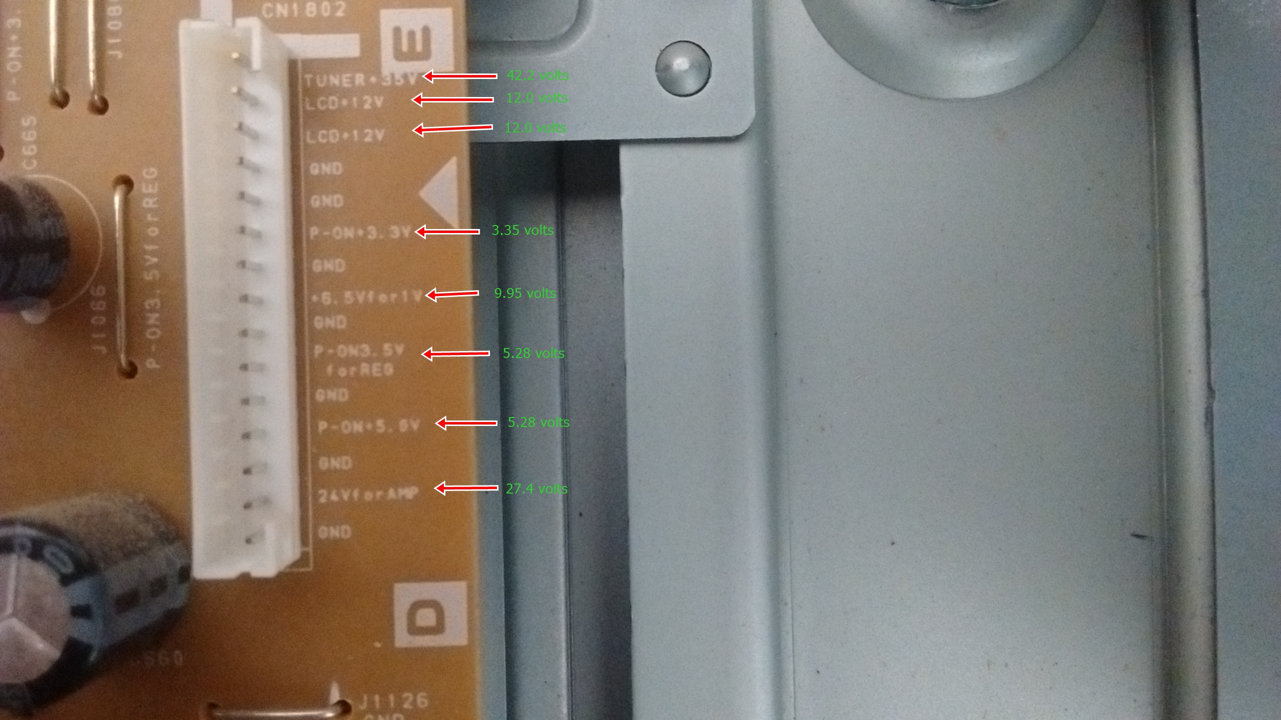

                          Bud, in the picture attached are the voltages I got this morning after removing D1208 from the board, and checking R1201 that checked out to be good. Diode 1208 on my board was definitely bad, it had a gaping crack all the way down the side of the diode.
                          Are those voltages within range?
                          I did turn on the TV and the screen lights up and everything seems to work normally, however, I didn't leave it on long for fear it might do some damage with the missing diode. I was curious to see if it would come on or blow the fuse. Which as you probably guessed is why I didn't have anything at the moment from earlier. I had to round up a good fuse since the one in it was blown.
                            I too replaced D1208 and have a working TV again. Had it on all last evening and works like a charm! Thanks Mark369, and budm for your work and dedication on resolving this issue.
