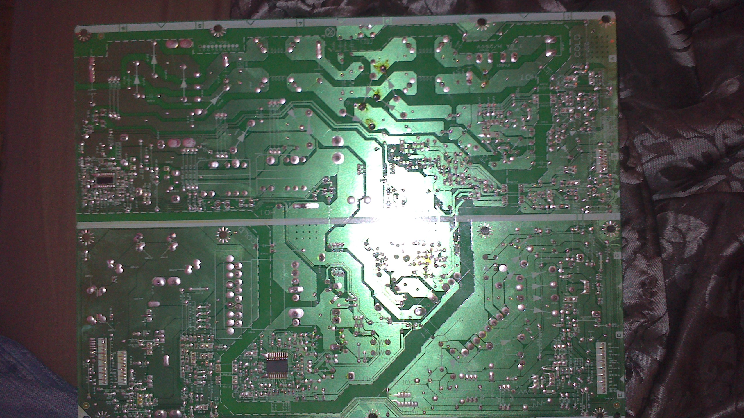

    SA1601 is OK so the fuse is not seeing a dead shorts. How are the the Diode second set of the rectifier (D1607~1609)?
    "c1612 on my blue esr meter it shows .33 in the board and on my dmm on the 20M setting it starts at 2.2 and then goes down" how far down does it go down to?

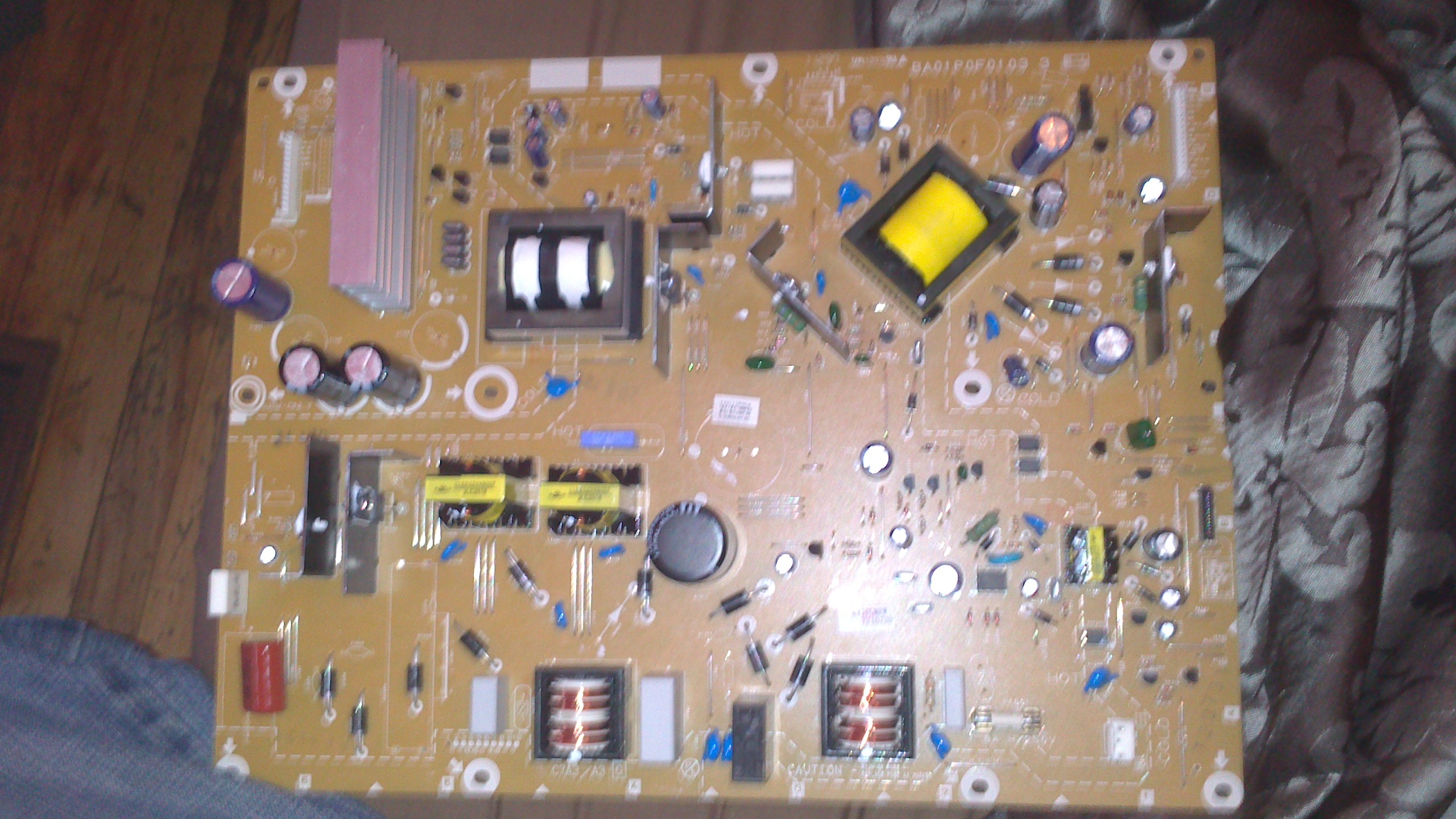

                    #29
                    Re: Emerson LC401EM2F
                    https://www.badcaps.net/forum/showth...rson+lc401em2fI read this post before I started this one.
                    It's the same board same every thing. this tv is only 12 months old.
                    so you could use his pics same board no damage can be seen not even heat spots.

                            I think that it has a shot on 5.0v rail to ground but not sure how to find it yet.
                            I have a muilt-meter and a blue esr meter i have a 15Mhz scope but i don't know very much about the scope on how to use. don't think i could use it if there is no power on the board anyways.
                            could some one give me a hand to find short.
                            thanks and mary christmas to all

                                    I was checking things and found I have short on pins of T1201 its like pins 5, 6, 7, 9, 10 are all connected together and pins 1, 2, 3, 4 all connected together. I have not removed yet to retest.
                                    IC1201 (MIP2F30MSSCF DIP7-A1) same thing pins 5, 7, 8 all connected? pins 1 to 4 all connected? short on c1208?
                                    have not removed yet to retest. found datasheet but not in english.
                                    how would i check the transformer and no i don't have a ring tester

                                        OK, we need to start isolate the circuits to find out which section is shorted out, let try removing the Q601 (2SK3798) on page 3. You should use the lamp (100~200w) in place of the fuse so you will not keep blowing fuses and cause more damages.
