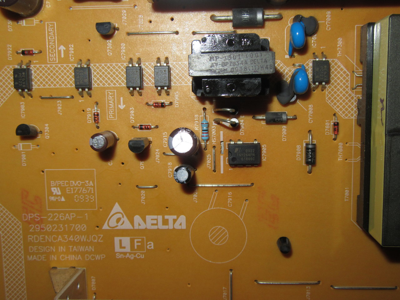

    TNY264AP. The resistor R7918 2.20 Ohms is 1/2W MOX Flame proof, it is for supplying the Voltage from AUX winding of the STBY transformer for running the PFC IC and the SMPS IC of the 12V/24V power supply. The R7914 is the fusible resistor for supplying B+ to run the IC.
    You also need to check the snubber network D7908, 7909.
    So do you have about 165VDC between the negative leg of the main filter cap and either legs of R7914?
    DCV between the two legs of the running cap C7915?

          Just wanted to thank budm, and add another data point!
          I had exact same symptoms as steinless on my RDENCA342WJQZ DPS-286AP-1 power board.
          IC7905 was visibly damaged and was replaced.
          R7914 was found to be open and has been replaced.
          Lifting D7905 allowed the board to power up again.

              Hello all,
              Have a 42" Aquos with DPS-226AP-1 and it brings up standby green light for about 30 seconds and then shuts off. If I try again in a minutes it'll bring it up for only a couple of seconds and shuts off again.
              Voltage testing on TNY264 gives me 0.85V on EN/UV and 6V4 on BP.
              I pulled and tested R7918 and it's okay, replaced it anyhow as a precaution
              Might I just go ahead and order replacement diodes/caps (C7918, C7915, D7904, D7909, and IC7905) in one lot to cover all my bases?

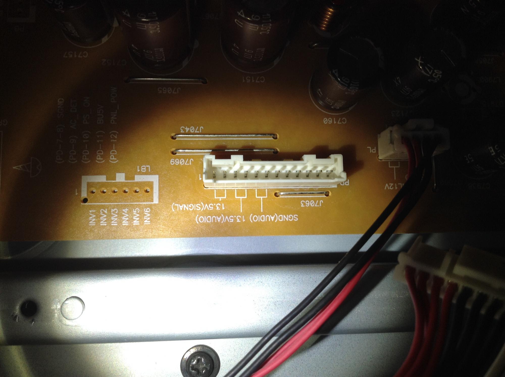

                    Please star a new thread with make and model name, then upload good clear pictures of the whole back side of the TV showing all the boards, the good clear straight shot pictures of the whole Top and Bottom side of the power supply board.
                    Does this board have AC_DETECT pin on the PD connector?

                        I can't sese it a AC_DETECT pin on PD connector but have noticed IC7905 is getting very hot before the tv turns off.
                        Sorry I just noticed auto correct changed board number should be DPS-286AP-1.
                        I seem to have all correct power voltages on the points I have tested until board seems to shut down.
                          #92
                          Re: IC Number on DPS-286 AP/RDENCA336WJQZ Sharp power board
                          The pin listing is right there to the the left of the PD connector.
                          PD-9: AC_DET.
                          You must report the Voltage readings of all the pins, you must put down the pin names and follow by the Voltage readings when TV is OFF and when the power switch is activated so we we can easily see the pattern.

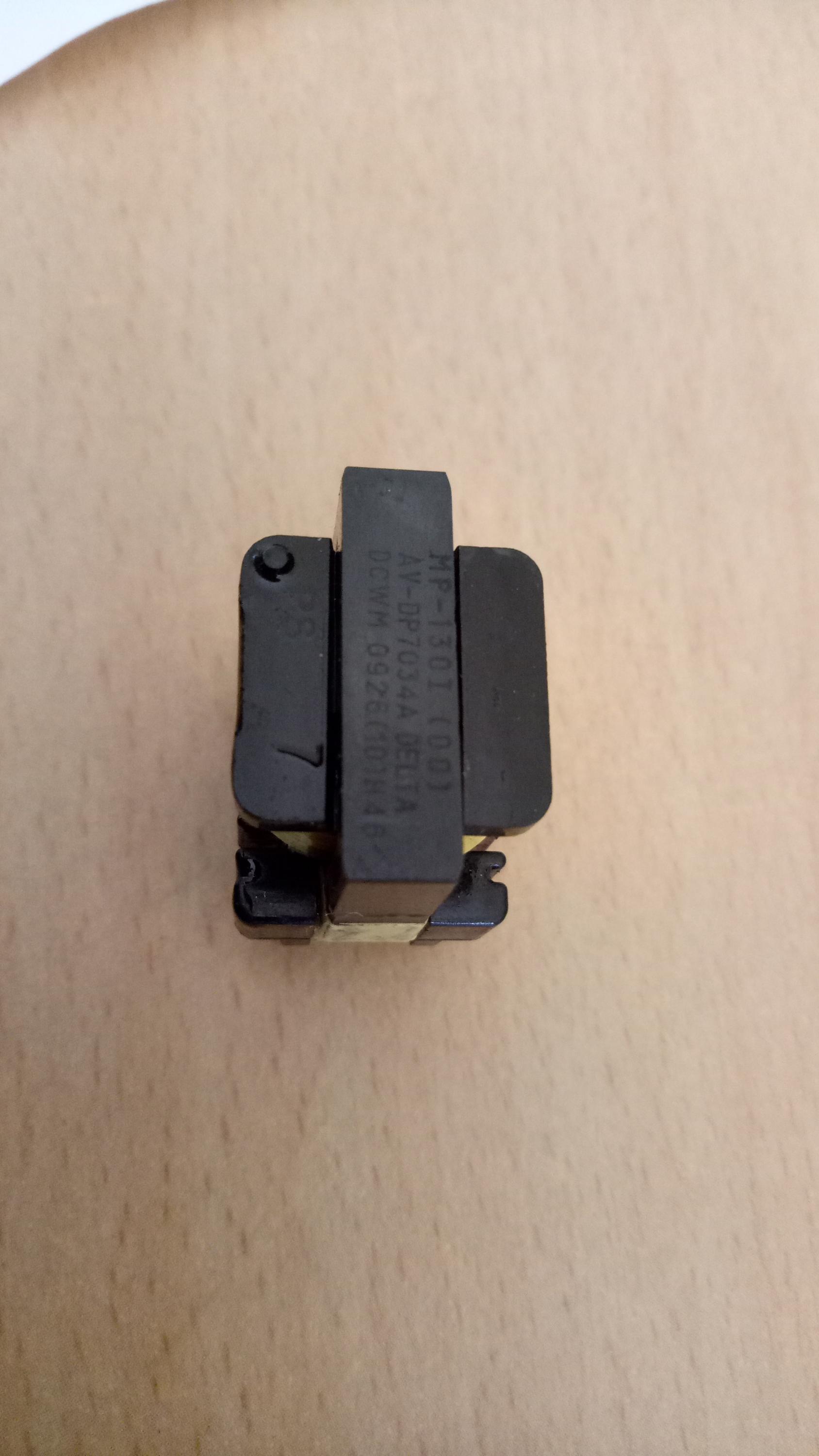

                              Hi Everyone, one noob here and was wondering if someone had a good supplier for components. i'm especially having trouble find a new standby transformer for my DPS-286AP-1 Power Board. Any help would be great.
                                #95
                                Is the transformer broken? in which way?
                                • mojos911
                                  • Aug 2018
                                  • 25
                                  #96
                                  The idiot that I am thought that there might be an inline fuse under the yellow tape and when I investigated this I cut the winding's with my blade. I know rooky mistake I hear you say and yep that's me. I have tried to get another one as I want to try and fix the set. I been doing research on why the standby power is not coming on and when I tested for the 5v output on the transformer there was none even though there was an input voltage of about 317v so I thought that there was a problem with that component. Any suggestions who might sell them, as I have tried Digikey, shopjimmy and a couple of local places hear in OZ but to no avail?
                                    #97
                                    That is going to be tough to find.
