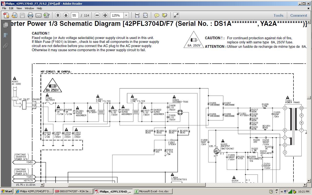

Philips 42PFL3704D/F7 Dead
    Re: Philips 42PFL3704D/F7 Dead
    That should not stop AC from being at the bridge rectifier unless the main fuse is blown, there is/are open trace/traces from the AC input to the Bridge AC pins some where.

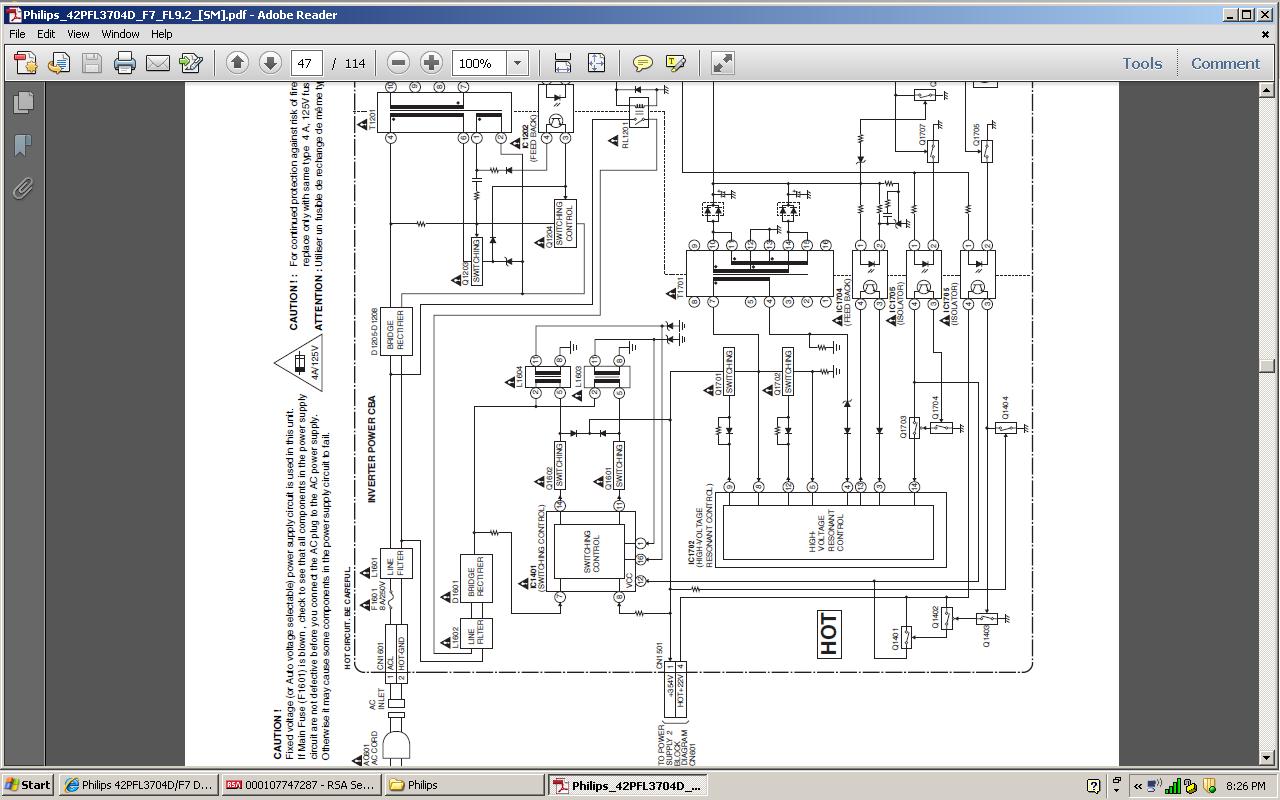

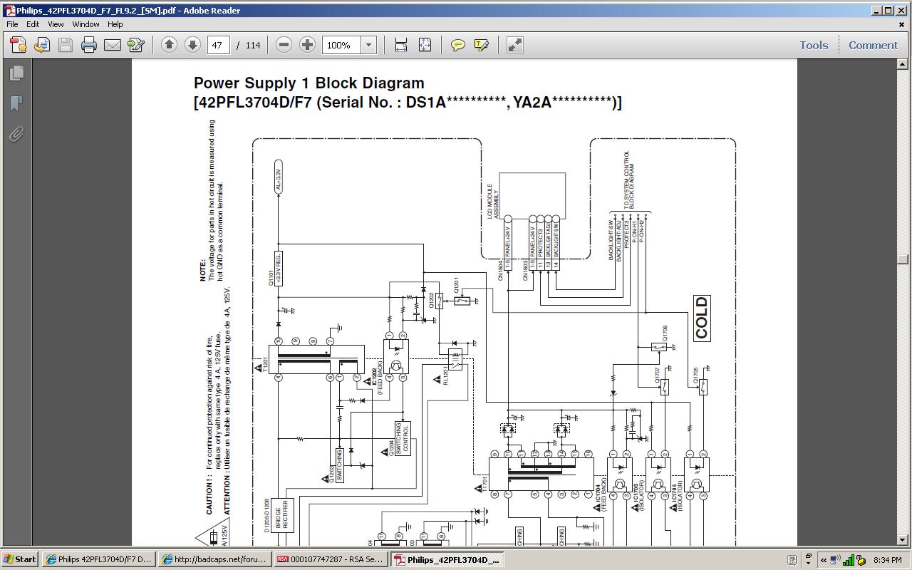

        Will this block diagram help determine where I need to look at?? I'm stuck here, I would go from the fuse to the bridge rectifier normally but something in between here... I see RL1201 sending back to main bridge rectifier but goes to standby circuit first looks like..
          OK, there are more than one bridge rectifier, one has AC fed through the relay for the main power supply which I believe that the shorted out transistors are in or they are in the standby power supply section. The standby power supply is always on, the main board will turn on the relay to run the main power supply instead of using PS_ON to turn on the IC. . So if the standby does not work, the relay will not turn on.
