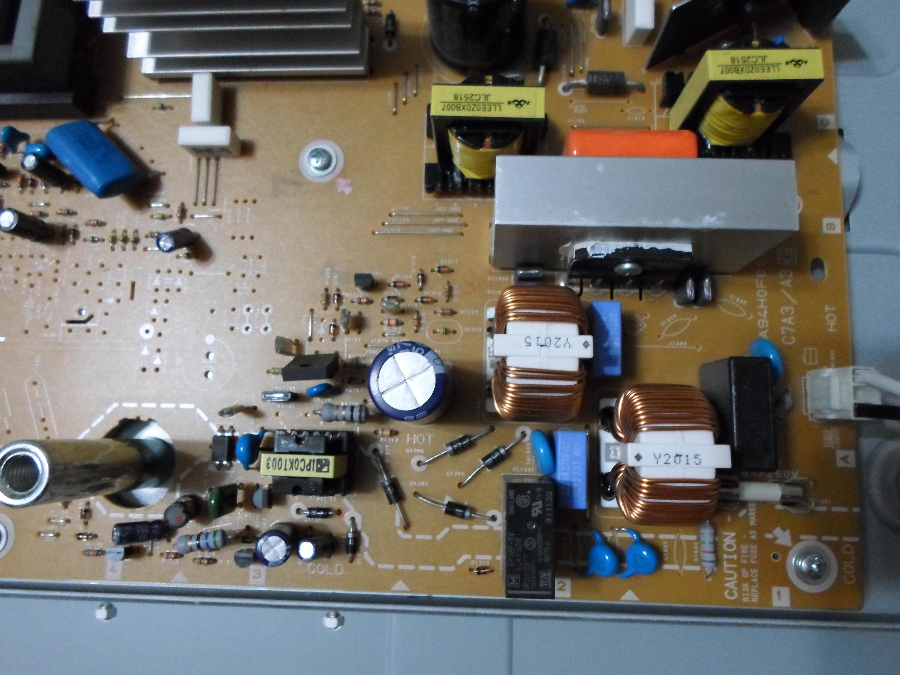

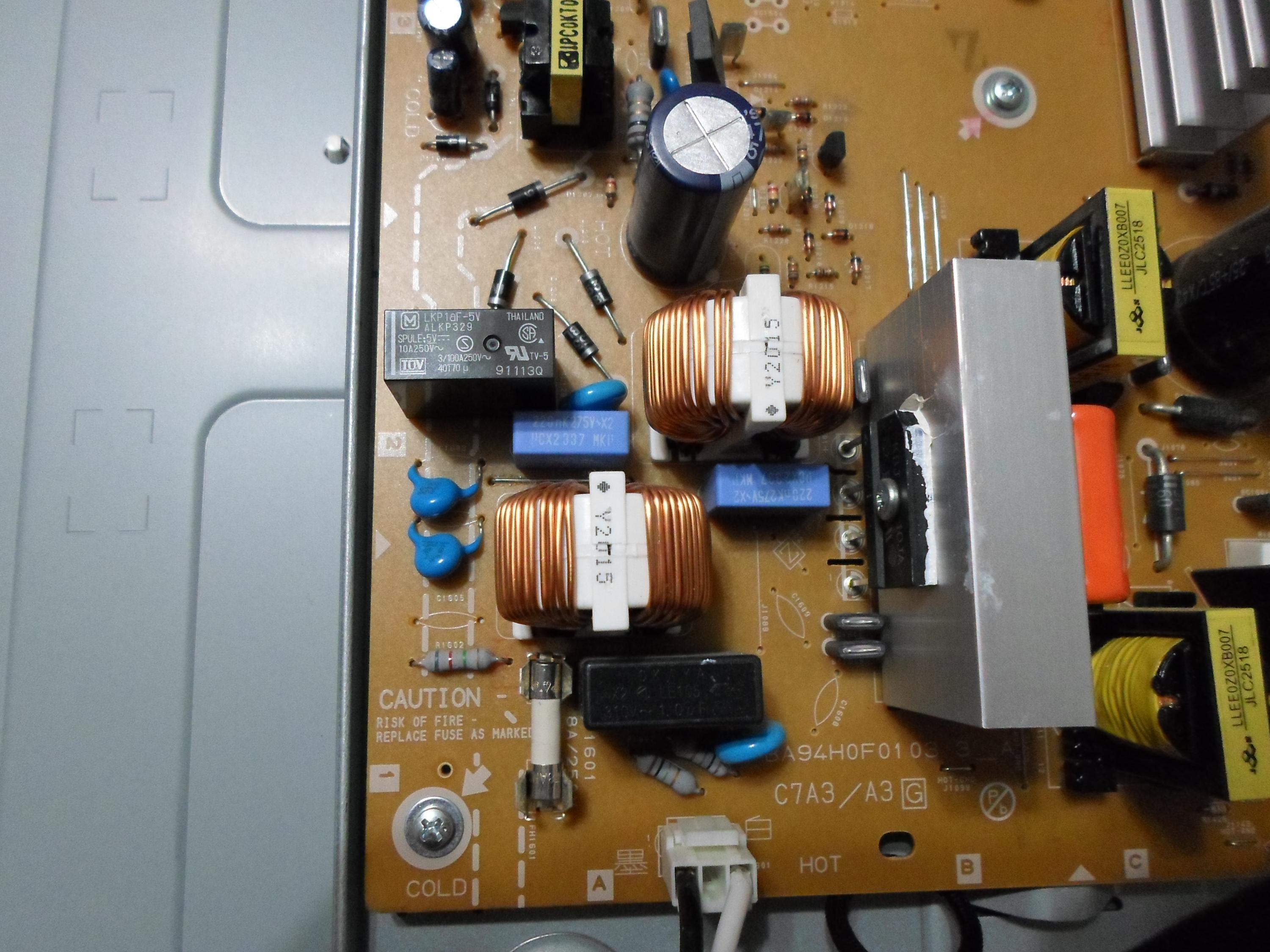

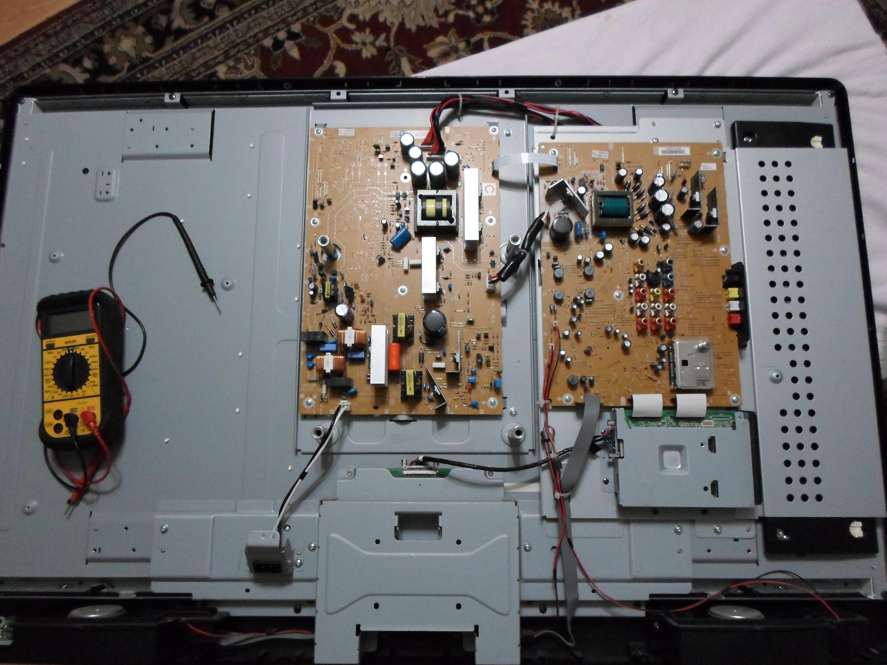

    TV is dead, no standby. Checked main fuse good, and then noticed no AC voltage at bridge rectifier. Checked resistor R1602 left of main fuse and resistance measured 8.37 with meter set to 20M ohms.
    Could it just be the resistor??

    That is an EMI safety resistor (MAINS to EARTH) and should essentially appear open under test, it is not at fault.
    There is a relay on the board, it needs to click in before you see power at the main bridge. Above it there are four diodes -- the standby bridge rectifier implemented using individual diodes. Post a picture of the bottom of this area.
    I assume you have checked the fuse.

      Thanks Tom. Fuse was good. Will pull the board up when I get back home. Also those 4 larger diodes test good right above the EMI..

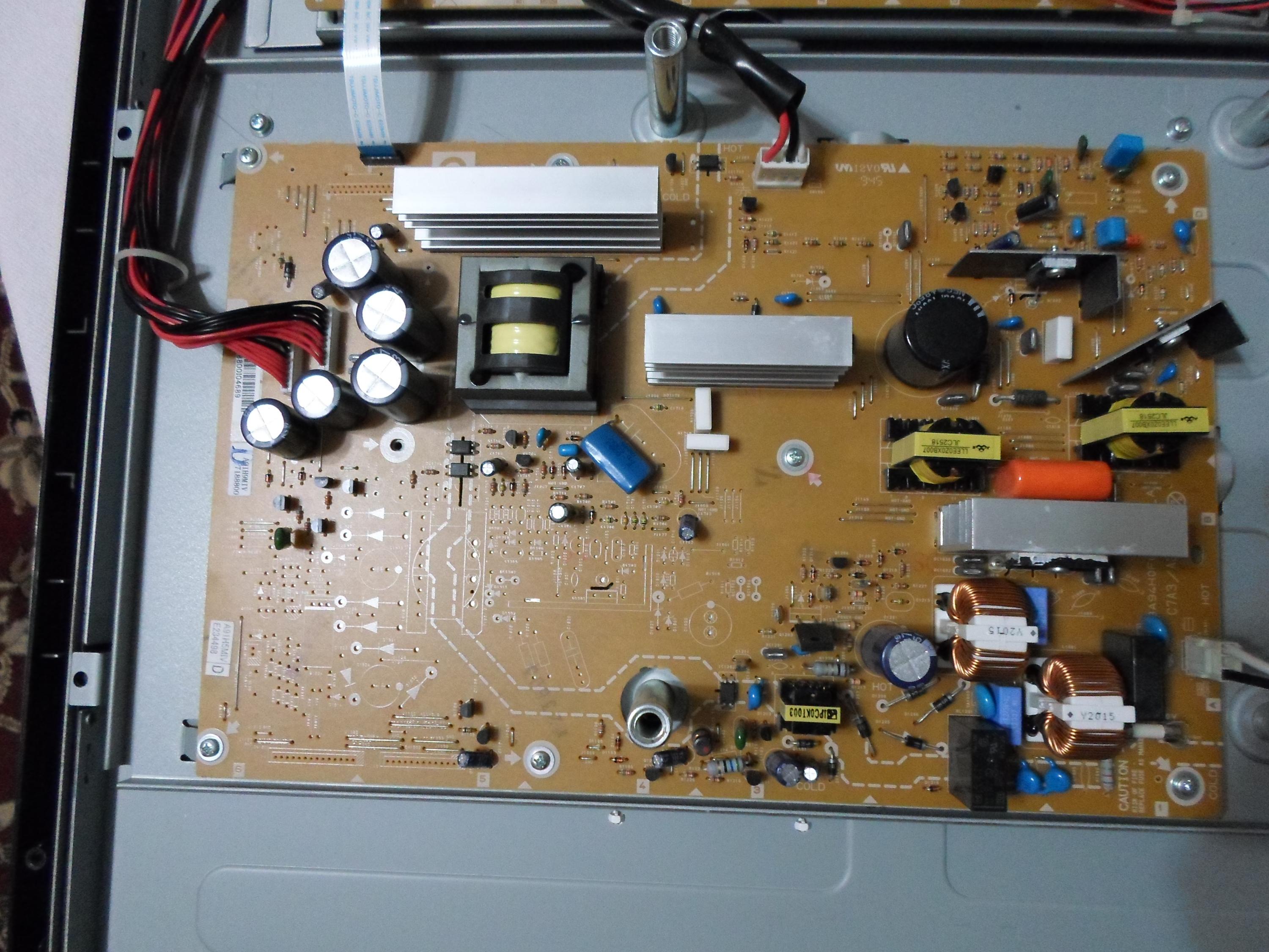

            Ok so Im using the flow sheets in the SM, the diodes 1205-1208 test good. Check Q1203 and Q1204. Q1204 was showing short between all pins in circuit, I removed Q1203 and Q1204, both have about 13ohms between pins 1 and 3 (C-E and G-S). High resistance between other pins.
            Not sure how to tell if these are good with meter..
            Also by removing Q1203 and Q1204 now diodes 1209 1210 and 1211 test good in circuit which didn't before.
            D1212 still does not I need to lift a leg on that one.
            (Lifted leg D1212 tests good)

                                    Replaced the 2 transistors, still dead. Still no AC at bridge rectifier. This problem should be localized to the standby circuit correct?
                                      Re: Philips 42PFL3704D/F7 Dead
                                      "Still no AC at bridge rectifier" The bridge is fed through the fuse F1601.
                                        Fuse is good, all diodes in area are good.. Im gonna check all the resistor values later. The 2 transistors were bad maybe something else close by shorted out too..
