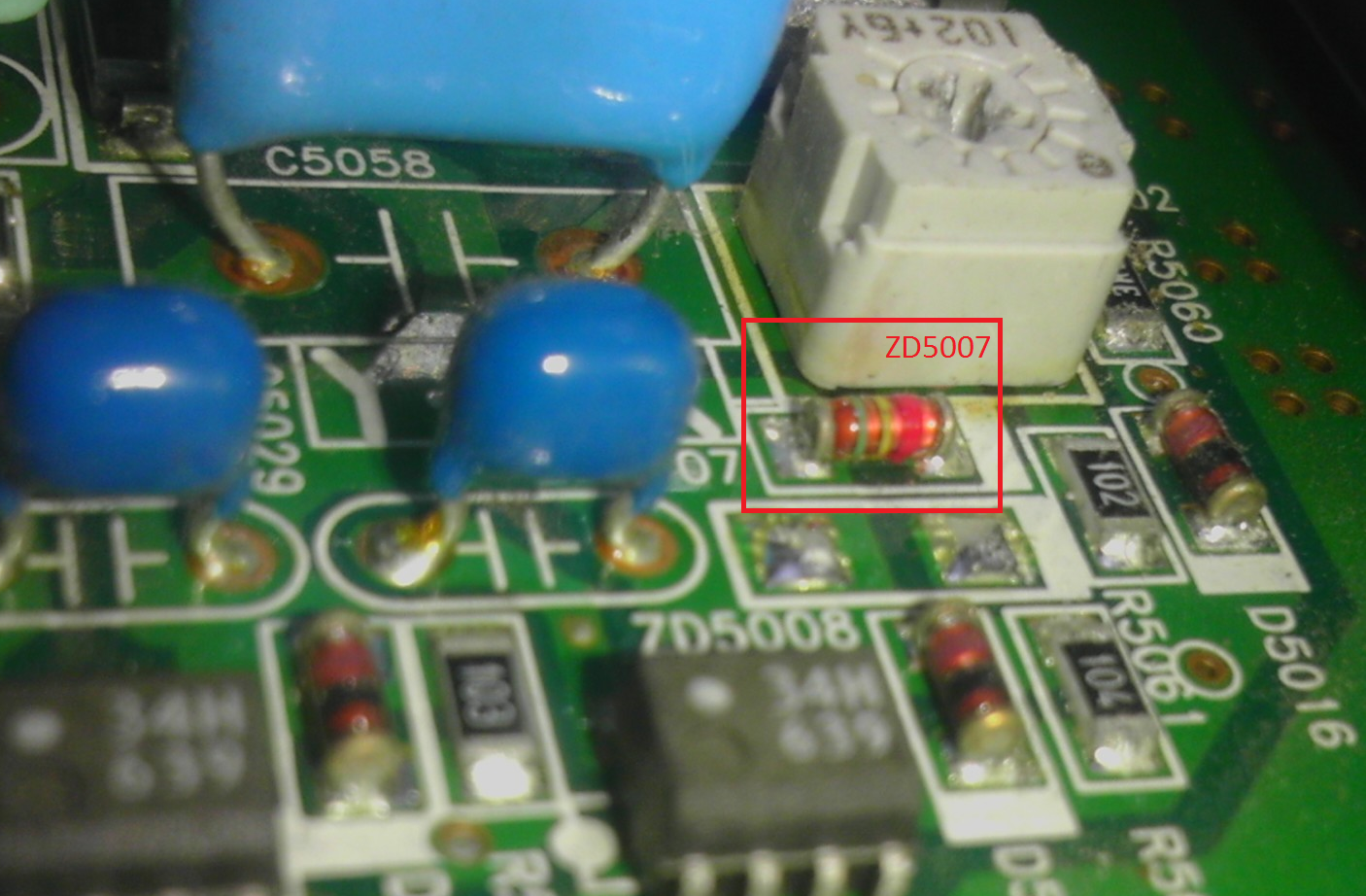

    Well, I broke my plasma thanks to me using a metal screwdriver to adjust a pot (Y-FR), but missed and hit a resistor + grounded heatsink instead. Once that happened I got a big spark. After that the panel had tons of "sparklies", or red/green/blue pixels that flash all over the screen, which looks a bit like static. The colors for the picture are somewhat off and have some vertical banding, which makes me think the panel is now being overdriven.
    The pot that I was attempting to adjust appears to no longer change anything on the screen as it used to, however the other 2 pots on the upper part of the board still function.
    I thought I identified the problem as being a bad MOSFET since doing the diode/resistance measurements on the one closest to the pot versus an identical one on the board near the other pots gave different results, and when the TV was on the heatsink was barely warm while the others are quite hot. So I got a close enough replacement to it, fired it up and not much changed in the picture or the heatsink temp.
    The resistor I hit with the screwdriver is a surface mount '3R0'. I checked the value in-circuit and got a reading of over 4 MegaOhms, which is way off from where it should be. I also disovered a zener diode close by that gives a shorted reading on the multimeter (0.000v). The pot reads the same range as the other ones which are identical, ~0.3ohm to ~1kohm (~ = approximately).
    I have read that testing resistors in circuit may not be reliable, though all of the other surface mount resistors read as they should except for one other that was marked '104', which was also off by a large amount.
    The questions I have so far are:
    1. Is testing resistors in-circuit reliable? What about MOSFETs? What about diodes?
    2. The zener diode has color bands on it, how can I identify what replacement part I need based off that. I tried looking up parts based on the number/letter combo chart I found online but that yielding nothing on mouser.

      Yeah that is exactly what I was doing. That and attempting to get rid of this blue static that appears after ~1hr of use. That was apparently a common fault of this model since others had reported the same thing and said that a fan on the back left of the TV fixed it. A fan did fix it but so did adjusting one pot (forgot which one now).
      Anyway, the part is labeled ZD, while other diodes are labeled D, so I just assumed it was a zener.
      If you could identify it for me I would be very grateful since I am about to order a replacement and would hate to get the wrong part.
      I did find this chart that explained color bands on Zener diodes:
      http://www.marsport.org.uk/smd/sod80.htm
      And this is the closest replacement I could find on Mouser:
      http://www.mouser.com/Search/Product...key512-FLZ18VB

          Assuming it's like a resistor colour code, I read it green yellow red, which means 542, or 54 x 10^2 = 54000. Which would be 54,000V. That is definitely not correct!
          I would suspect the colour code might have a different meaning than what I expect!

                The red band is fattest, so starting from there we get 245. So either a 24.5v zener, or a 2.45v zener. Not sure which, but my guess is a 2.45v zener.

                    Maybe the 5 means 5% tolerance? That would make it only a 2.4v zener

                      Red Yellow green suggests it may be 18volts?

                            I replaced the bad zener diode (18v) and resistor 3R0 (2.2Ohm worked) and it's now working close to what it was before.
                            I unfortunately destroyed one of the pots trying to desolder it to get it out of the way, and lifted a pad, but after surface soldering a new one, it worked out just fine.
                            And I'm not sure if anyone is already aware of this (I wasn't), but a bad resistor can cause other resistors to give false readings. A resistor near by labeled 104 (if I remember correctly) was reading quite a bit lower than it should have. After desoldering, the reading was normal.
