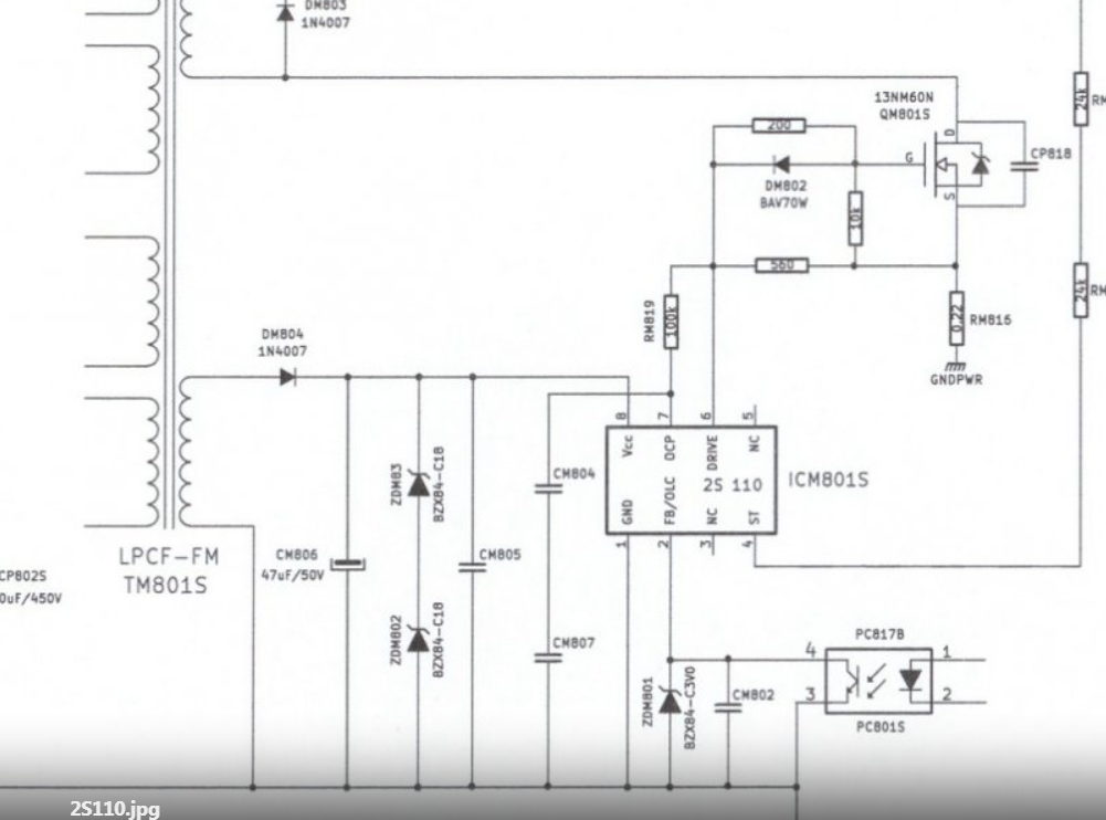

    Samsung BN44-00517C PSU...identifying these zener diodes
    Does anyone know what value these zener diodes are please on a Samsung BN44-00517C PSU board?

    They are usually marked, and their name is determined by this marking.
    • lotas
      • Jan 2016
      • 4830
      • Russia
      ZDM802, ZDM803 - BZX84-C18
      ZDM801 - BZX84-C3V0
      DM802 - BAV70W
      And replace the PC817B optocoupler.
