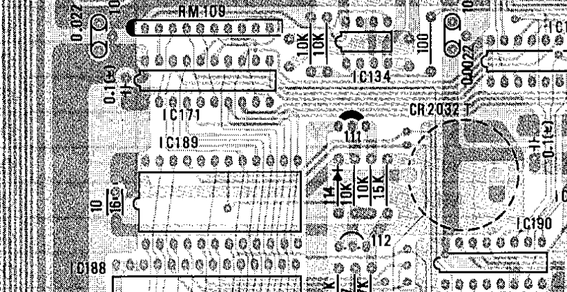

    im actually trying to save a d1500 delay from yamaha. I found the service manual but schematic is missing and BOM list is a bit unclear as components listed have no reference linked to the pcbs... In my case, one zener diode was broken (114 code on the pcb in attached file) and couldn't be repaired : it was a zener type package. In the BOM list i found 3 reference on this board : 1S555 (can be replaced by 1N4148), RD4.7EB2 (approx 5v rectifier), RD7.5EB3 (approx 7v rectifier)...
    Actually the cathode goes to VCC of sram M5M5118P, without this diode missing, i have 4.7V at vcc coming from 2x10k resistors in serie, the cathode being connected to this resistors and VCC of the SRAM... so it's easy to say i ll go for the RD4.7EB2 (5v rectifier)... but why the anode of the diode is connected to the + of the CR2032 3V battery in this case ?

    The 114 diode is likely not a zener diode so it is just a 1N4148, Diode 101,102, 103 and 104 are marked as zener diodes Note diodes are maked with the same identifier even if they are zener or regular diodes, not sure why?

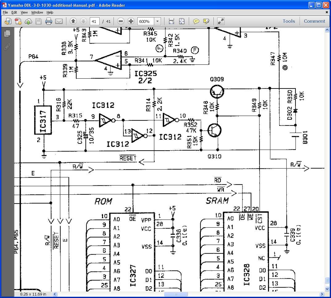

    See the service manual for the ddl-3-d-1030, it has a schematic and may be a similar circuit (see B301 with D302)

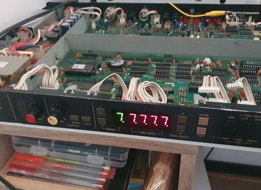

      Hello, i just put a 1N4148 but no improvement. The unit still shows Bank 7 Preset 777 right after i switch the device on without kind of loading process. Power rails look correct. I hope it's not dead. I m going to find out.

        That diode is likely part of the memory circuit for the backup battery, I would check if the reset circuit is working, I suspect it is not. Is the battery ok?
        The schematic I provided looks similar in that circuit ie: diode 114= D302; transistor 111 = Q309; Q112 = Q310 IC181 = IC317 etc.
        Try and figure out which ic is the same as IC312 (reset) It may also be a bad elec. cap like C325(35) in the schematic causing the reset not to happen.

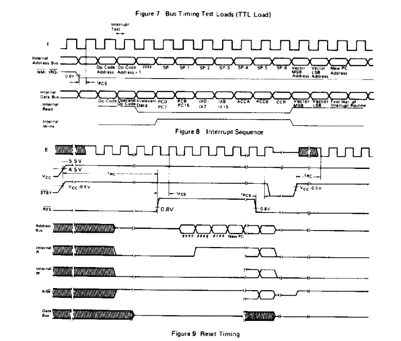

          update : found some infos about the reset state.
          • debidoobs
            • Nov 2022
            • 22
            • France

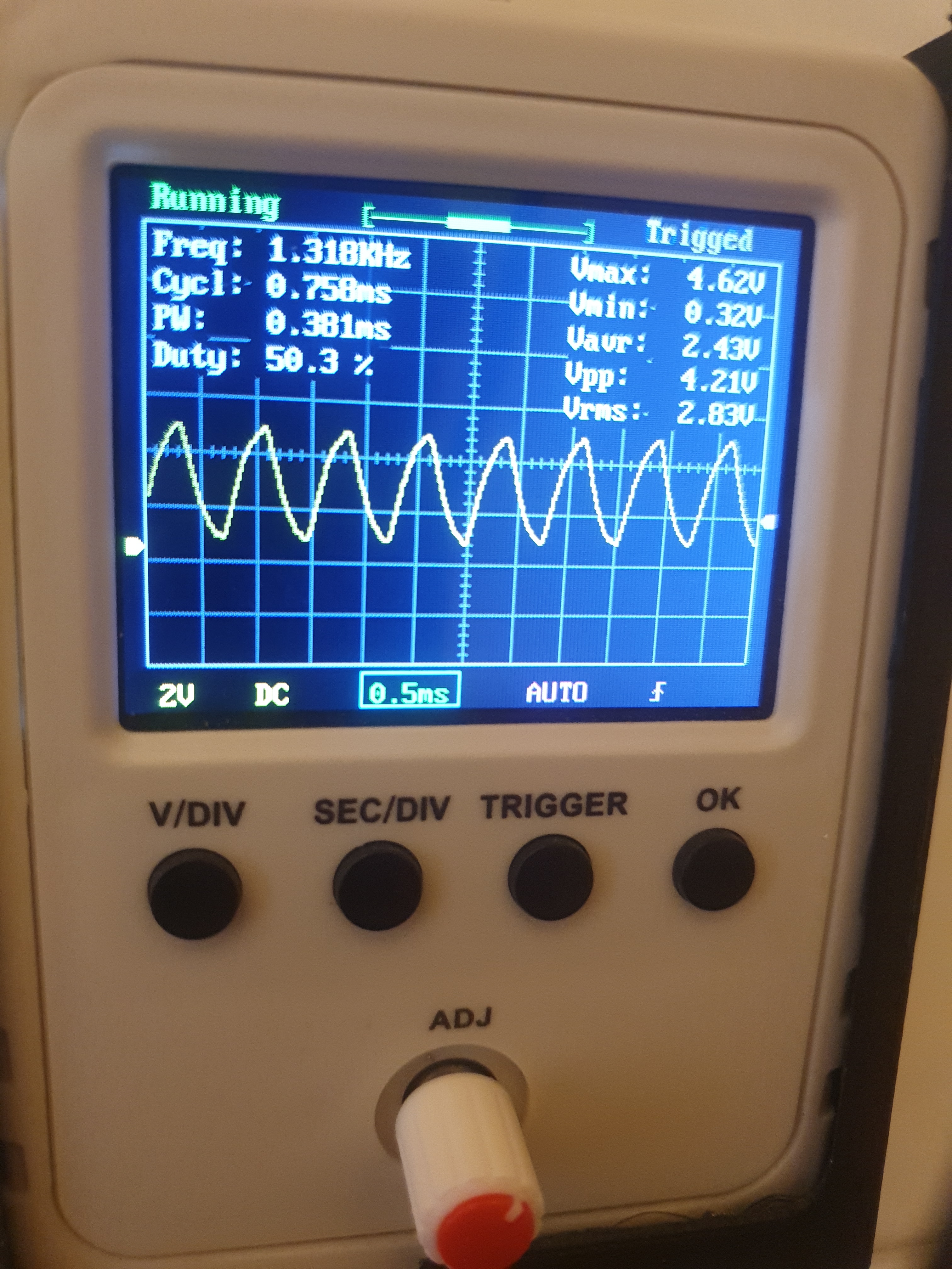

            So i made some measurement, "reset has to be low for 20ms at start up"... the only thing i see at reset pin at start up is a dc signal that goes up to 5v and stays like this, so i guess at start up its stay low enough ? No oscillation between xtal and extal at all.. At the flipflop 74HC74 supposed to send the reset signal, the clock input is a bit weird, i attached the picture.

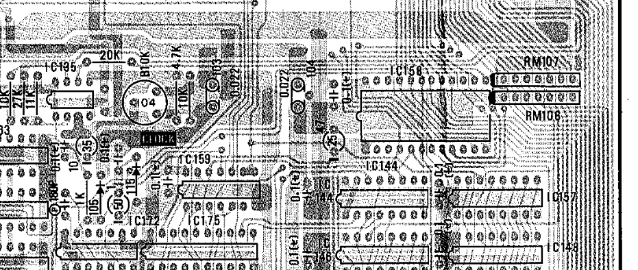

            I also tried to set up the clock adjustement from the manual at pin 3 of the IC173 74HC163, but i only can go to 213khz max then it will go down if i keep turning clockwise with a screwdriver, it 's supposed to be set to 512khz.. It was at 27khz from the beginning !..

              Well don't mind the scope signal i was using x1 probe setting so it's all flat at x10... no clock anywhere.

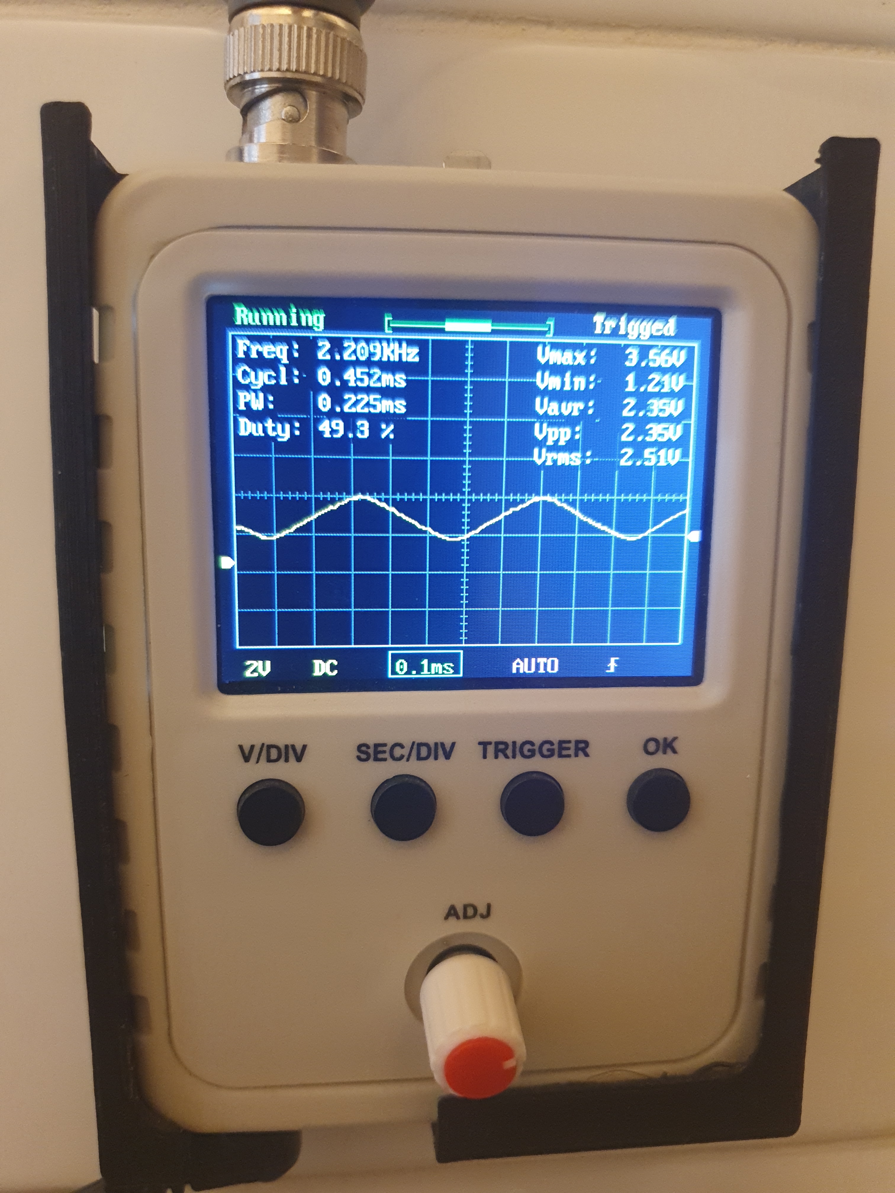

                    One thing is in the manual, they say to set 512khz at pin 3 of IC173 with B10K pot 104, but i only get 215khz at best, it will then decrease if i keep turning left or right the pot. Don't know if it helps.

                            just an update. I found a broken track just under the RAM IC M5M5118p. I was probing pins when at pin 18 CHIP select input S2/, i could hear my injected sine wave but no effect, this pin 18 is supposed to be connected to the front side of the pcb with a metalized vias, this one is located under the M5M51118p and it was broken !.... I made the connection back but it's far from being fixed now. Right part of the front panel is responding now, from "RATE, TIME,... to MIX, INV", leds turn on when switch button is pushed. Rate is also reacting by using increment or decrement switch...
                            I might have other broken tracks so im digging it out.
                            Leds screen does not show 7 777 anymore but it's totally silent now, not showing anything. Vu meter led is working. I have no delay out nor mix signal ouput.
                            I still cannot set the clock adjusting pot V104 as as soon as i reach approx 200khz it falls to 5khz... so i cannot reach the 512khz which is mandatory page 3 of the service manual.
