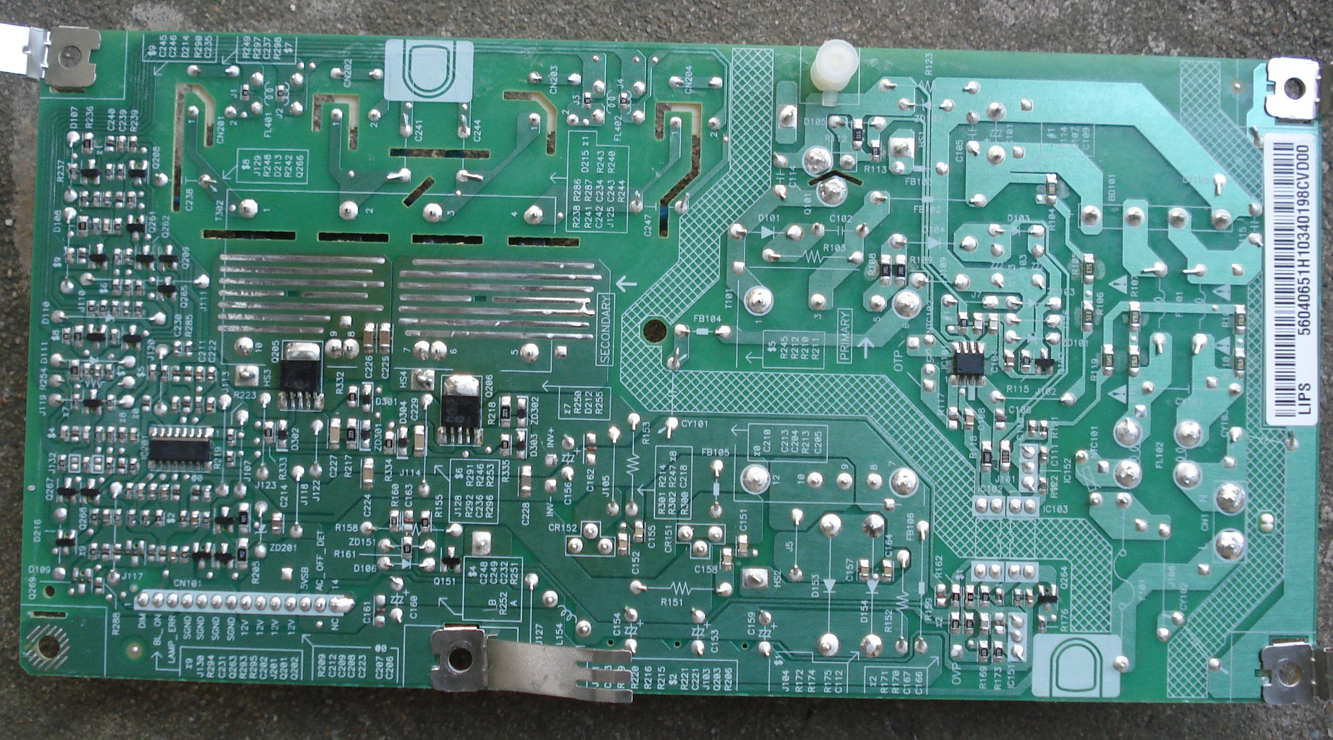

    totally dead. When I push the power button ,nothing happens. No light. No sign of power.

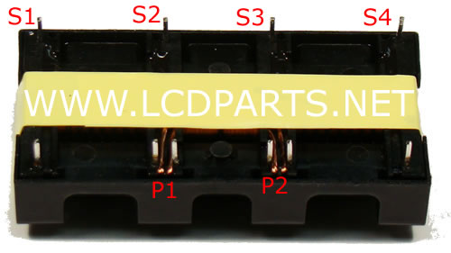

    I checked the fuse on power board. Fuse is ok. I checked the resistance of the transformer pins S1 & S2 =972 Ohm
    S3 & S4 =972 Ohm
    Whoever replies thanks for that.
    Re: Dynex dx-22ld150a11 LCD TV No Power Dead

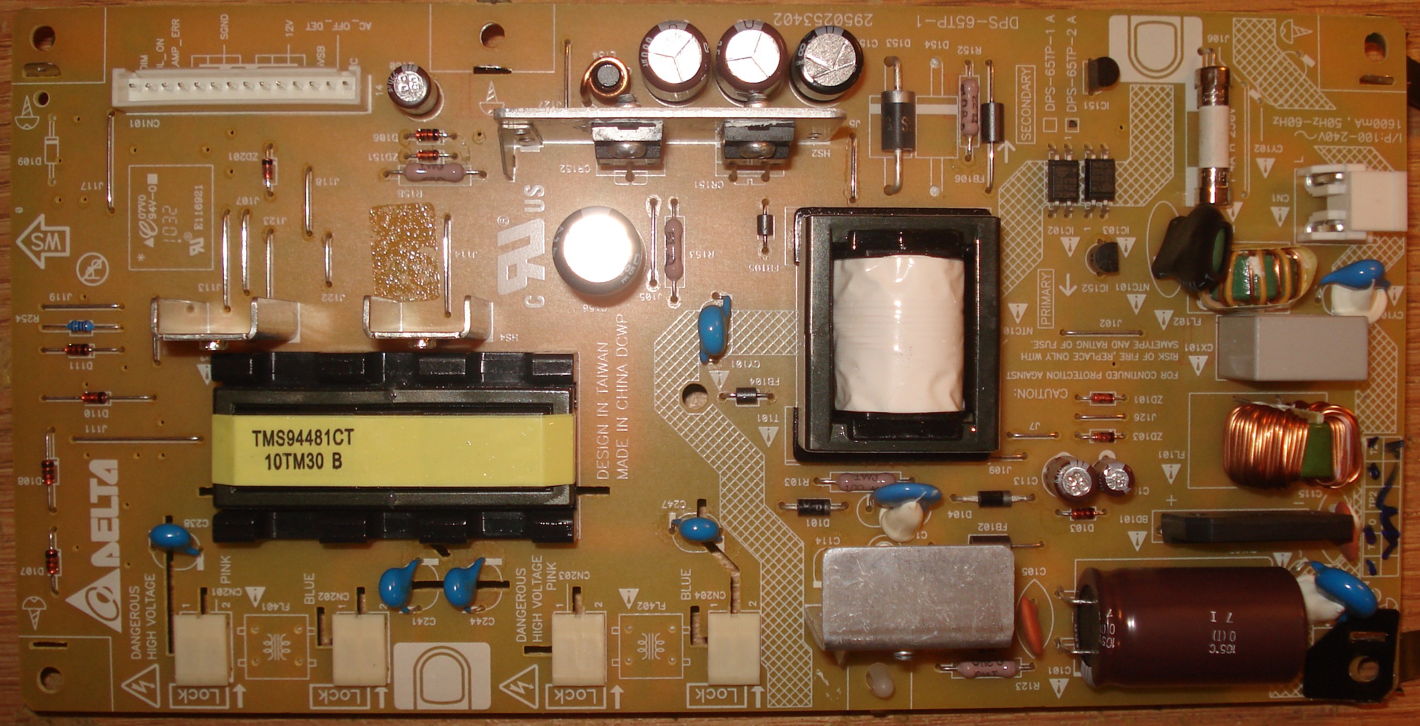

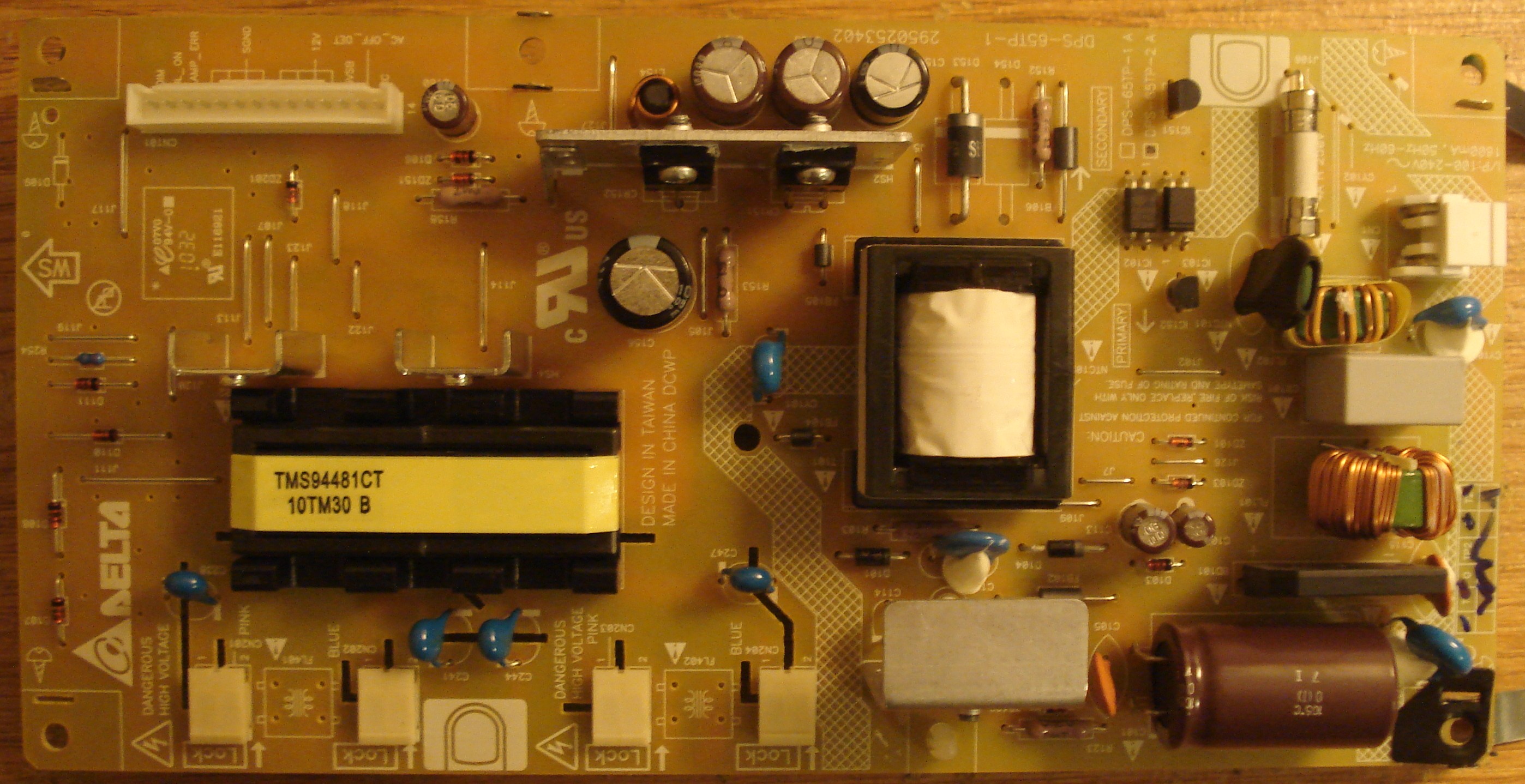

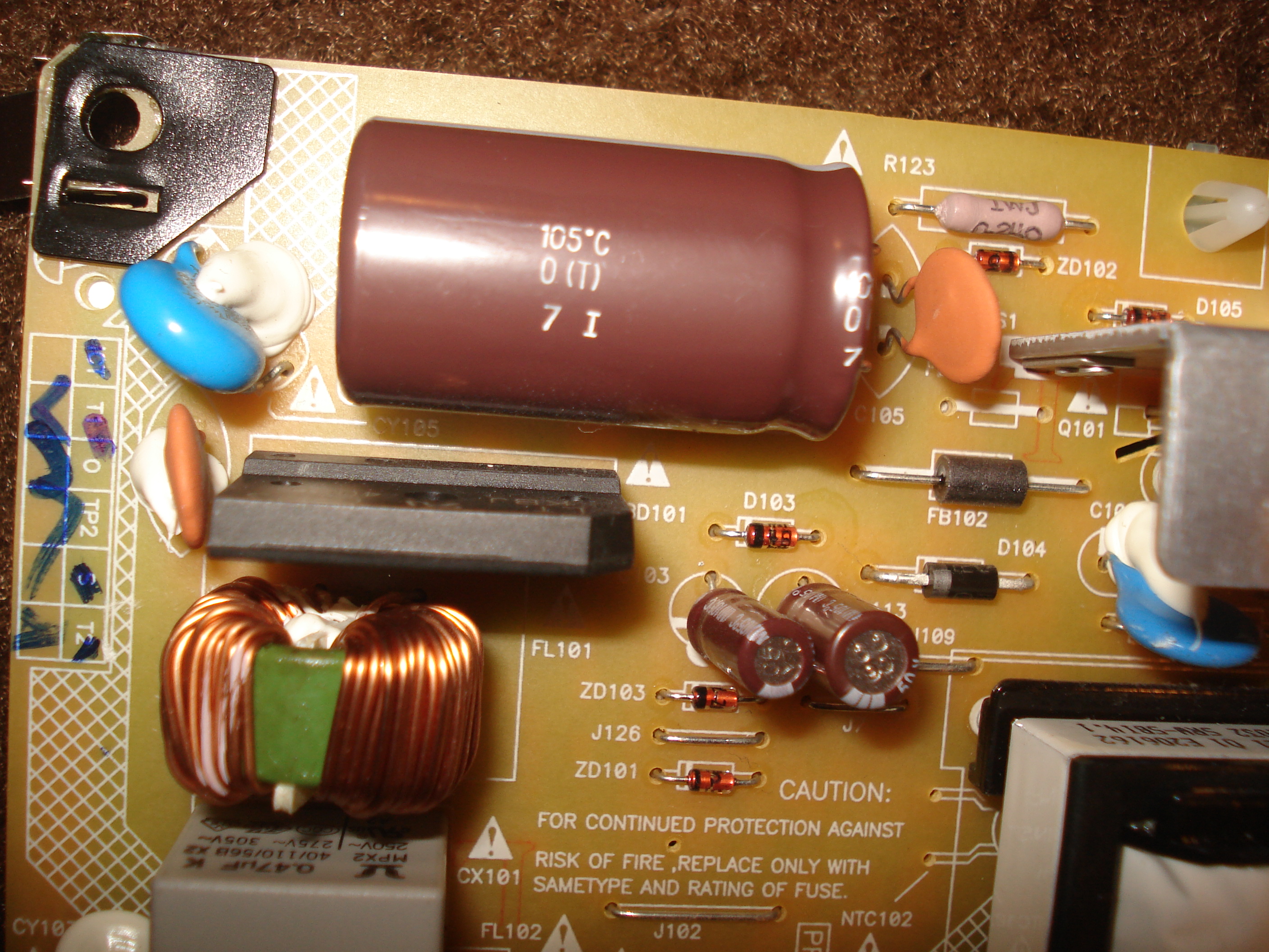

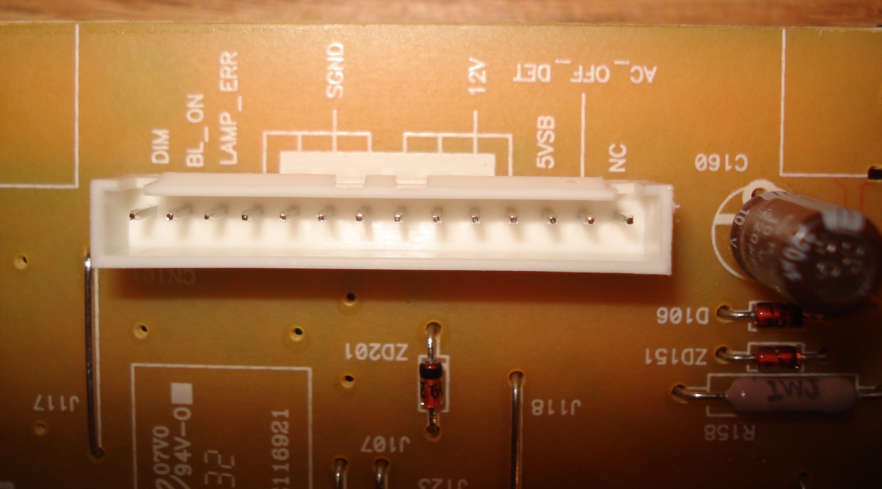

    Do you have about 165vdc on that large brown cap?
    Any 5vstby?

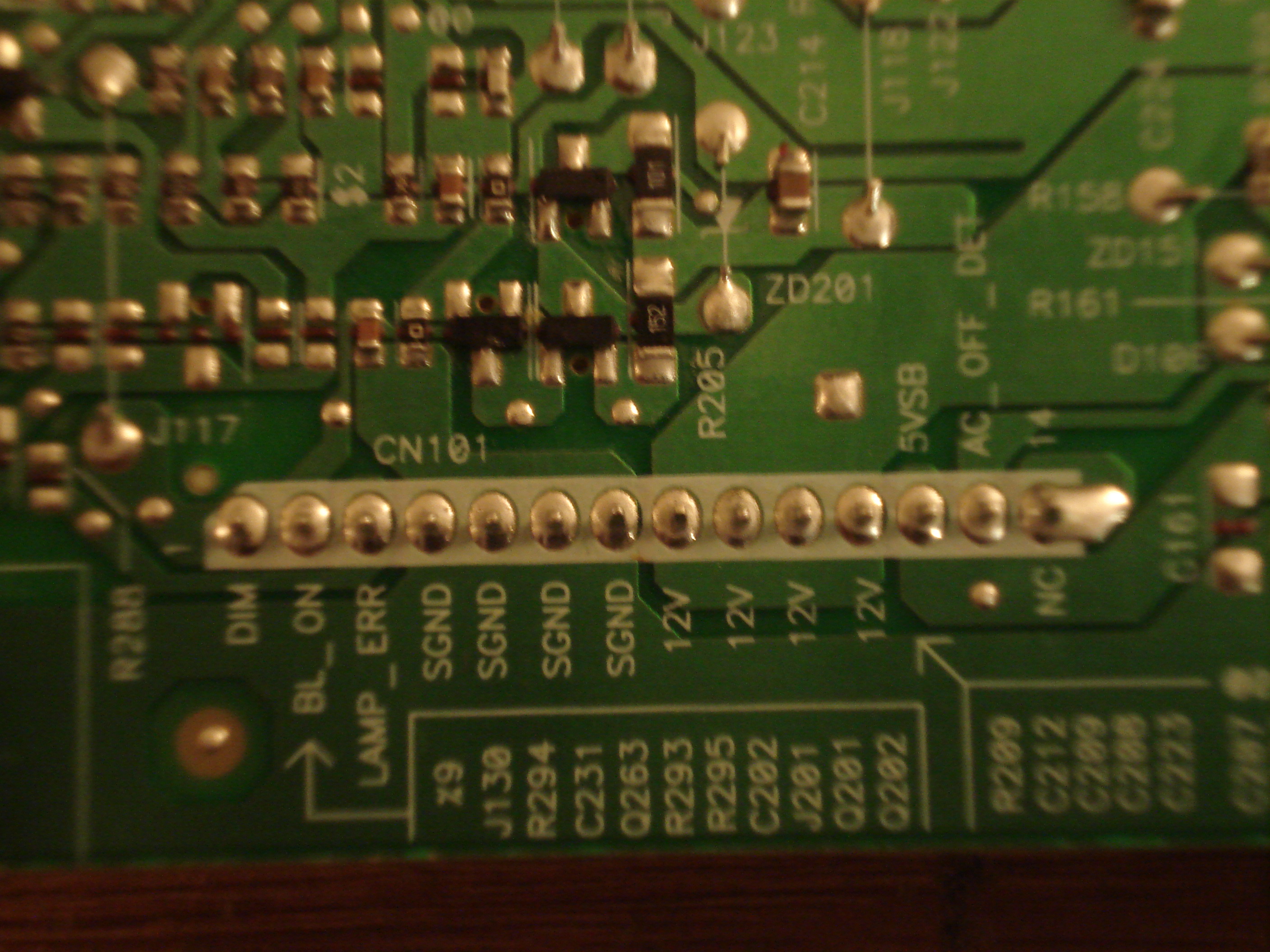

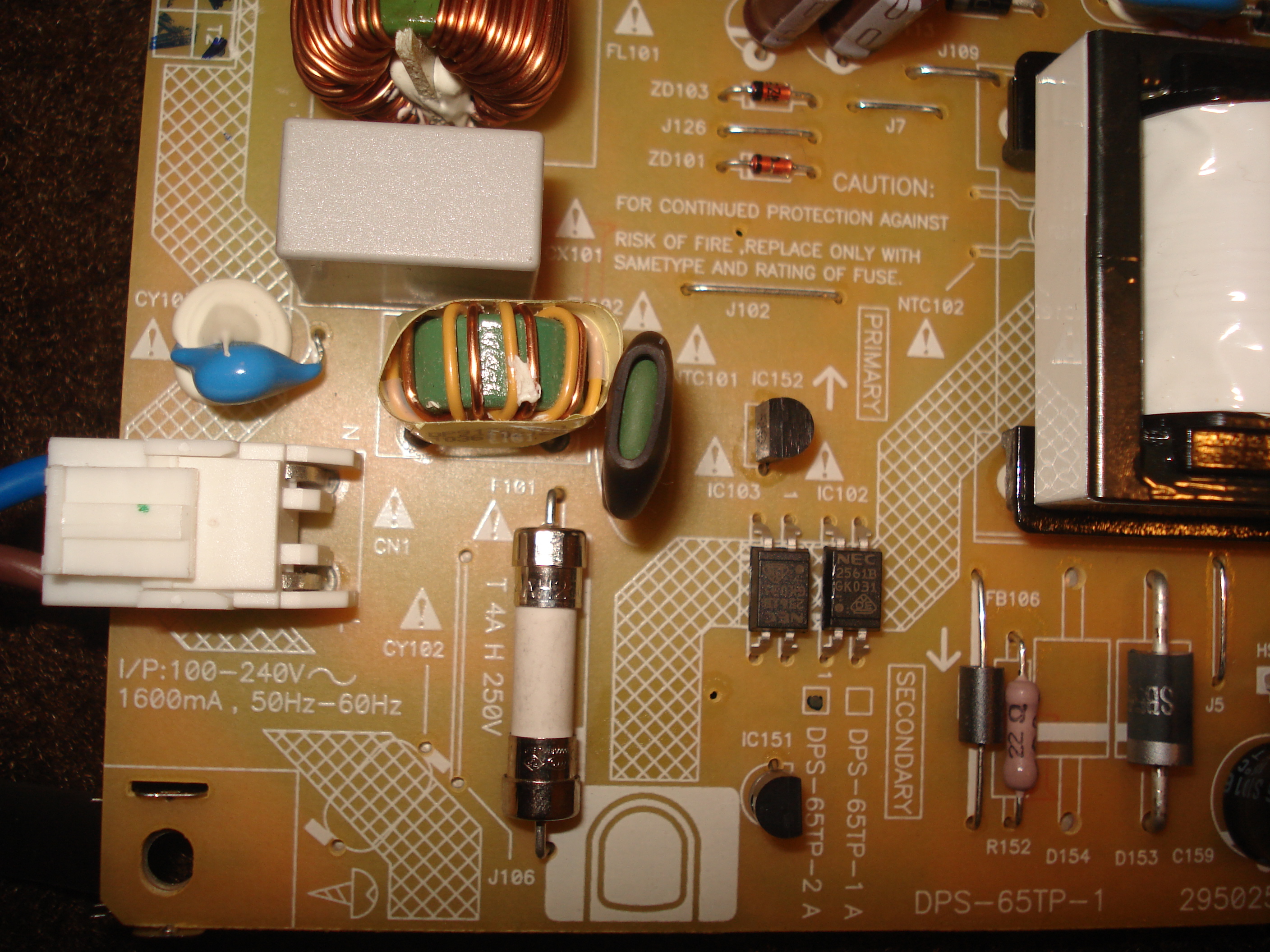

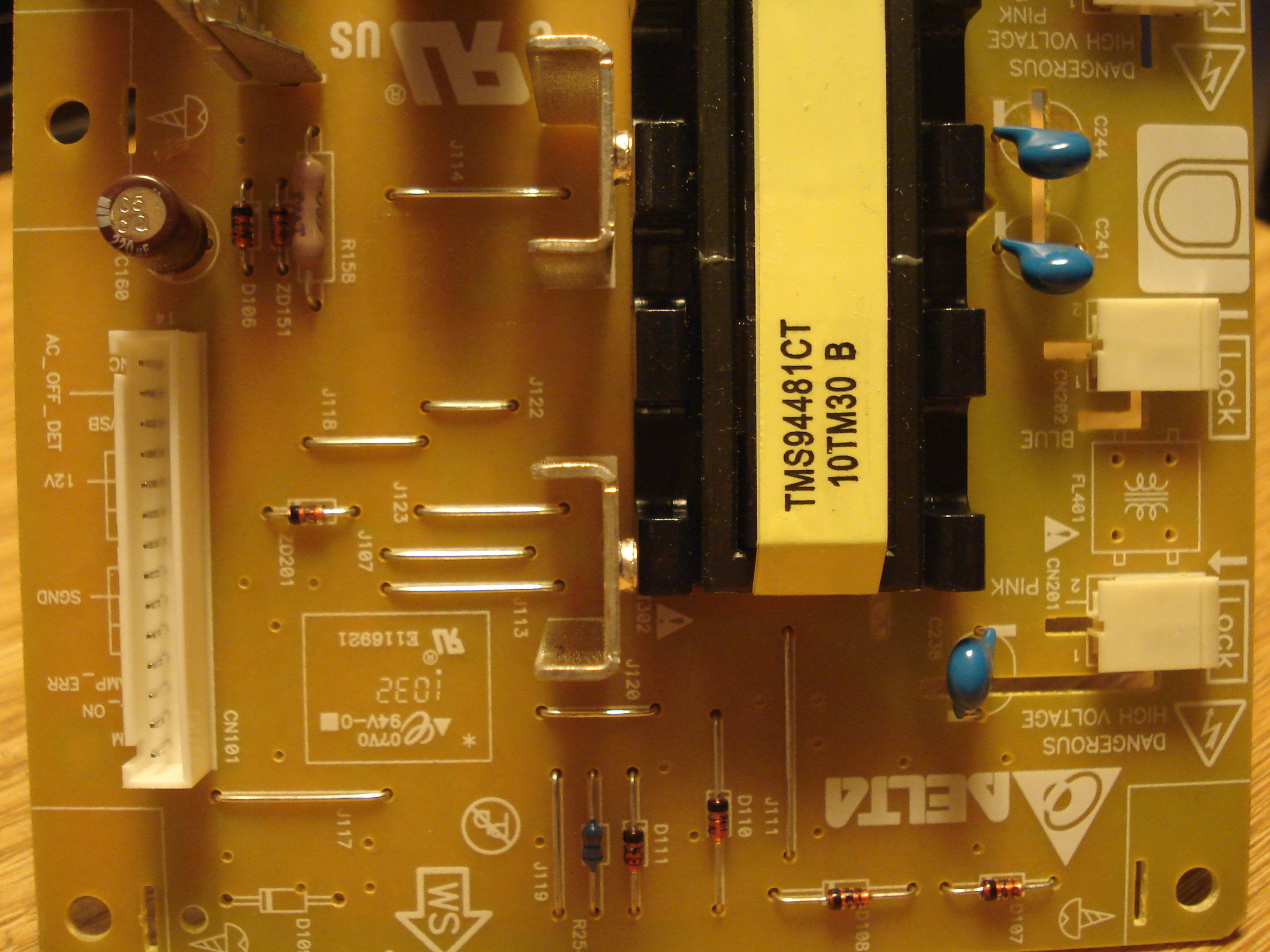

    Also good pictures of this power supply/inverter board both sides and also good closed up in 1/4 section each so I can trace the copper tracks
    • arman960
      • Sep 2012
      • 129
      Any 5vstby?
      I get 172.4 VDC from that big brown caps.

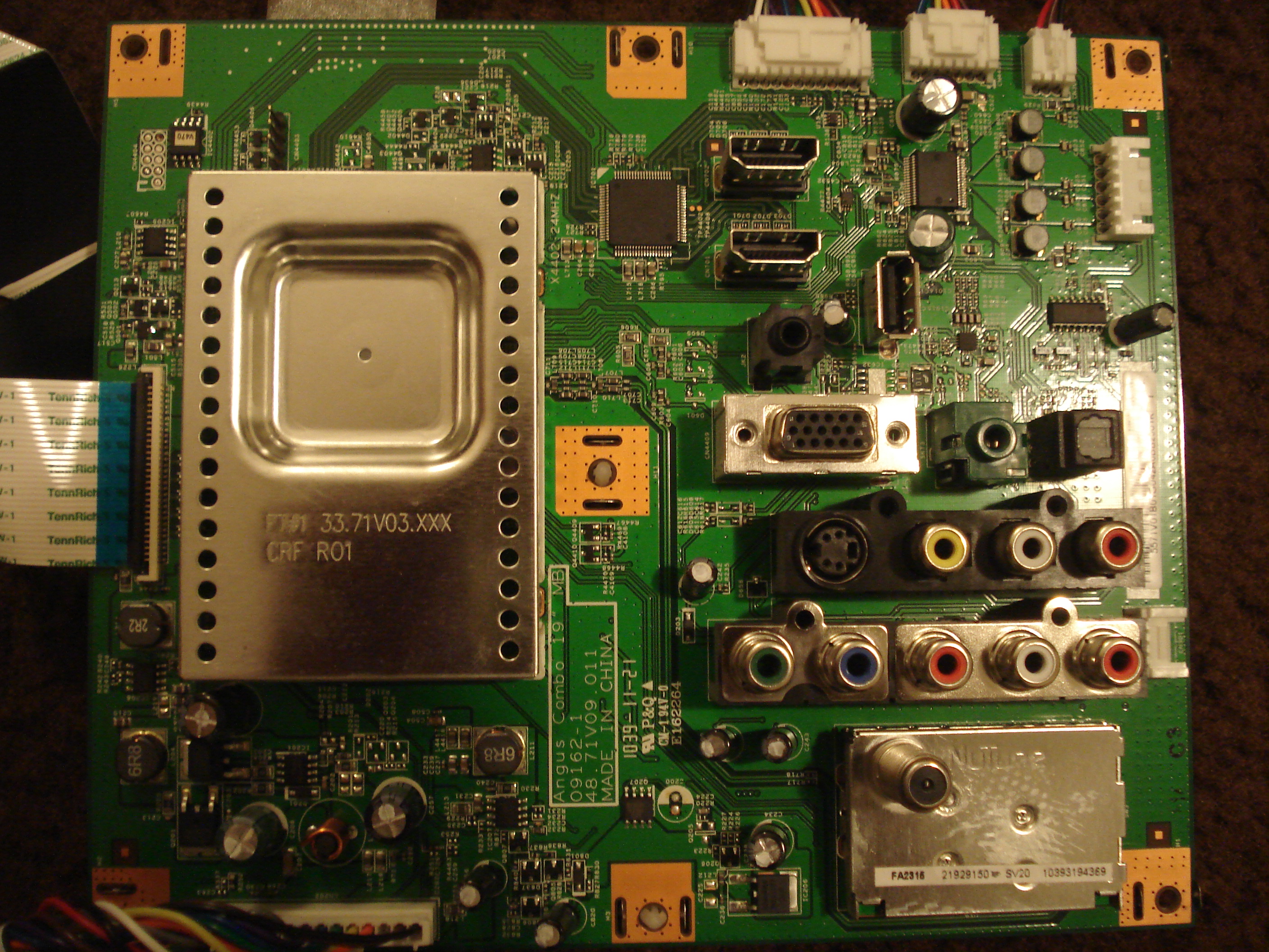

          There is no sound or clicking noise. No LED anywhere. when I push the power button, nothing happens.
          This main board is connected to DVD player. This TV basically has powerboard integrated with Inverter and main board. Basically two boards and dvd player

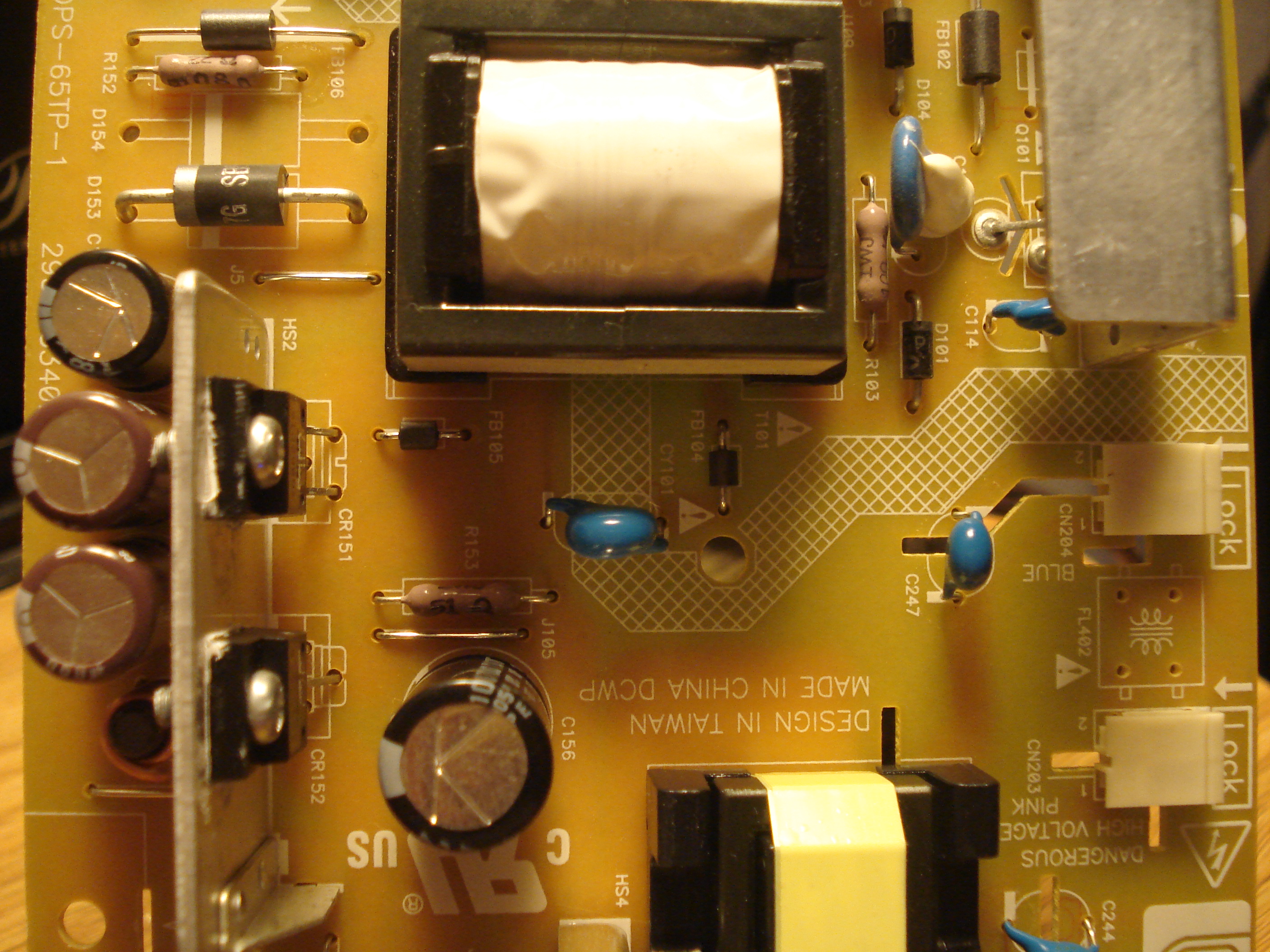

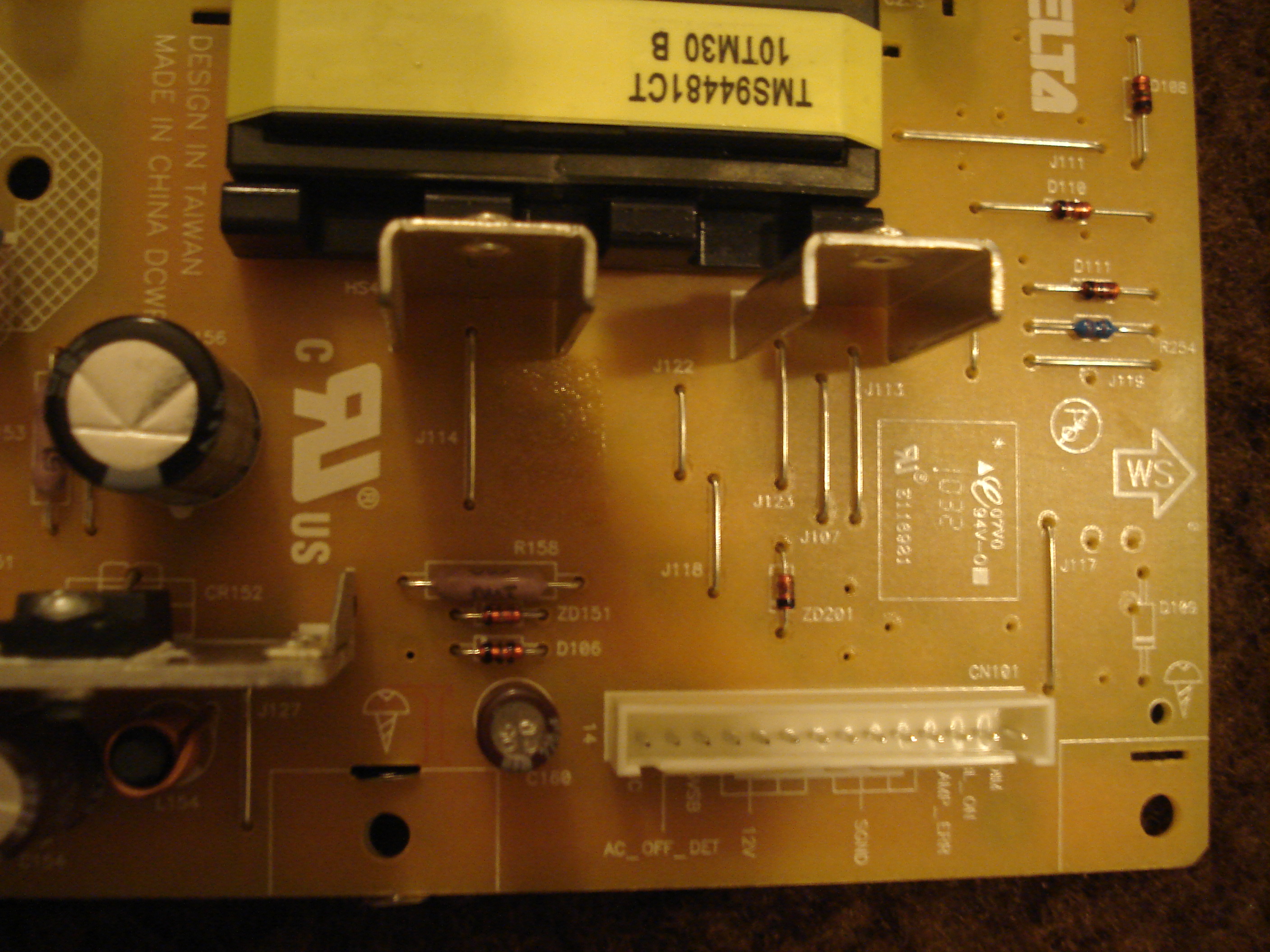

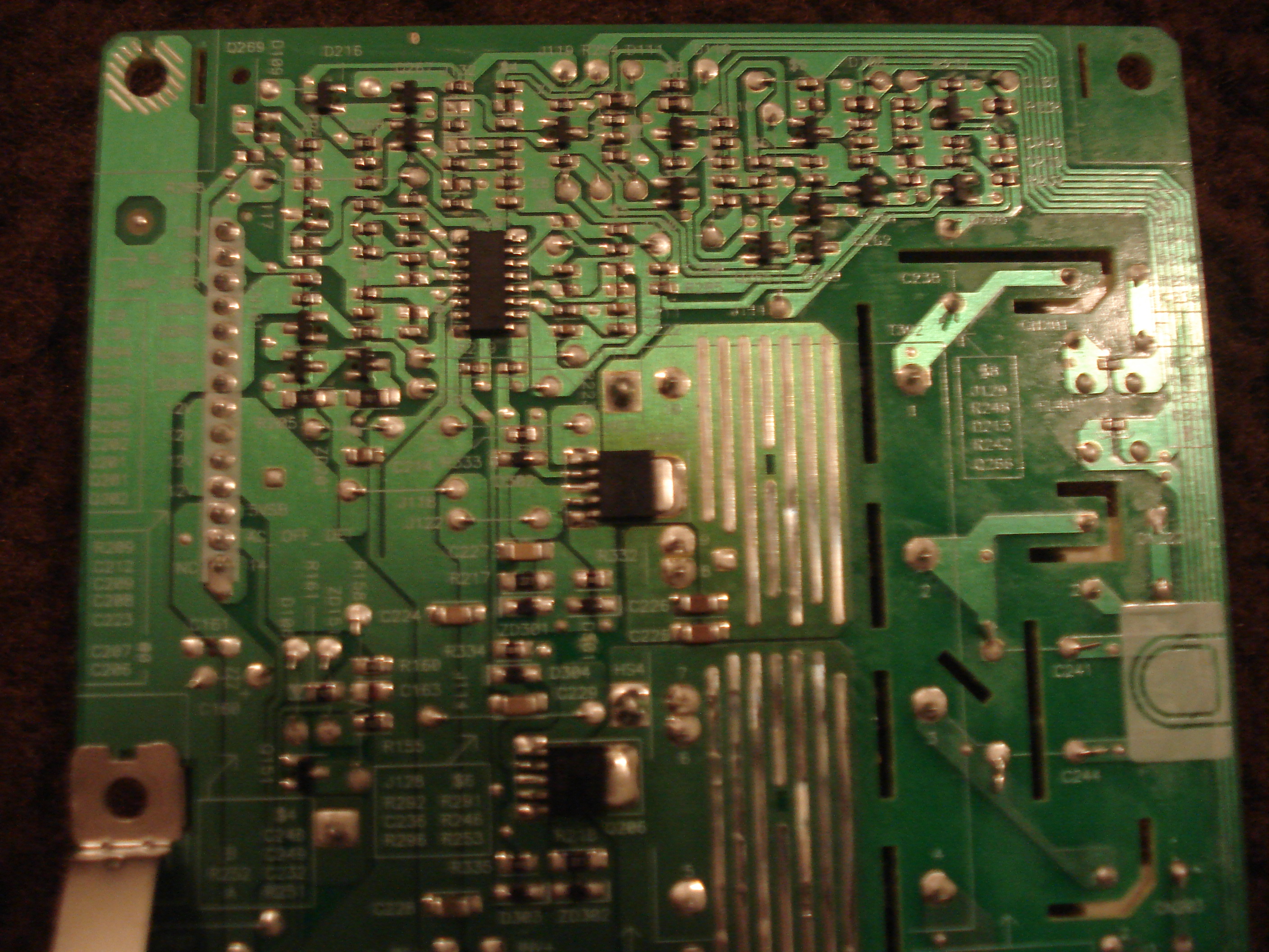

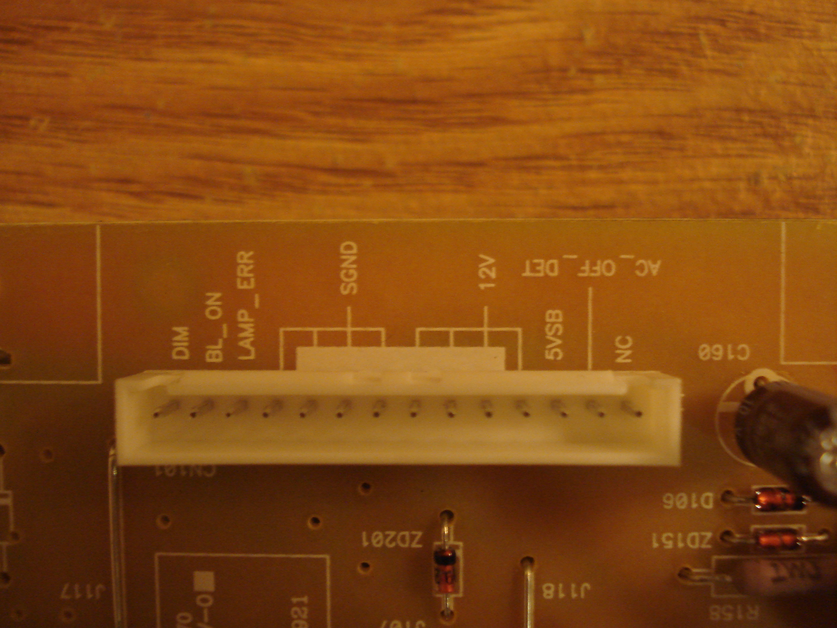

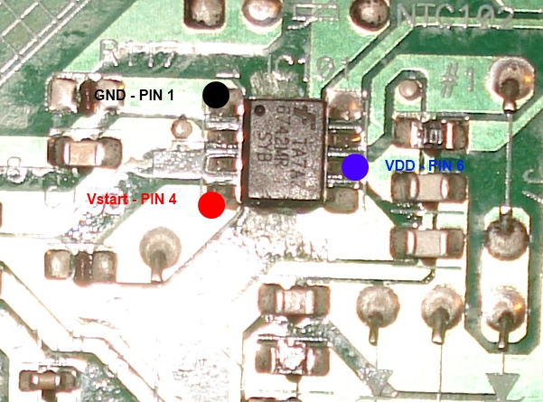

            As you can see in picture #3 in your post #1, see if the you have 5V on that pin (pin #3 from the right).

                It has one section primary and other section secondary.
                The smps IC is an SG6742MR
                Check the voltage:
                1. From GND to pin 4 (Vstart)
                2. From GND to pin 6 (VDD)
                Please report back your findings.
                    VDD is pin 7, not pin 6.
                    The voltage on pin 4 seems low. I would check the components connected to pin 4 and the resistance from pin 4 to ground, but someone else might have a better idea.

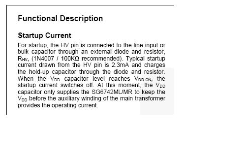

                        When HV is applied to pin 4, the DC voltage at pin7 VDD should start rising, when it reaches the VDD-ON (15.5V), the Gate drive signal will appear at pin8 Gate drive to drive the MOSFET, when the drive happens the DC will be generate by the rectifier diode that is connected to the Aux winding of the standby switching transformer which will keep itself running and the IC will no longer use the HV voltage. Since pin4 is reading only about 8V, that will not be enough to start up the IC. If you look at the app note, the circuits used in your TV will be really close to what is shown.
                        So take the resistance reading at pin4 as suggested by lti, also take the resistance reading at pin 7 also. Check the resistor and cap that supplies the power to pin4 also.
                          I do not have Multimeter to measure capacitance. So I just use multimeter's Mega Ohm to see if the capacitor charging or not. But I can check those capacitor and ressitors that supplies power to pin 4.
                          when you said to measure resistance at pin 4 and 7, did you mean resistance between pin GND and pin 4?

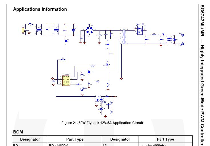

                              Sorry for not being clear:
                              4 and Gnd, 7 and Gnd.
                              Does the app notes circuit match pretty close to your board?
                                Yes the circuit close to the IC looks like this. But I am not good at reading the trace circuit diagram though. The pictures are in Primary power supply section

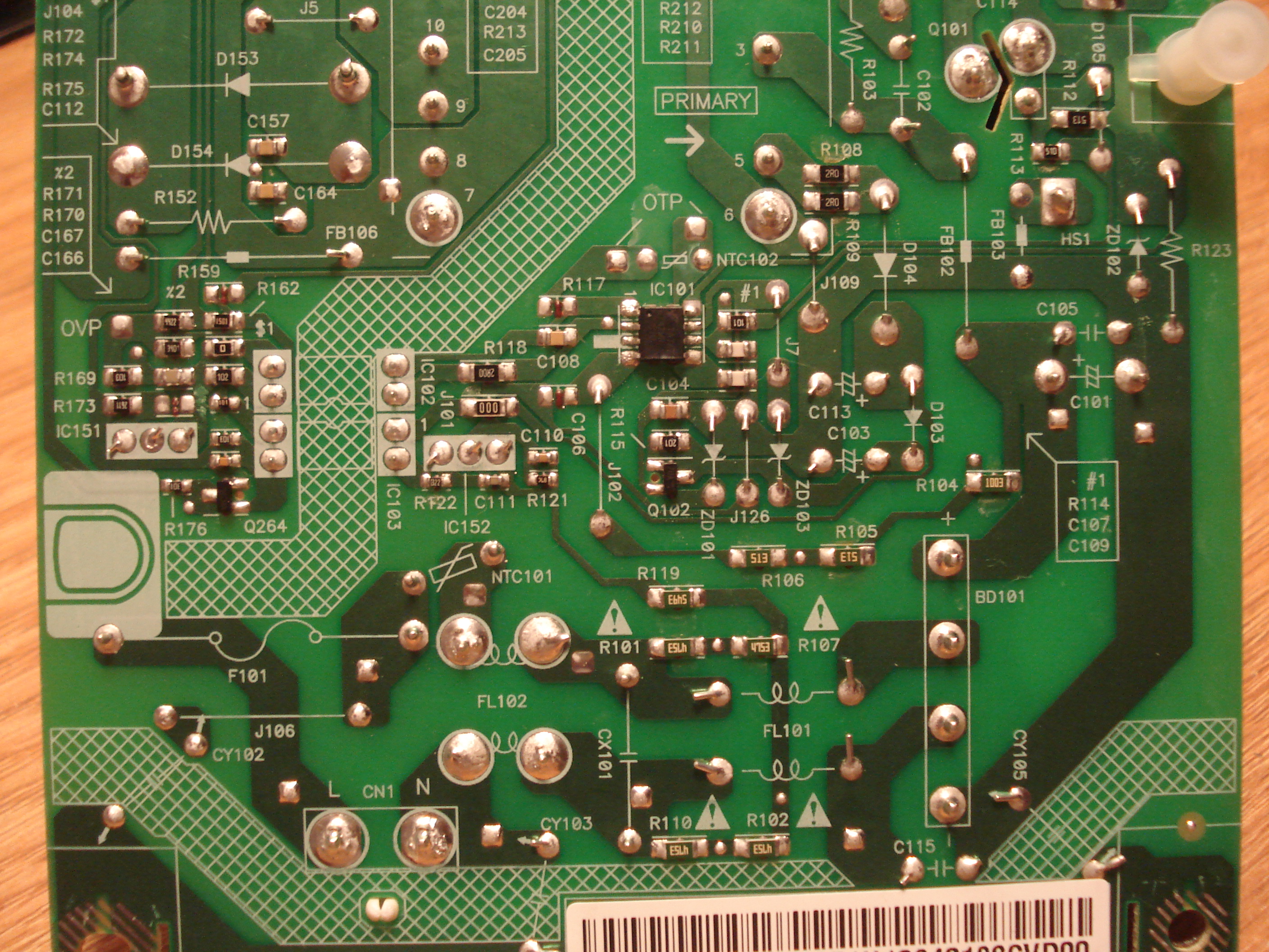

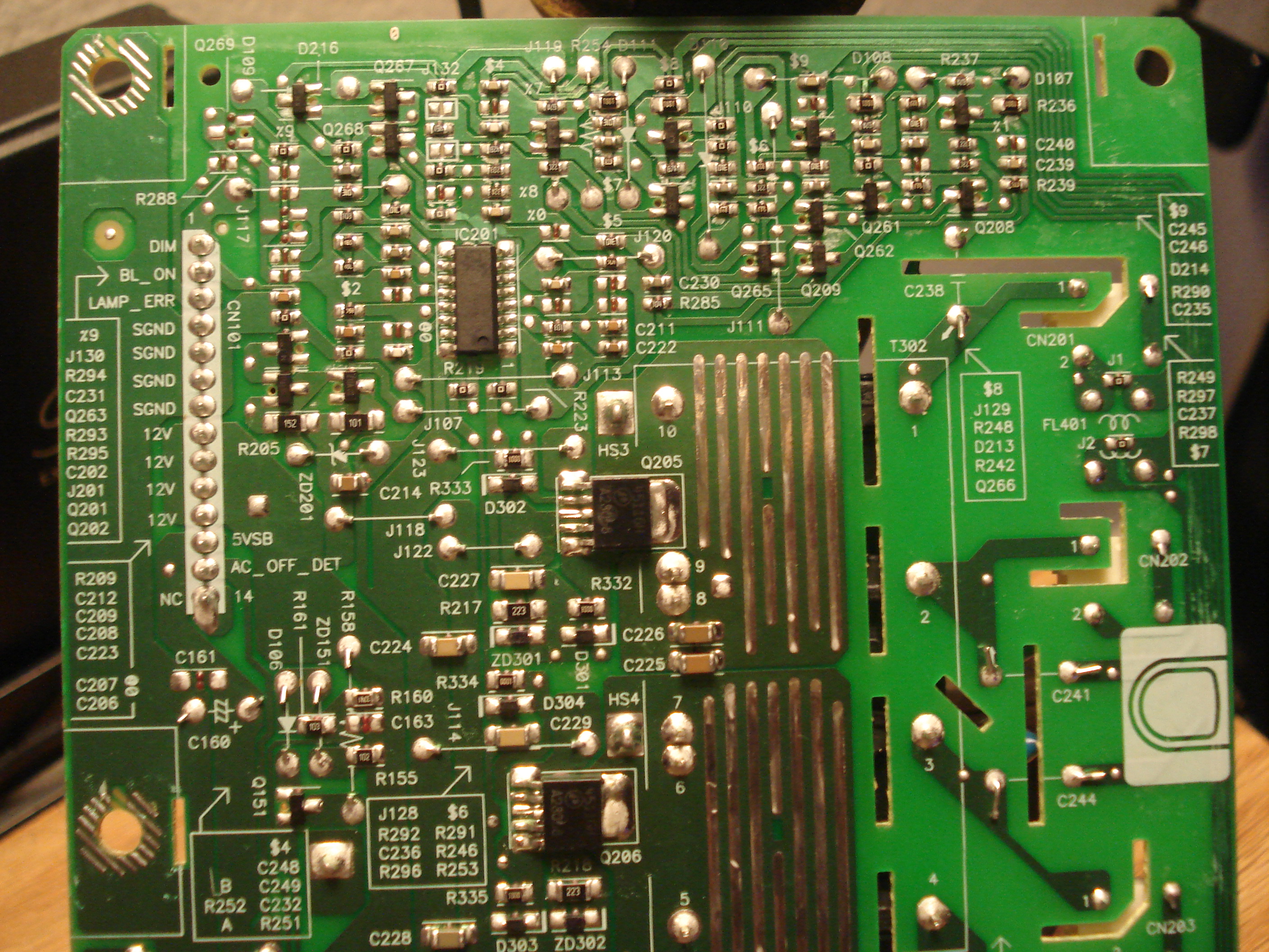

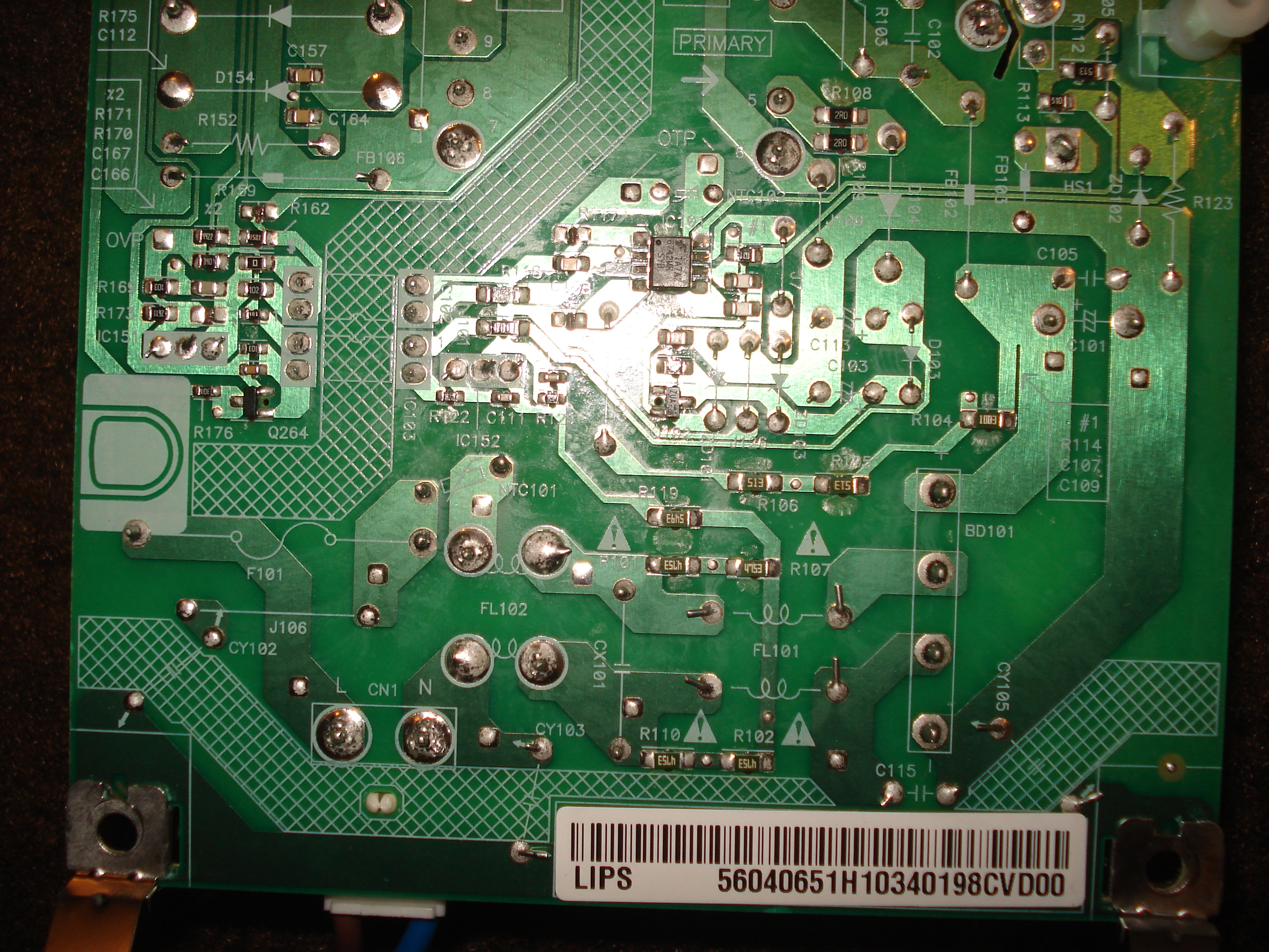

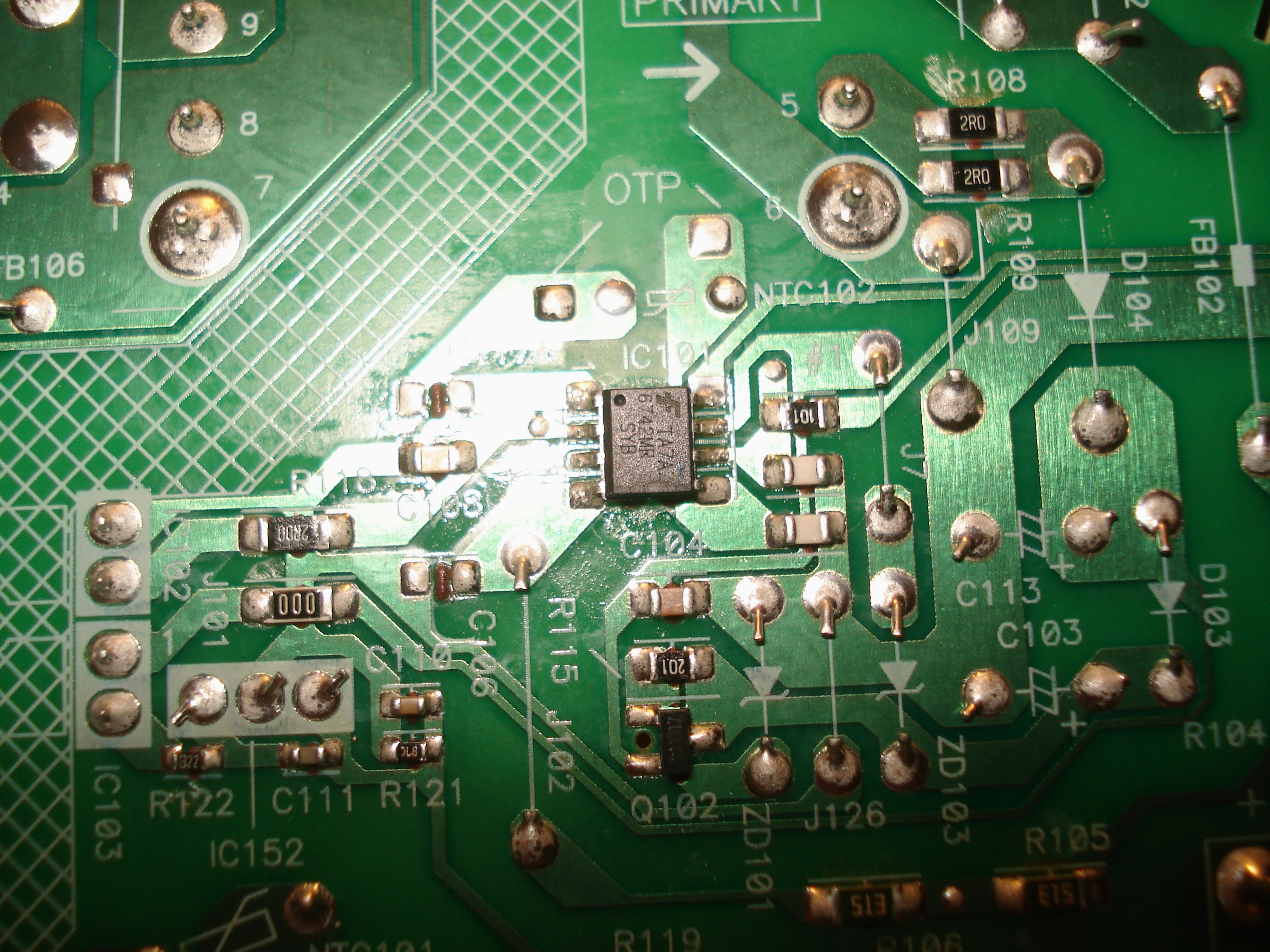

                                  That is NOT normal at all on pin7. You will have to carefully unsolder and lift pin7, then take the reading again.
                                  Can you take good clear pictures of the board in the IC area so I can see how the traces are connected? Pin 7 looks like it is connected to a jumper wire.
                                  • arman960
                                    • Sep 2012
                                    • 129

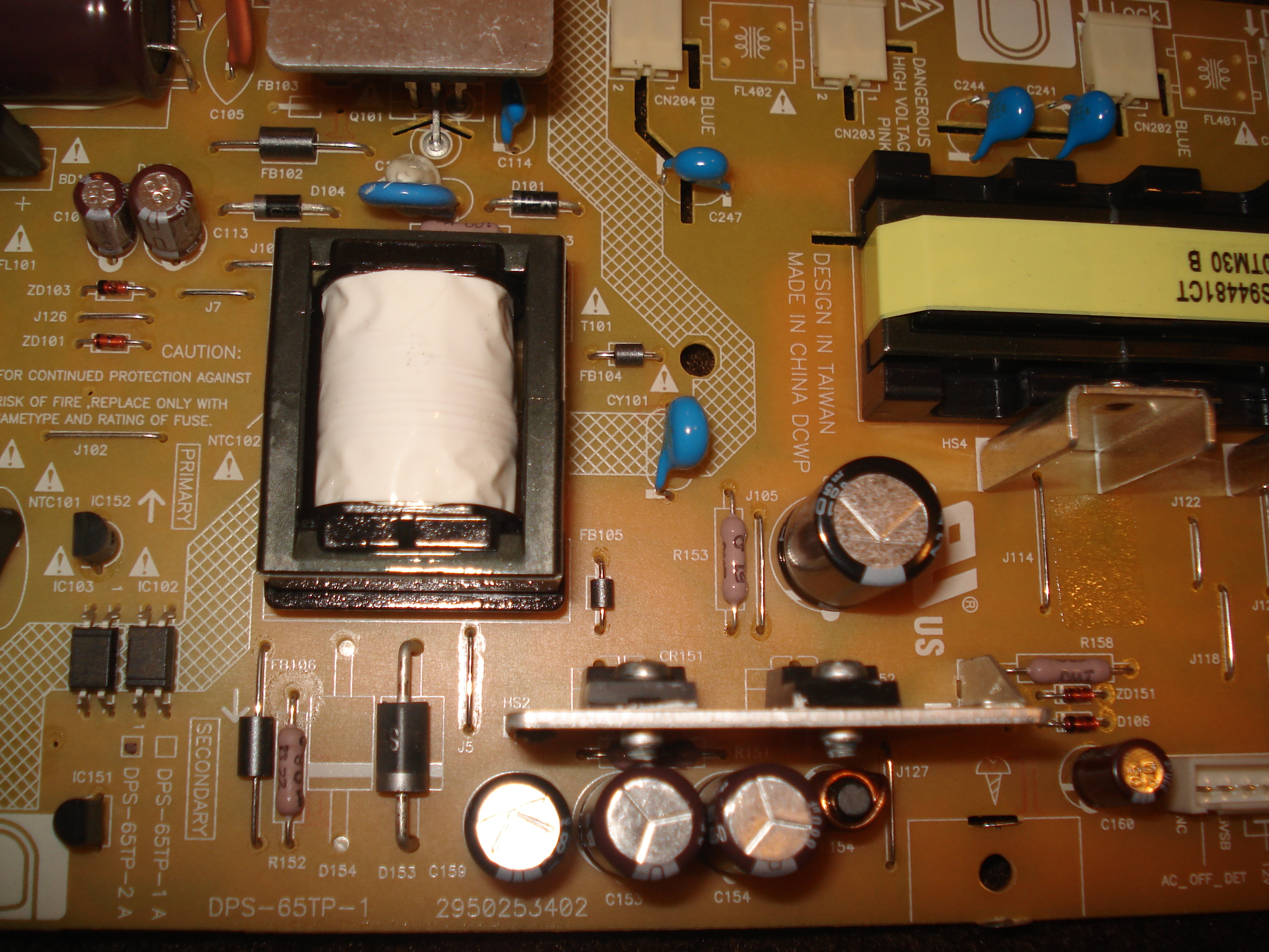

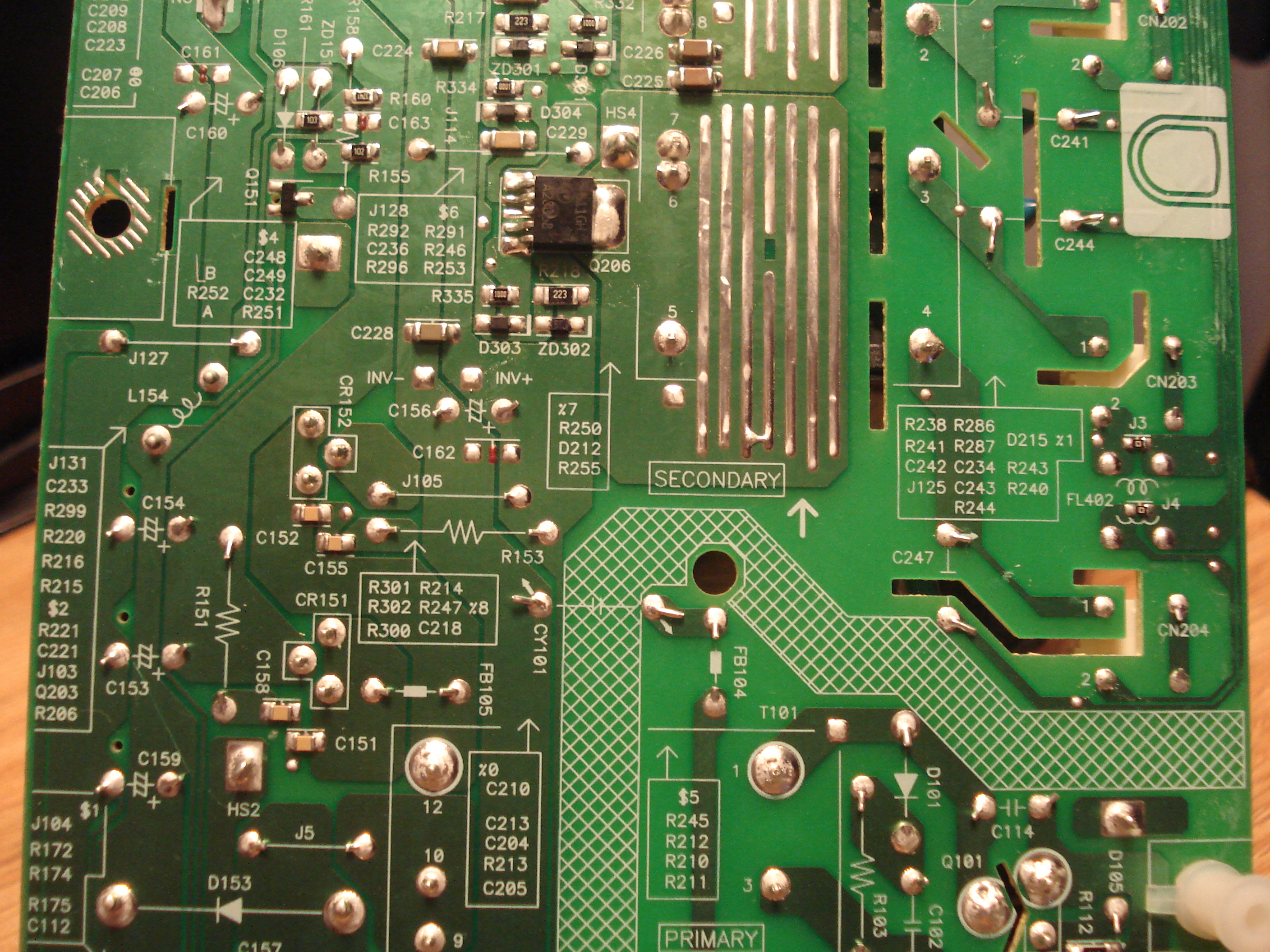

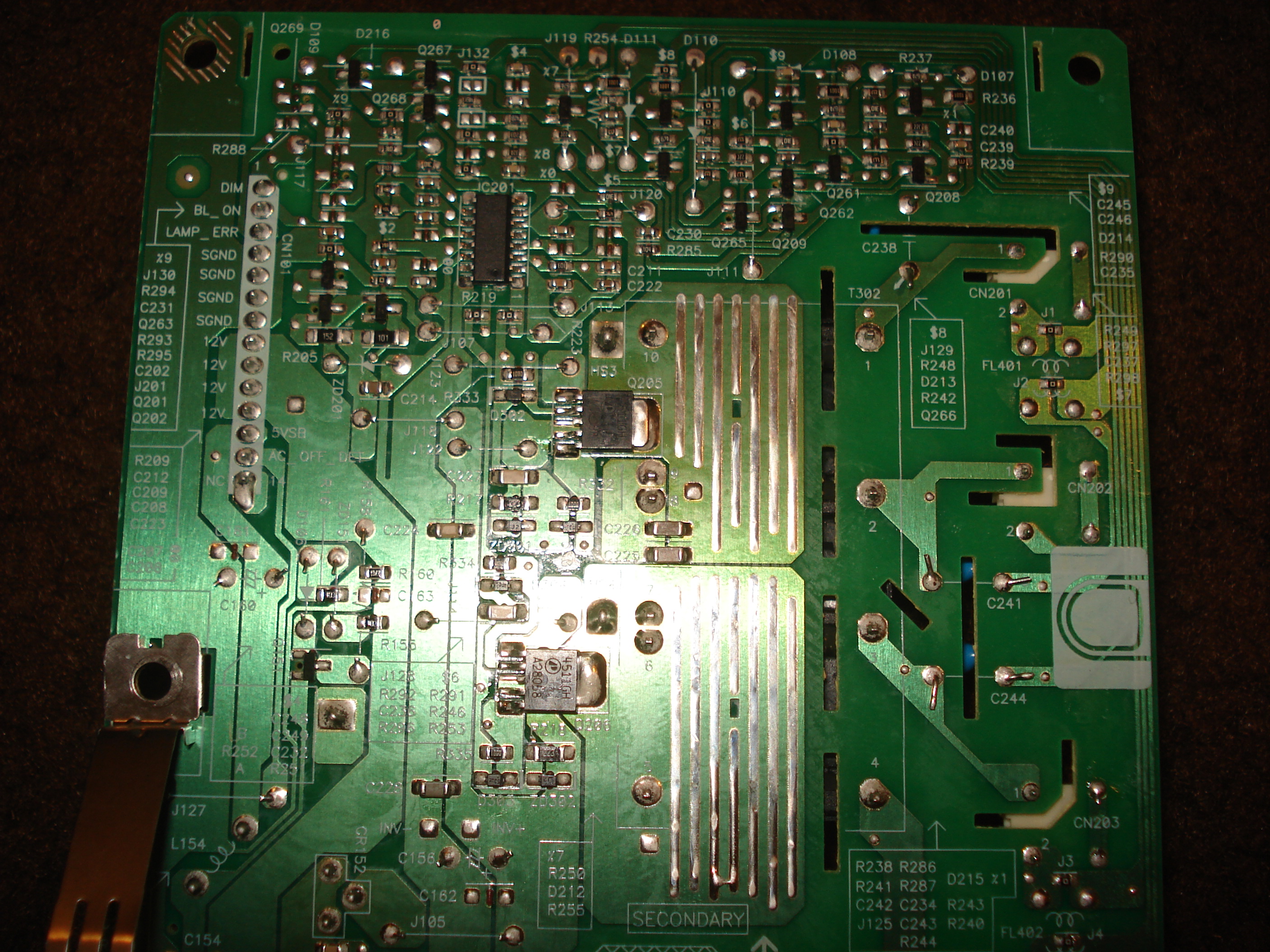

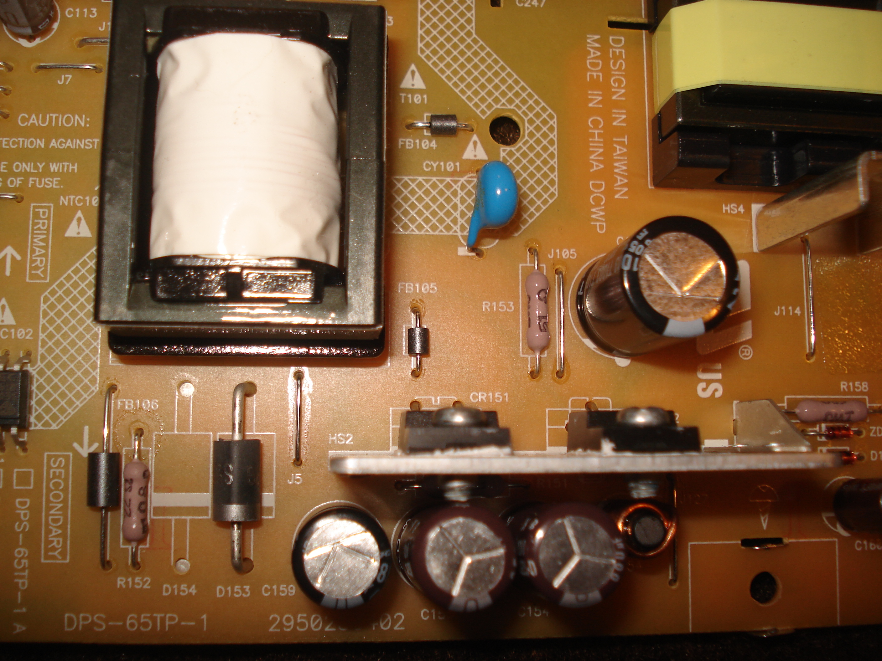

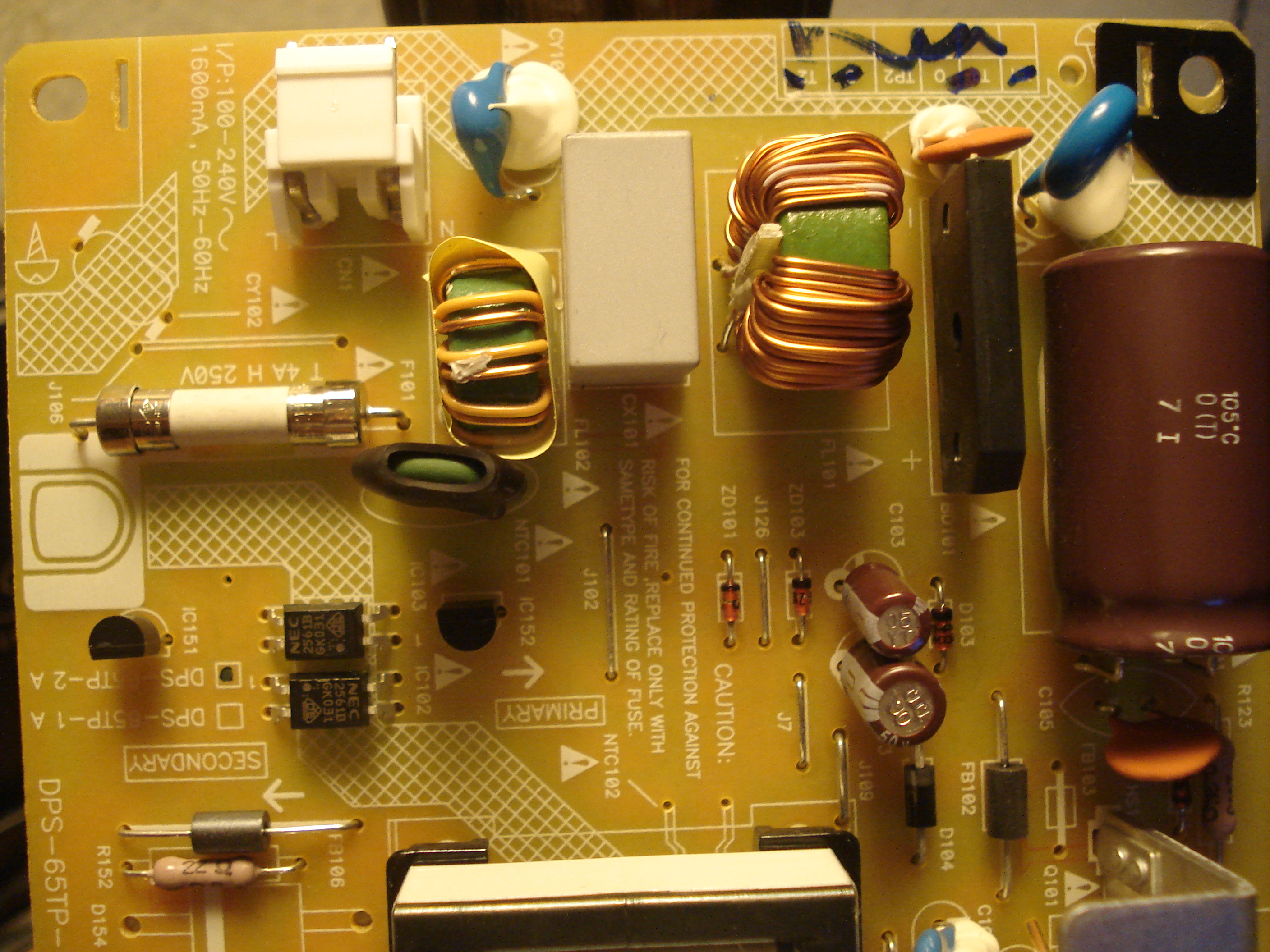

                                    Here is the picture of top bottom and lower section of the board

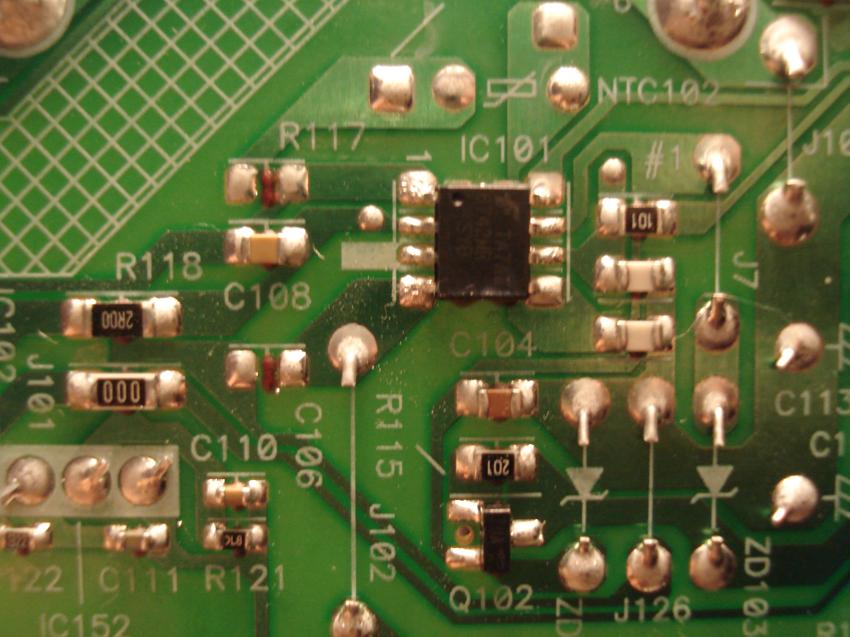

                                      OK, much better pictures with less reflection.
                                      Correction! I look real close at the picture, pin 7 is connected to J7 jumper, and it is ALSO connected to C104 to ground and also ZD101 to ground.
                                      So best thing to do is to lift pin 7 off the board.
                                      So the short can be the IC, C104, or ZD101.
                                      • arman960
                                        • Sep 2012
                                        • 129
                                        Ok removed the J7 jumper and than measured the resistance.
                                        GND and pin 4= open or very high resistance (above 2M Ohm)
                                        GND and 7= 3.5 Ohm
