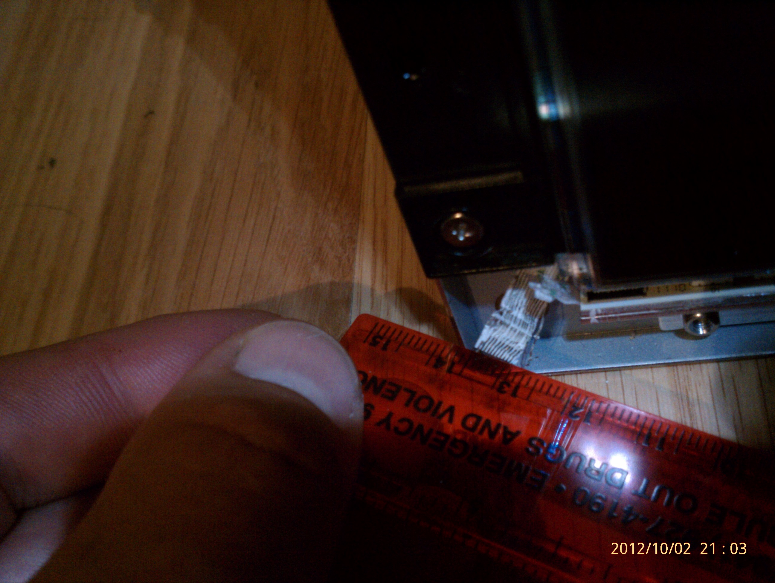

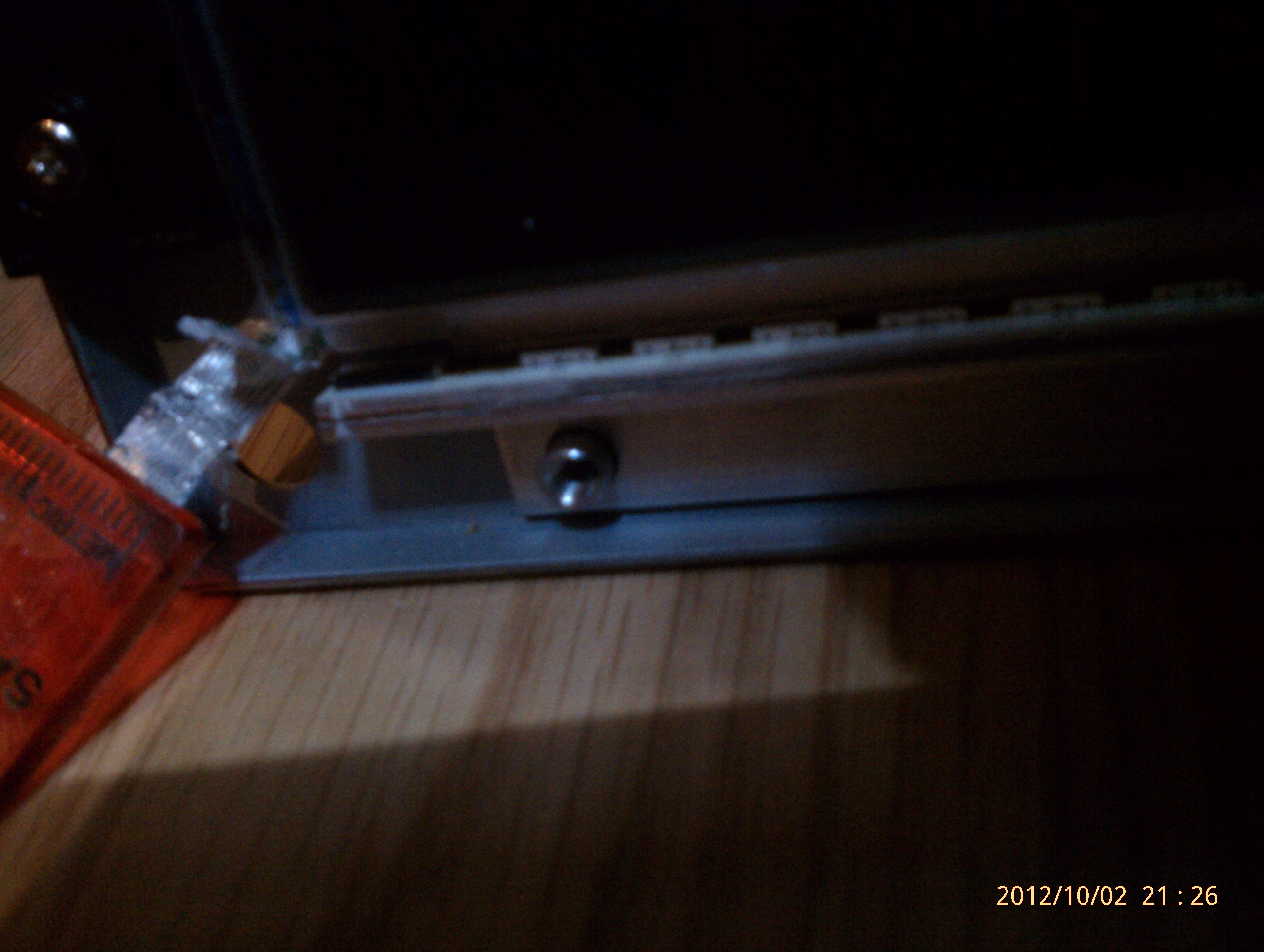

                                      There is not enough slack to cut the cable back far enough unfortunately, here a few pics sorry I cannot get the lighting better...
                                      Are the #'s on the ribbon relevant to the # of leads and spacing??

                                        It looks like this is the cable I need, it's 12 pins and measures 7mm wide like mine.
                                        http://cgi.ebay.com/ws/eBayISAPI.dll...#ht_1114wt_934
                                        However, it's not long enough. Wondering if there's a simple female to female connector that will connect them both together??
                                        I need a 2-3' cable, 70-80cm or anything close..
