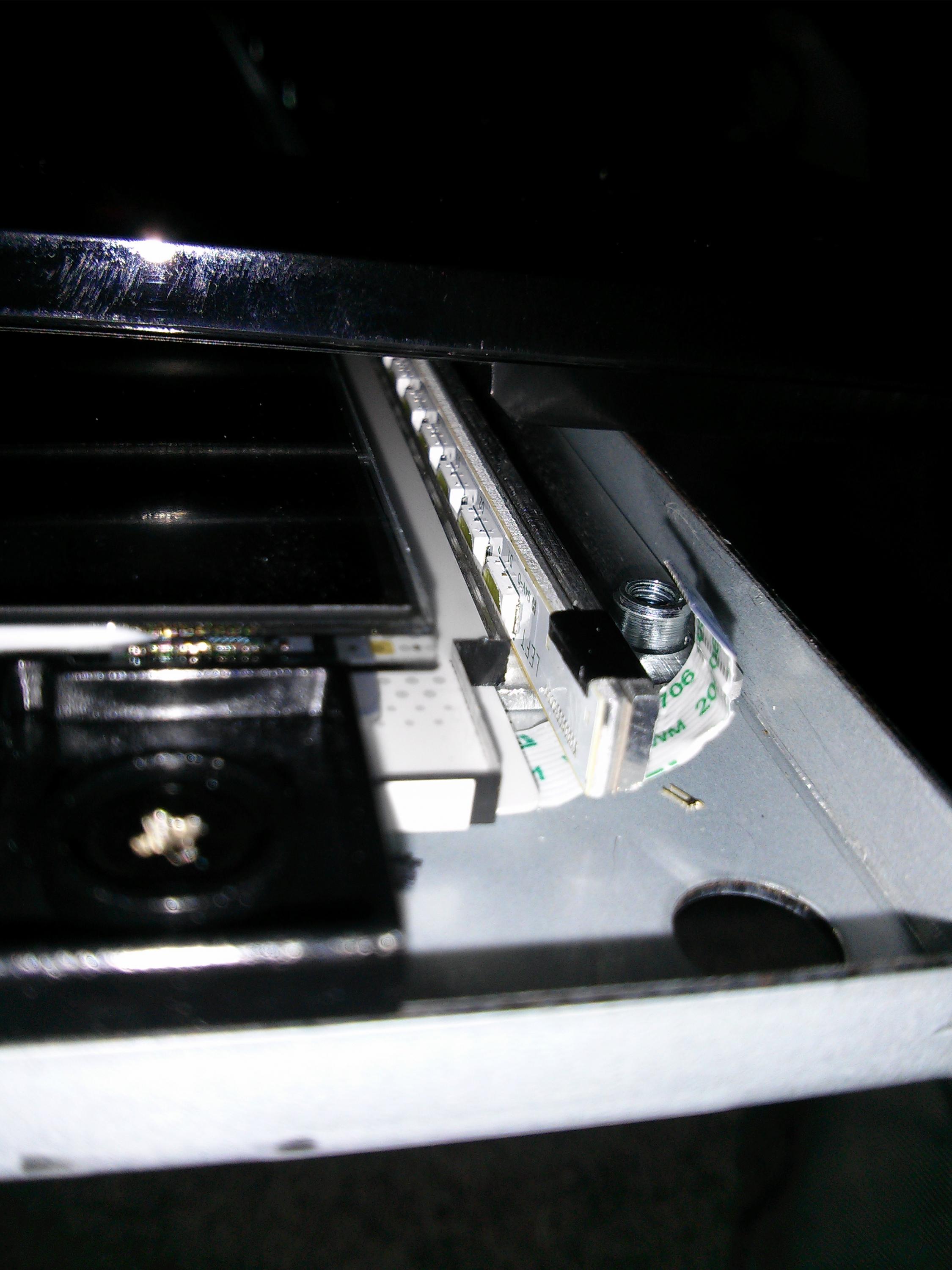

    I have to say I read alot of forums and dont really ever post, but I had to write a quick note on here. I need to give a huge thank you for everyone in this forum as I have finally resolved my issues without spending a dime. I found this a month or two ago and quickly took off the back and disconnected each side to isolate the issue and have been using the tv dim on one side until we bought or replacement. The new TV (LG LED) has arrived and this past weekend was time to tear down the westinghouse even further, upon further inpection I found the cable to be chewed up as well on the right side where it connects to the led strip, I removed it and cleaned it then added a small piece of electric tape to the aluminum to keep the ribbon cable from touching it and viola! It works like new again. I really have to give everyone a big thank you and I hope others are able to find this before they toss out their sets like I almost did. Thanks again!

                            I need some more help, earlier today I posted how the tape fix worked. In an attempt to add tape to the other side to avoid future failures the entire lock for the ribbon cable fell off the led strip. I'm killing myself right now as 20min ago I had a 100% working TV. Is there anyway to connect the ribbon cable directly to the strip or is there a place to buy a new led strip? Please help

                              That happened to me, had to rely on some Gorilla tape to hold it in place.

                                I tried holding the cable in place with my hand and couldn't get it to power up. So you didn't have any of the clip at all and were successful at taping the ribbon cable directly to the led strip? if you see in the pics there is barely any points of contact left. Thanks

                                  In my case the locking tab broke off, I can't really tell where it's supposed to be in the pic. Did the whole connector break?

                                    Yeah, the whole connector is gone. Bare metal with 12 very small points. I believe its done.

                                      Yes that would be very tough if not impossible. If you're really good at soldering you may be able to scrape the end of ribbon to expose the traces on top and try to solder it back on but that's a long shot.
                                          Electrical tape alone won't hold up unless you cut the plastic above the cable to prevent it from pressing down on the ribbon.
                                          Why people are ordering replacement cables? There's plenty of slack on the originals to repair the damaged area.
