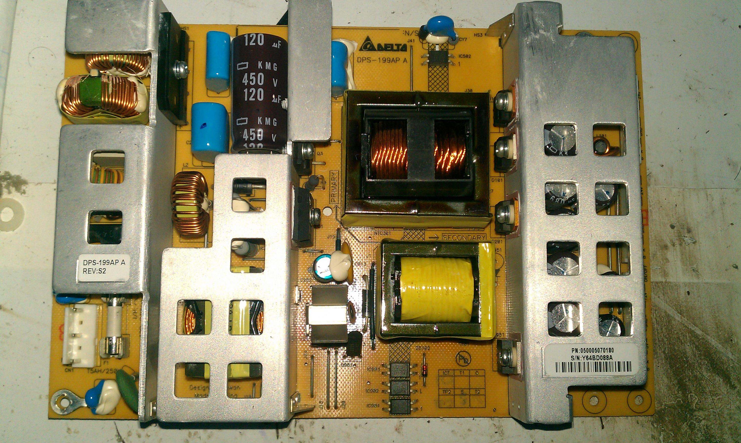

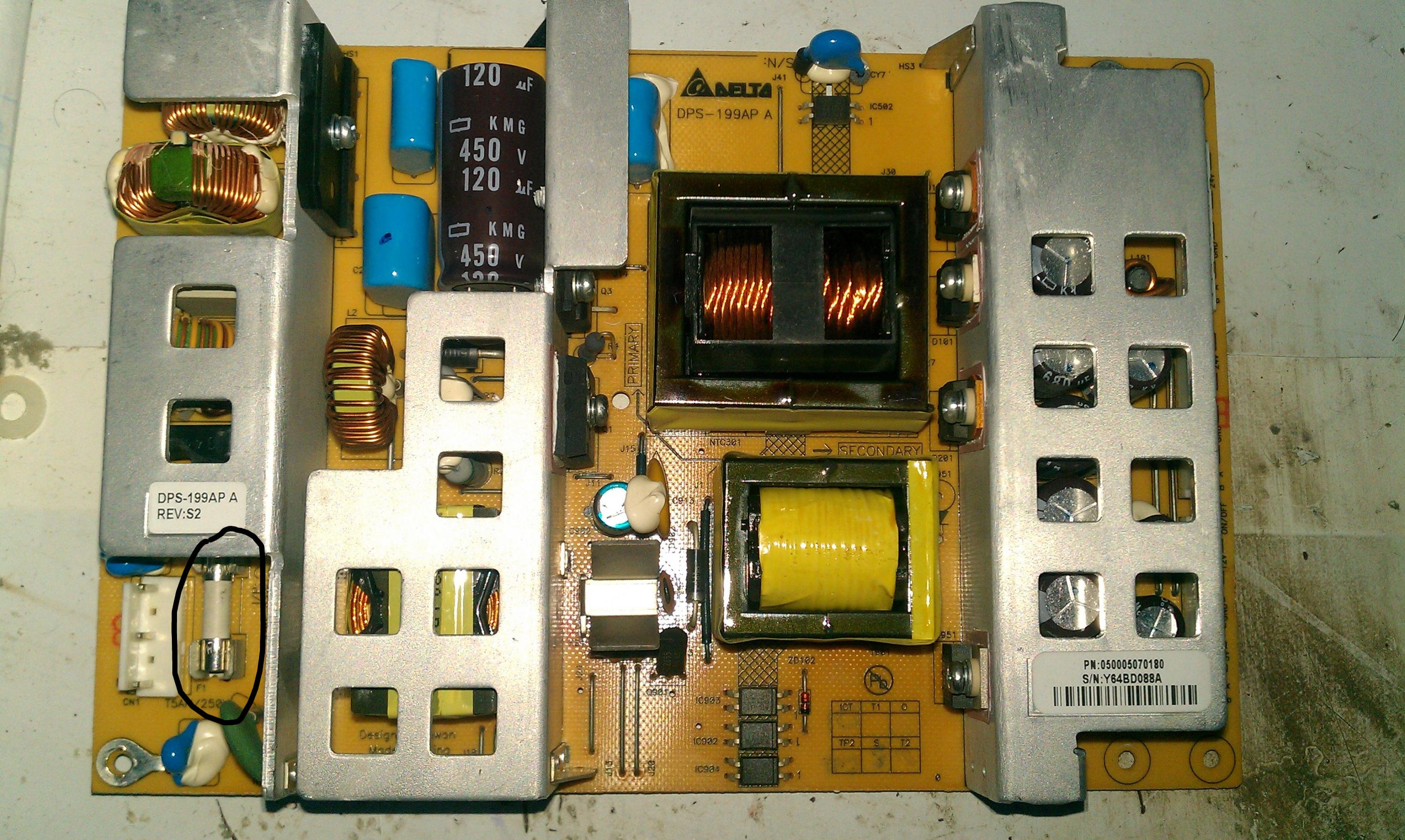

    I am Currently working on a Vizio HDTV that isn't giving me any sort of response. when plugged in. I have no Lights for standby or any form of sound or anything from the set. It seems to not be getting any power. I am assuming that It is the power supply, But I Need to be sure. All other connections and boards look normal. Does anyone have any insight on what This Could be. I Have provided a Picture of the Supply board to the Vizio.
  • retiredcaps
    • Apr 2010
    • 9271
    Re: Vizio L32 HDTV 10a No power, no standby LEd Nothing.
    1) Do you get 5V standby on the power board?
    2) If yes, then check your voltage regulators on the main board as per my sig file below.

      If #1 is no, is the main AC line fuse OK?
      • Ziggazam
        • Sep 2012
        • 22
        The main fuse is ok . I tested it first.
            Have you tested the 5V standby? If you post a closer shot of the connectors going from the power supply to the main board (which has HDMI etc on it) we can highlight the places to test. If there is a legend such as 5VSB next to a pin, that probably is the 5V standby voltage.

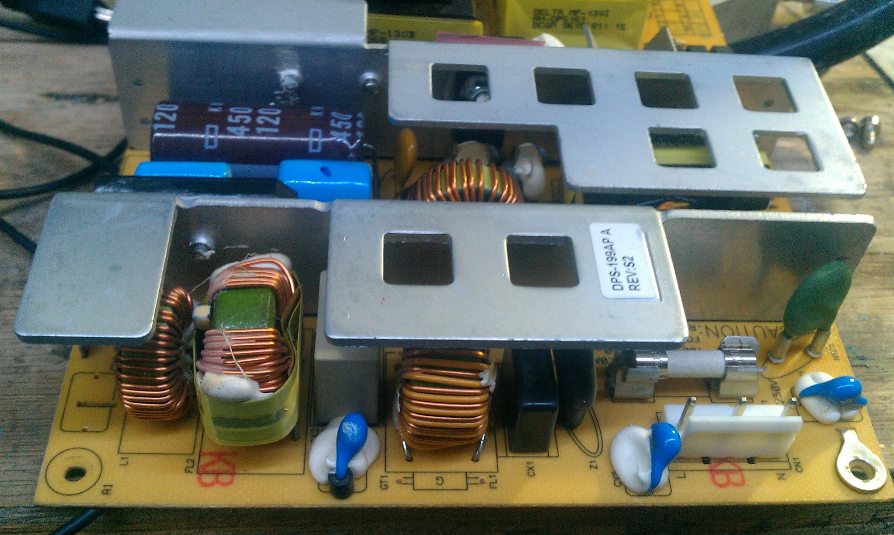

                close up of some connectors
                  Can you get a pic of the others? You could also just list them on the forum and we can tell you which to test.

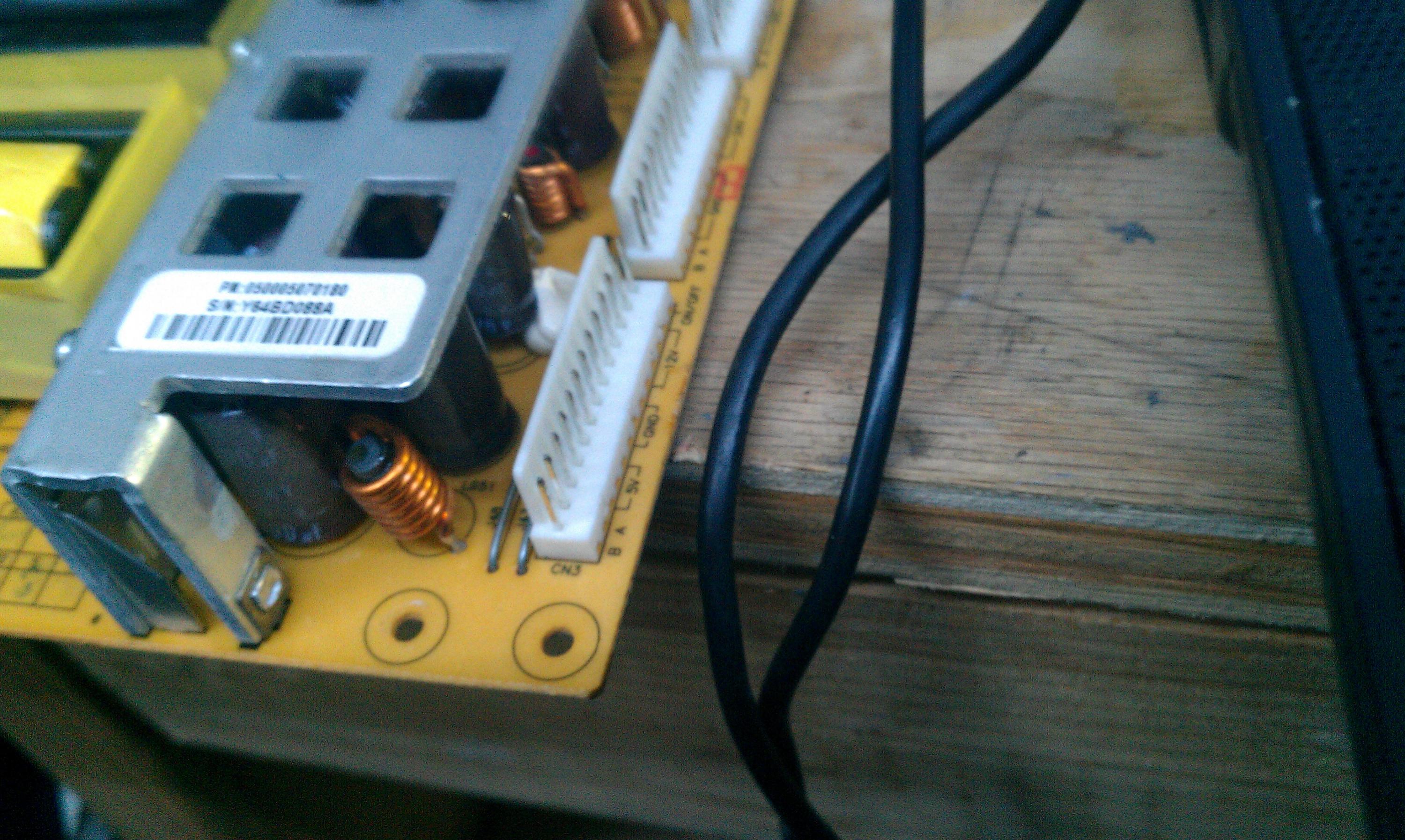

                    More photos
                      Can you get a pic of the other connectors - the ones at the top of the PSU.
                        OK, put the black meter probe of the DC Volt meter to the metal chassis, the Red probe on the terminal that is labeled with '5V' and see if you do have that standby 5V coming out.
                        Please also take CLEAR AND FOCUSED pictures of the connectors front view so we can read all the lables on the connectors.

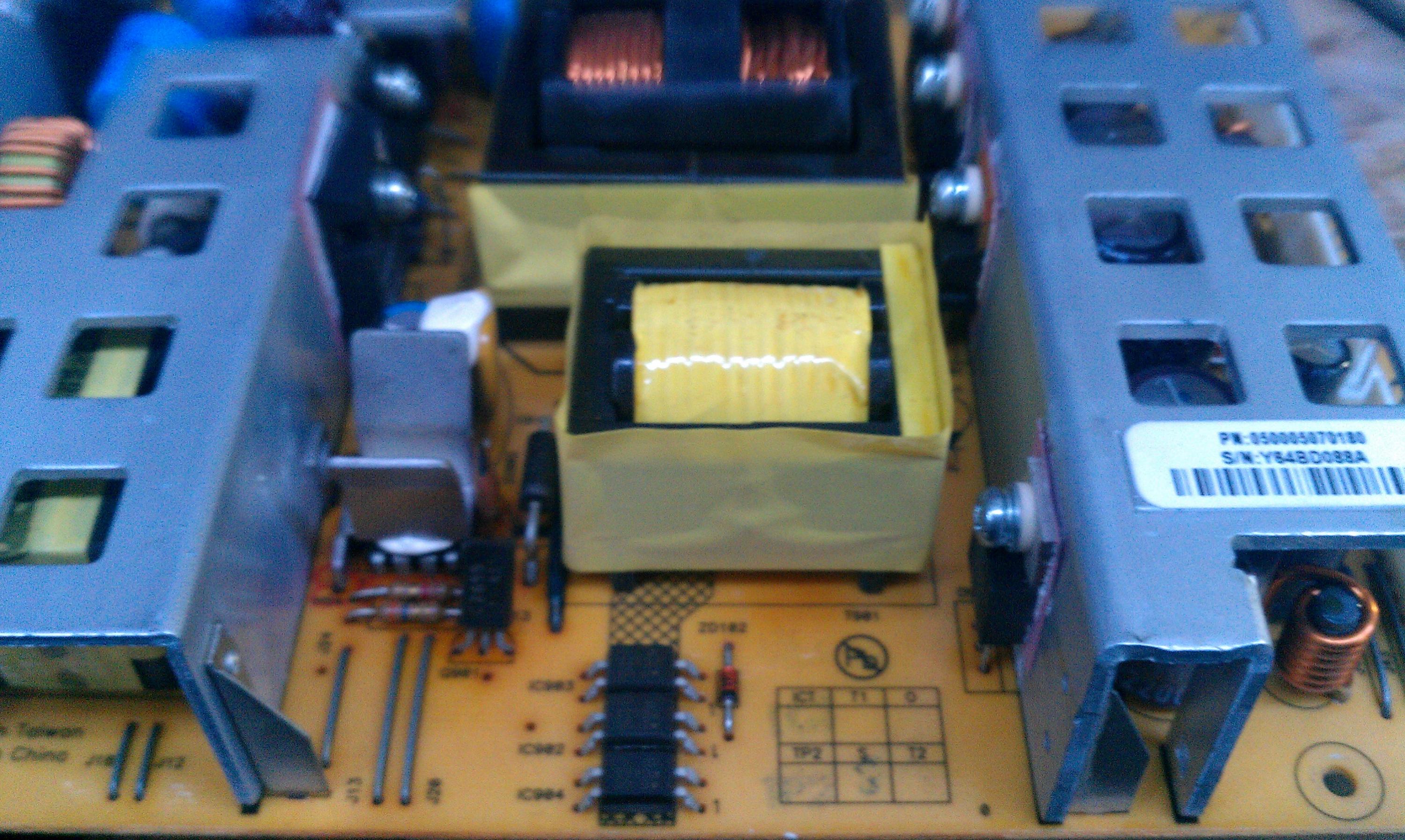

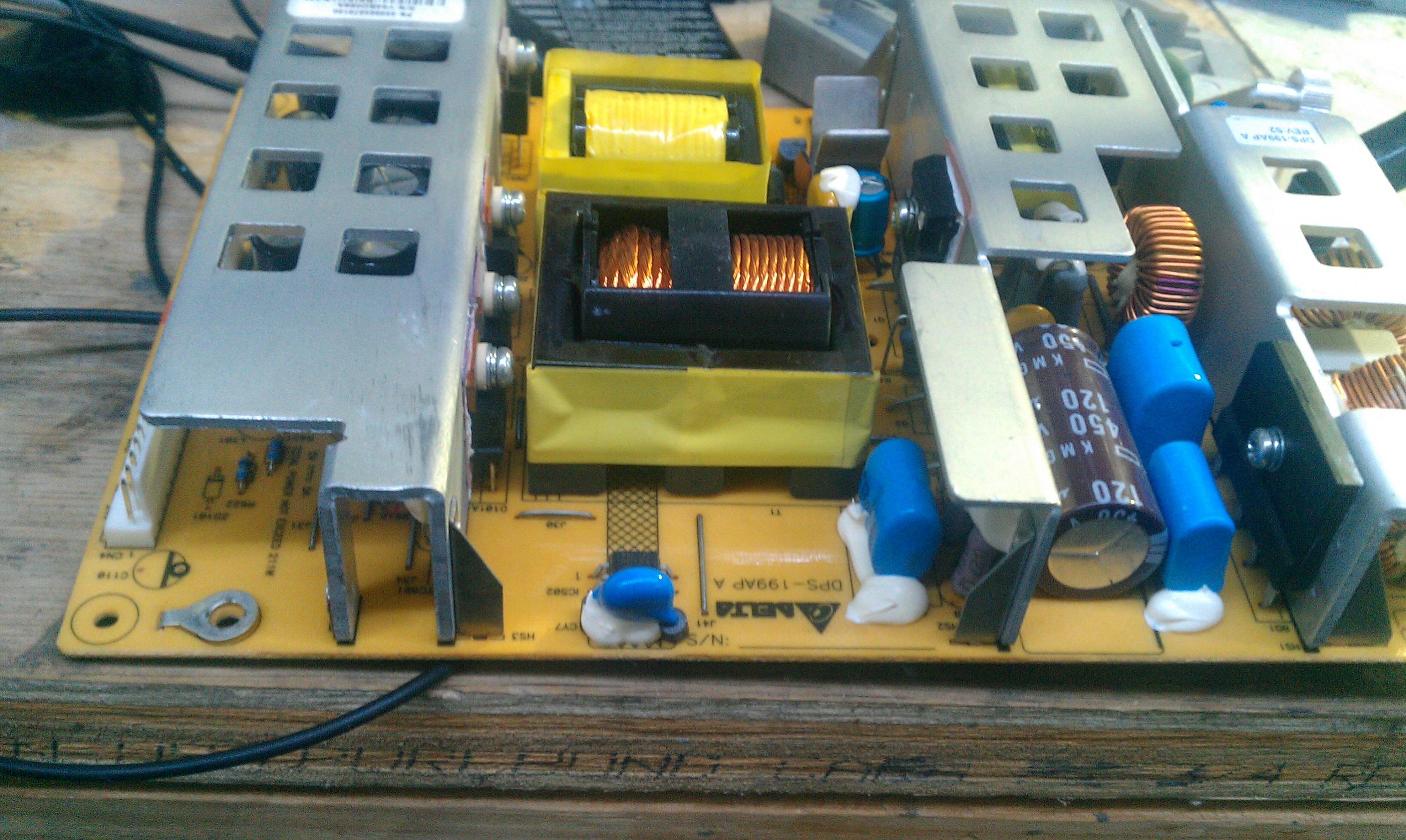

                          The other photos
                            Do you get the 5v on the connector? How about the pictures of th 3 DC output connectors?

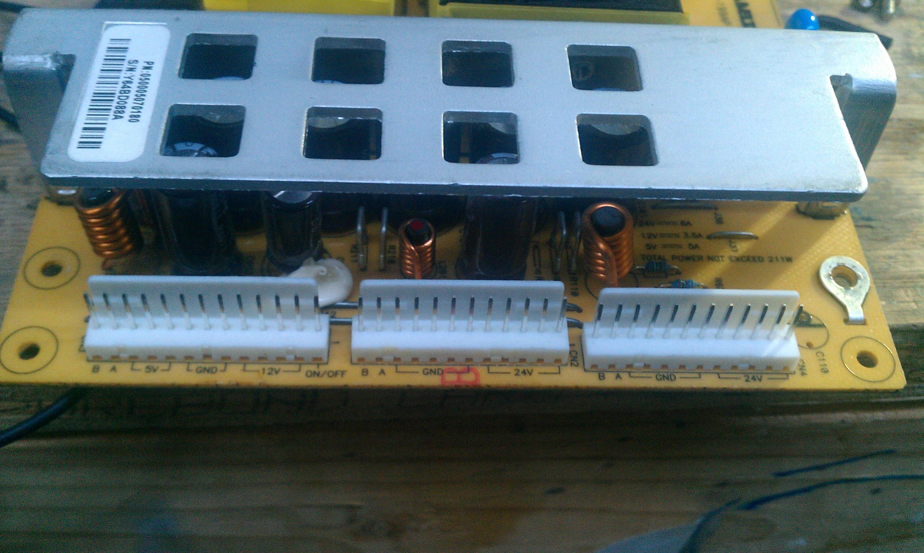

                              one more, much better photo
                                Thanks, that is much better. So check that 5v OUTPUT.
                                  I checked that 5v output And it not giving me anything. Over 000.0 on the multimeter that was dc
                                    OK, so the PSU is dead. There is a white ceramic fuse here. With the power to the board unplugged (very important) test the resistance across it - should be close to zero ohms.
