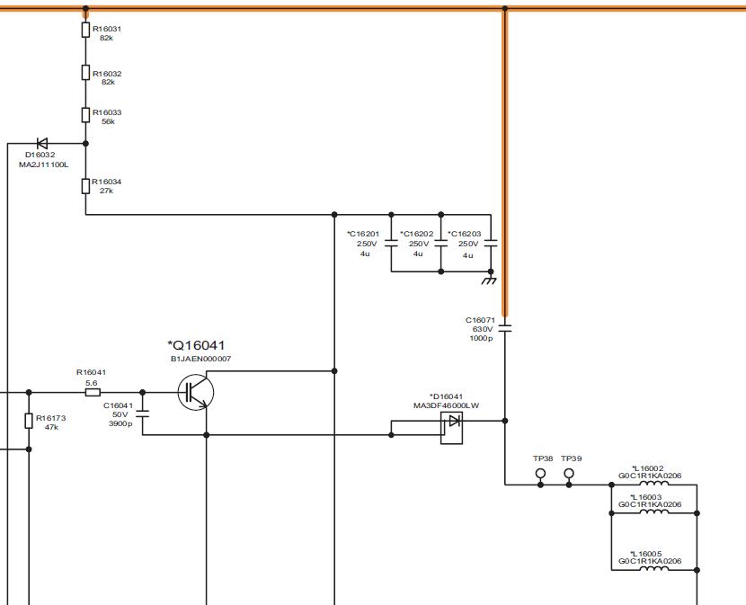

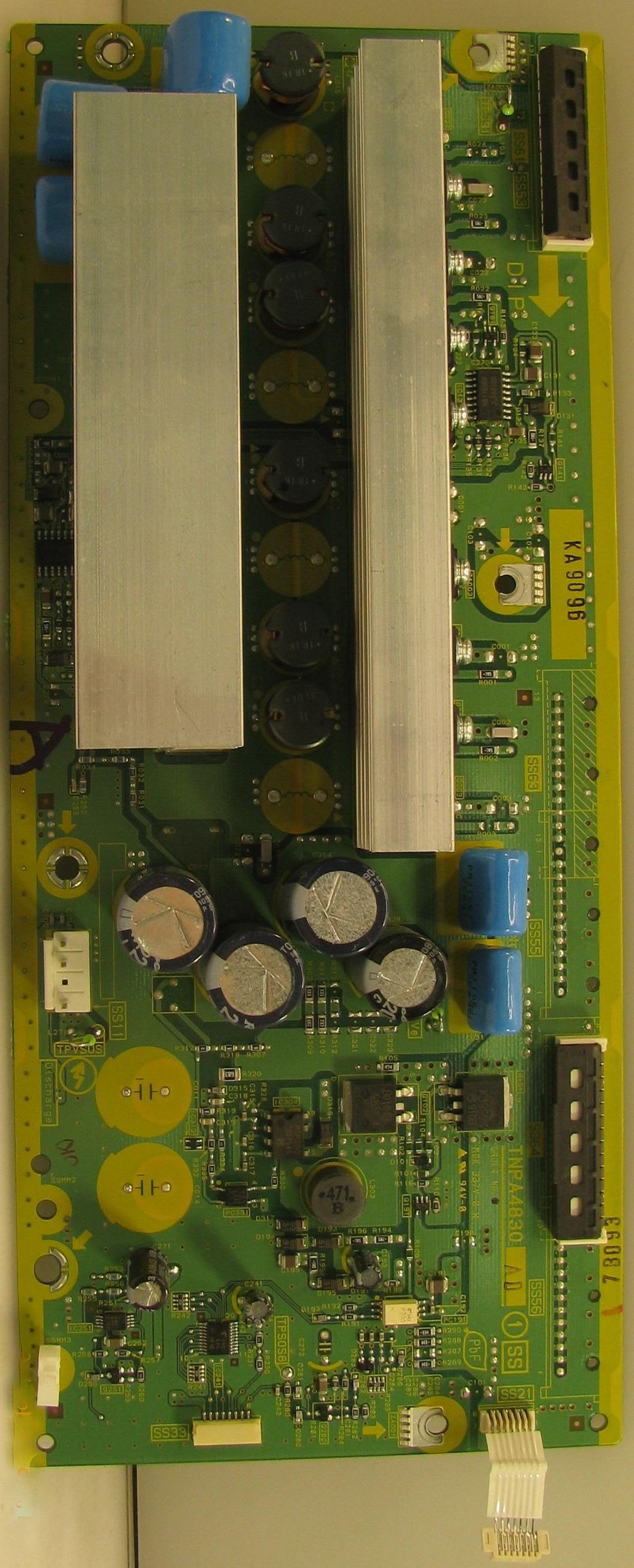

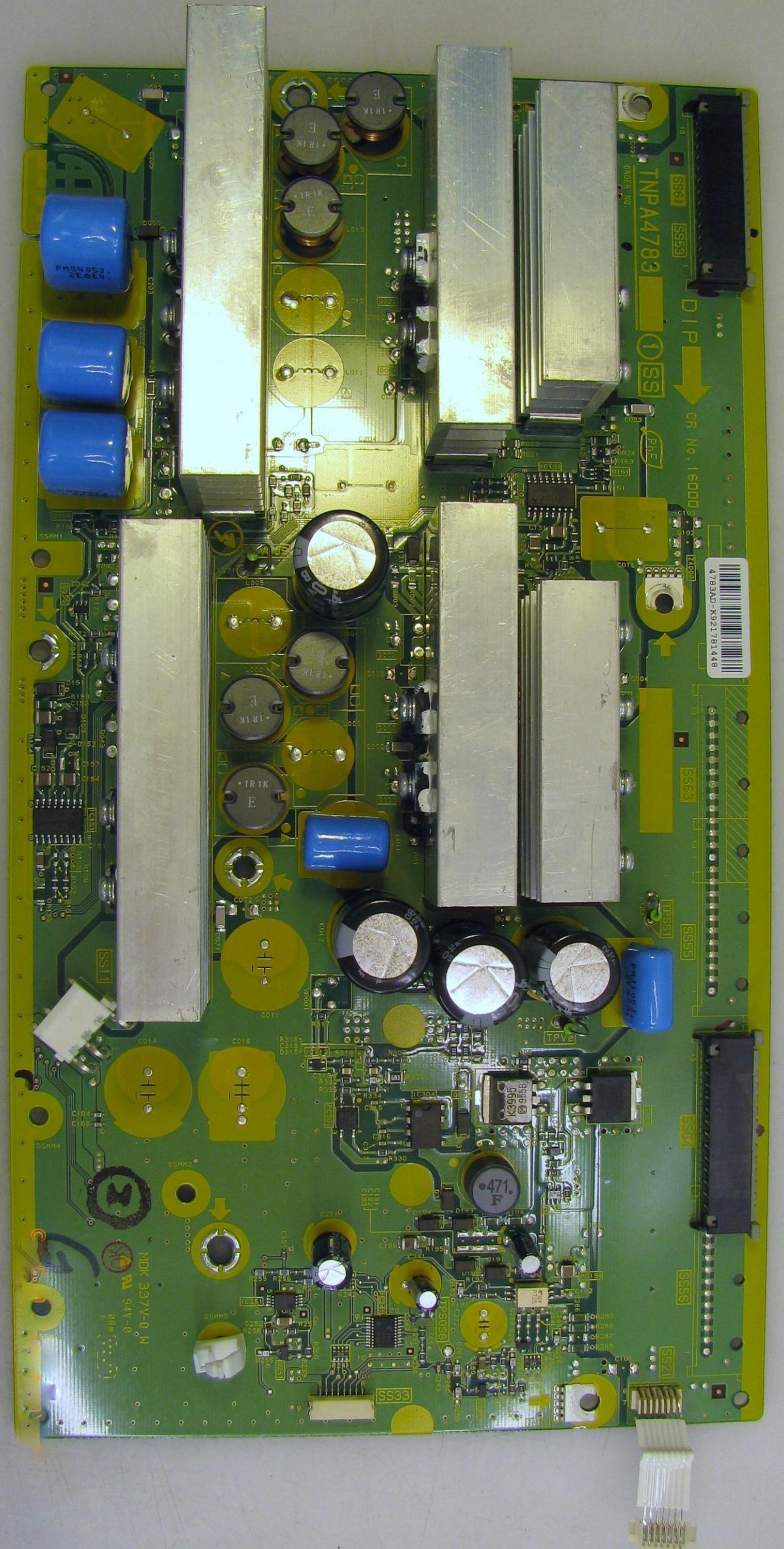

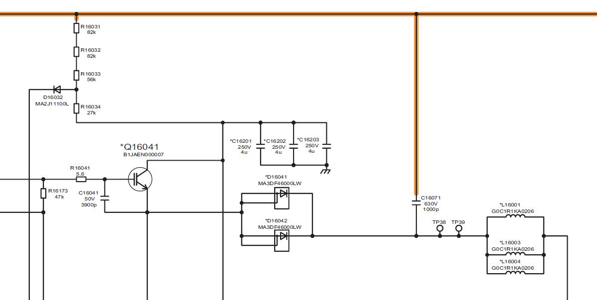

                Here's some radical thoughts I had.
                The TC-P42S1, TC-P42G10,TX-P42G10B have panel sticker Number: MC106F16T12, part #MD42F12A1J and uses SS TXNSS1EFUU, TNPA4783AD with daughter board TNPA4802S.
                The TC-P42U1,TX-P42S10B. TX-P42S11B, TX-P42U10B have THE SAME panel sticker Number: MC106F16T12, part #MD42F12A1J and uses SS TXNSS1EKUU, TNPA4830AD with THE SAME daughter board TNPA4802S.
                the service manuals confirm the same panels.
                I've had a quick glance at the 2 cct diagrams and they've removed some diodes and transistors, I've attached some pictures so you can see what I'm on about.
                My thinking is if it's the same sticker and part numbers then it's the same panel so will have the same electrical specs and mounting posts.
                looking at the shots you can see the 4830 is a cut down board and the screw holes do align with the 4783.
                2 things which has me cautious about this are:
                1. connector SS11 as it's rotated 180 degrees and now vertical. Your cable may not be long enough to reach it in that position since it's inboard compared to the 4783. If you can get the cable along with the purchase of a 4830 that would solve that one.
                2. the 4783 model TV has 490W max in the manual
                the 4830 model TV , 293W max

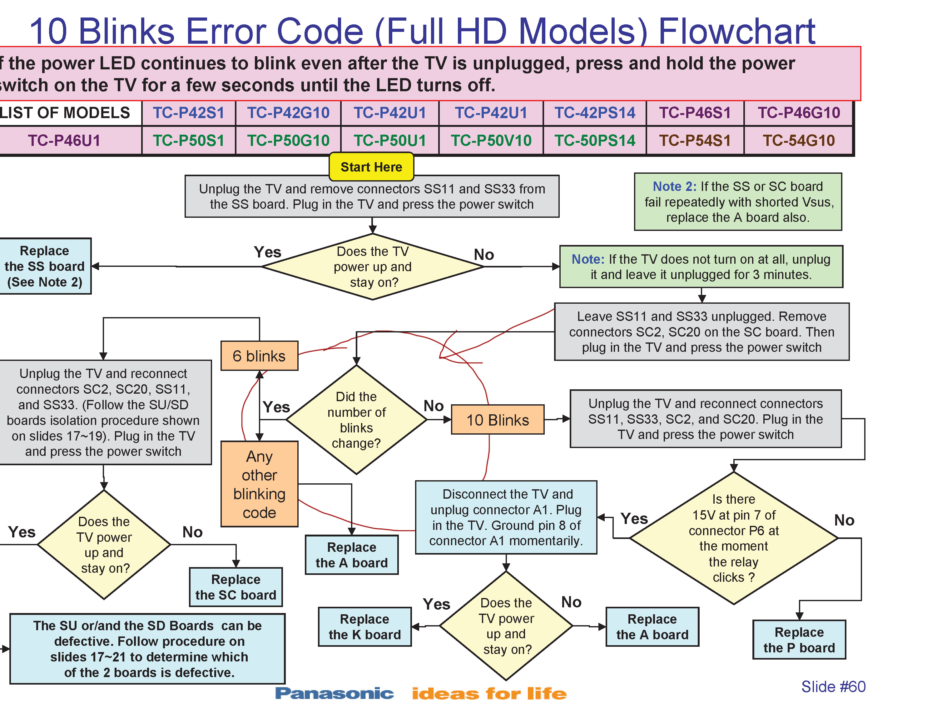

                                Not sure if this is ok i have this same tv and same problem but not the SS board as i have followed the attached flow chart and see the red circle where i get stuck...
                                I do not get 10 blinks i do not get 6 i do not get any the Power LED comes on solid then the TV just shuts off that is it no blinks no nothing.
                                Would that be the A board or the P board causing that issue?
                                Any help would be great i could not make a new thread so i hope posting to this one was ok as i think it is on topic.

                                  So, you originally had 10 blinks but after following the flow chart, you get none? I believe no blinks can also be interpreted as 1 blink. It looks like you should replace the A board according to your chart.
                                  Or are you saying you never had any blinks, but you followed the 10 blink flow chart?

                                    I am at the Center point of the board trouble shooting. its between the SU and the SC board. Does anyone have the slides that give me the diagnostic to isolate these so I can pinpoint it. It says slides 17-19...
                                    Link or what ever would be great.
                                    • tw2005
                                      • Oct 2011
                                      • 6458
                                      Re: Panasonic TC-P42s1 10 blink SS board bad!
                                      Disconnect the 3 connectors from the SC to the SD/SU. Remove the earth screws at the SD/SU boards. Jumper the 2 pins on the SC at SC50, power on. If the SC is good the TV will pass it's self checks and turn on.
                                      How many blinks did you start with?
