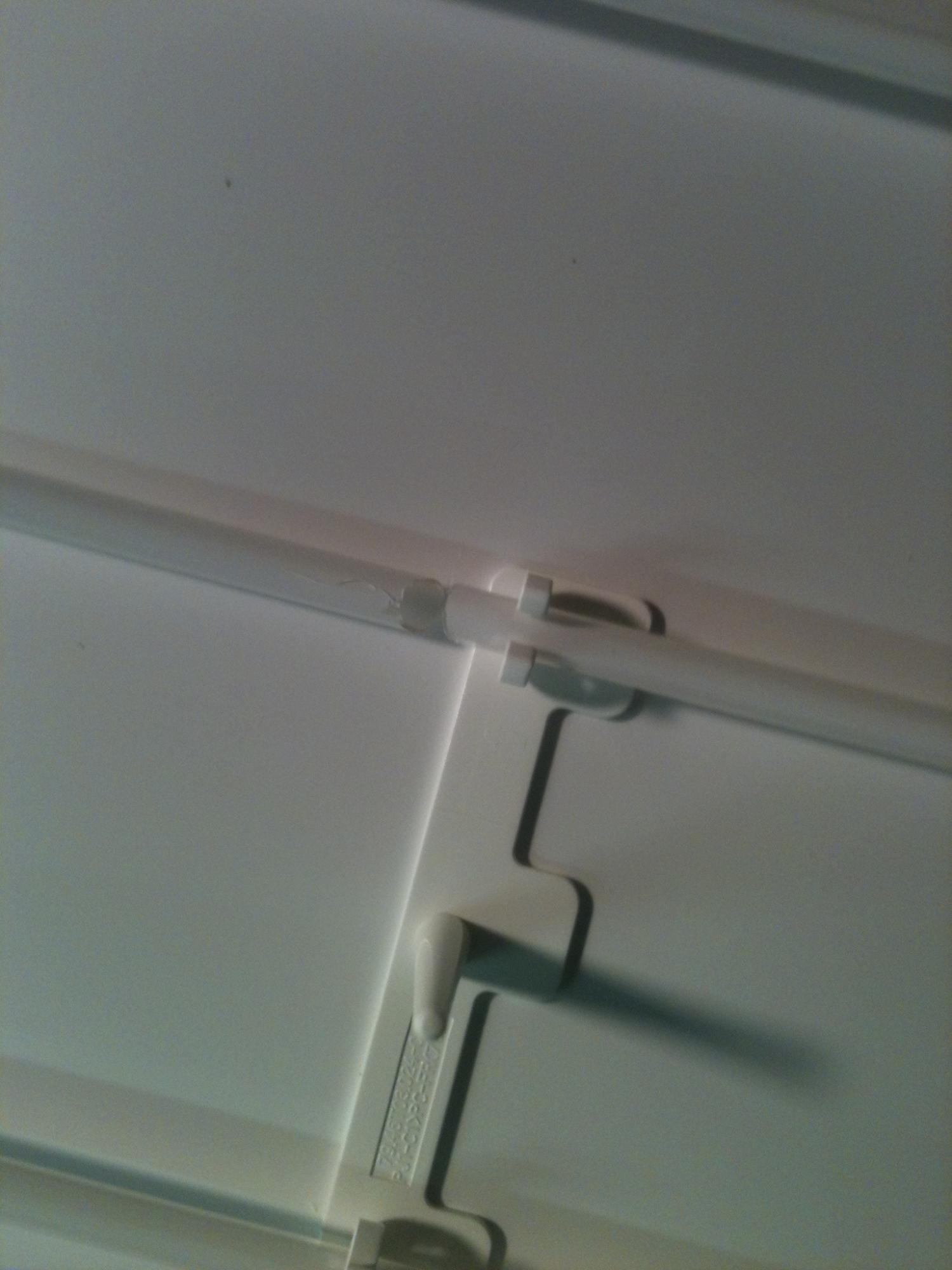

      It was certainly a bad tube! It was cracked good, but all the other bulbs turned on just fine. Thank you for your help. Now I have to find a compatible tube, hopefully be back in business.

            I have changed quite a few lamps in monitors lately and a warning is in order. The lamps are very fragile. Make sure especially with the one you will be dealing with to keep is supported along its length, just because they are so long. Also don't put any undue pressure on them while getting them seated. I am sure these are very expensive so you don't want to have to buy another.

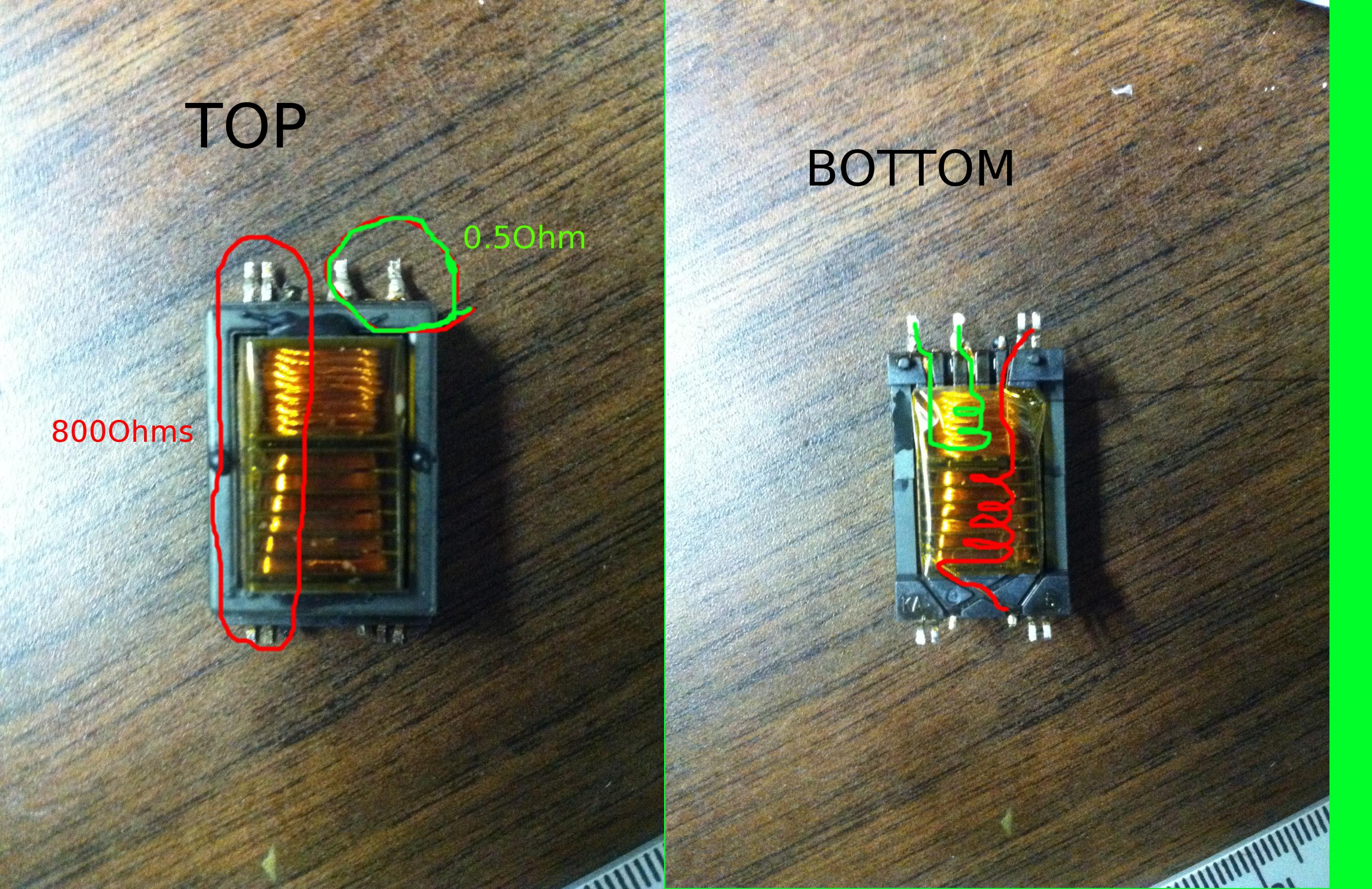

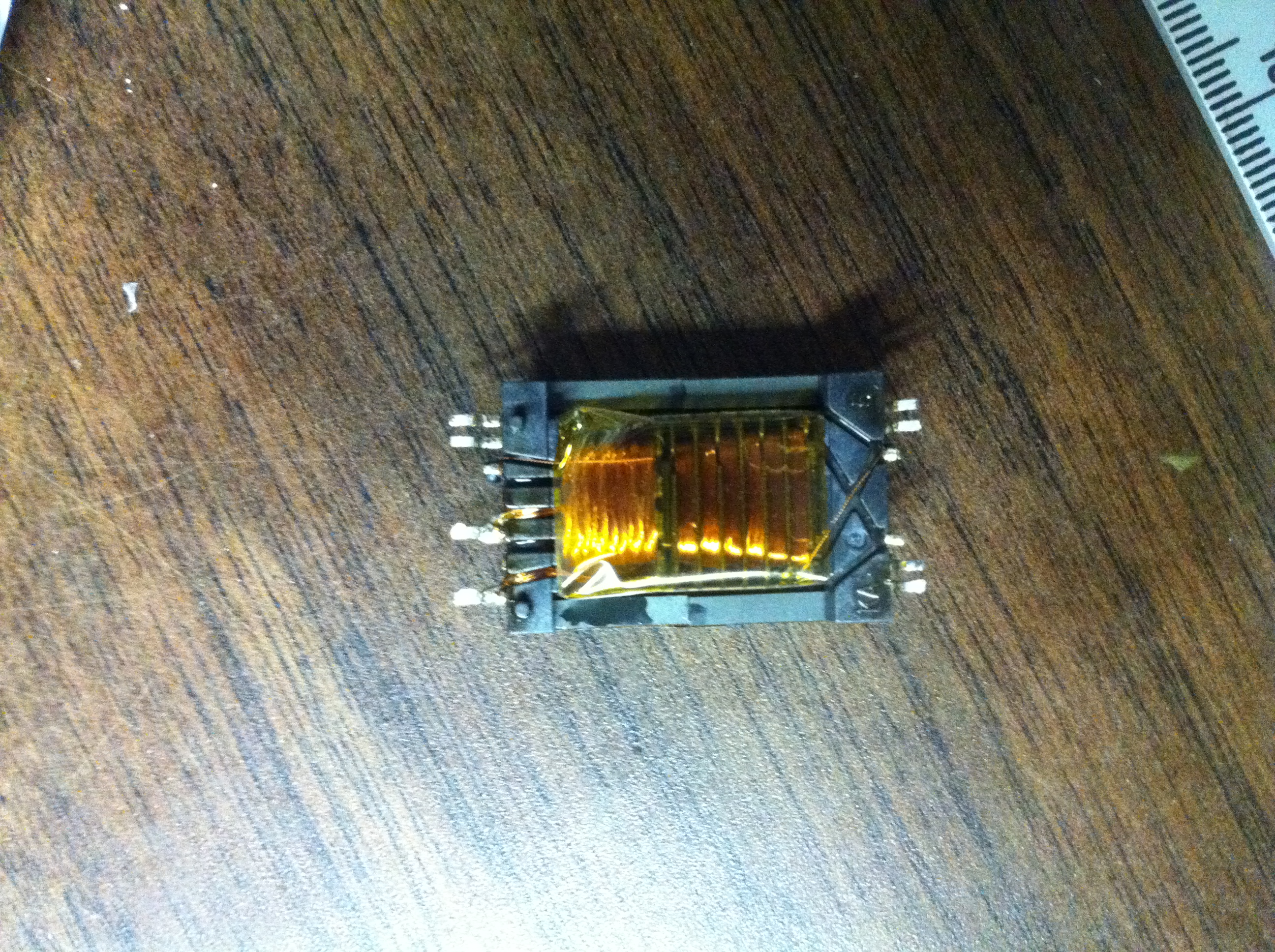

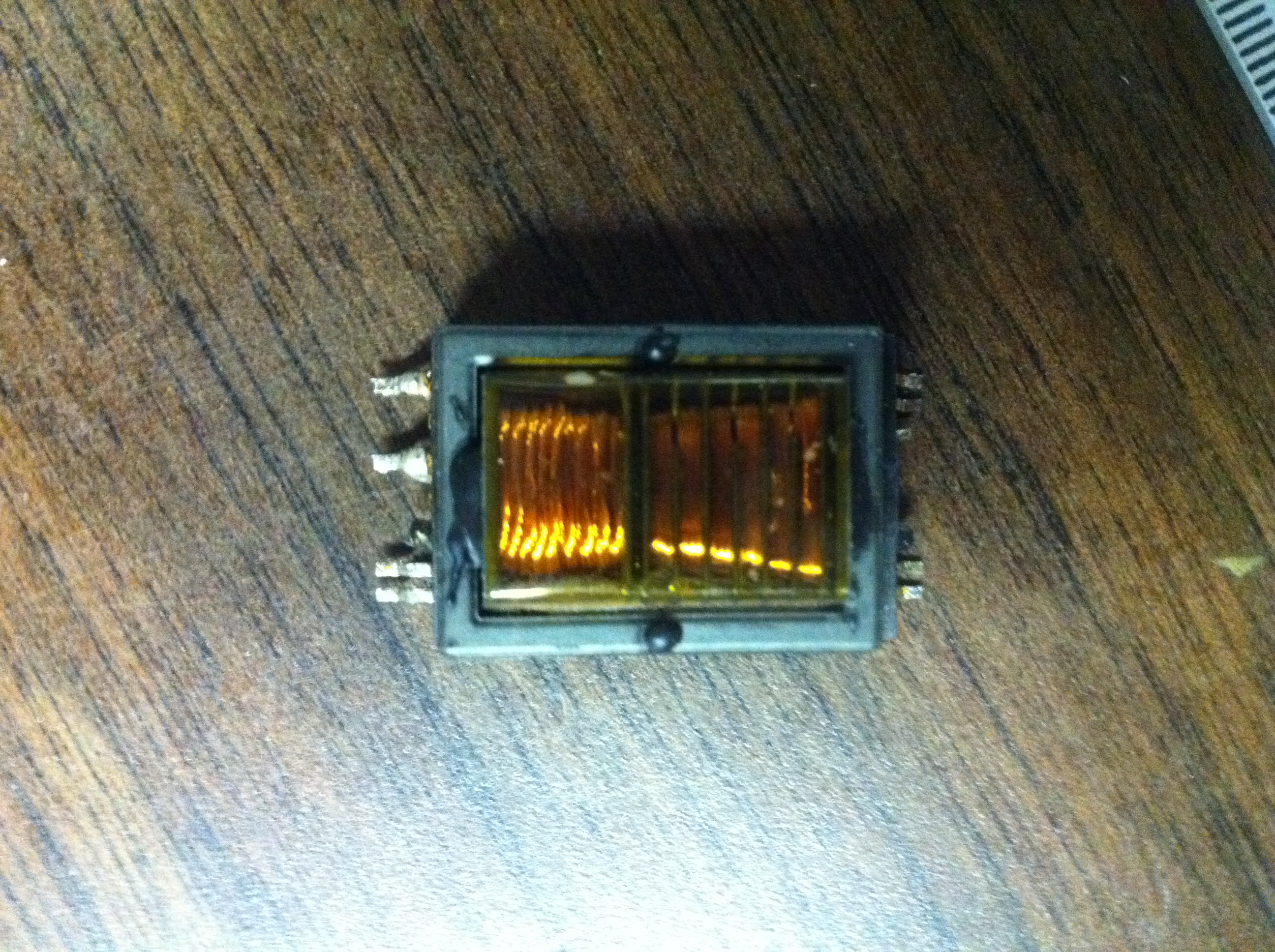

                  I took one of the transformers off to see which pins had which windings. The high ohm windings where as follows:
                  1. 800
                  2. 804
                  3. 806
                  4. 805
                  5. 808
                  6. 798
                  7. 798
                  8. 807
                  9. 802
                  10. 799
                  11. 805
                  12. 796
                  I also measured the lower ohm winding and found I measured 1/2ohm on all of them. I tried to test for any shorts between the primary and secondary and it measured 4.2kOhm in circuit. They look in parallel so I shorted out a primary/secondary winding in another circuit with a wire and it them measured 0 Ohm. That seems to tell me theres no problem with primary to secondary shorts.

                      It would be useful for others reading in future if you could marke up the transformer showing te secondary pins.

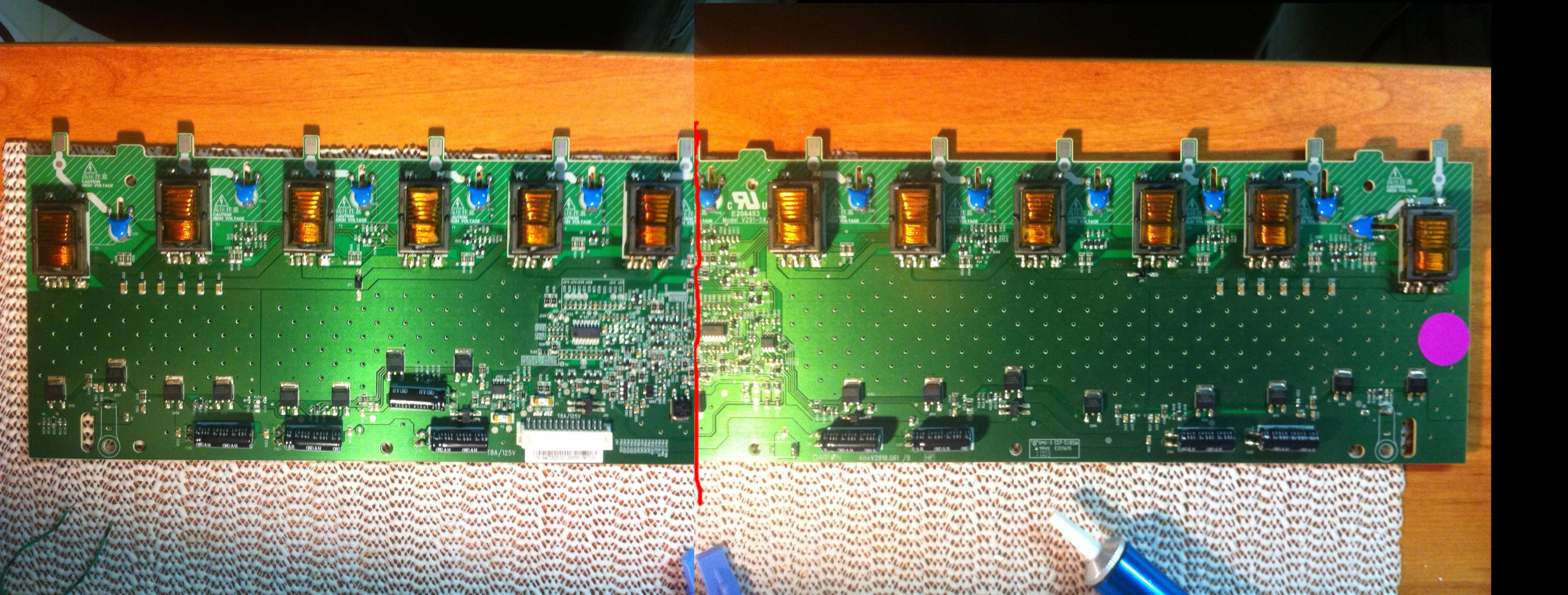

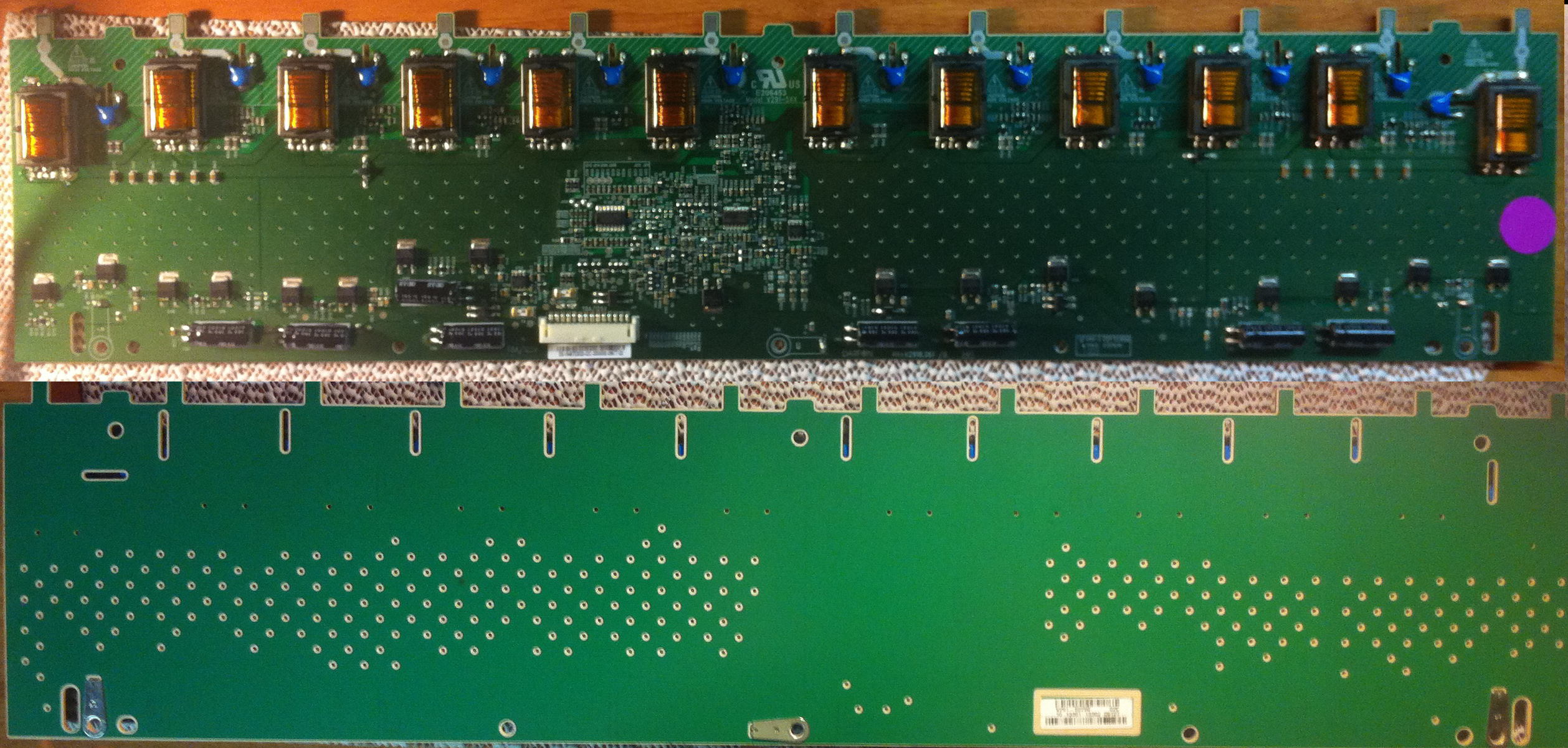

                      In order to try and troubleshoot this we need to be able to see the boards so can you take pictures of both sides of the power supply main board and inverter board. Need them to be clear so we can see the board numbers.
                      • CommTechRepair
                        • Aug 2012
                        • 20
                        #31
                        Re: Sanyo DP46480 2s to black
                        It is a AUO 19.46T03.020 Backlight Inverter, the part can also be seen here:

                          Hi
                          It has been a while since I have posted and during that time have learned a great deal..... One of the sets that have been a biggie in the learning curve has been the Sanyo's
                          In this series Sanyo and for all others there are a current sensing line that lets the main board (micro) know if too much current is being pulled.... Having said that, there is also a similar current sensing line that is in the inverter board too.. Multiple redundancies...
                          This Sanyo has numerous issues with bad bulbs and also bulbs that are weakening. Since you have the shell opened and if you are able to separate the panel and diffusers so that you can see the bulbs light up, you should be able to get that there are other bulbs that are in rough shape or pinkish...
                          The other thing to be aware of while someone has replaced the caps, it probably would not hurt to dig a print up to make sure that the caps are the right ones....
                          As far as the inverter transformers go, you do not want to see much of a variation between each...
                          You do not want to see much variation in the secondaries of each transformer... An example would be.... lets say each transformer measures between 390 to 405.... But you came across one that was 375... I would consider that one bad.... Even perhaps 380..
