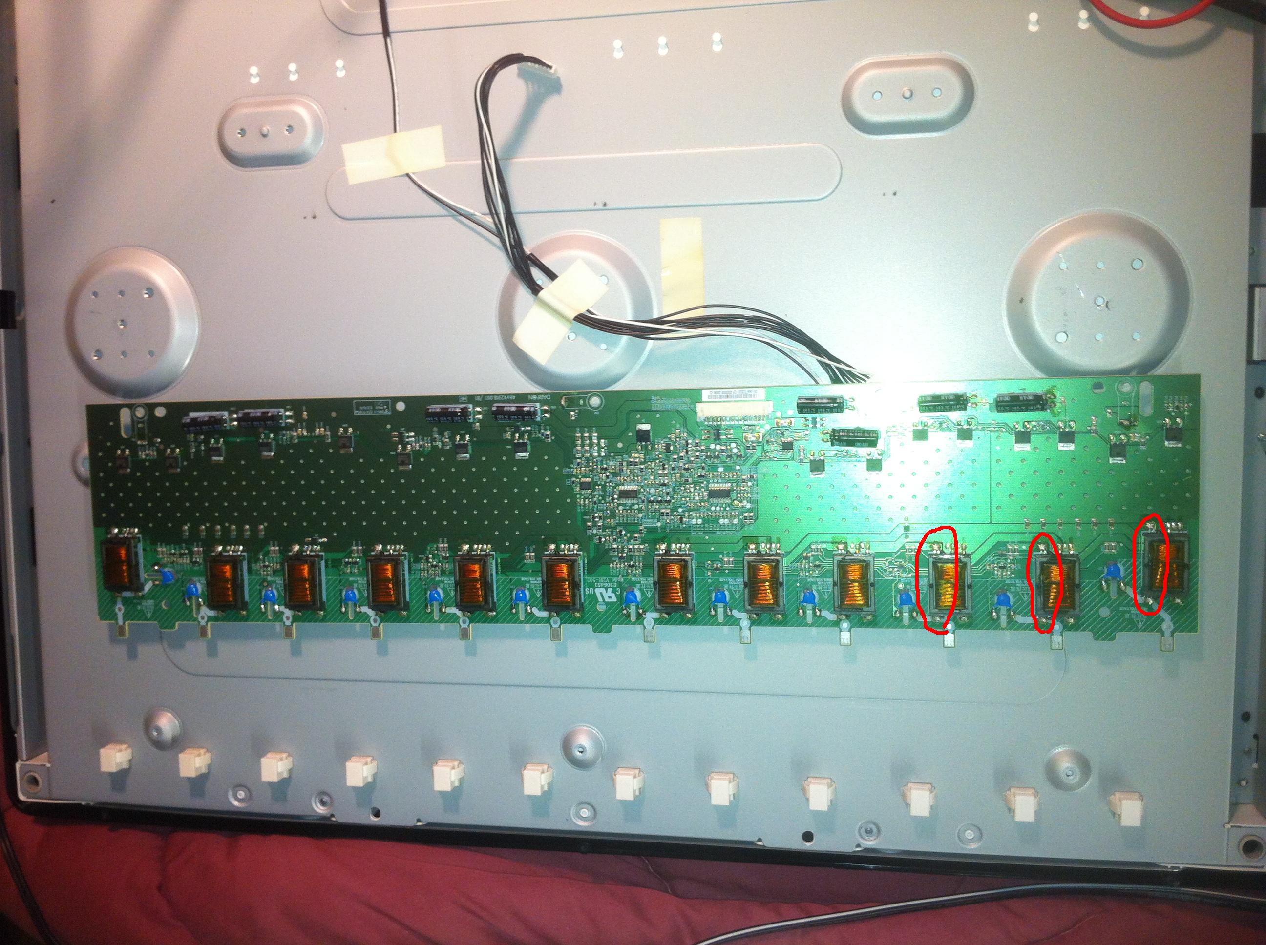

    I have a Sanyo DP46480 that when you turn it on the backlights come on after a few seconds, stay on momentarily then shut off. The TV continues to run with sound in the background and I can see video if I hold a flashlight up to it.
    So far I've put an oscilloscope on the power connectors from the power supply board to the main system board. There was no ripple and voltages where good. I compared it to the expected voltages that are silk screened on the board.
    The power connector from the power supply to the backlight inverter board has 9 pins, 4 marked ground, 4 marked 24V, and one odd man out, white wire, that also has 24V on it. They also have no ripple and no correlation between voltage and the backlight's working. They stay at there intended voltages.
    Measuring the BL_ON pin I have spot on 3.3V, it comes on right when the backlights power up momentarily. When the backlights go off the voltage stays at 3.3V.
    Using the holes in the back of the TV it appears that when the backlights come on that every CCFL powers on. I see no unevenness in display of the light. Some light from other tubes must bleed through, but I would expect with one not working it would be noticeable by the naked eye?
    I have a known good back light inverter that I tried to put in and it does not change anything. Same problem, same symptoms.
    The TV works with video and sound, so I would expect the power supply, system board, and TCON board to be ok. The system board is sending it's 3.3V signal to the inverter board. It appears that all the CCFL tubes are turning on before they shutdown, so I don't expect them to be bad? What is left?
    Another note:
    The BL adjustment pin that runs beside the BL_ON pin sends a PWM signal to the inverter. When it first comes on the pulse width is close to 100%, when the backlights turn off there isn't a change that correlates with it. However the pulse width slowly decays to ~50% over time. I don't know what the expected operation of this pin should be?

            Any hints on how to get to them? I could put some nonconductor over the pads when I push the inverter into place so that it doesn't light that set, but will that cause harm being unbalanced?
            Picture of CCFL connections
            Sorry I don't know how to link to images without them loading inline
              Re: Sanyo DP46480 2s to black
              Looks awkward.
              Since you own an oscilloscope you can try this trick.
              Get your scope probe out and leave it OPEN. Wave it over each transformer - the same distance on each.
              CCFLs which are working will give good waves on each transformer. The bad CCFL will produce a substantially smaller wave.

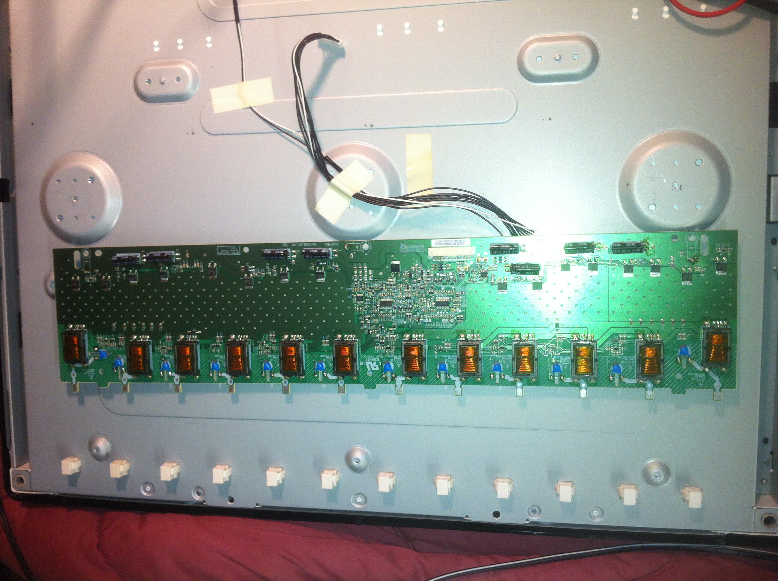

                That trick worked very well. I had to go through each one with a new power cycle since the inverter shuts down pretty quick. I had two questionable waves, not much smaller but by half. After I checked all of them I went back and retested them made sure my distance was consistent and they were fine too. So if the transformer putting out a wave at a consistent level at the same distance is a good indicated that the bulbs are working then they are all good!
                I am very stumped! One thing I'm confused about is I expected there to be feedback from the inverter to the system board. There is only two signal wires, BL_ON and BL_ADJ. There are empty spaces in both connectors next to those signals. Do some TV's not bother with feedback?

                      just noticed the inverter has darfon transformers on it,check all the secondary outputs resistance of each transformer,they all should be quite close ,use 2kohm-20kohm setting on dmm,these transformers have a high failiure rate,and will also cause your 2 seconds to black problem

                        CCFLs in an LCD get a pulse of about 2.5kV to start, then run at around 1.5kV.
                        I may have been wrong about the transformer trick; try touching the probe on the magnetic core of the transformer. (NOT ON THE OUTPUT! YOU WILL BLOW UP THE SCOPE!!) I am thinking maybe an inductor would help form a coil which would form an air gap transformer, allowing you to measure the CURRENT through the transformer, not the voltage across it.

                            I don't know exactly which pins lead to the secondary winding. I uploaded a picture of the pins I measured. The measurements were consistent with each other and with a second inverter board I have of the same part. From 0.81ohms to 0.82ohms.
                            The two smaller pins I suspect is the primary winding just measured a short, I don't have a meter sensitive enough to measure it.

                              pop one off,on the other side it should show you what pins go where.resistance should be between 1.8kohm to around about 2kohm,your primarys sound fine you tested,they should be low ohms readings

                                What is the part number on inverter transformer? Then see if you can find it at
                                http://www.lcdparts.net/T.aspx
                                That site will show you the secondary pins.
