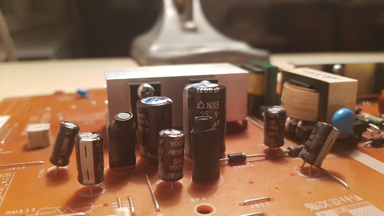

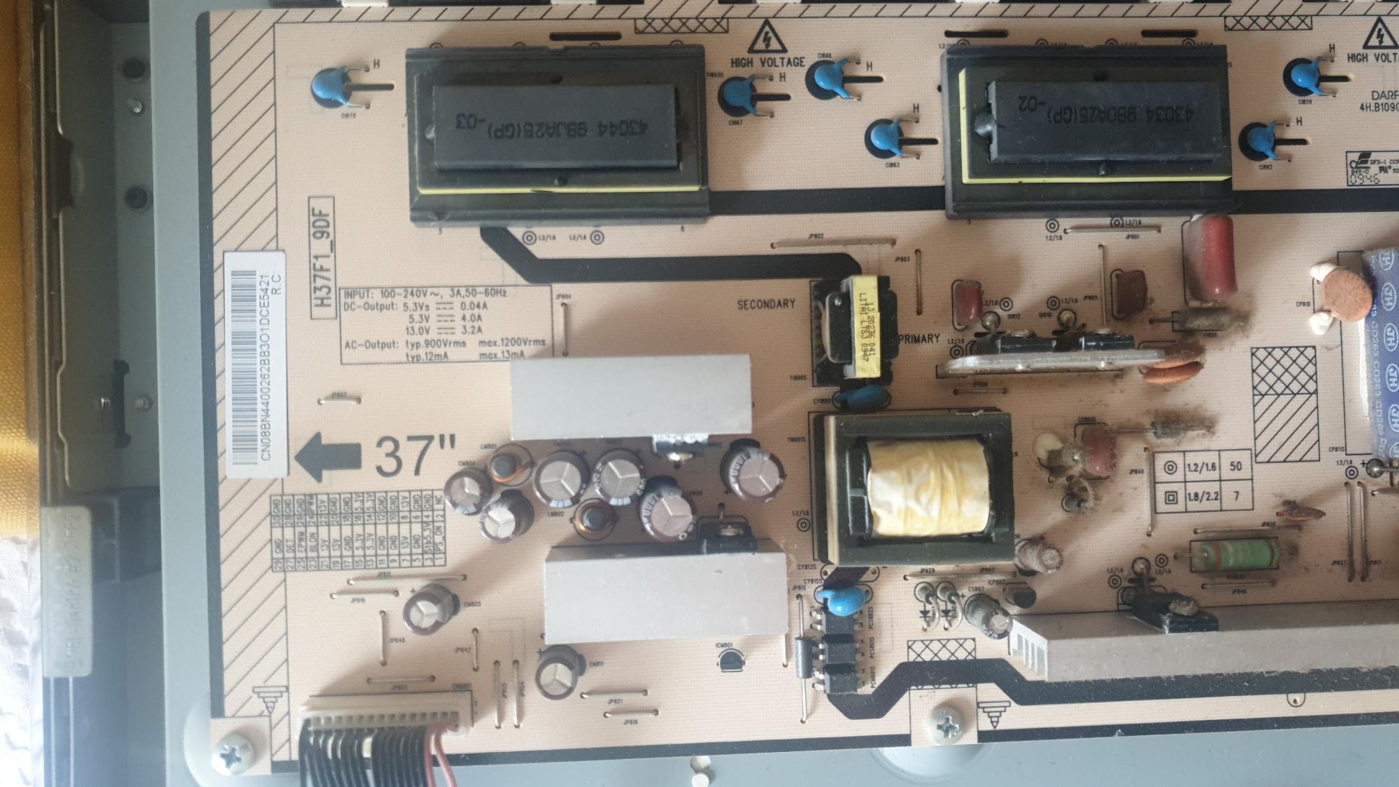

              Hi all. I'm a complete n00b when it comes to this, so bear with me.
              My father has a Samsung LE32B350 TV with a BN44-00289B power supply inverter. It started going crazy - turning on and off by itself, and then after a week or two it went completely dead.
              I took the board out connected it to mains, and got the following DC voltage readings from the CN802 pins with black probe on pin 16:
              1 - 0,77
              2 - 5,20
              3 - 0,00
              4 - 13,19
              5 - 0,00
              6 - 0,00
              7 - 5,20
              8 - 5,20
              9 - 0,00
              10 - 13,19
              11 - 13,19
              12 - 2,86
              13 - 4,82
              14 - 0,43
              15 - 0,00
              Also, I measured DC voltage on CP815 constantly shifting in the 393-395V range.
              Does this mean this board is OK, or could it still be faulty diodes? If yes, then I need to figure out how to test diodes with my cheap instrument. (Any pointer to which diodes I can get instead of the ones on the board are welcome; I don't know if there is anything, e.g. amperage, that I need to watch out for when getting them)
              Thanks!

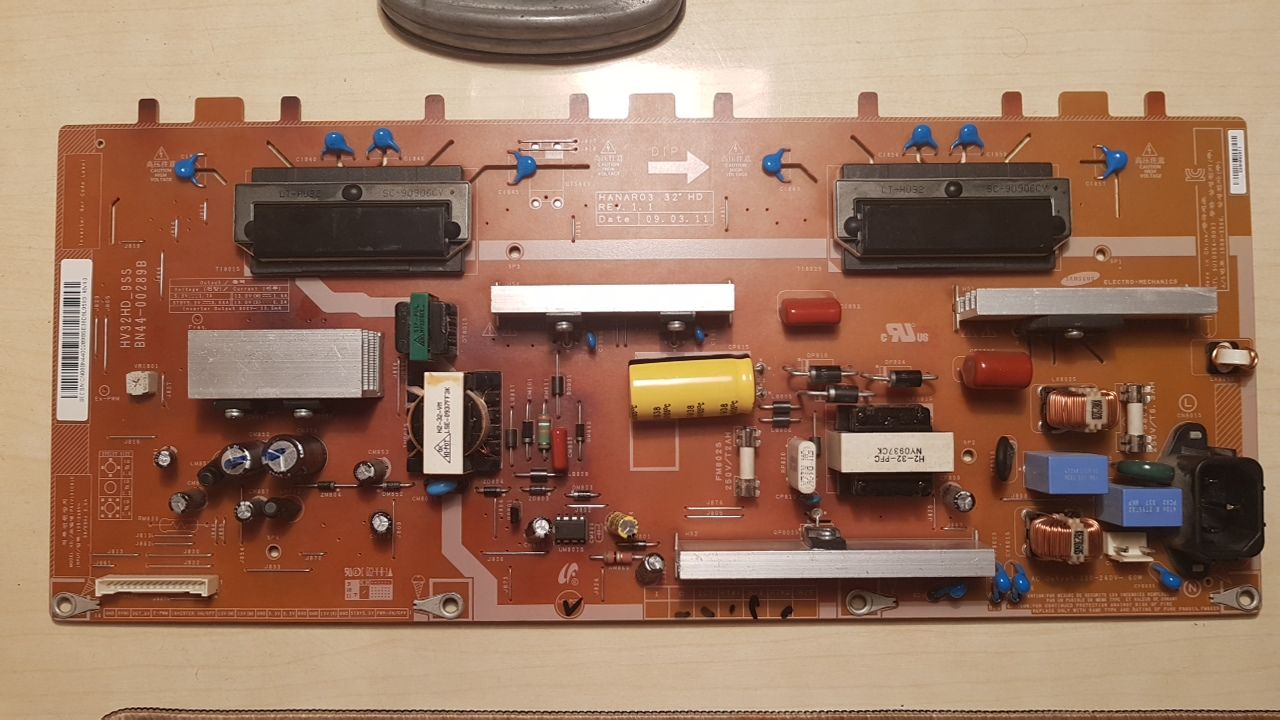

                #47
                Re: samsung 32 ln32b360c5d no power no indicator
                Here is also a picture of the board. Area around those fishy diodes is suspiciously darker than the rest of the board, as well as the area to the top of the leftmost cooler in the picture. Bottom of the board has no visible damage anywhere. Top of the CM852 (1200uF, 10V) capacitor looks slightly convex (other capacitor tops are concave), but it doesn't look blown to me.
                • vinceroger69
                  • Mar 2012
                  • 6714
                  • uk
                  #48
                  That one capacitor does look bad as has slight bulging top but as theirs only 11 small capacitors i would first start by changing them all as capacitors can fail with bad uf ratings and also bad esr .
                    #49
                    You should have put the pin label for each pin to make it easy for us to know which pin has correct Voltage.
                    "14 - 0,43" That is the DET_5V which is the inverter error signal pin, it should be high (>2.5V) if the inverter section is OK.
                    But since you have bad cap CM852 (CM854 is also part of the STBY filtering) which is for the 5VSTBY filter so the main board is probably not getting good 5VDC feeding it.
                    You should at least replace those caps in that cold side of the power supply.

                      #50
                      Thanks guys on all the help. I'll go out tomorrow and get the caps for it.
                      Two questions though:
                      1) What is the cold and what is the hot part of the power supply? I mean in general? in this board I presume that would mean exchanging those seven caps in the lower left in my picture?
                      2) Can I put higher voltage caps in place of the lower ones? E.g. I have a 1200uF 35V one available, and CM852 is 1200uF 10V while CM876 is 1200uF 25V?
                      Edit: Success! I replaced that single cap, and now it turns on. Thank you once more!
                        #51
                        No need to go higher Voltage rating caps, just use good brands LOW ESR 105c caps such as PANASONIC FM/FR/FC.
