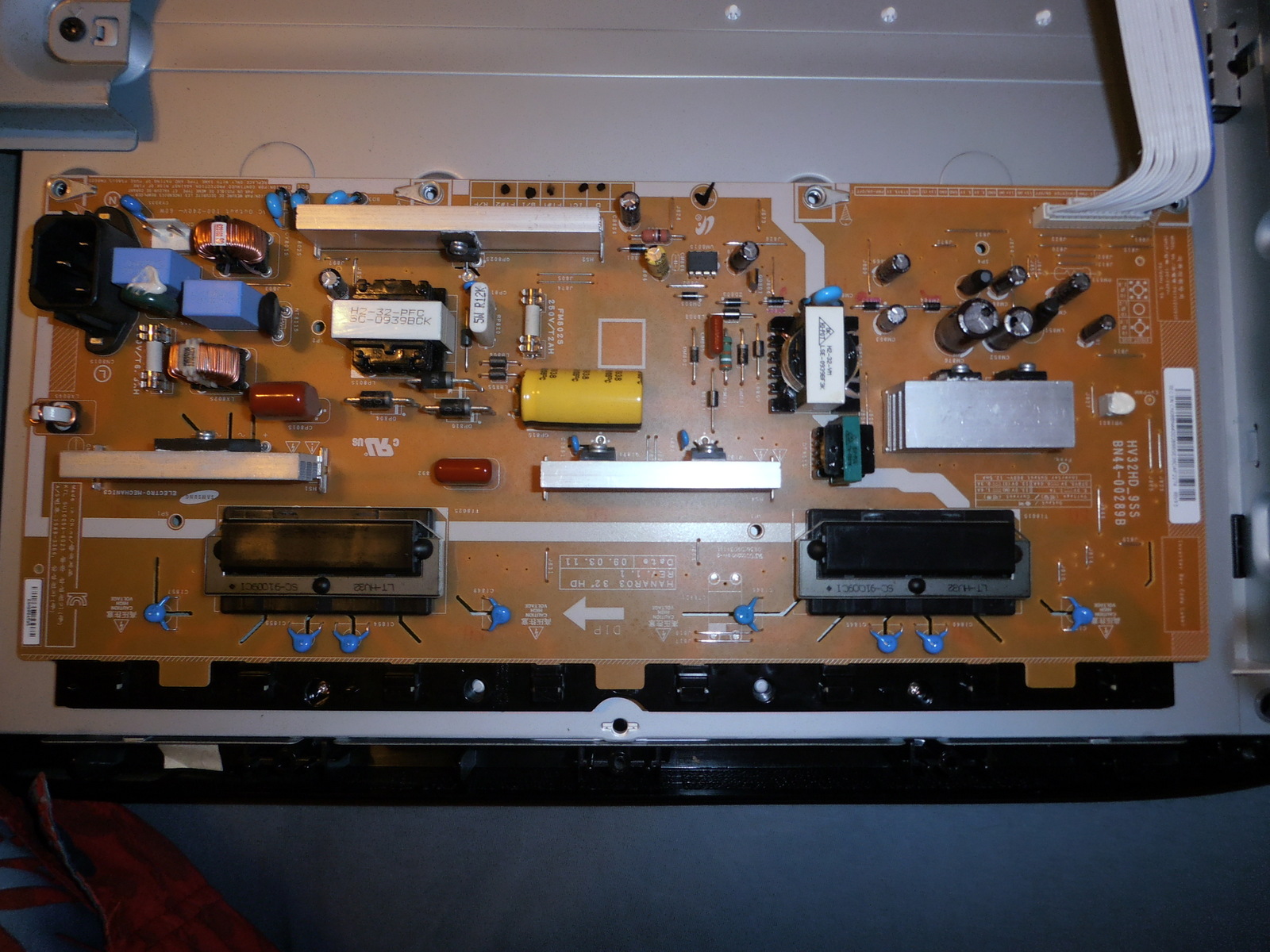

    samsung 32 ln32b360c5d no power no indicator
    hi i have samsung 32 ln32b360c5d that i bought off craigslist hoping it was bad caps. that was not the case all of the caps look good and all the fuzes are good. i tested the power boards output pins and all tested 0 dc v except three pin4 (e-pwm) pin6 (13v (m)) and pin7 (13v (m)) tested 5 m volts. thank you in advance for all your help.

    i retested the power board thinking i should use the ground pin as a ground and when i did that there was 0 v on evey pin. i also tested the three big diodes and they are good.
    Can you test a zener diode with a dmm diode test because i am trying to test all of the diodes and one zener diode reads .361v and .193v
    The model of the power board in hv32hd_9ss bn44-00289B

      Re: samsung 32 ln32b360c5d no power no indicator
      check the startup cap in the power supply, it will usually be a smaller cap 10 to 47 uf somewhere close to the main filter cap(big ones)

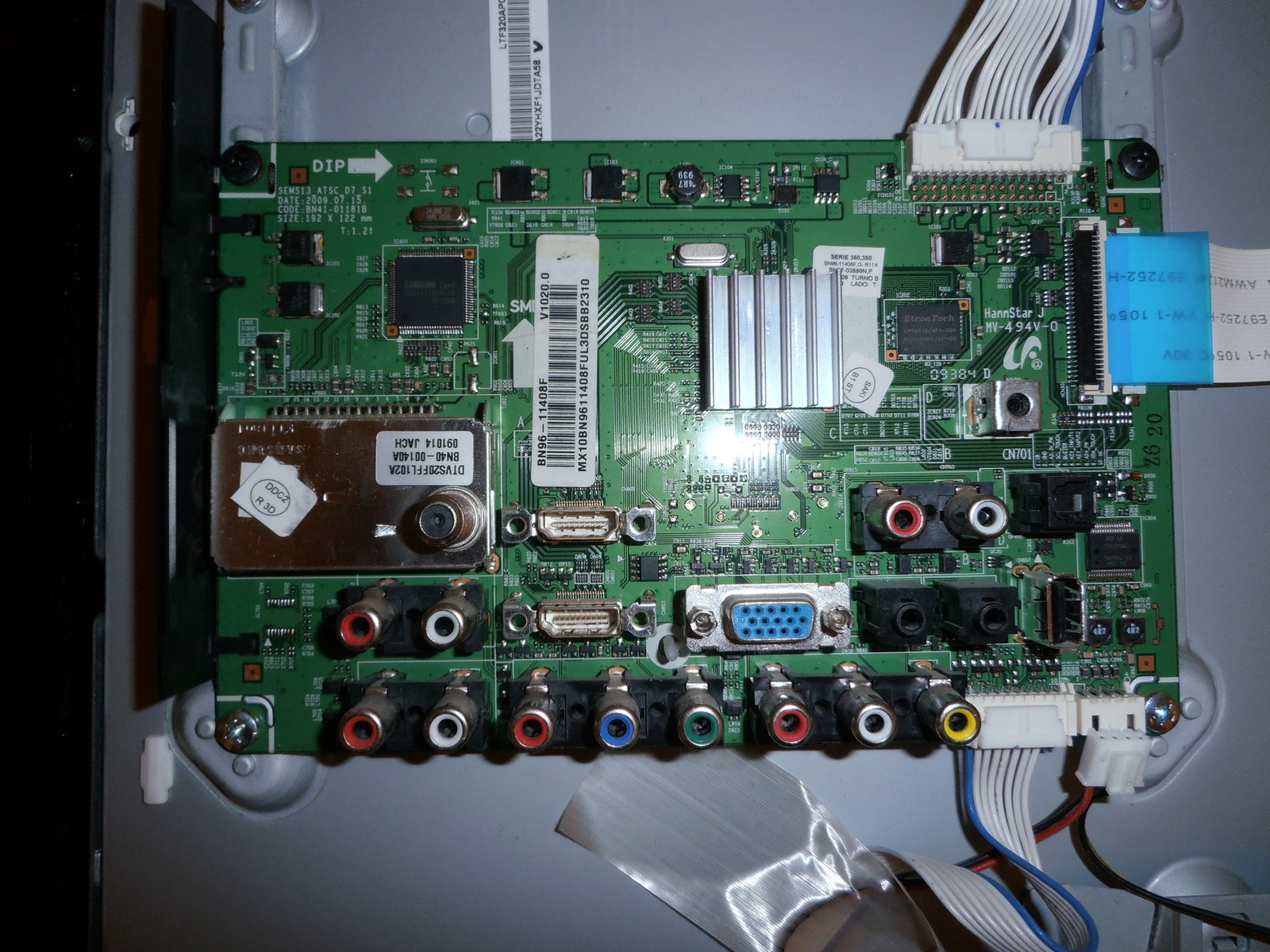

        Please upload the pictures of all the boards so we can see how they are connected, then good clear pictures of the power supply board both top and bottom.
          here is the pics and power board schematic
            What DC voltage do you have at the main DC filter CP815, 100uF 500VDC.
            This TV has PFC circuits, when the TV is off, you should have about 170Vdc on CP815, when the TV is on, you should have about 400Vdc on CP815.
            The standby power supply (always on) is generated by IC UM801S (ICE3BR0665), produces 5V and 13V standby voltages.
              cp815 reads 162.3 vdc
                                I think i found three shorted diodes. (zd804, dm852, zm804) I ordered the parts and will hope that will fix it.
                                  it is fix
