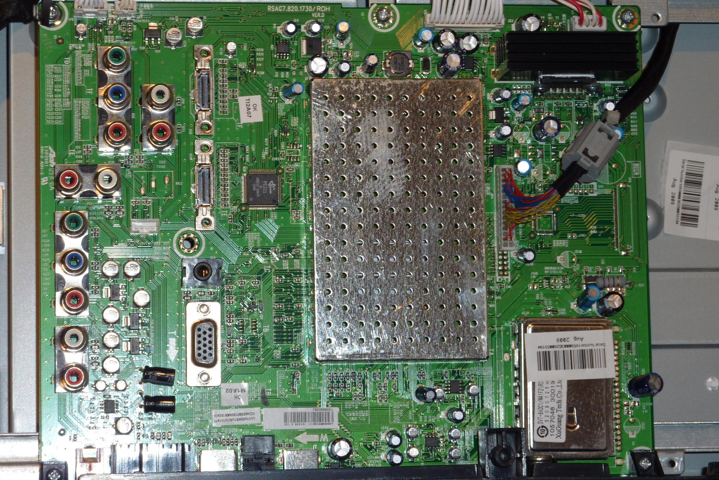

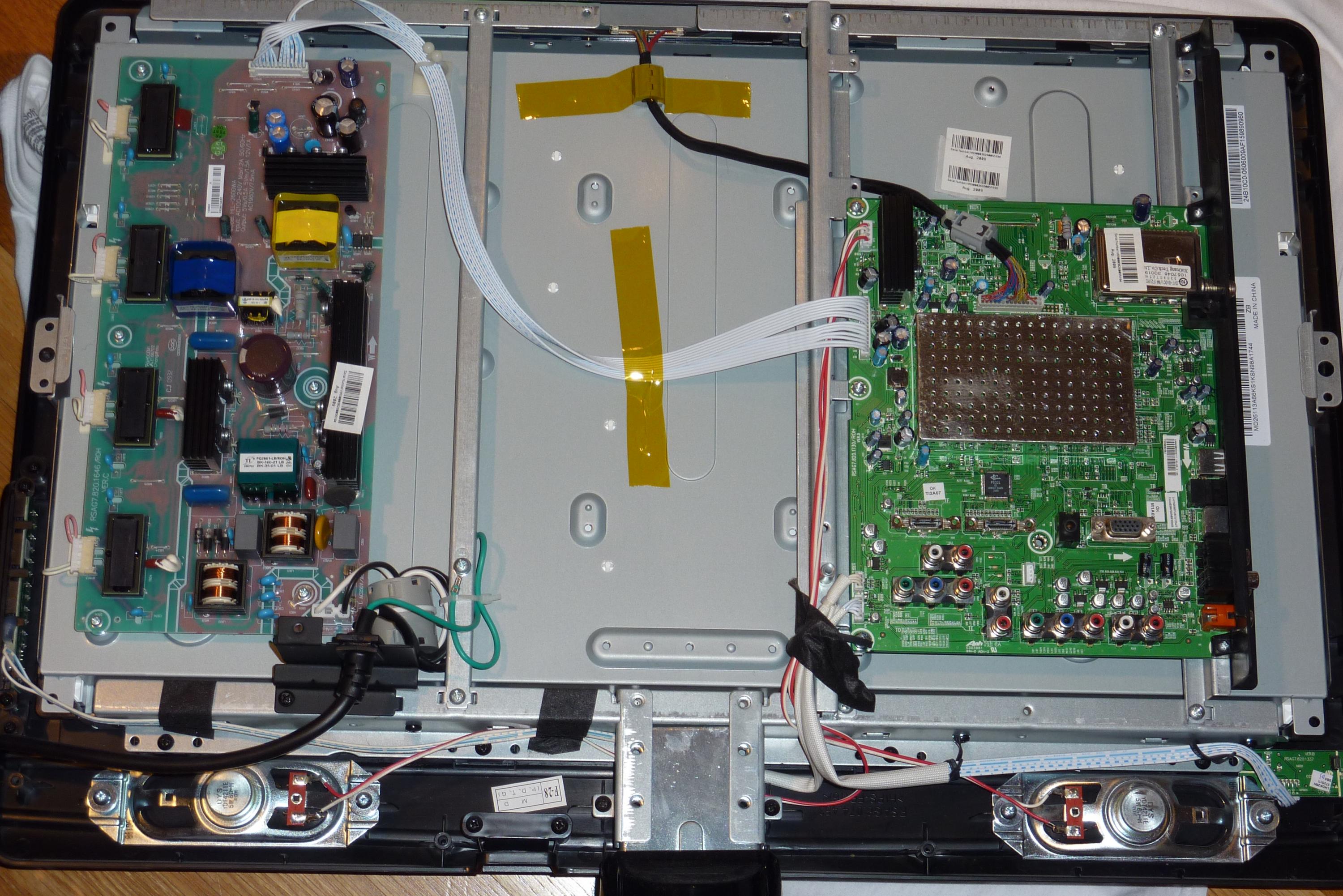

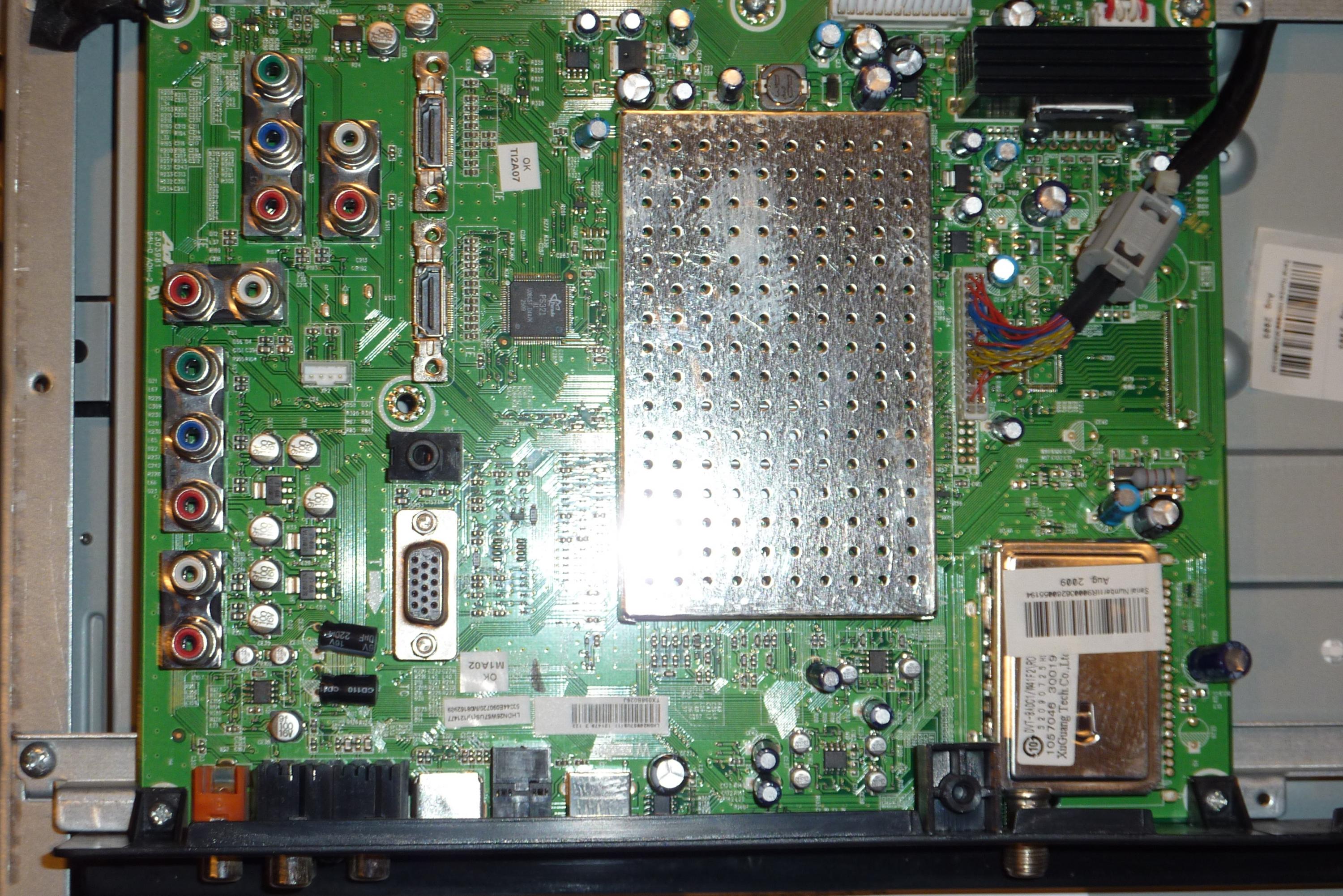

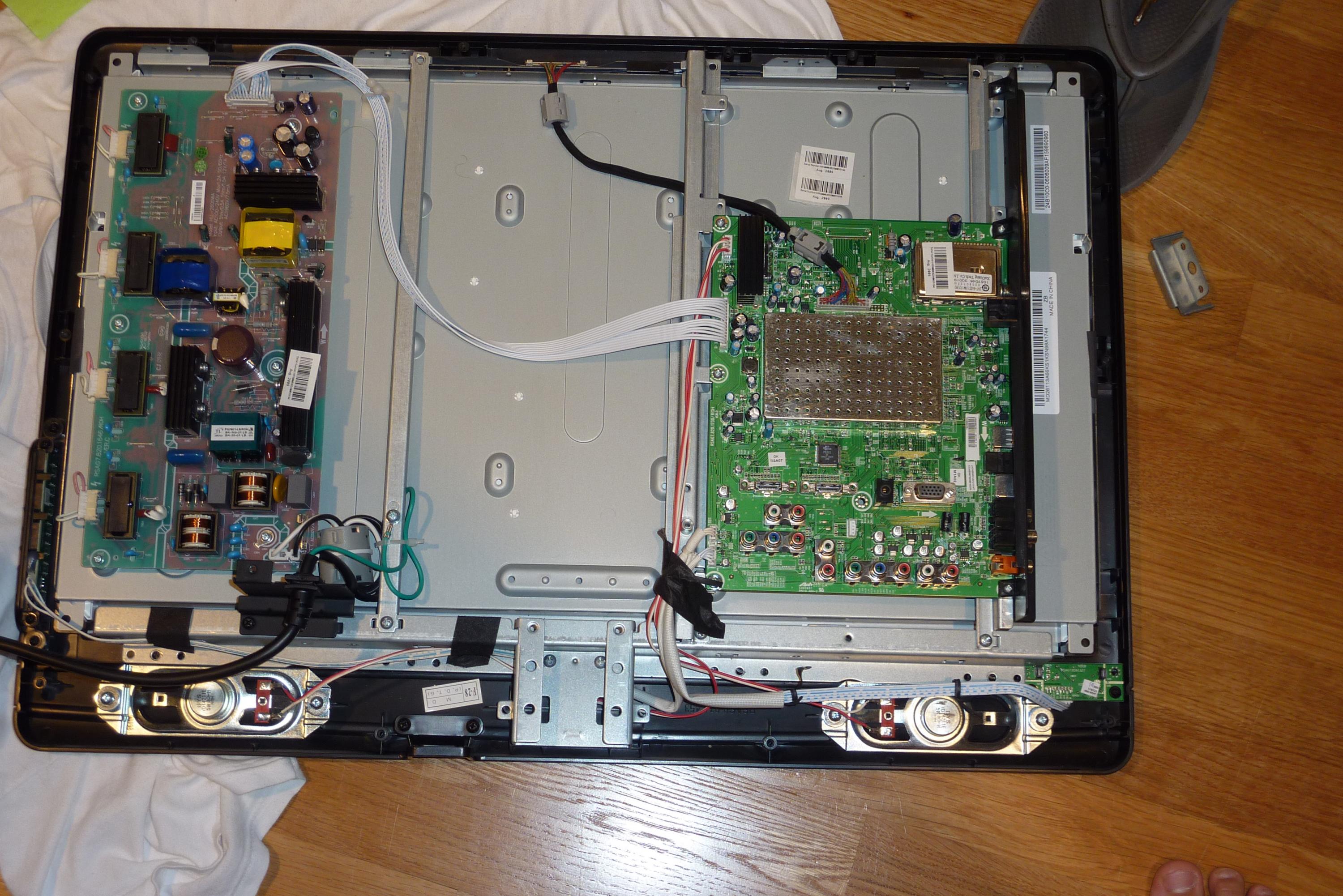

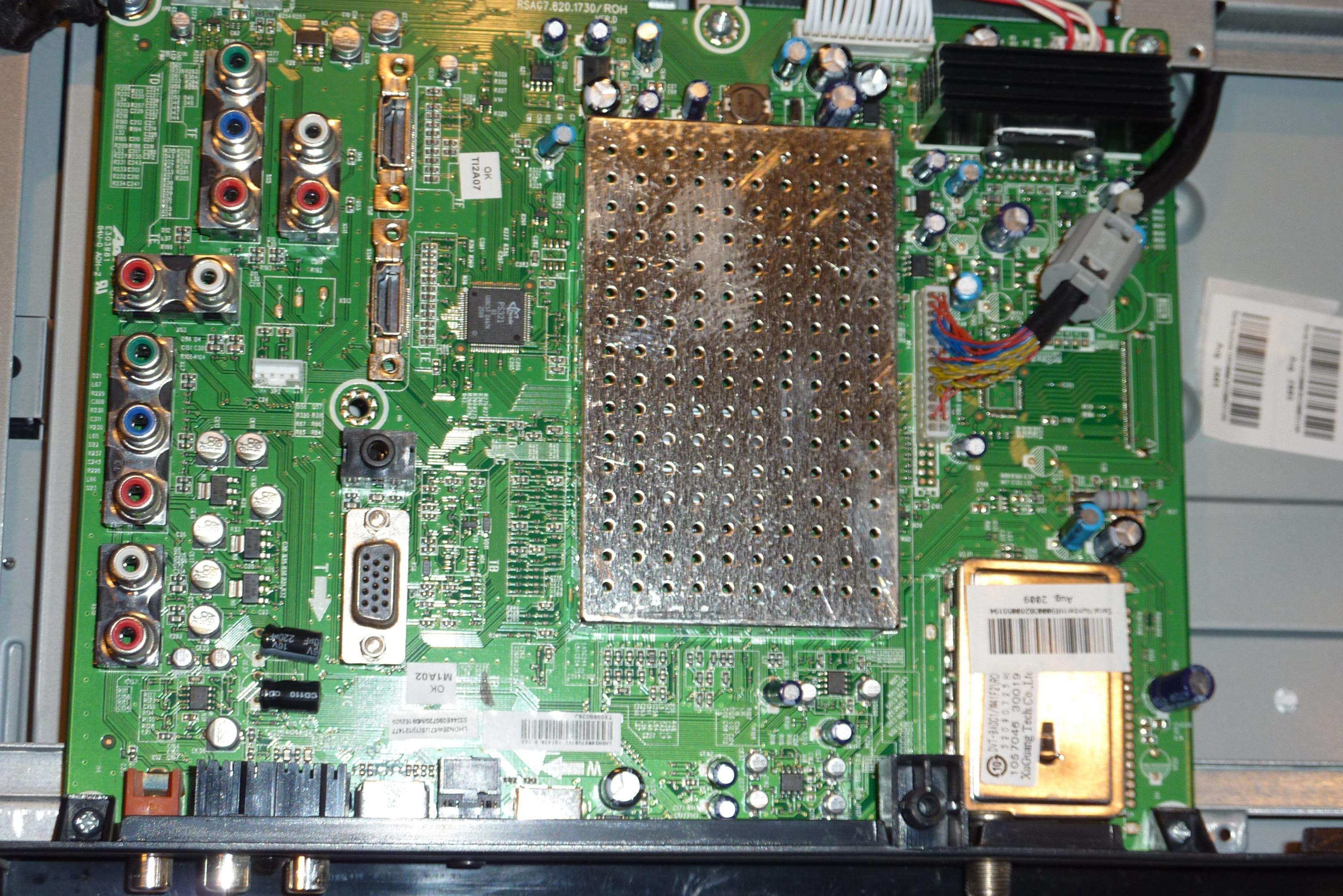

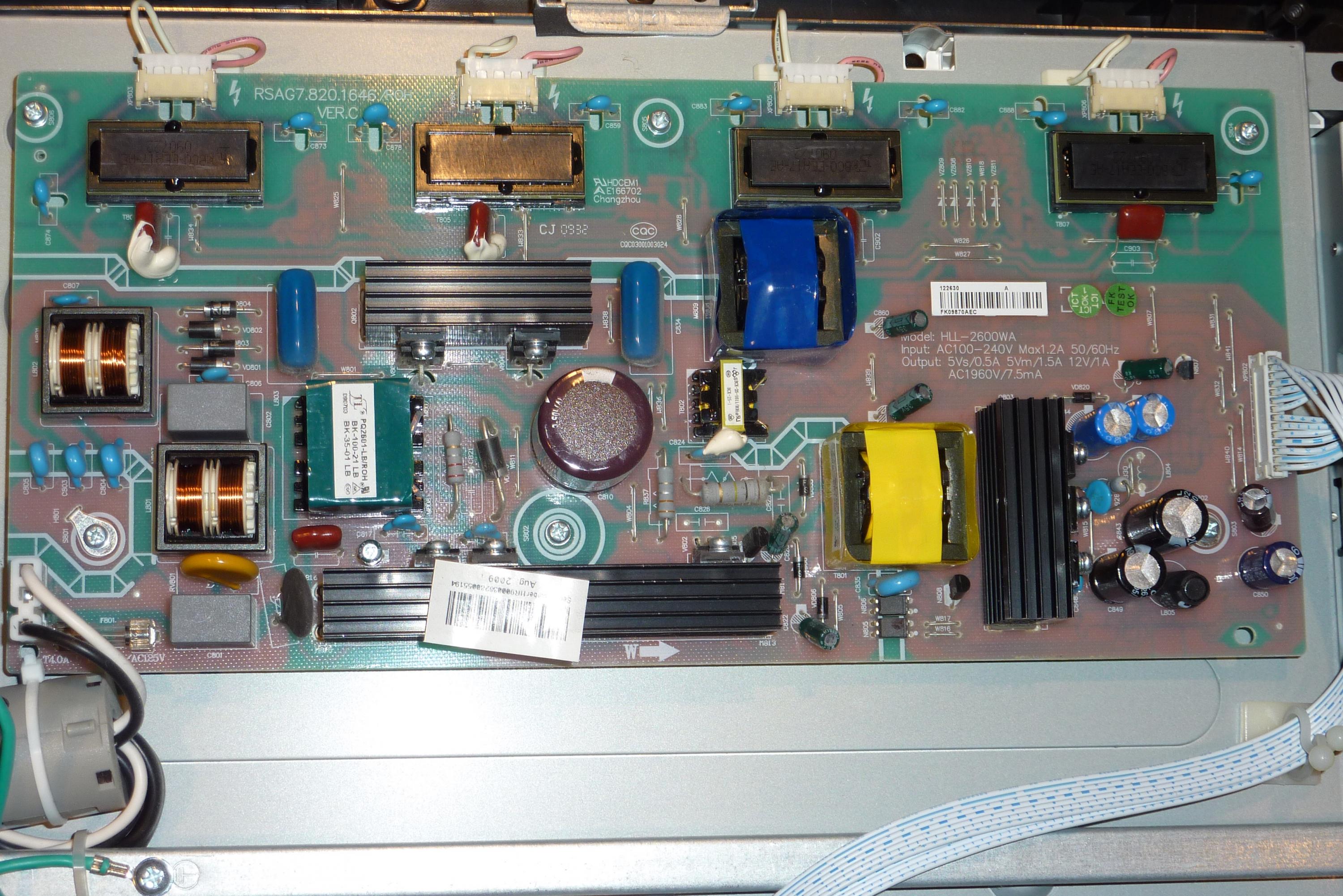

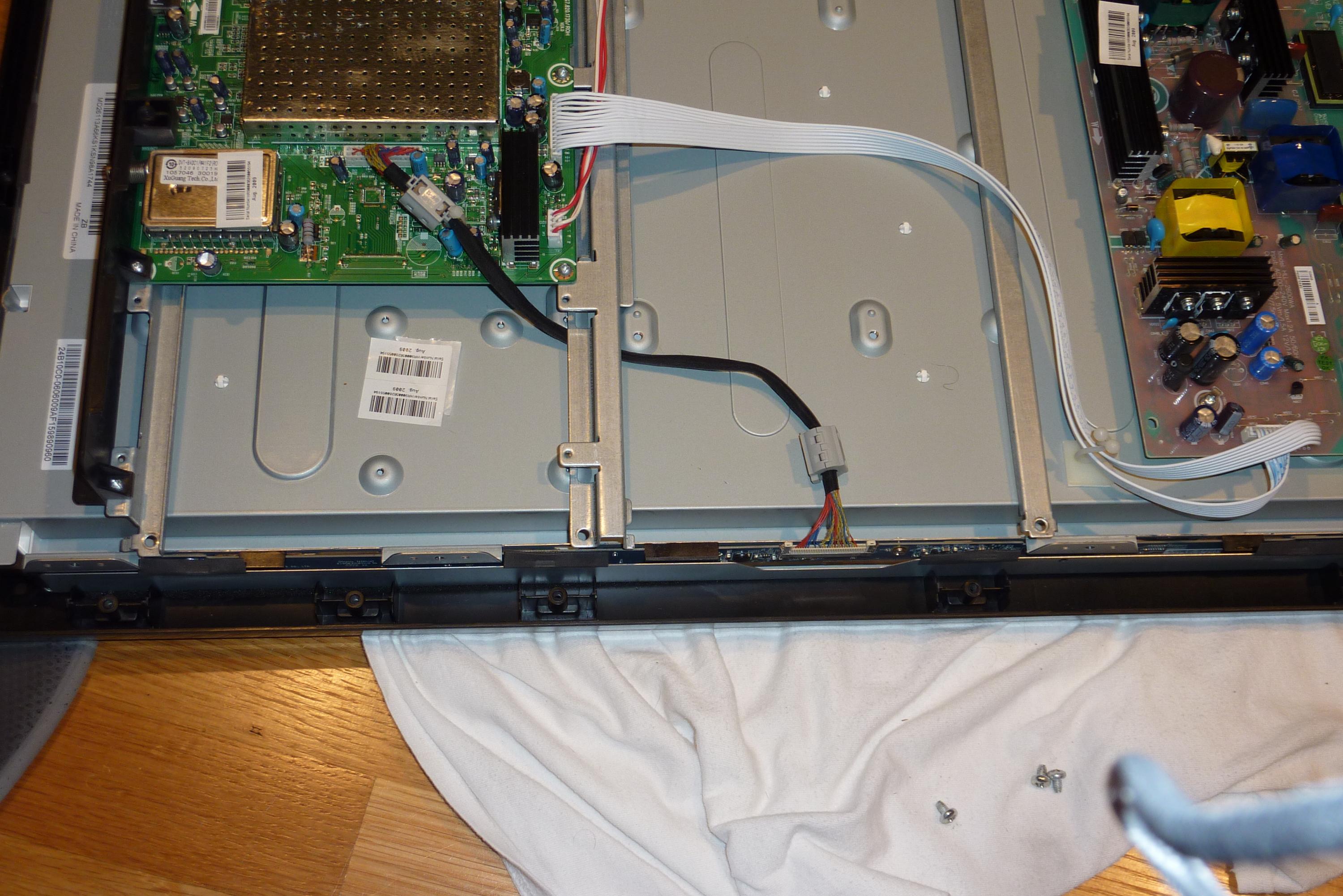

    I have a 26" element tv (Model number ELCHW261) and whenever I turn on the tv the screen freezes and whites out. I have the back taken off of it and I can't seem to figure out what is wrong. I am new to electronics, this being my first project, and I want to figure what is causing the issue and how to fix it.
    I have pictures for aid, they require a few clicks to the get them to full size though.

    Do you get any picture or just a white screen? If the latter, there may be a blown SMD fuse on the t-con/panel board at the top of the tv. A good fuse should measure less than 1.0 ohms on a multimeter.

      As per previous post, did you try pulling, cleaning and replacing all cables/connectors. Flat ones can be cleaned with isopropyl alcohol (IA) on a qtip and pins with IA on a brush.

        This TV panel has integrated T-CON, it will not be easy to get access to the T-CON board, you do need to check the fuse on that T-CON.

          It turns on but it freezes on a skewed picture of the element logo when it turns on the the screen whites out. The picture does come back after about 15 minutes of just sitting there as long as the tv doesn't turn itself off.
          This may be stupid but again I'm still learning about all of this what does the fuse on my t-con board look like?

            normally t-con fuses will be white,with a letter on it,ie D E etc,also look for fxx on the printed circuit board

              but your panel T-CON board is under the frame, you need to disassemble the panel to get top the board. But since you can see the Element logo on the screen, then the fuse is more likely to be OK but it may have problem with regulators on that T-CON board.

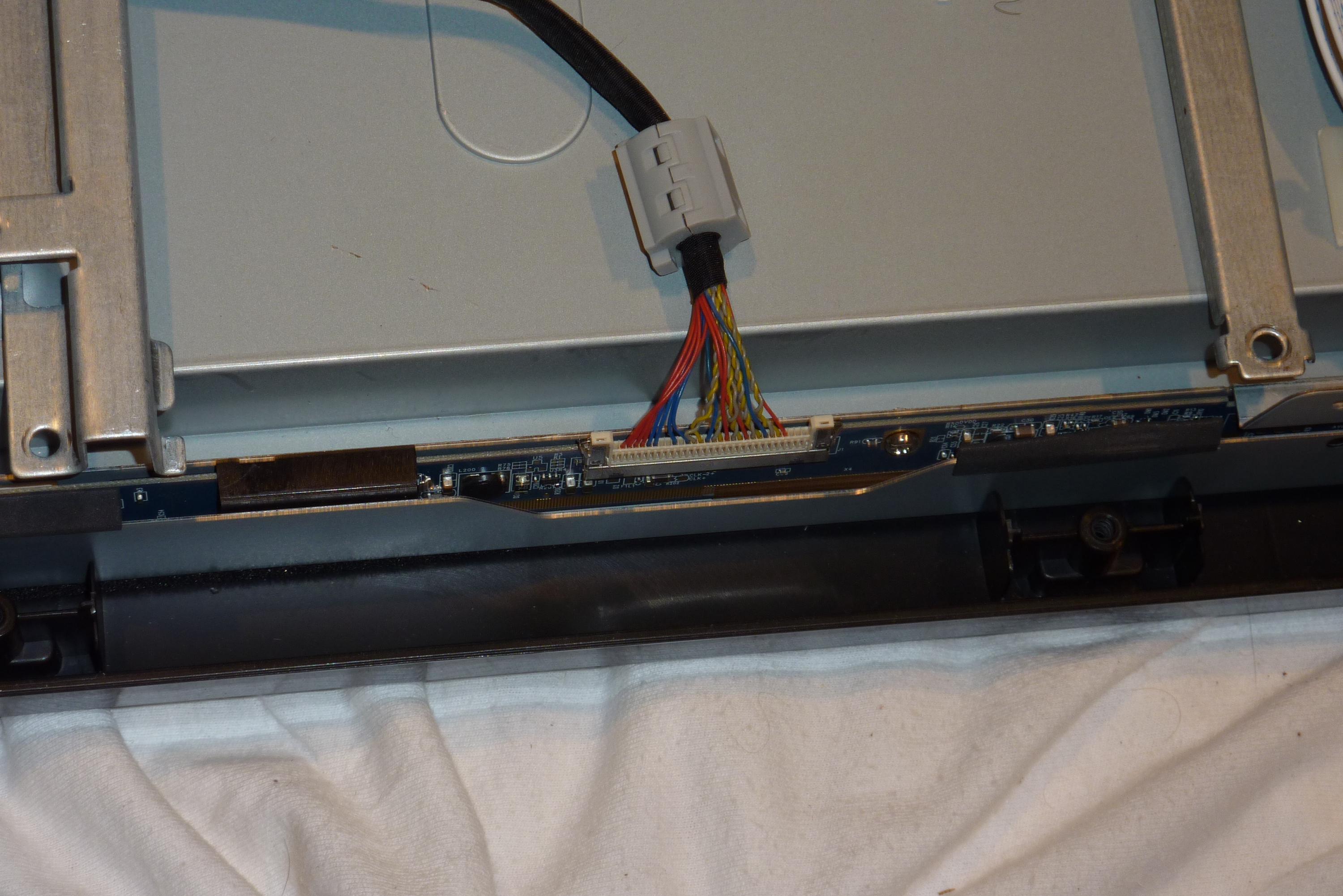

                It's sitting near the top then under all of the metal framing? That is what I am assuming. There is one cable going to the top of the tv, which is the t-con board then?
                  Re: Element 26" white screen
                  Yep, that T-con board is under that LCD frame assembly, you will have to take the panel apart to get to the board.
                    So I have the frame unscrewed but I can not figure out how to lift it off to get a good view of the board. I can see parts of it but don't know what I am looking for.

                        It seems like the cables and connectors are stuck on the boards pretty well I have tried pulling them off but they don't seem to budge
