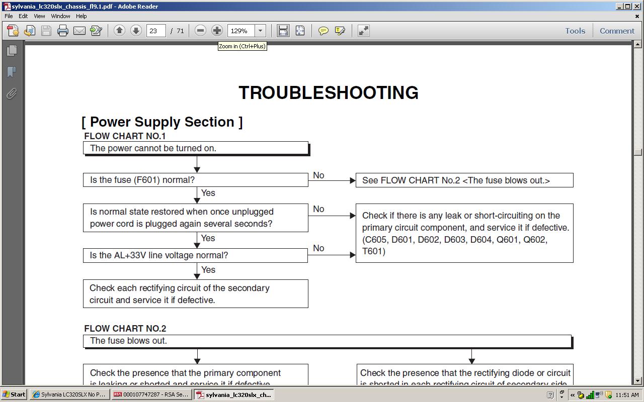

                    OK so I will replace C605 (do you think this would be the cause of the TV not coming on, i.e. replace before continuing?)
                    And according to SM, that leaves Q601, Q602, and T601 to check?

                      Re: Sylvania LC320SLX No Power-Dead
                      yes your al33v should be al33 if your getting 7volts thats to low and will not work your al33 volts comes from diode D638 also your al3.3 comes from IC631 pin 2

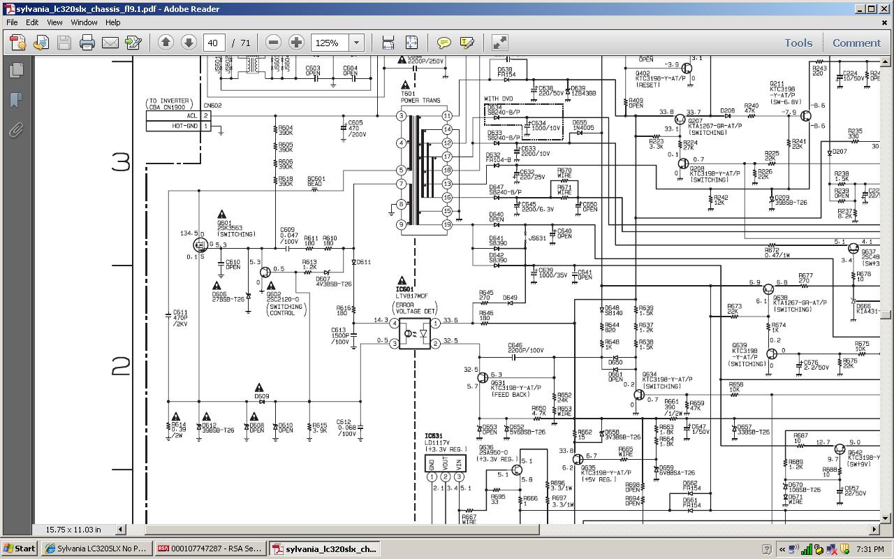

                                  Hey Ron can look at page 37 of SM Block Diagram pin 2 of IC601 is 7.7v same as D638 also see a feedback circuit, any relevance?
                                        ok something sucking up our voltage on cathode D638 we need to start eliminating things on that 33volt line thats killing our 33v
                                        located R661 lift one side then read voltage again @ D638 see if come up
