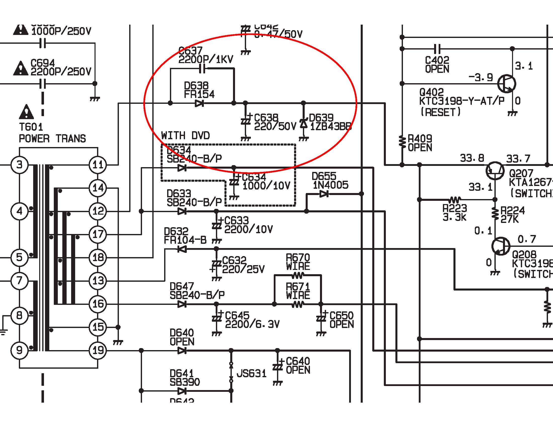

    So can you help me understand what I should or could be looking for on my own? Does it seem to be a short on the secondary side, etc? Earlier I asked if lifting cahtode leg of D638 would isolate that AL33v circuit from D638 which is the source, is that true? Why are my other voltages low aswell like Q601?

      kevin in theory by lifting the leg of D638 if there was something loading down that line our 33v should have come back up on just the cathode leg of diode we lifted,now from the rest of you standby voltages like the al13v thats low course now that the 2 pins were touch over on Q601 that transistor could be bad now

              If you look at the diagram, D638 is the rectifier (It gets its AC from transformer pin 11) that feeds filter cap C638 and the clamping Zener Diode D639. If you lift the leg D638 then for sure you will not have the 33V. I would look real close at that Zener D639, and that filter cap.
              I do not understand why you expect to see 33v when the D638 is not in place.
              Unless I am missing something.

                  it does get it's Ac input from pin 11 T601 but if you lift cathode side of D638 you should see the 33 volt dc come up on the cathode,D639 would not prevent the 33 volts unless it was leaky or shorted and he did say D639 was good,be same thing if we had cold solder joint on the pad but at the leg we had the 33volts

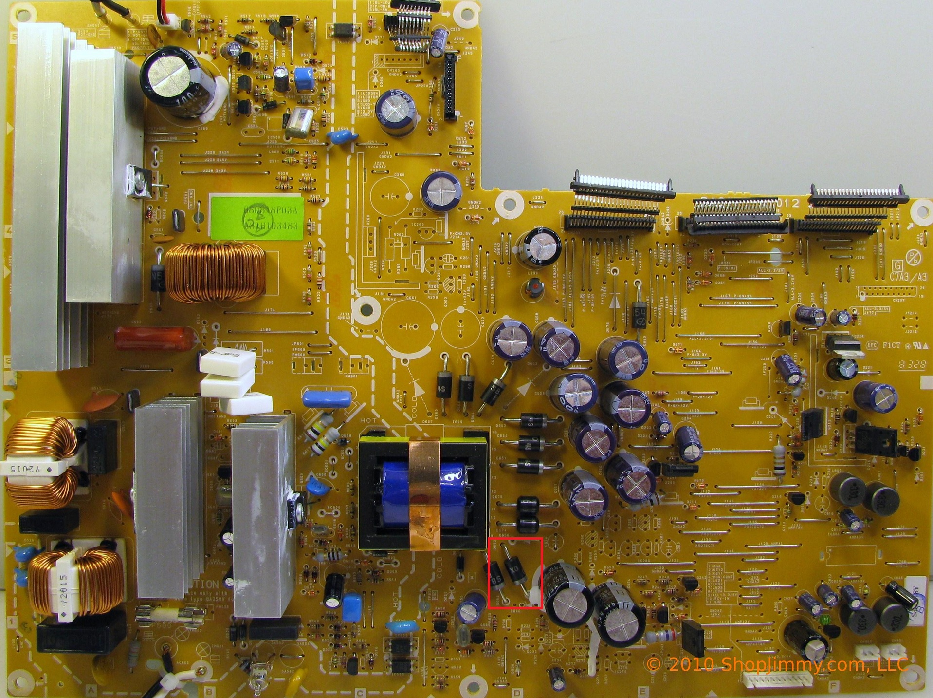

                          I checked all diodes and resistors on the primary side, it's a big board and wasn't sure if it was practical to lift every resistor and diode on the secondary side without being instructed.. This is my board:
                          http://www.shopjimmy.com/sylvania-a9...unit-board.htm

                              This was the diode that was shorted on my last sylvania that was completly dead. I never lifted any of the diodes. I checked them in circuit and if it read 000 then i removed to verify.

                                    You will not see 33Vdc at the Cathode of the Diode since there is no cap to charge up to the peak of AC. You can build the circuit and test out that theory, all you are getting is the high frequency at the only half of the cycle coming through.
                                    How do you think you get about 170Vdc when you rectify 120VAC, 120 X 1.414 =169.68VDC.

                                        It is just a simple half wave rectifier set up with filter cap, nothing special at all.
                                        Take a 120 to 6V transformer, attach a diode to one leg of the transformer, take a DC meter one probe to Catode, another probe to the other lead of the transformer and see what DC you get at the Cathode, then attach a 10uf or so to the Cathode and another end of the transformer, I will bet you will not see 8.48VDC without the cap.
