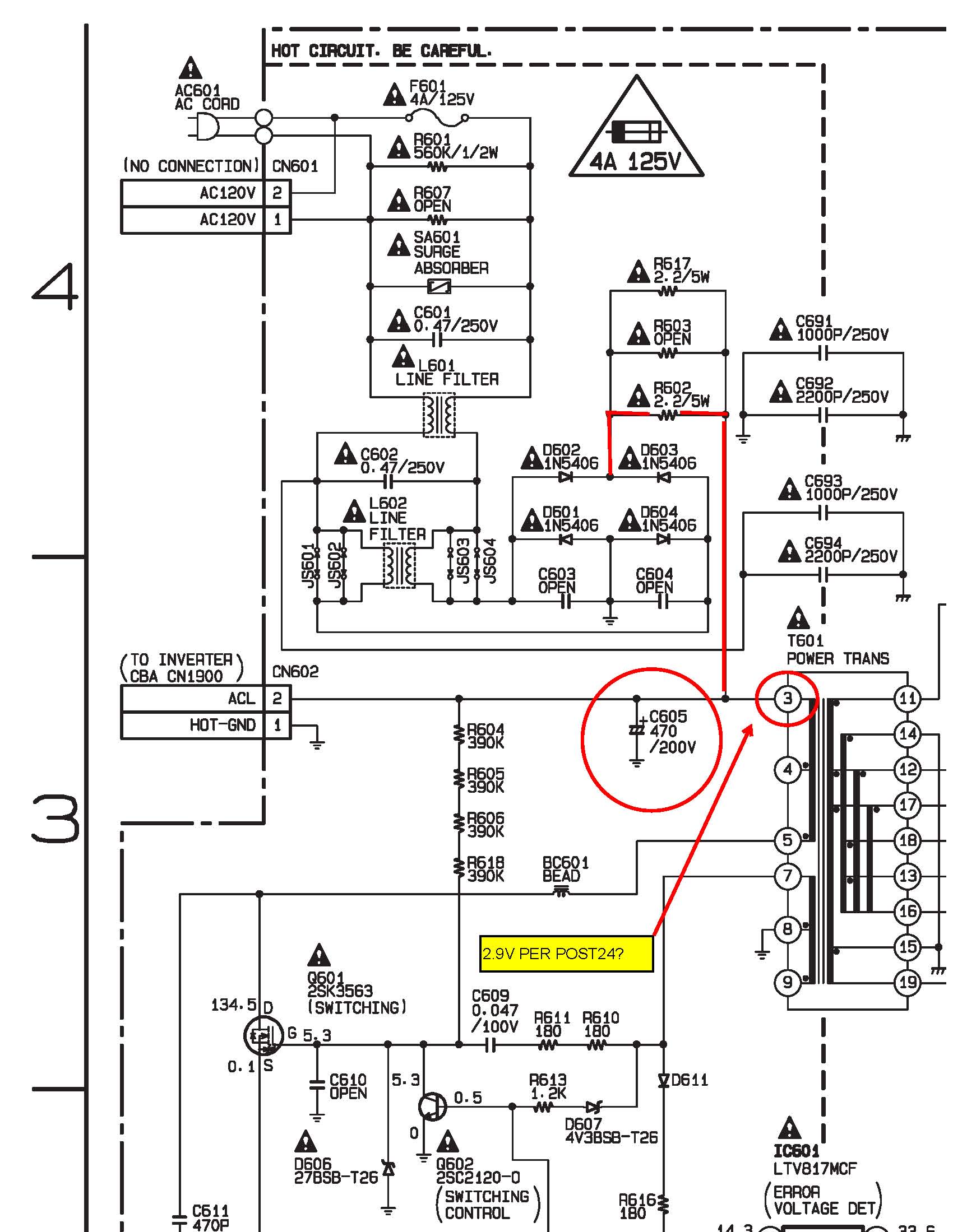

    What do you get at pin 3 of T601?

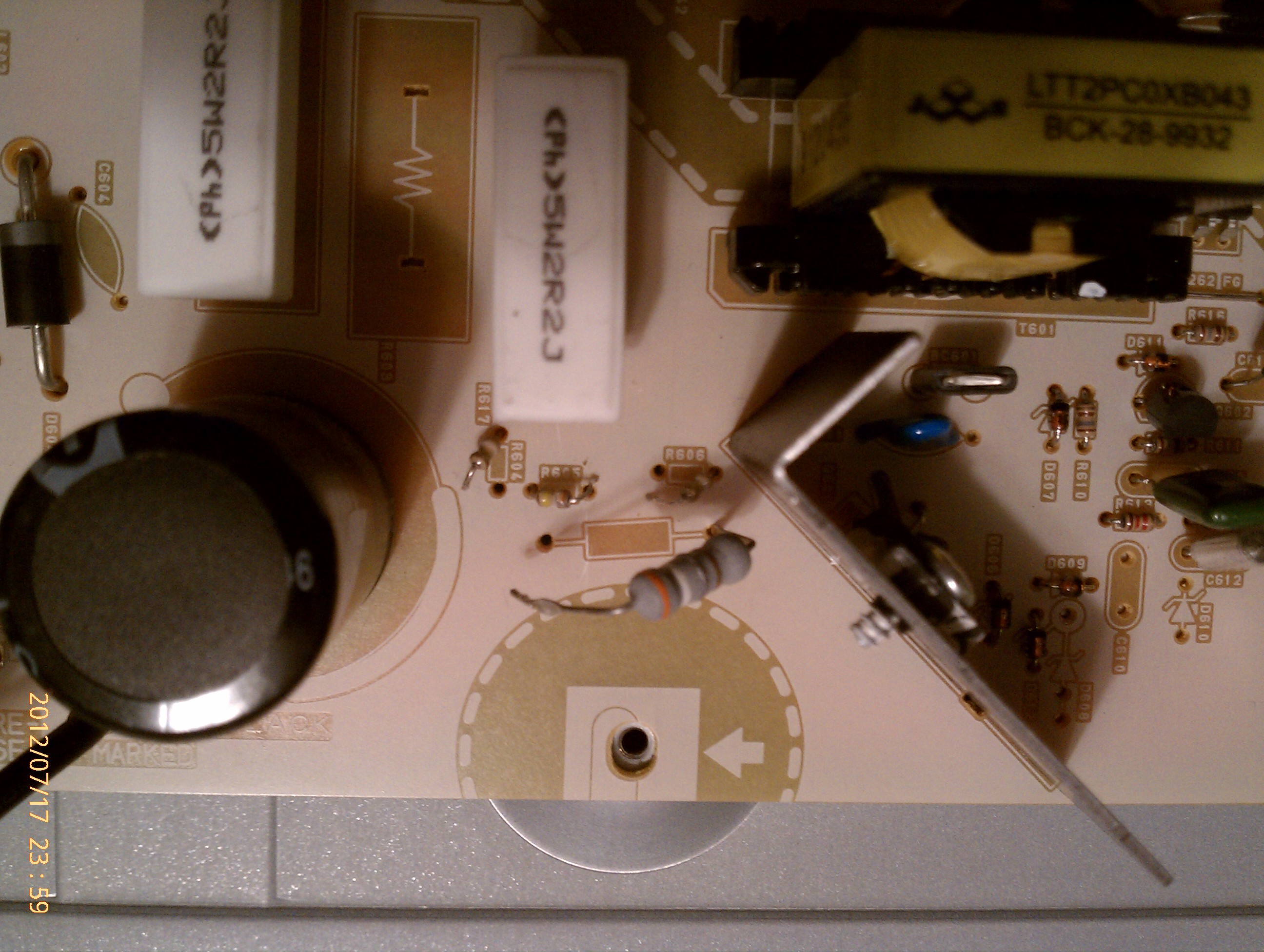

      Think I may have found something. Figured I check this group of resistors.
      R604 tests open
      R605 and R606 test good .392-.395
      R614 the large resistor test 0.000?
      R604-606 RES CARBON FILM T 1/4W J 390k Ω
      R614 METAL OXIDE FILM RES. 2W J 0.39 Ω
      Could R604 be the problem? What about reading on R614?

        Let me resolder them and Ill check.

          If I'm checking correctly 2.9v
            Re: Sylvania LC320SLX No Power-Dead
            From the SCH, the line voltage is fed to L601, L602, then it goes to 4 Diodes D601~604 bridge setup, the + output feeds R602, 603, 617 then the output feeds pin3 of the T601.
            So check all those connections of all those component, and the resistors.

                        OK Ill try that. Also Im curious why the large resistor (R614 METAL OXIDE FILM RES. 2W J 0.39 Ω) gives me a resistance reading of 0.000?

                          R614 if you are reading this in circuit your going to read just like short due to one side is connected to ground,but what i do is remove one side of R614 to read and you should get about .3 ohms also the zener diodes there D608,D610,D612 should not read shorted to ground in circuit

                            I pulled 1 leg of all the resistors and R614 still read 0.000

                              how accurate is your dvm? also you do have a tolorance factor but either way you should read .39 ohms plus/minus i say 10% out of circuit

                                Well now Im not sure how accurate it is, it's an Ideal Digital Multimeter, model ND 3267-1.
                                I'm definetely not getting a reading on that resistor but the other ones were very close so I don't know.
                                Maybe it is my meter the lower resistance ones seem to be the problem Ill have to try to change batteries first. In any case that one R604 is the only one that looks open so I will try replacing that and report back. Thanks!

                                  You know, pin 3 of that T601 was reading 2.9V as indicated in post 24, that power supply section is an always on, so if you got the shock from that large cap, then that reading of 2.9V cannot be right.

                                    agreed budm cuase that voltage should be around 135 volts DC

                                      I have feeling his meter is not working right.

                                        You're right Bud but not my meter, the main fuse FH601 is blown, must have happened with the spark...
                                        At Pin 3 of T601 get 166v

                                          You said I should be getting 135v is something wrong if Im getting around 165v which is what Im getting off of large cap?
