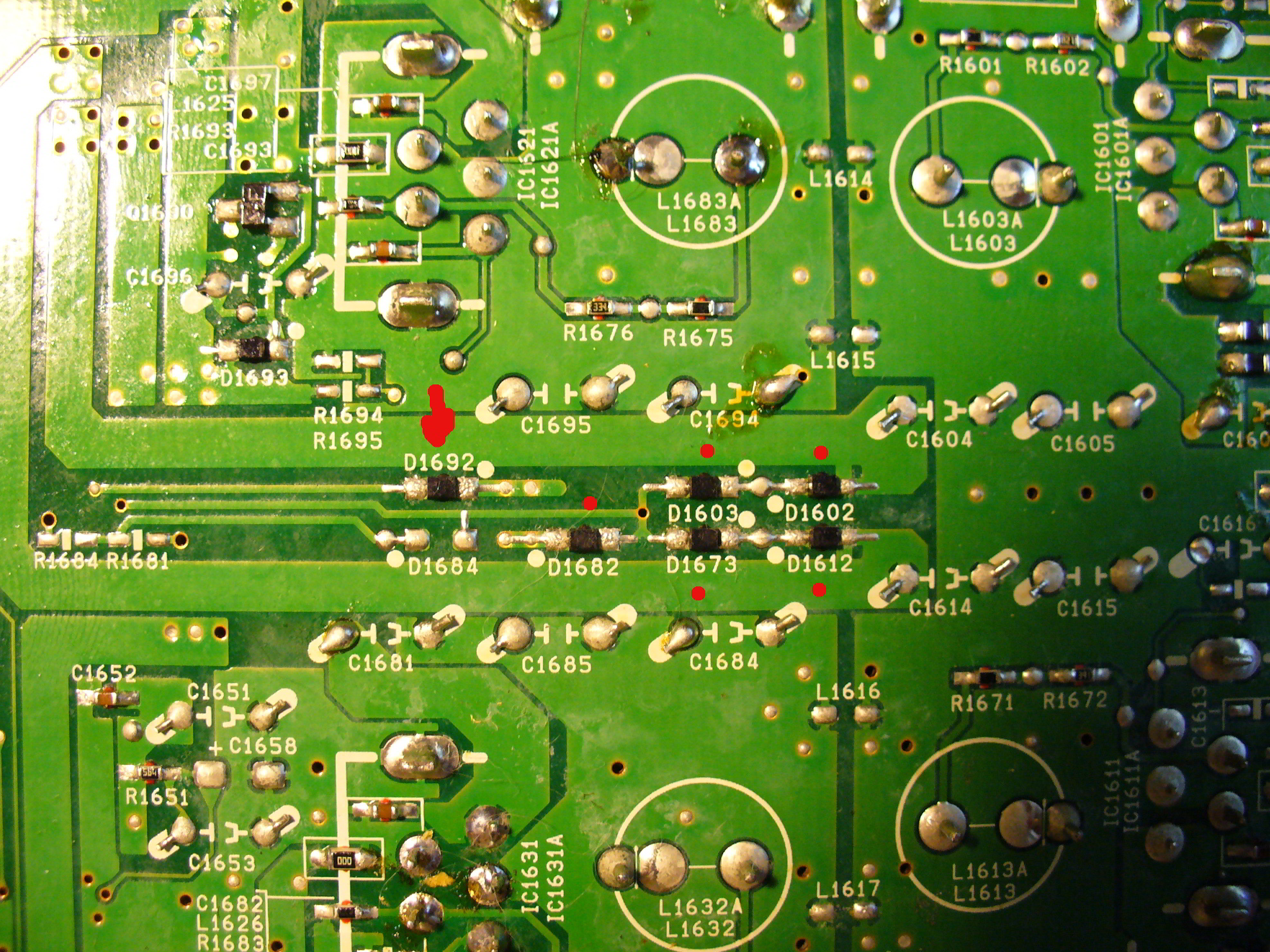

Sanyo DP26746 LCD TV-sound,no picture,lamps are on.

    Take this diode and retest it out of circuit.
    Tests good with dmm and with load.
    • retiredcaps

      Re: Sanyo DP26746 LCD TV-sound,no picture,lamps are on.
      What are the readings?
        .335
        L
        I put a new one in its place. One from NTE. 89 cents only.
        There are several smd diodes on the foil side of this board at and near the ICs tested. All but one test L and .5XX-.6XX. One tests .524 & 1.89 (D1692 red arrow picture). On the component side of the board there are more and they all test out .5xx & L.
        http://www.datasheetarchive.com/1SS3...datasheet.html
        I guess I should pull that smd and check it off board? Looking this weekend for some junk board to practice on removing and soldering smds. Looks kinda ez on youtube.
        I read these can be tested on board but I can't find anything about if there is a short will it cause the later smd diode to give that kind of a reading, as in current going around it?, or if that diode is the bad shorted component. I'm guessing/hoping the later.
            I never seen a multimeter just display "L" for out of range. The most common is "0L" and if you have a radioshack model, it might be "0F". Getting these things correct is important because we cannot see what you are reading.
            D1692 is good. Depending on your multimeter, some of them don't display "0L" until the voltage is > 2V or 3V. 1.89 is "close enough" to 0L.
              Opps, sorry.
              It displays 'l' , I just assumed it was an 'L' and didn't want 'l' to be mistaken for '1'.
              If D1692 is good then I'm back at square one with the possibly shorted @ shottky diode
