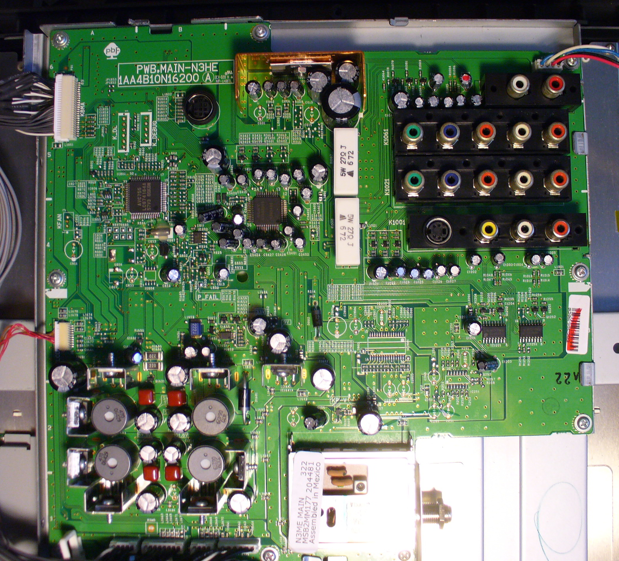

Sanyo DP26746 LCD TV-sound,no picture,lamps are on.
  • walking
    • Jun 2012
    • 28
    • usa

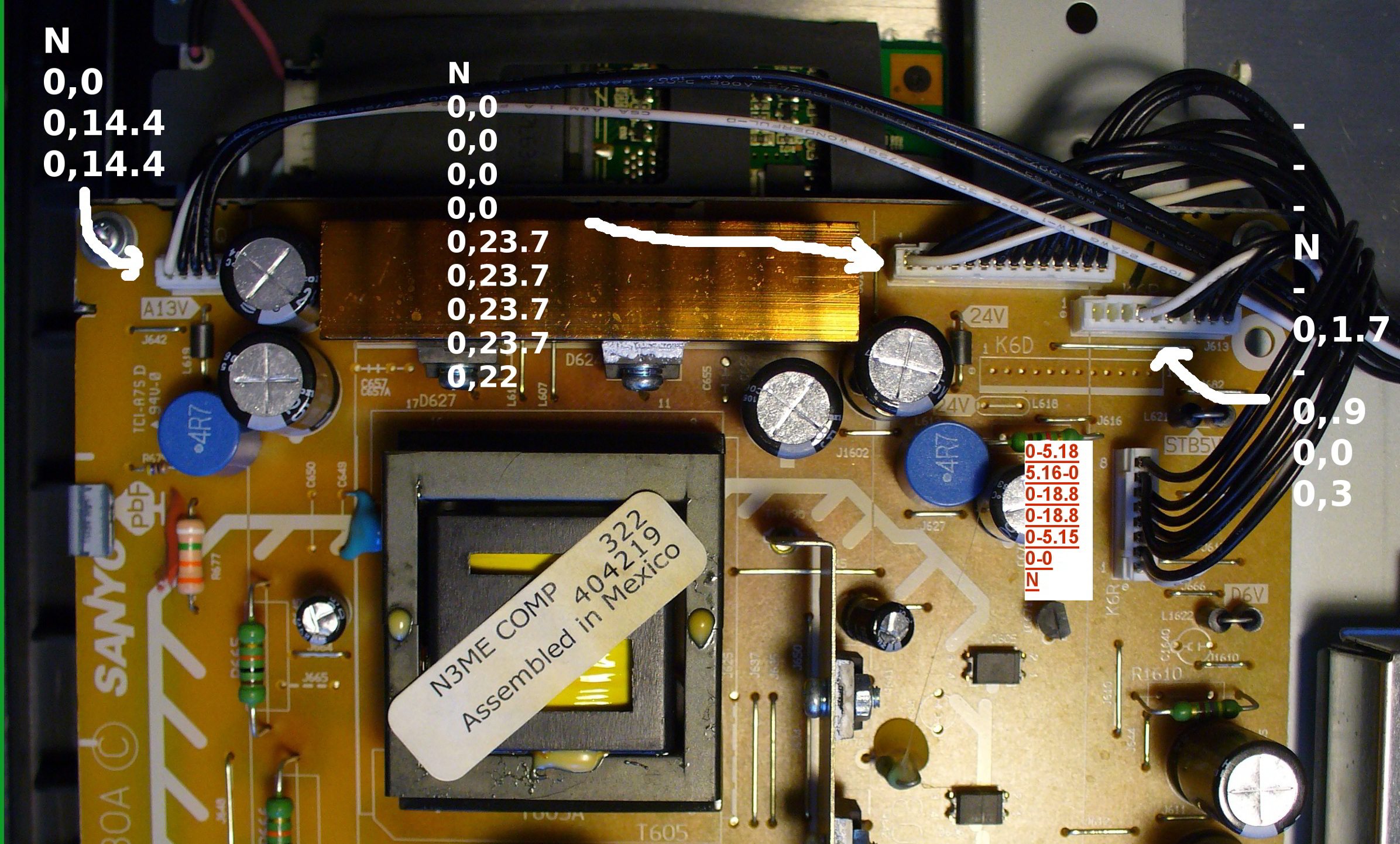

    So far:
    1.tested all but 3 .1uf caps(tops are flat) with Cap88a, all tested test good. Cap88 cannot go down to .1uf. All caps are Nichicon 105c.
    2. tested all diodes, test good off board.
    3. tested what I know for sure are fuses and all are good on smps, Tcon.
    4. Mainboard-either there are none or I do not know what the designation for the fuse(s) are. No F, PF,CF or any F's at all.
    5. Screen has no faint image when viewed in dark room/flashlight.
    6. Backlighting is all on.
    7. No whinning noise. Just the normal "click" when turned on.
    8. No dry holes or broken solder conns @ 10x magnification. (both sides main, smps,Tcon, top side of tuner.
    9. Was not able to test caps on TV tuner due to board intentionally soldered to lower metal housing but all are flat. No discoloration, blow-out leads hanging there either. Wasn't sure about how to disassemble this assembly so I left it.
    Things that seem odd to me:

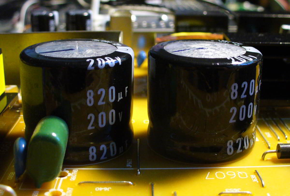

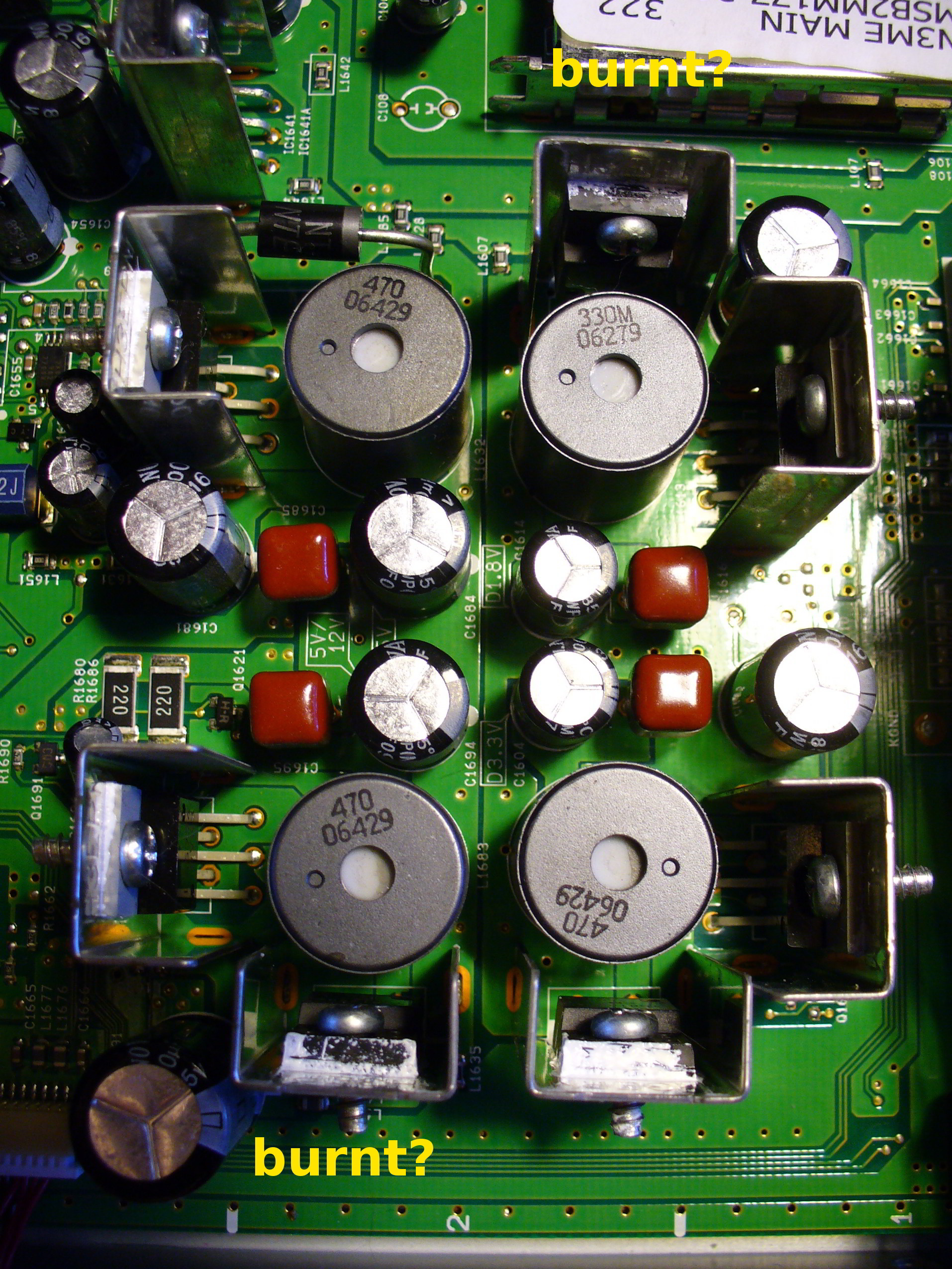

    A:Two of the large 820uf 200v caps appear to be rounded a bit on top, like 1mm at the crown. I desolded one and tested it off the board and it tested good. Put it back on to check other things as the caps were the second thing I zeroed in on, 1st was the fusing. The third large cap 470uf 200v is flat as a pancake(tests good).
    B: Voltages of pin connectors when stndby and on.
    I looked alot for same model showing same symptoms online and found 1 iffy post that it is a mainboard issue and to replace the mainboard to correct this condition. There are a couple stating to change out the Tcon. Trying to get more experienced input here as it's obvious by reading posts here there are pros here.
    Any help appreciated. I'm new to this stuff ...I just happen to get a $30 deal on a new cap88, fluke and weller solder station compliments of California penal system-they train cons to fix tvs and set them loose to sell the tools they gave them in training.

    Re: Sanyo DP26746 LCD TV-sound,no picture,lamps are on.
    In most of these TVs, there is a t-con (timing control) board. Follow the K8MA connector from the main board to where ever it leads. The t-con board is usually near the top of the tv and may be hidden underneath a metal shield or behind the power board (I see another green pcb there).
    On the t-con board, there is usually a small SMD fuse. It could be blown.
    Here is a t-con board for your set on ebay. Thanks to the seller's photograph, I can clearly see F1, a fuse.
    http://www.ebay.com/itm/130675408161

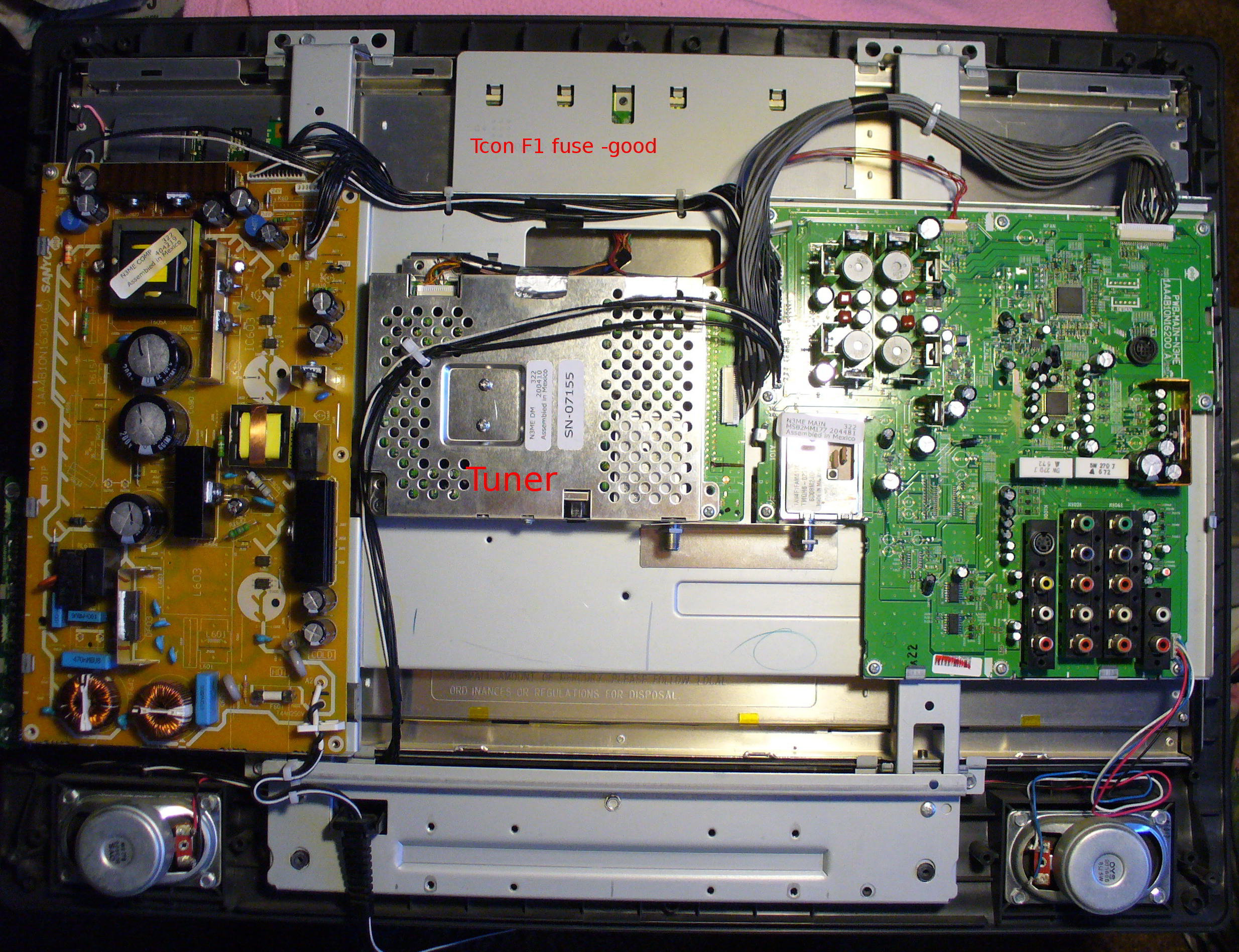

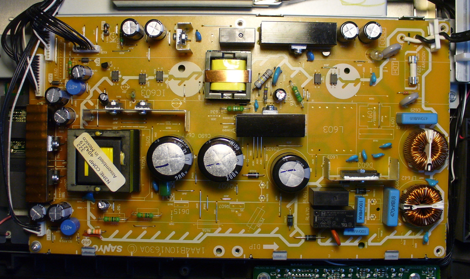

    When posting pictures, it is also important to post an "overall" shot of all the boards connected so we can see the relationship between them.
    That is a great deal for all that high end equipment. That is probably $300 worth of equipment originally.

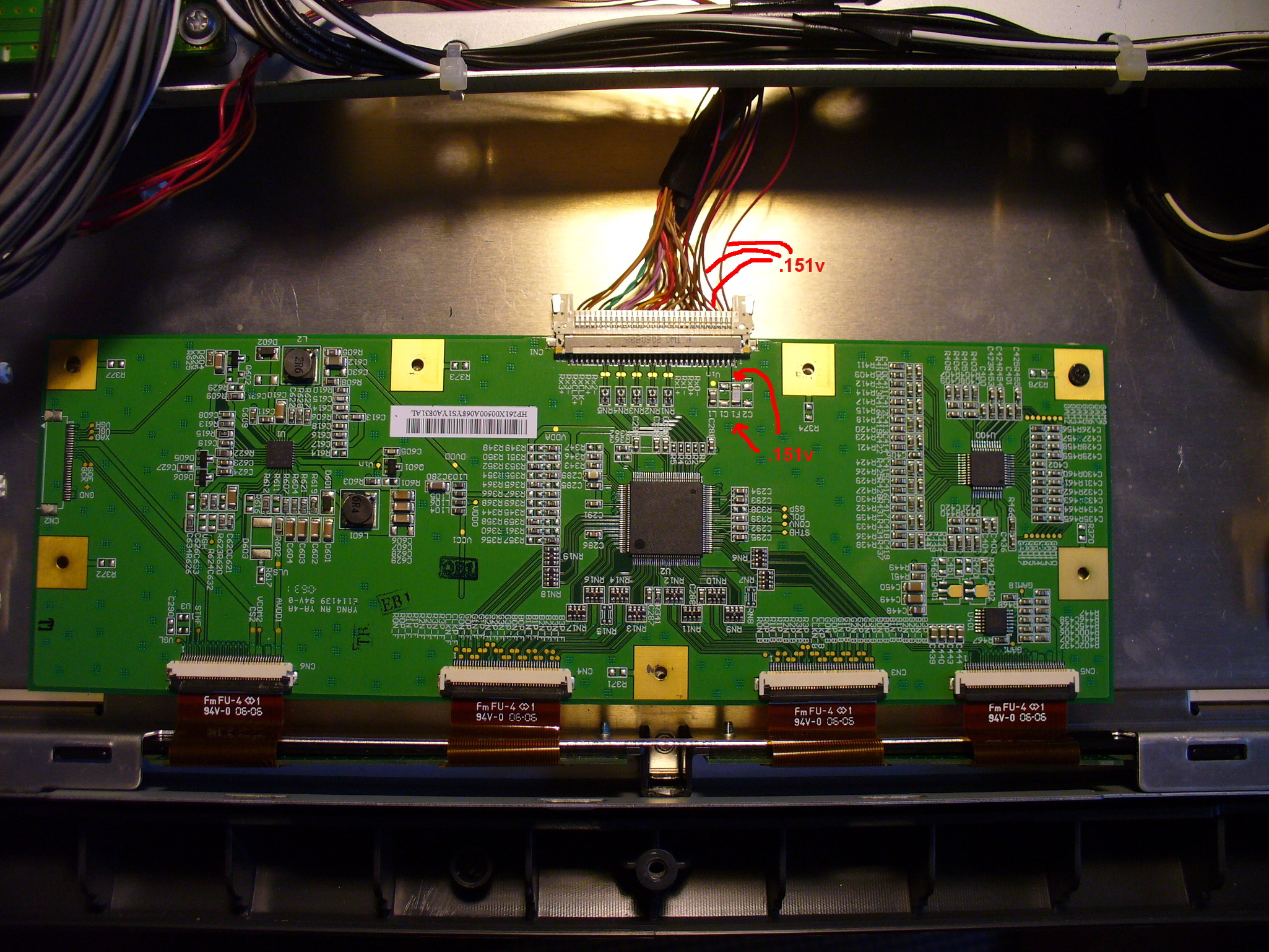

      Yes, I opened up the Tcon cover and saw a single fuse marked F1 rated 1.5 and it is good. Did a close inspection of the board @ 10x and saw nothing dry or cracked. That thing is just riddled with itsy bitsy tiny "things" I guess 'istors and what nots.
      Added photo of entire.
      I think so. Only went there to buy his solder iron. He asked what I was working on (lcd monitor) and he handed me the entire box of stuff telling me he didn't have the aptitude to repair TVs and wished me luck. Didn't know that Cap88 is like over a $100 by itself, didn't even know what it was lol.
      So with the F1 fuse good on the Tcon'y thingy-what would be the next step? New mainboard? Maybe its a switching problem, but I have no idea about the voltages on the cables if they are correct or not. Oh, and I checked the ribbon cables from the Tcon by removing them and reseating them, same condition still. That cable from the tuner to the Tcon(LVSD?) after removing it was looking dirty, kinda like old flux on it or maybe that's some kind of lubricant. I cleaned it with contact cleaner and reset it.
        Ooops, guess I didn't click right on the "upload" button...here it is...

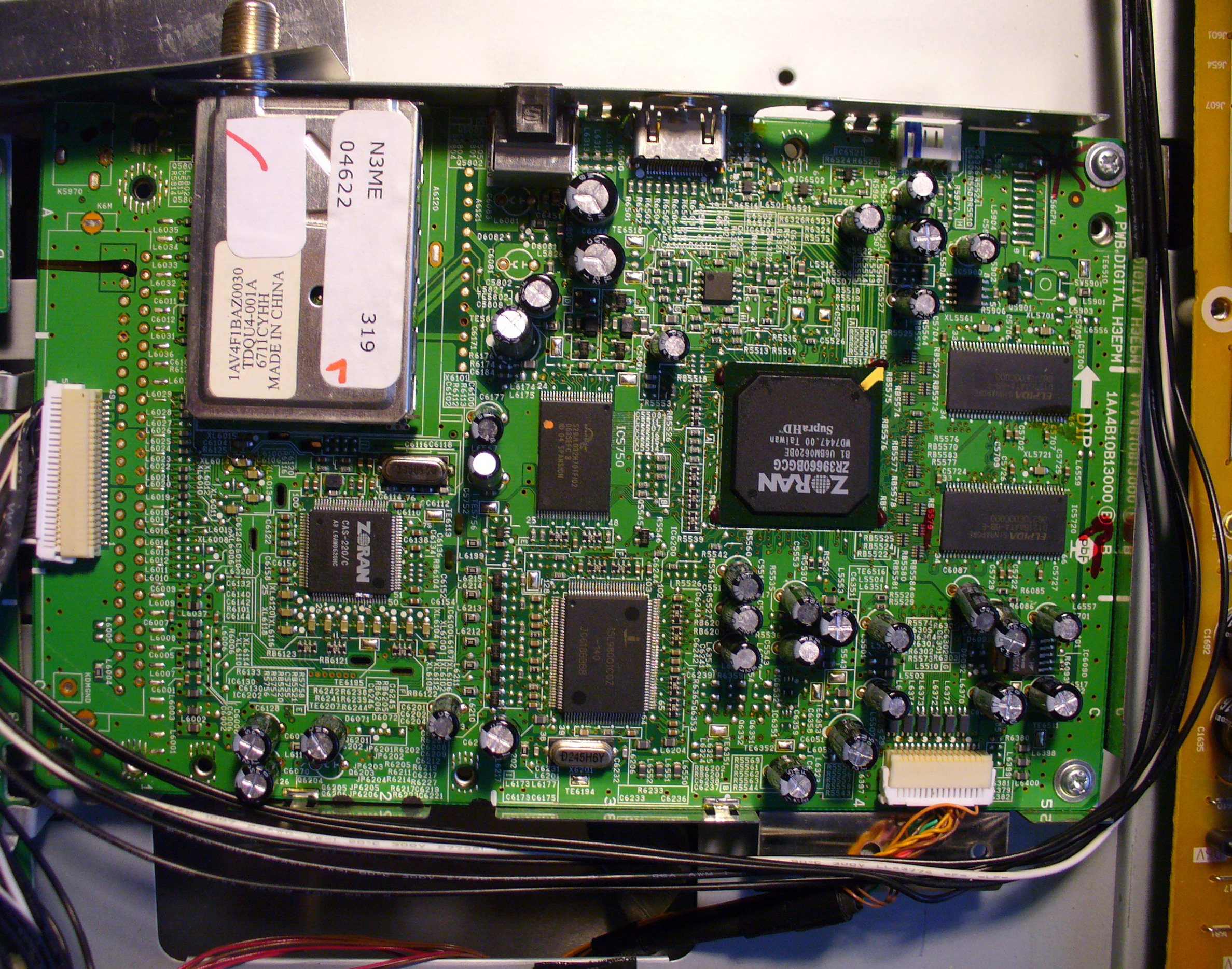

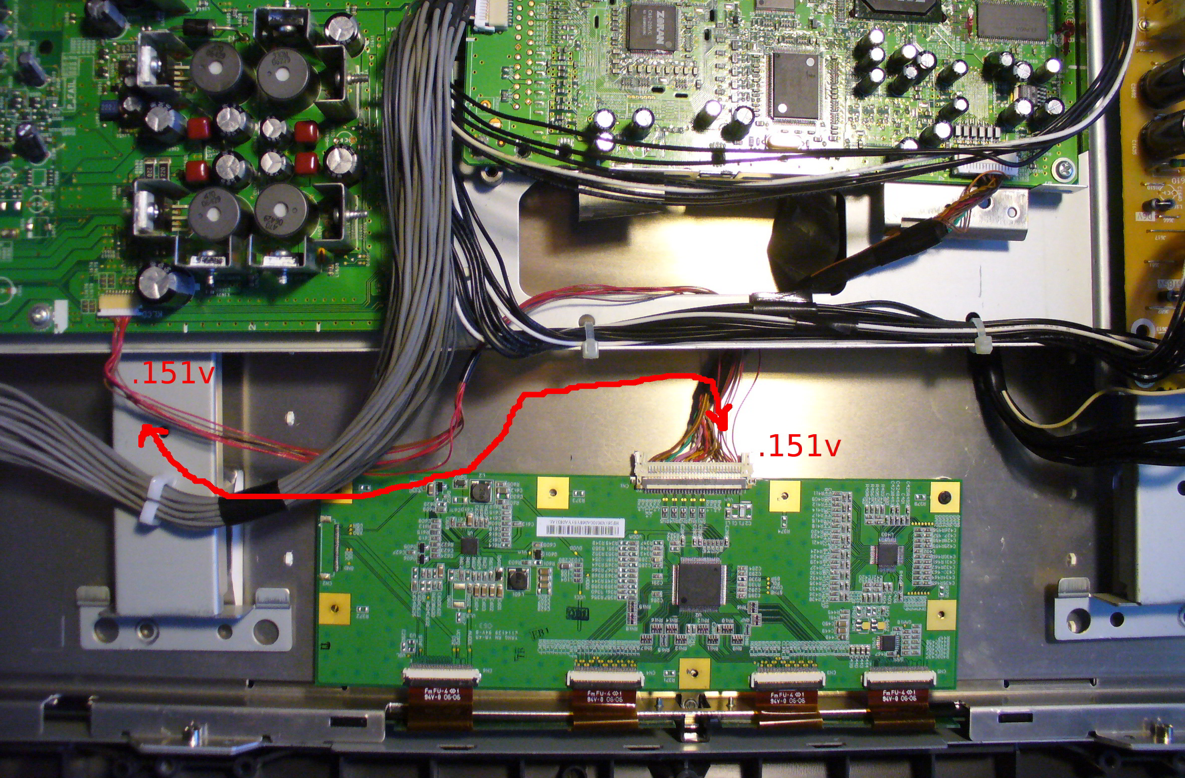

          1) That board you call a tuner, please take the shield off and post a picture. Do the same for your t-con board.
          2) Measure the voltage on either side of the F1 fuse on the t-con. Put your Fluke on DC voltage. Black probe on a t-con ground screw. Red probe on one side of fuse, then the other. What are the two readings?
          3) Which model Fluke did you get?
            .151v on both sides of the F1.
            Rightside 3 red wires on the cable show .151v and at the other end where they connect to the mainboard with cable disconnected from the mainboard read .151v on the mainboard also.
            Fluke was an 178 or something I think. I traded it next day as I didn't need 2 DMMs so I traded it to a buddy for 3 racquetball racquets. One was a $220 pro and a jug of new balls. Also got a Novax glove and something else in the $30 box, I think it's a cap discharger, maybe someone here knows what it is-the stiff wire thingy with yellow box attached and 2 probes, got 2 of them-one black and one yellow.
            thanks again.
              Wow, you got an excellent multimeter "included" for $30. An used one goes for about $100 on ebay. In Canada, the list price for a new one is around $330 CDN.

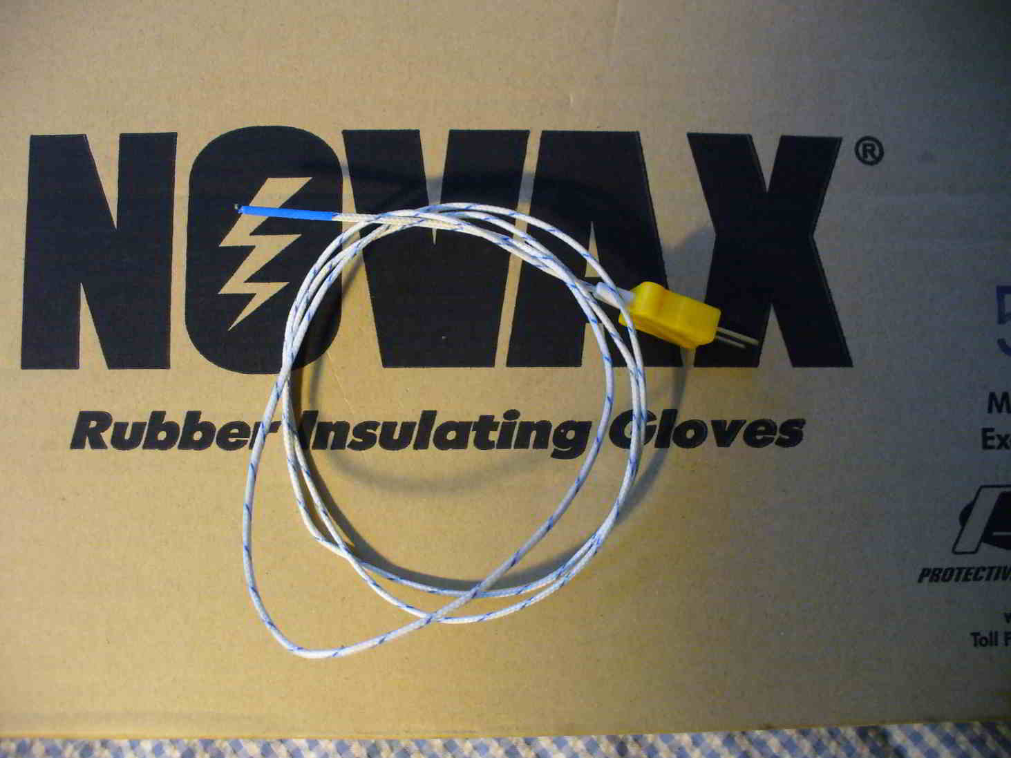

              That is a thermocouple. It comes with the Fluke 179 so give it to your buddy as the Fluke 179 does temperature measurements.
              Are the readings of 0.151v with power ON? We need readings with power on.

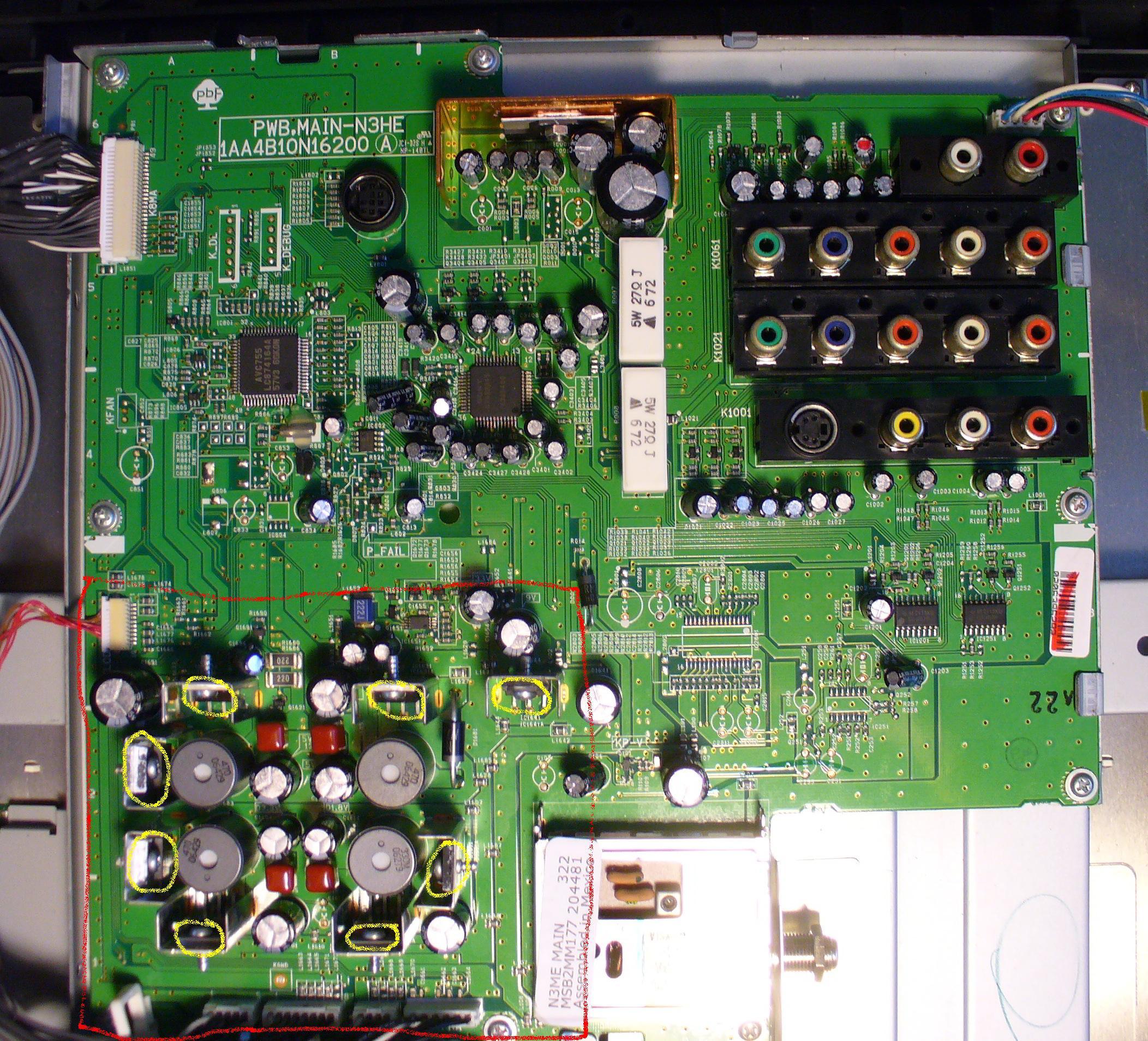

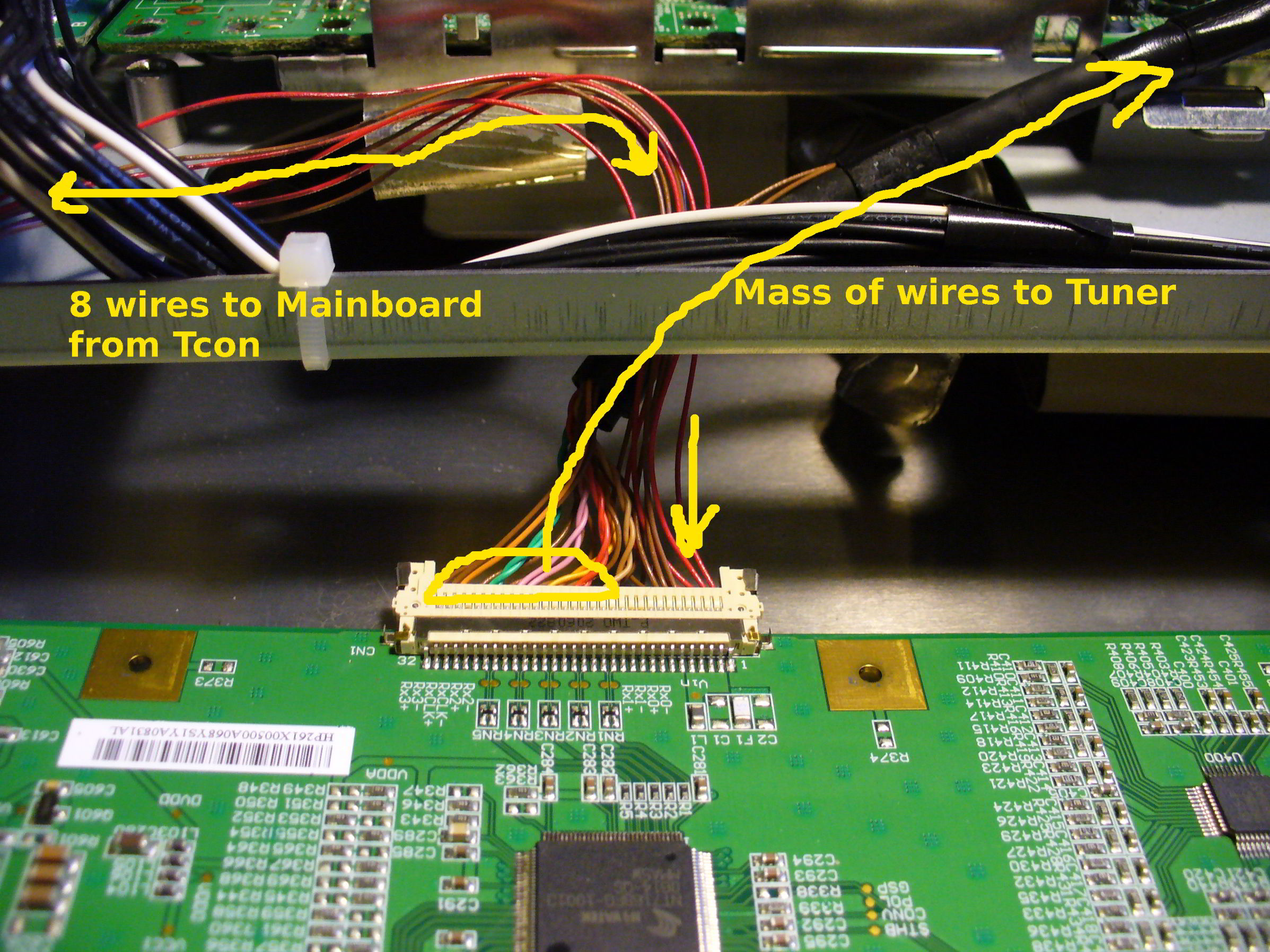

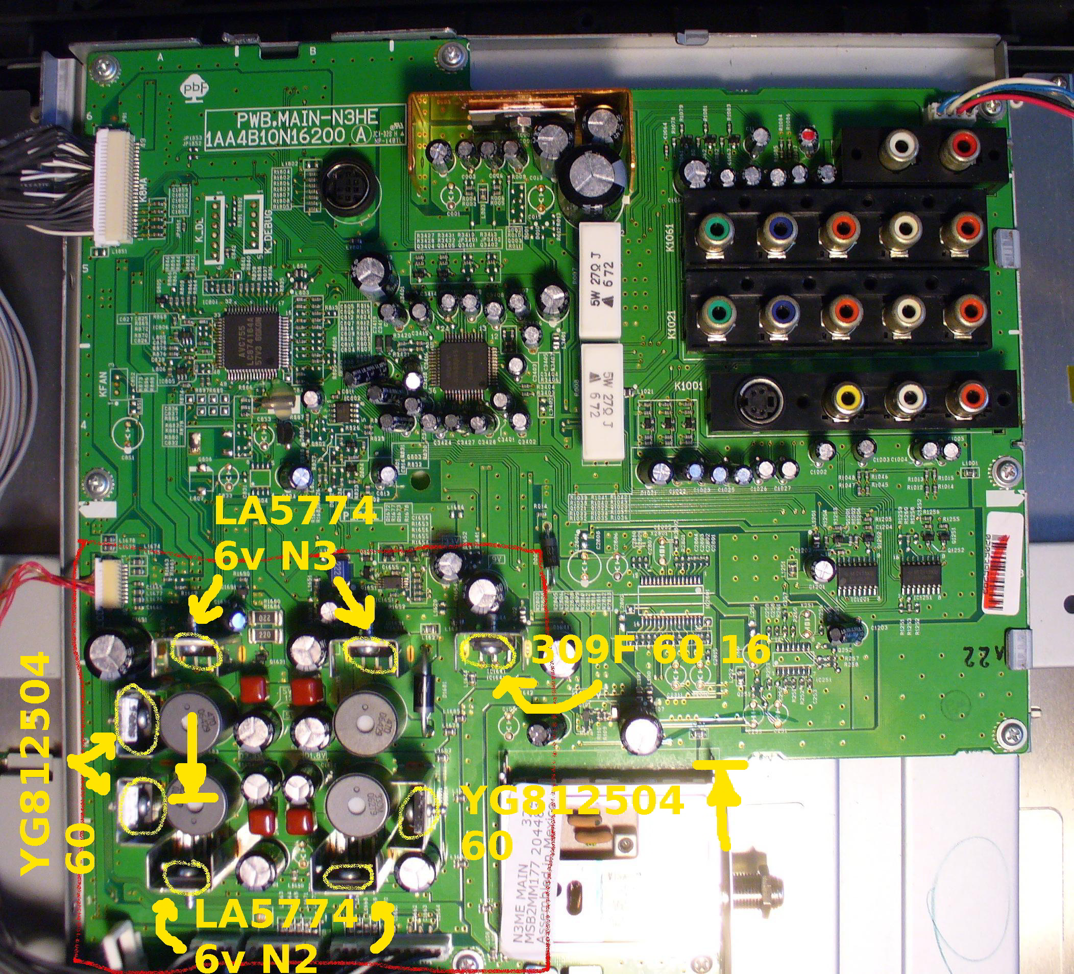

                1) Is the t-con cable split into 2? Does part of it go to the tuner board and part of it to the main? (Sidenote: This is why an overall picture of the boards are important).
                2) If yes, we need a close up picture of the area circled in red.
                3) What are the part numbers of the 8 ICs circled in yellow?
                --- begin sig file ---
                --- end sig file ---
                • walking
                  • Jun 2012
                  • 28
                  • usa
                  Yes. Most of the wires goto/from Tuner to the Tcon but there are 8 wires-brown(4) & red(4) wires that goto/from the Mainboard to Tcon. The red wires have .151v. These readings are with Power On
                  Attached
                  (#'s shown in pic). I just notice in the ICcloseup pic that one labled YG812504 on the rightside and one on the leftside of pic looks like it might be burnt a little. I used a toothpick to feel them and the rough looking spots are rough and look kinda pock marked like they bubbled up under that white goop painted on
                  Off topic: Thermocouple? Hope I didn't kill it by using it as a Capacitor discharger a couple times LOL. Dang, should have traded him my old meter, it cant do temperature checks but I'm emotionally attached to it.
                  Thanks again. Gonna do some research on how them IC things work. Notice 3 have Diode markings on them.
                  • retiredcaps
                    • Apr 2010
                    • 9271
                    1) For YG812S04R (not 5), see
                    http://www.datasheetdir.com/YG812S04R+Schottky-Diodes
                    2) Power off, unplug lcd. Put your multimeter on diode test function and test the YG812S04R. You should have 2 readings per diode. Report both for each chip.
                    3) For LA5774, see
                    http://pdf1.alldatasheet.com/datashe...YO/LA5774.html
                    4) Plug in lcd, power on. We want the DC voltage readings for each pin (there should be 5 readings). Report like so
                    U100
                    pin 1 = 5.0V
                    pin 2 = 1.0V
                    etc

                      YG812S04R: Ohms/Vdc
                      D1611
                      pin 1 = .524 on=1.9v
                      pin 2 = .002 on=.002v
                      D1691
                      pin 1 = .004 on=.004v
                      pin 2 = .001 on=.001v
                      D1601
                      pin 1 = .600 on=3.4v
                      _________________________
                      LA5774:Vdc "on"
                      IC1631
                      pin 1 = 14.7
                      pin 2 = 0
                      pin 3 = 0
                      pin 4 = 1.24
                      pin 5 = 1.92
                      IC1621
                      pin 1 = 24
                      pin 2 = 0
                      pin 3 = 0
                      pin 4 = 0
                      pin 5 = 0
                      IC1611
                      pin 1 = 5.6
                      pin 2 = 0
                      pin 3 = 0
                      pin 4 = 0
                      pin 5 = 1.9
                      IC1601
                      pin 1 = 5.6
                      pin 2 = 3.4
                      pin 3 = 0
                      pin 4 = 1.1
                      pin 5 = 1.9
                      Additionally,
                      http://www.datasheetarchive.com/SI-3000F-datasheet.html
                      SI-3090FA:Vdc
                      IC1641
                      pin 1 = 0
                      pin 2 = 2.45
                      pin 3 = 9
                      pin 4 = 9
                      pin 5 = 14.18
                      Pins=LEFT TO RIGHT when viewing Part#
                      This stuffs amazing and fun.

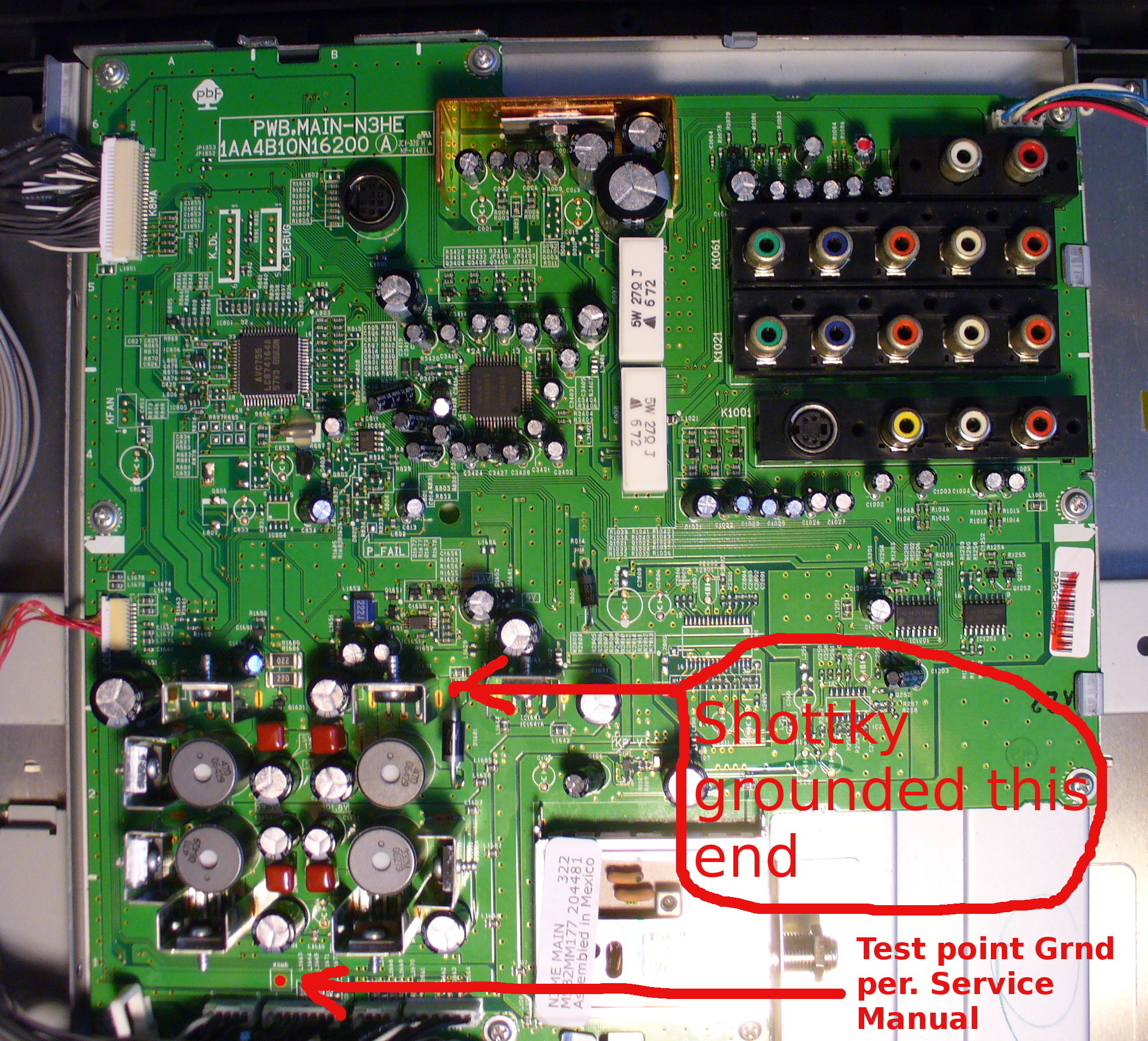

                          OOOPs I forgot about my grnd was to chassis while checking something else. Also never thought about the diode test mode being 'v' instead of "ohms", thought it was some oLaw combo figure displayed.
                          Meter on Diode Test-diodes in circuit
                          YG812S04R:
                          D1611
                          pin 1 = .524v First reading-Red lead on pin 1 black on 2
                          pin 2 = .154v Second reading
                          D1691
                          pin 1 = .004v First reading-Red lead on pin 1 black on 2
                          pin 2 = .001v
                          D1601
                          pin 1 = .600v First reading-Red lead on pin 1 black on 2
                          pin 2 = .148v
                          D1691, those are the correct #'s. Looks like shorted out maybe or the board has a short somewhere else?

                                      While checking around I noticed one end of the Shottky diode in the attached picture is shorted to grnd. using the test grnd. location in the service manual. It's the only one in the entire TV that shows zero ohms to board.
                                      I set dmm to diode test and it reads:
                                      .321
                                      .699
                                      cathode end = 1691 ohm to board grnd.
                                      anode = 000
                                      • retiredcaps
                                        • Apr 2010
                                        • 9271
                                        .321
                                        .699
                                        Take this diode and retest it out of circuit.
