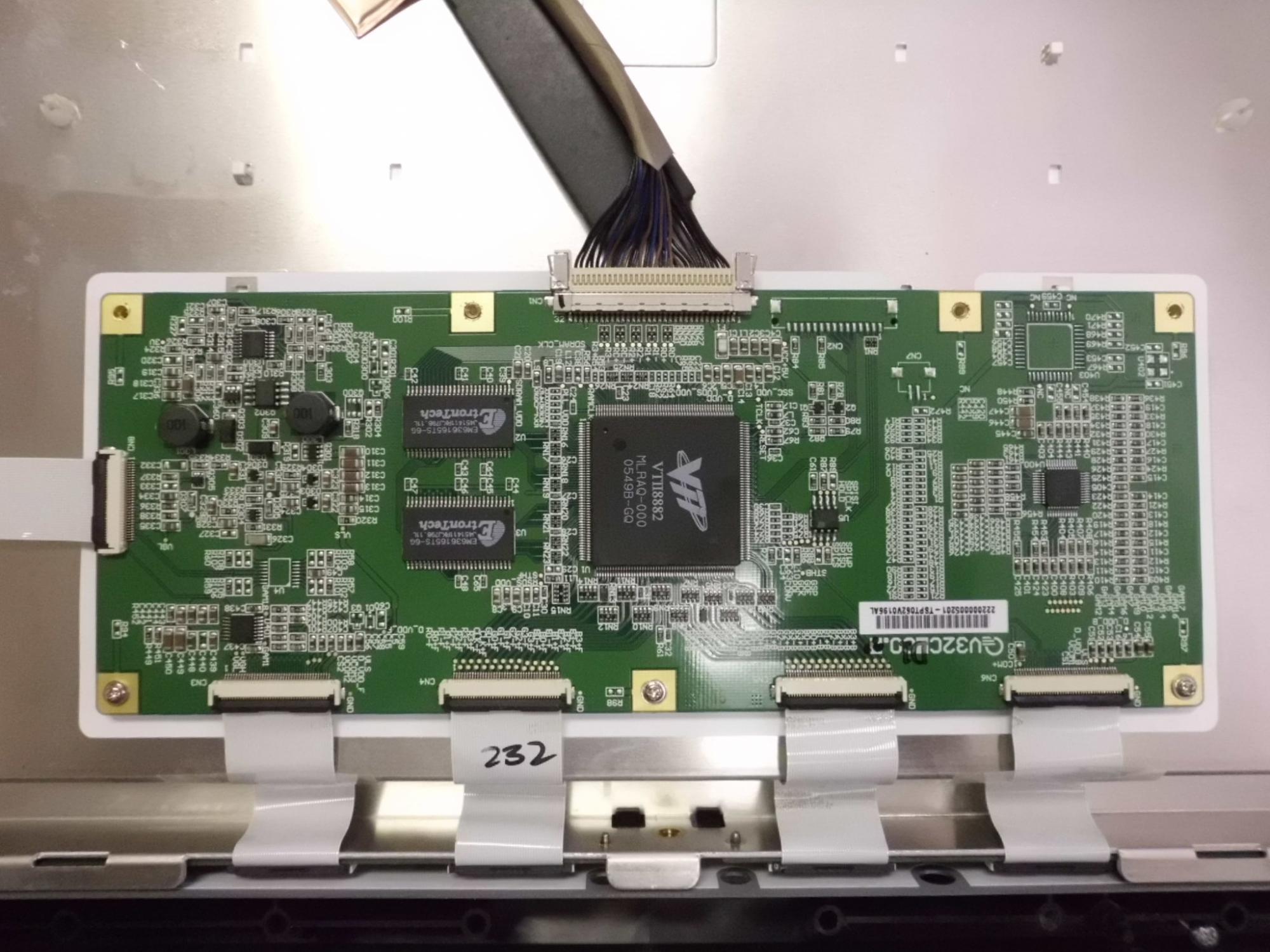

    Good day! Just found an older LCD in the dump (Sharp LC-32D40U) and plugged it in. I get backlighting (blue screen) but see no images or sound. When I press the Menu button (or any other buttons excepting PWR), I get no response. The service manual is accessible http://elektrotanya.com/sharp_lc-32d.../download.html but I am unsure as to where to start troubleshooting. Seems like a T-con issue perhaps? I removed the T-con and visual looked it over. 3A fuse was good and no burned items. Suggestions of what to troubleshoot would be appreciated.

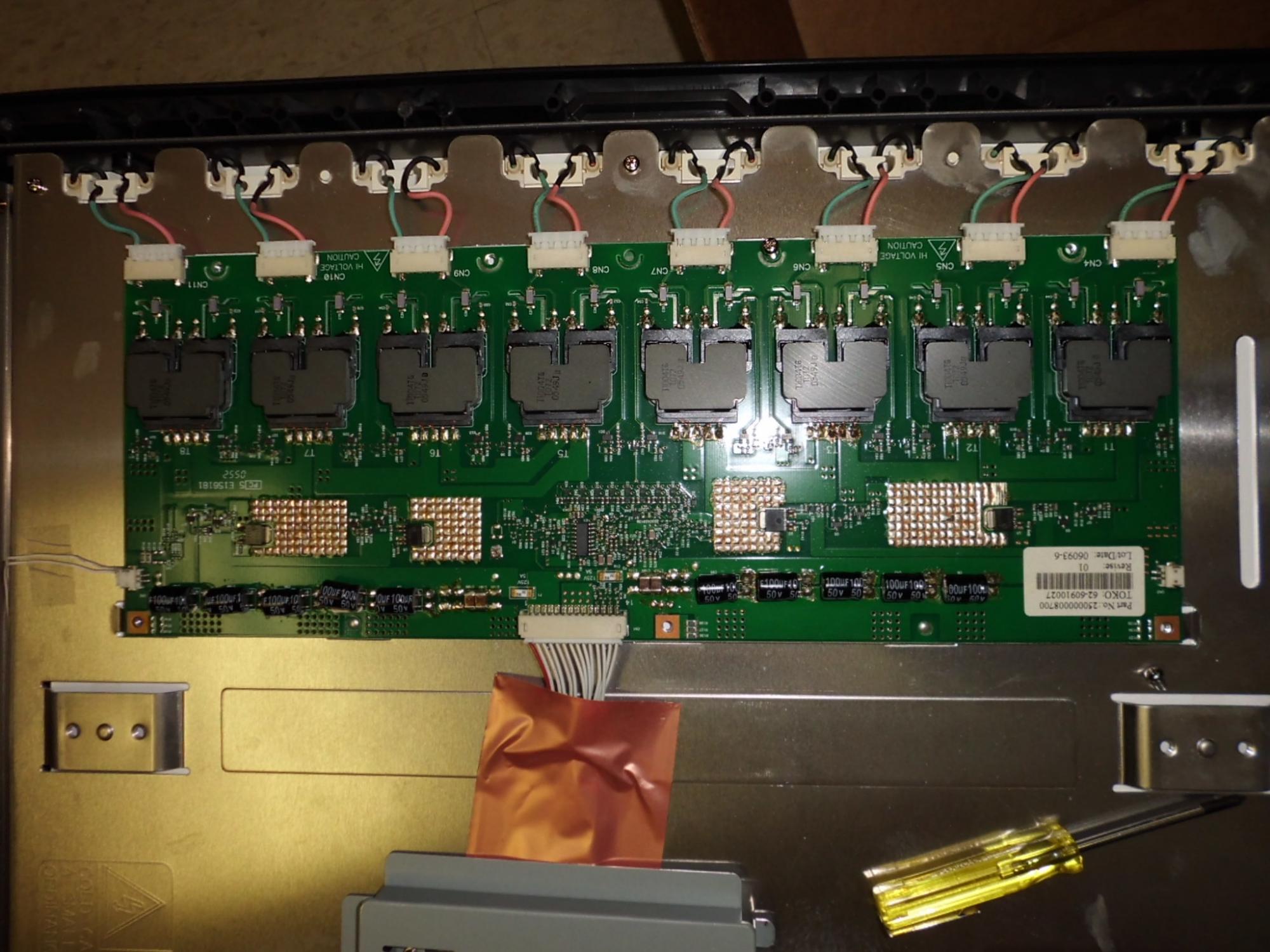

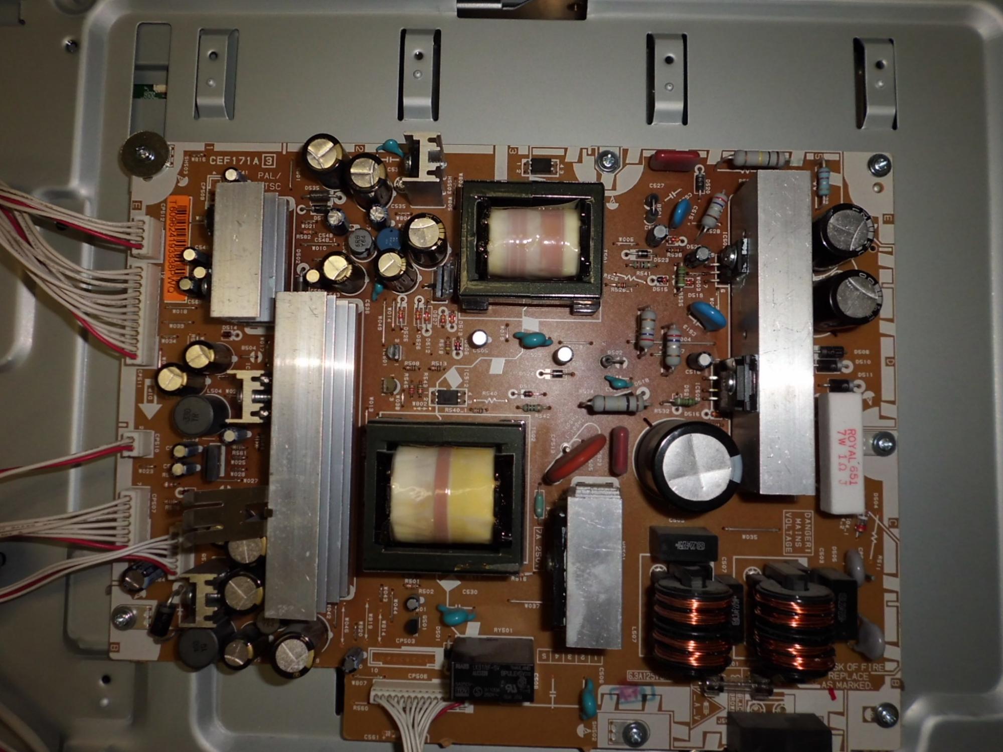

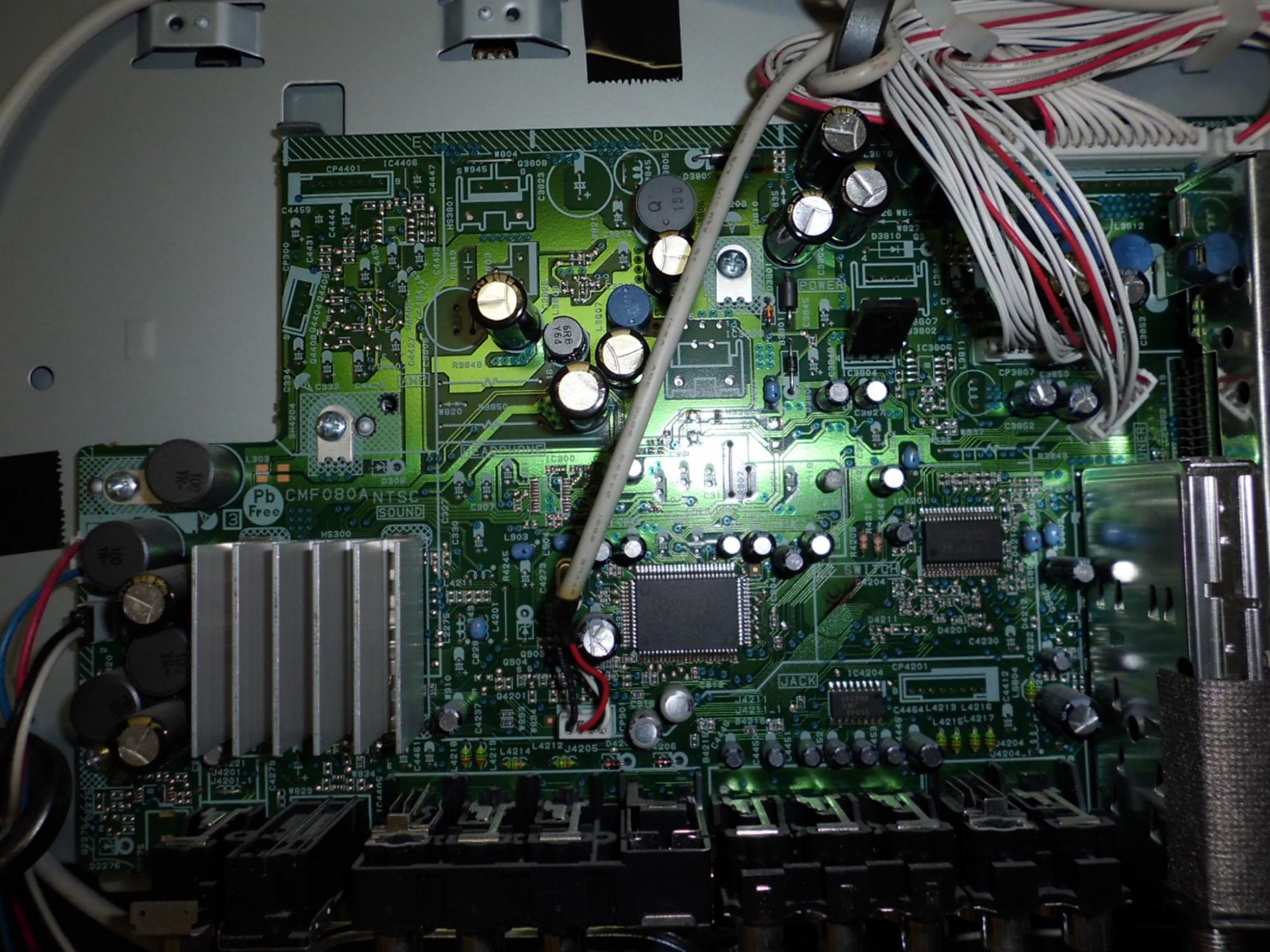

        Power supply, t-con, tuner and inverter. Scaler is on its way.

          Did you replace the caps with Panasonic caps or did you find it this way?

            Found it as-is.

              Lucky you. At least you don't have to recap it if/when it works.

                1) On the t-con board, check the VCC (5V) test point just by the F1 fuse.
                2) Check to see if the voltages on the main board are okay.
                3) I can't tell from the pictures, but see if the are any voltage regulators on the main board and see if they are within spec.

                    There's a few test points on the t-con that you should check the voltage on:
                    VCC+5V, VDD, VGL, VGH, SDRAM_VDD, VLS, 3V, SSC_VDD, D-VDD, and S_VDD(?)
                    Check with respect to ground. Let me know what voltages you get.

                        Ok, the T-con board is under the main shell, separate from the major boards and very difficult to get to while cables are connected. I measure the 32 pins along the connector CP7203 which extends into the T-con board. This 32 pin cable is serviced by the scaler board. Voltages are below. Pins that show 0.0V (GND) are skipped.
                        1. -
                        2. - 5.32
                        3. - 5.32
                        4. - 5.32
                        5. - 5.32
                        10. - 0.0
                        13. - 1.43
                        14. - 1.17
                        16. - 1.42
                        17. - 1.06
                        19. - 1.38
                        20. - 1.12
                        22. - 1.22
                        23. - 1.27
                        25. - 1.42
                        26. - 1.08
                        29. - 3.27

                          CP506 coming directly off the main PS reads as follows:
                          1. 23.9 V
                          2. 23.9 V
                          3. 23.9 V
                          4. 23.9 V
                          5. 23.9 V
                          12. 3.3 V
                          13. 3.2 V

                            CP3201 on scaler board which comes from the main board reads as follows:
                            1. 11.8
                            2. 8.8 V
                            3. 5.3 V
                            4. 3.4 V
                            5. 4.2 V
                            6. 4.2 V
                            10. 5.1 V
                            11. 5.0 V

                              CP511 coming off main PS board read as follows:
                              1. 5.3
                              2. 5.3 V
                              3. 5.2 V
                              7. 11.9 V
                              8. 11.8 V
                                Re: Sharp Aquos LC-32D40U - no image
                                CP510 coming off main PS read as follows:
                                1. 8.9 V
                                  So F1 fuse on the T-CON board is OK (since the 5Vdc feeding it from the cable is OK)?
                                    Both sides of F1 show 5 VDC.
                                      Not to sound negative, but I doubt those voltages can be of much use in terms of troubleshooting. You really need to get the voltages at those test points I mentioned in order to see if the T-con is working properly.
                                      I'm not very familiar with the layout of the TV, but if needed, use cardboard or plastic sheets to insulate the boards from each other and run the TV that way if you can to get those measurements.

                                        Kinda working on too much here and just got back to this one. This evening I plugged a DVD player into the Component 1 jacks and got audio, but still no video. This tells me that the main board is OK, correct? Just need to spend my time looking at the T-con and scaler boards?
