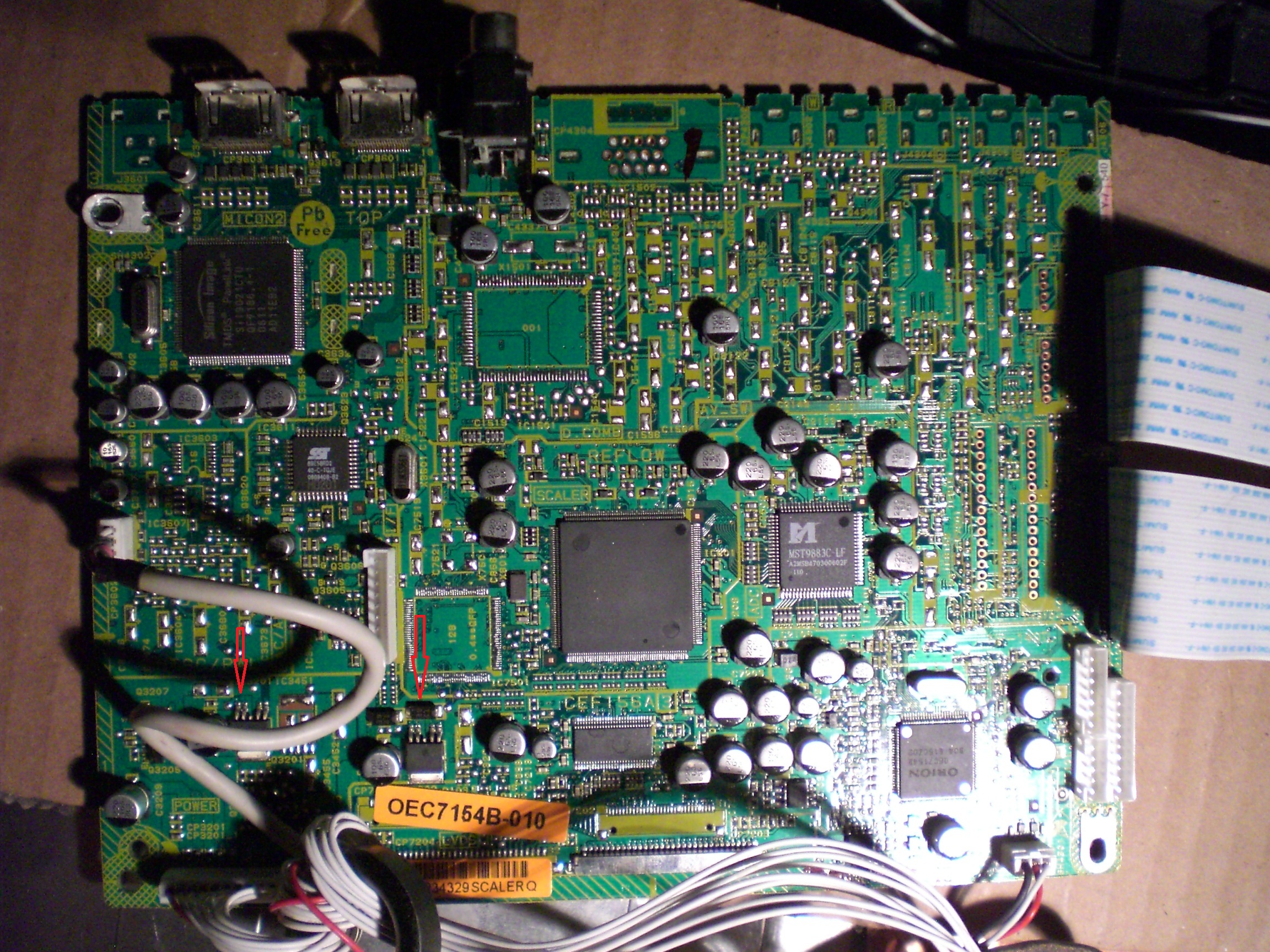

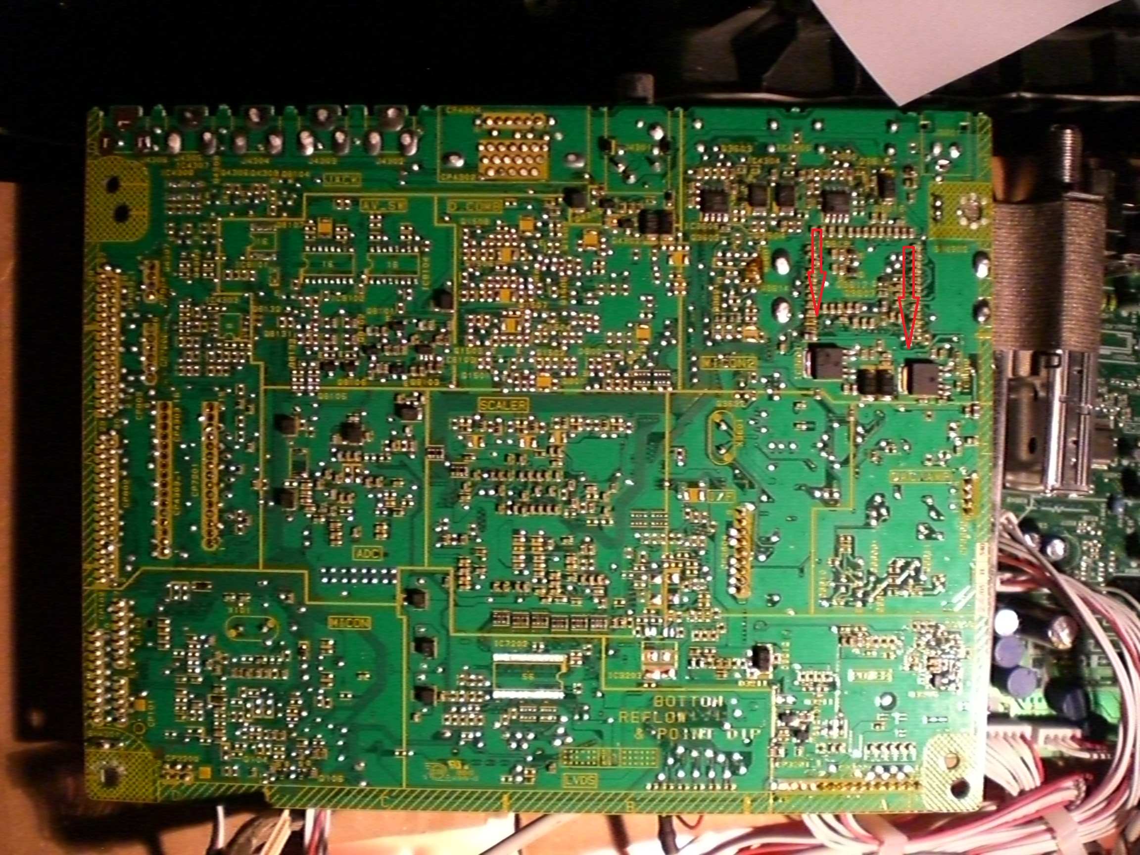

                  What are you calling the scalar board? Post a picture of it with the two ICs above circled in red.

                    #49
                    Re: Sharp Aquos LC-32D40U - no image
                    Pins #2 on both read 5.0 VDC. Remaining pins have 0.0 VDC. Attached are a front/back shot of scaler board.

                        #51
                        Ic3602 = ba00bc0wfp
                        ic2601 = bd7820fp
                          #52
                          It looks like both belong to a subsection called MICON2. I'm not sure what that stands for, but it is possible that until the TV actually turns on, those output voltages are at 0.0V. It will all depend on what the datasheet says those components are and the expected output voltage.
                          Are those 2 connectors (CP3601 and CP3603) on MICON2 usb ports?

                            #53
                            They both look to be part of the HDMI interface. Both have pins #1 (Vc) connected to a H_INT line. Might be that they don't turn on until this pin goes high?
