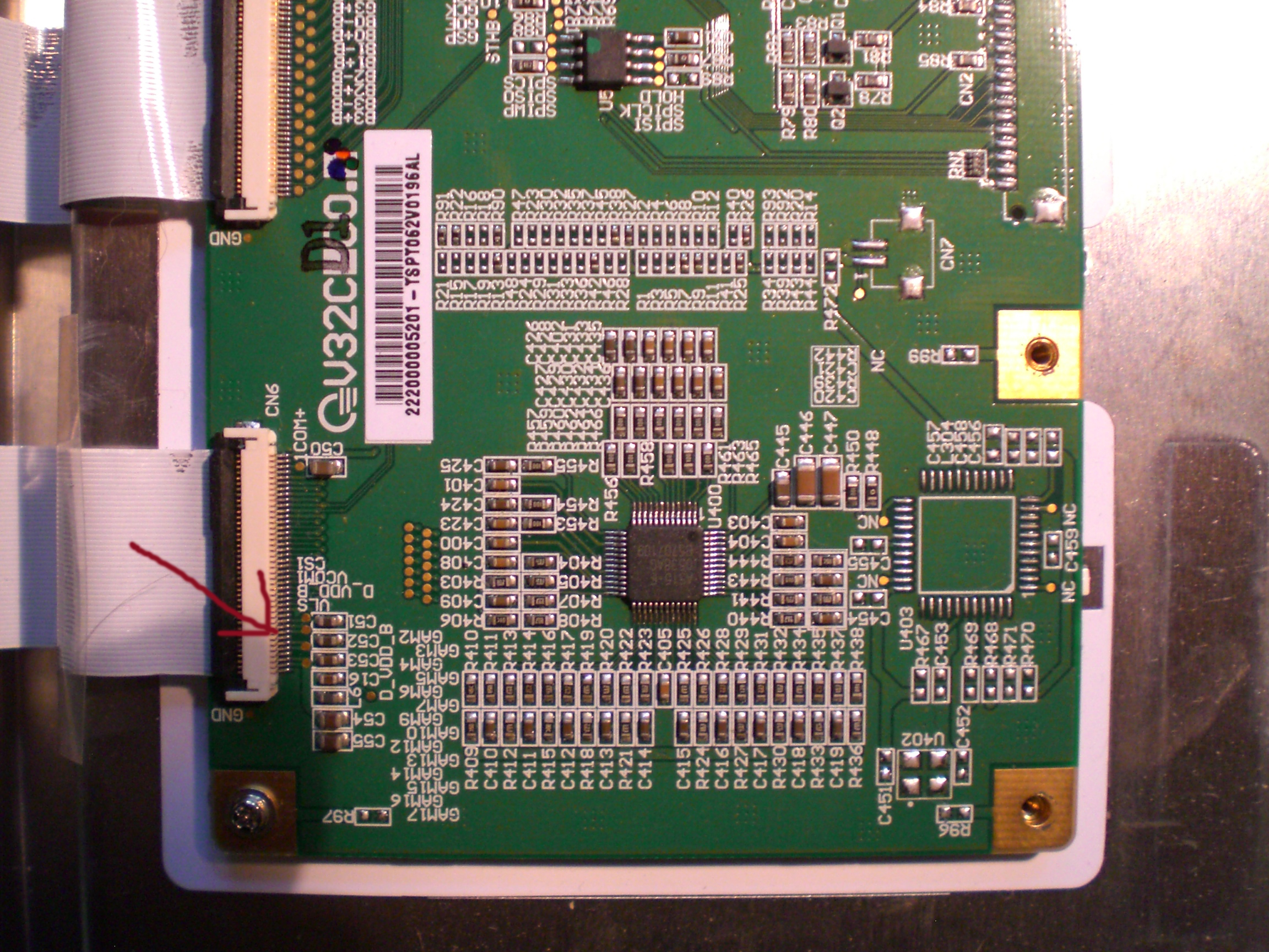

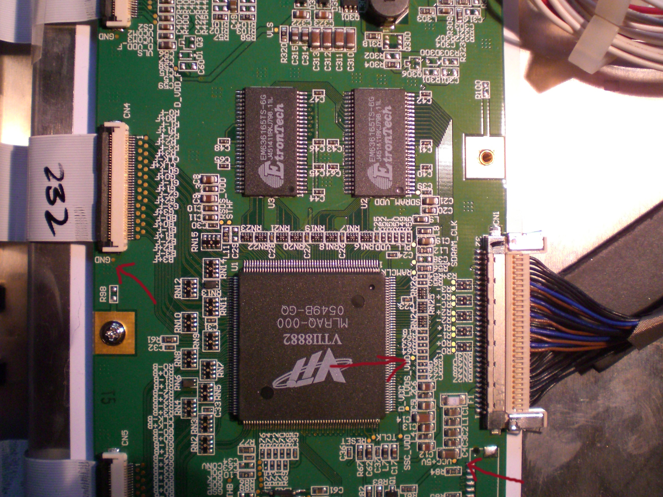

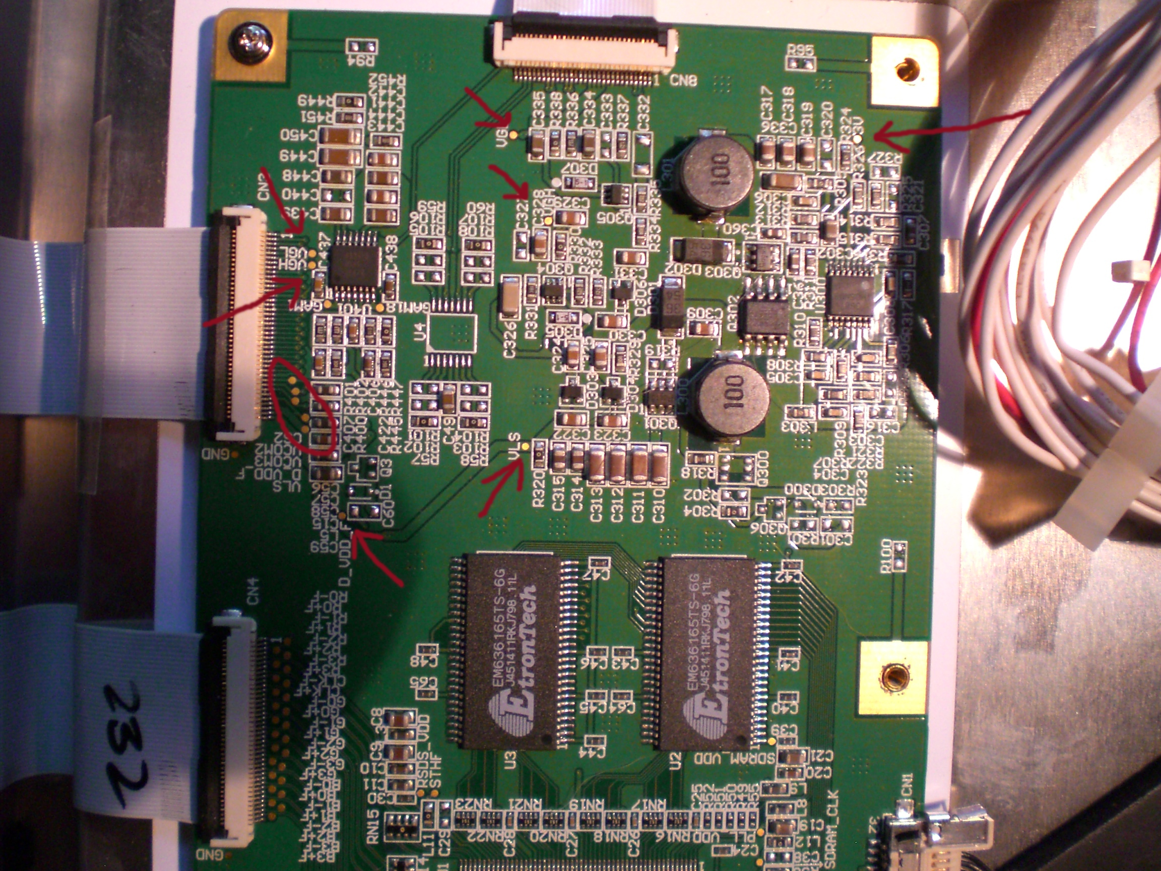

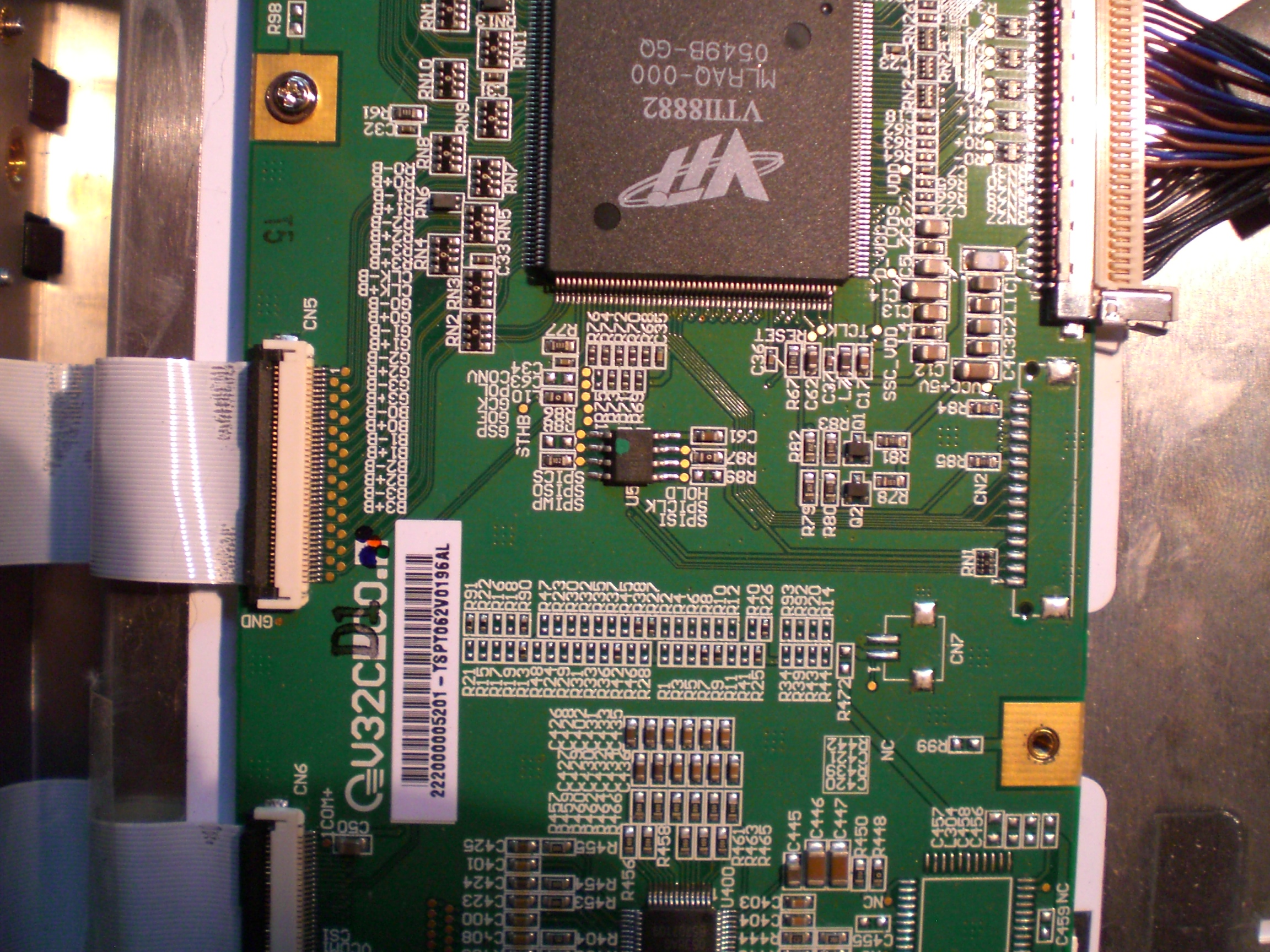

                              • ahickman
                                • Jan 2012
                                • 233
                                #35
                                Re: Sharp Aquos LC-32D40U - no image
                                Momaka,
                                Sorry, it is just so very rewarding to make progress on these sets and I am very dependent on the knowledge of this forum. It has been VERY hot here in VA and I find myself looking for such projects during the heat of the day.
                                I have snapped a few close-ups of the t-con board. Had to take sequential pictures in order to get decent resolution.
                                I retested the 3V pad and several others using one of the screws going to chassis as GND. Got the exact same voltages. I also used a heat sink on the secondary side of the PS as GND. No changes in voltages.
                                While I could blindly order the t-con board from ShopJimmy, I would rather have the satisfaction of learning more about troubleshooting the t-con. All help/guidance is greatly appreciated and I will try to be more patient
                                aaron
