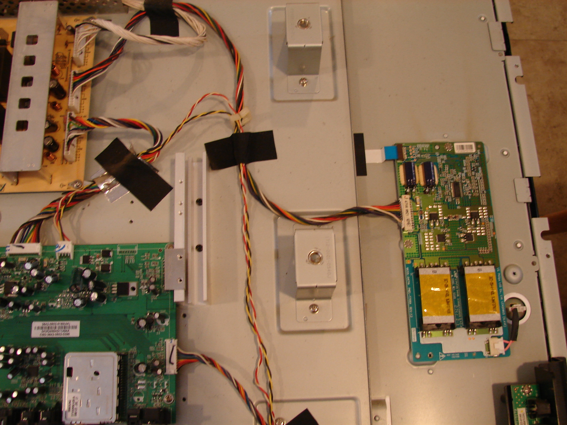

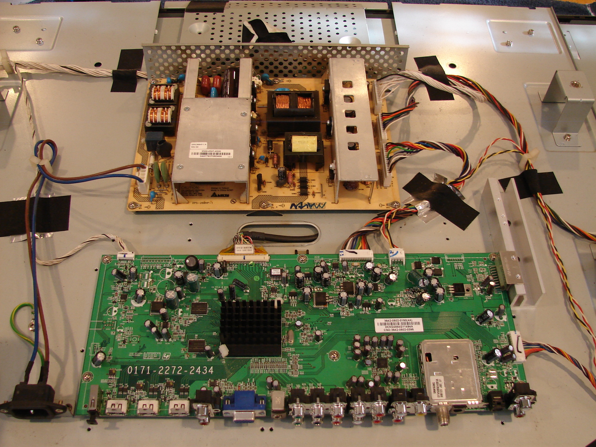

    Ok so ya, no screen (which means no image or backlight) and no sound...only the Vizio light came on.

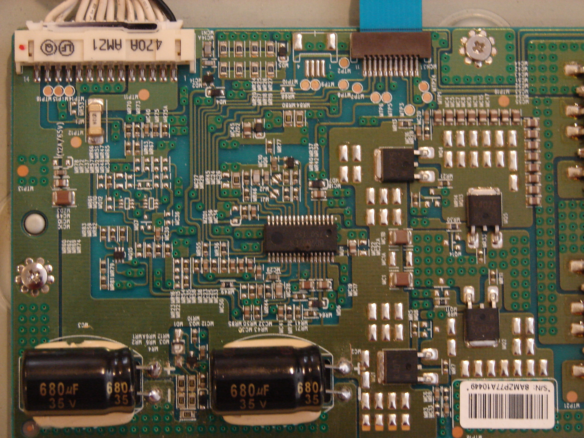

    Opened it up and saw a bulged cap on the Master inverter so I replace both of those. With same results (except for one thing I'll explain later).
    I've read that a lot of the GV series has the regulator issue so I just decided to order a main board but that didn't change anything either.

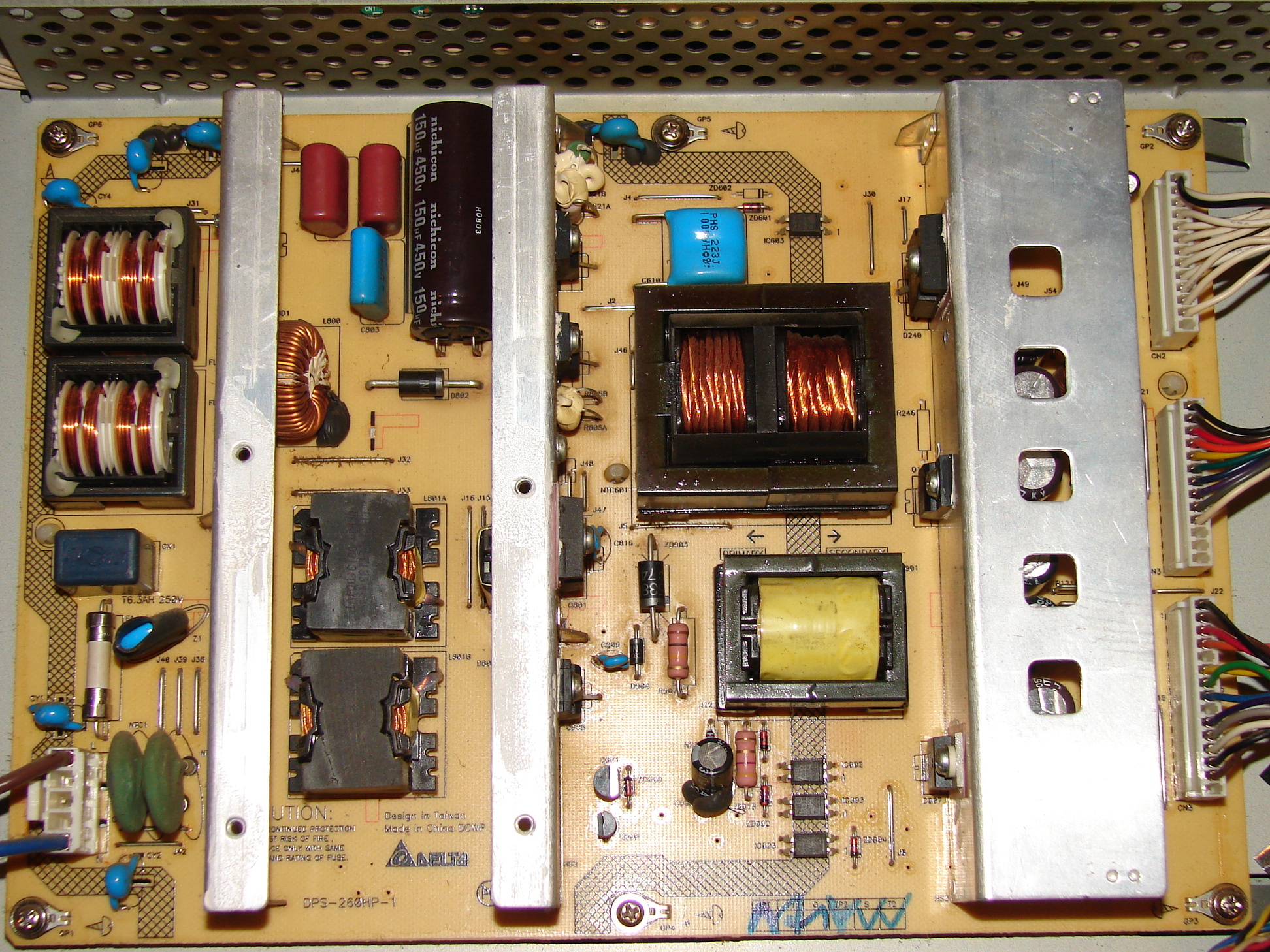

    All the voltages check on the P/S and there are slots on each of the outputs to each inverter board and main labeled A, B, and C.
    A measures 2.267v
    B measures 4.8v
    and C isn't connected to anything.

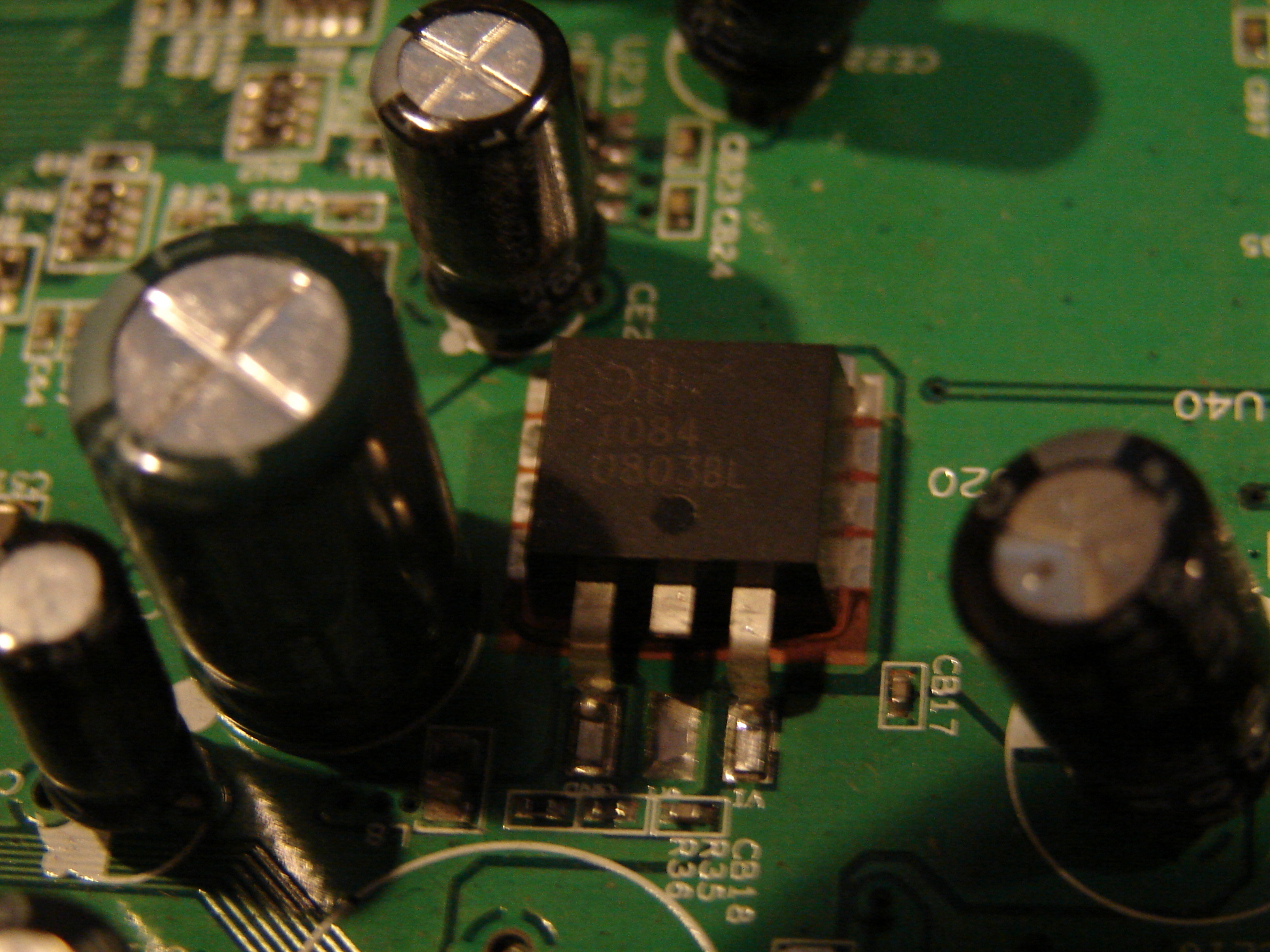

    Now on the main board one of the transistors labeled U20 was outputting 3v while U15 and U19 (of the same kind) were outputting 5v. (I'll include a close-up)
    Is that supposed to be a regulator or...?
    Now, the one thing that did change after the caps were replaced was the behaviour of the blue LED on the master inverter board. Before it came on then abruptly went off. After, it smoothly fades away. When power is first cut on there is 3v to the LED but after about 2 secs there is 24v. Why is it doing that? (There is a close up of that (the LED is in between the two big caps)) Are the resistors bad?
    On either inverter, there are no voltages getting to the actual inverter itself but the board is being supplied adequate power.

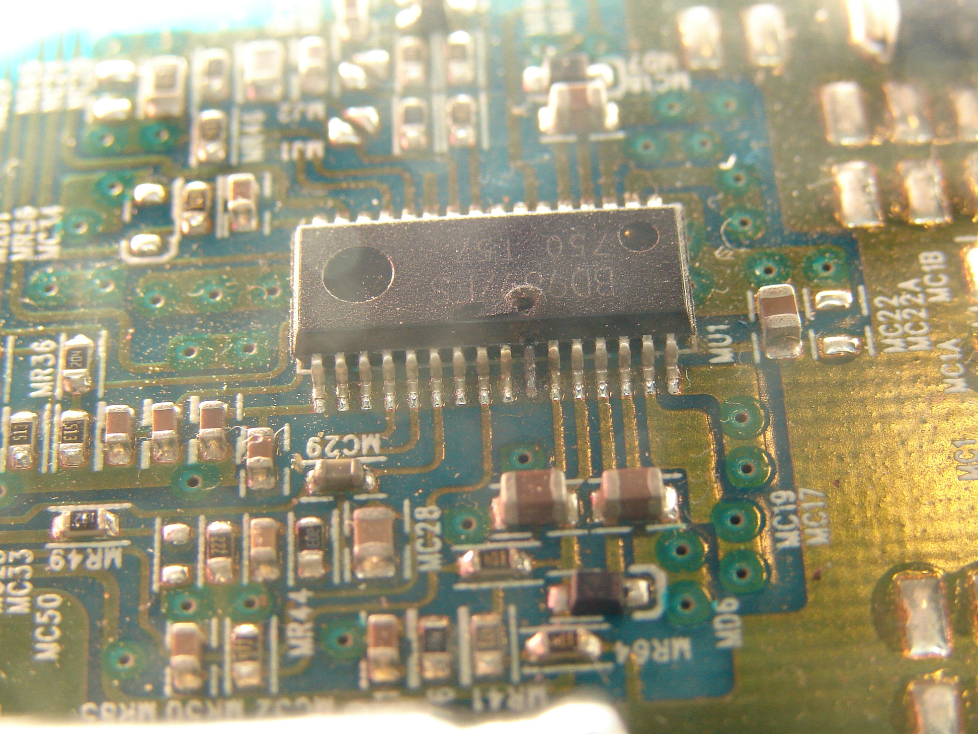

    In one pics is a closeup of an IC (Master Inverter) that got chipped or maybe fried? But I was still hoping I would get a picture. So that could be the cause of the backlight failure but I am still a little puzzled about the LED.
    I guess too it would be good to mention that you must hold the power button to get to even cut on....sometimes......and like wise to cut it off but it then restarts itself after you cut it off.
    So if that is a regulator, would it cause all of this? Or something else?
    I am confused
    Sorry this is a lot.

    Do you get 12V (for sound) and 24V (for backlights inverters) at the PS OUTPUT connectors? Also need closed up pictures of the power supply board

      That chip is cooked. You can see the damage even at the pin thats right in front of the hole.
      Does the tv turn off? In my experience with the bad regulators, the tv won't power off. Since you replaced the mainboard have you tried to shine a bright flashlight into the screen to see if you can see the "no signal"?

            As Bill pointed out, that PWM controller IC is blown, more likely to have bad MOSFETs also.
            I think they may need mod kit for the two inverter boards.
            You can buy repair kit (not mod kit) from Ebay.
            Very similar failure to this one:
            http://s807.photobucket.com/albums/y...VO42LFHDTV10A/

                    Yep, they do need upgrading.
                    • drpj23
                      • May 2012
                      • 528
                      Re: Vizio VW42LFHDTV10A - Only the logo light comes on
                      By upgrading do you mean an updated version of this board or just plain replacing?
                        You need to install all the added parts as shown in the PDF mod info I posted after you have replaced the IC (1) and MOSFETs (4) in each board.
                        Please note that they had issued the first mod and it did not fix the problem, so they released the second mod.
                        So I cannot tell if the second mod will actually fix the bad design to begin with, only time will tell.

                          But I want to know if that transistor in the last pic is supposed to produce 5v on the VI pin. The other ones have 5v on that pin but this has only like 3.3v.
                            The 3-pin device is a LDO adjustable regulator (can tell by the two resistor between the left pin and ground and between left pin and the middle pin (the big tab is connected to the trimmed center pin).
                            If the regulator is good, there should be 1.25V between the left pin and the center pin.
                            In the input can be anything as long as the Vin is 1.2~1.4V higher than the required output voltage.
