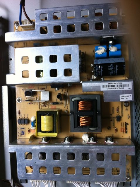

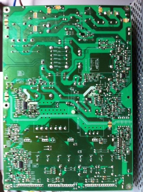

        I have soldering skill,pretty much skill on anything but the power supply ive look at it dont see any damage to me.
        http://*************/photo/my-images...ersupply2.jpg/
        http://*************/photo/my-images...ersupplyi.jpg/
        2 pictures are front and back on power supply.

          Check the bottom left connector, one of them should be labeled with 5VSTBY.
          Please post the picture of the connectors of the power supply so we can read the labels on them. Please keep the picture in focus also.

            Since it's a Vizio and they are only sold in North America to my knowledge the OP must be on 115VAC 60 Hz.
            I would check CAREFULLY across the big Rubycon 180uF capacitor. Use the 600 or 1000V DC range.
            Also do check the plug fuse (do you have those in US & Canada?), it may sound silly but it has bit me before!
              Re: Vizio VX42L hdtv10a *No power, no vizio logo orange light or white light*
              I think there is a white ceramic 5x20 mm fuse on the fuse clips on the top left of the board.

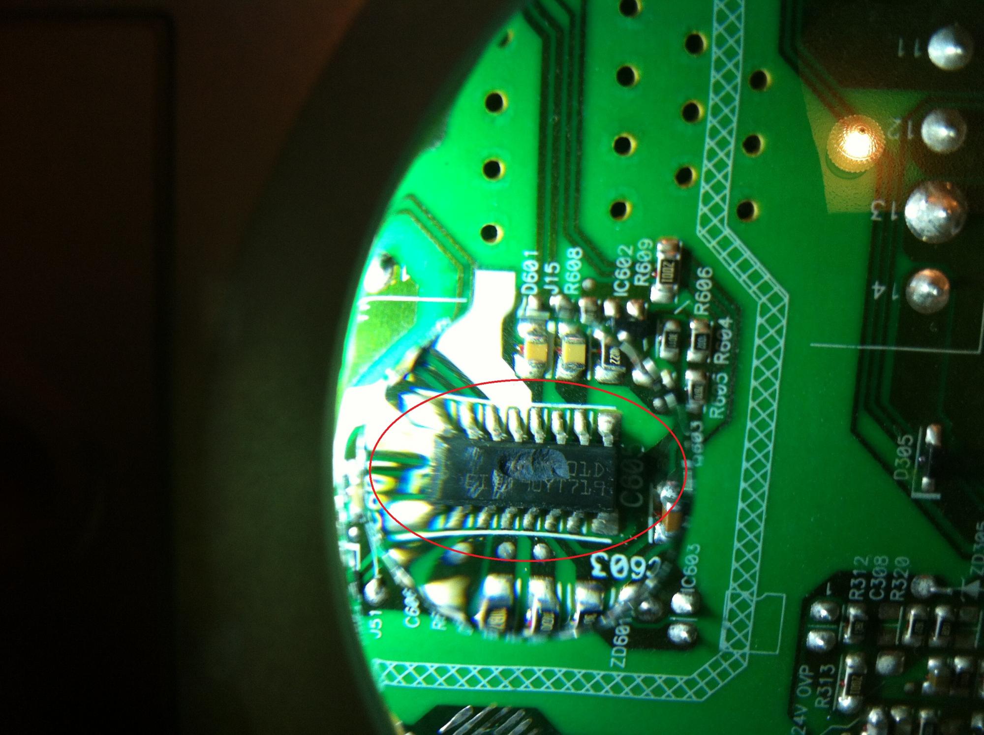

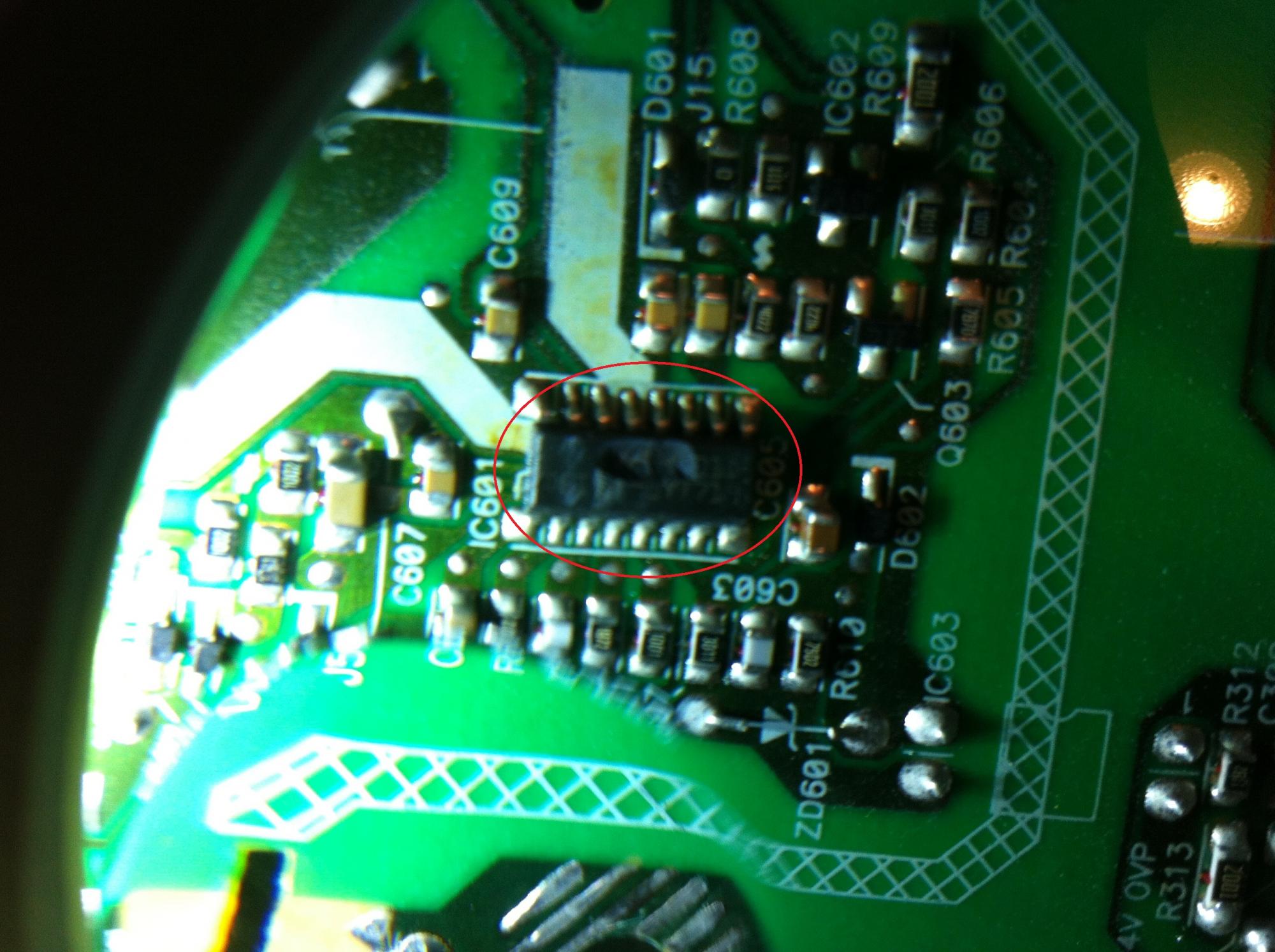

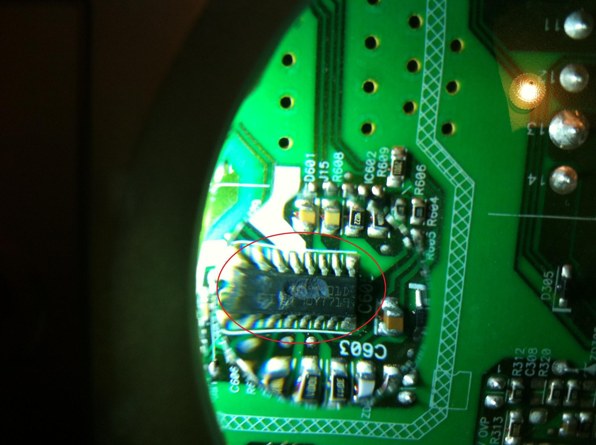

                I think ive found damage its under the power board...i took picture. Tell me if its normal or its for sure its damage. I do not know what this name of part. Here picture of damage, i marked red circle on picture.
                  Looks like that chip had a bad day. :/ I think it's an L6562D from another post on this forum, but that might be for something else... It is likely for controlling the PFC side, so expect the MOSFET to be shorted for the PFC. Is the fuse blown on PSU?
                  • supremacy13
                    • Feb 2011
                    • 25
                    fuse is fine no blow fuse.
                      Did you check it with a meter? These ICs rarely fail like that without a serious amount of energy being dumped into them.
                            Originally posted by supremacy13
                            you said L6562D, i check ebay it has 8 legs. The bad chip I have on power board has 16 legs. Wonder where I can find those part?
                            My error. I'll try and dig up the thread on this TV that had a similar power board - the numbers may be visible.
                              Ah. L6598.
                              http://i.imgur.com/RtXcU.jpg
                              Is that board the same as yours?
                                      Okay it's fine so the next step is to figure out how the IC has been damaged. Are any of the MOSFETs shorted? It's possible the current limit control somewhere has prevented the fuse from blowing somehow, or that the IC has failed for another reason.
