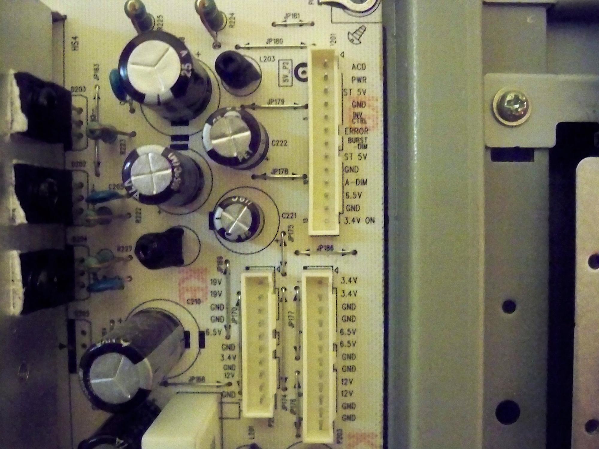

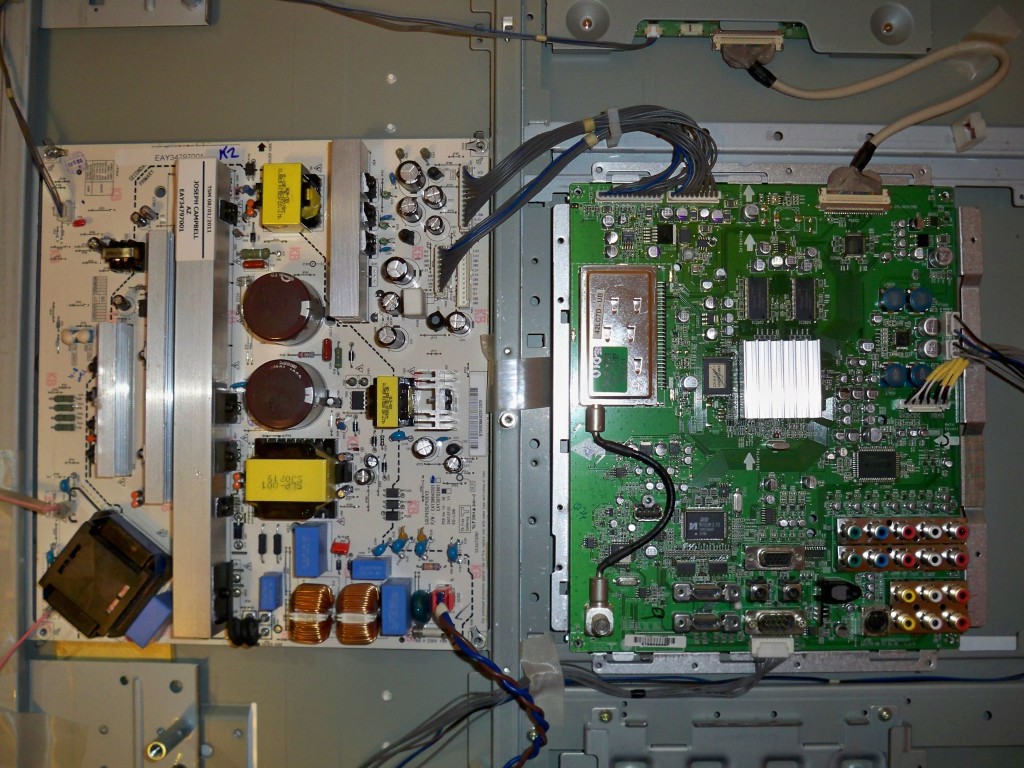

    I got this tv in for repairs and the customer replaced the power supply with one from Tri State Modules. The old P/S board had the usual bad caps in the secondary stage. That didn't fix the problem the tv still shuts off.
    The only thing I can find the first picture, the pin out shows inv control, 5th down from the top is at 3.3v with ps on, the inv comes on when that 3.3 goes low to about 1.8v to 1.6v inv comes on and flashes and the voltage goes to 0v and the process repeates three times and the TV turns itself off to standby. I can turn it right back on with out unplugging or resetting fault.
    While Tv is on the sound is on and the first time backlight flashes I see the channel indicator and snow the next 2 times only snow, then it shuts down.
    IDK

    Re: LG 42LC7D-UB Comes on backlight flashes 3 times and TV shut off
    What happen if you disconnect the cables to the inverter board?
    • high-tech
      • Sep 2010
      • 197
      The inverter is on the P/S board. I think the main board is havin a hard time holding the inv on signal low

          We can help a lot more if you please post good clear pictures of the whole chassis, and then pictures of each board, front and back and close up of connectors, (max resolution 2000x2000 and 2MB) using the manage attachments button, which is found by clicking "go advanced" under quick reply.
                  I found a bad or blown up sm cap on the ccfl board (tb42a-6plh-r) causing the bright bulbs & may be the cause of the inverter / pcb shutting down?
                  trying to find this cap now marked 5kv 15j 77 any help on this cap
                    15pf 5% 5000V, you can use 6300V instead. They are ballast caps to limit current flow though the lamp, it it has leakage due to high voltage break down, the inverter will shut down to protect itself. I would check all of them out and see if more than one has resistance leakage, you can also see it has tinted of bworn on the body when it is bad.

                      The ballast caps are actually used to start the lamps. When the caps fall in capacitance or become leaky, the lamps don't start. The way it starts is quite novel: the inverter pulses the transformer briefly; the transfomer secondary and capacitor form a resonant circuit, which spikes the bulb with about 2~3x nominal voltage, then the inverter operates initiates normal operation once the bulb is struck and the capacitor passes AC. (It will only attempt to strike once and will check after 2 seconds or so have elapsed.) If the capacitance falls, the output spike will drop, if the capacitors become leaky, the spike will be damped (and will also reduce.)
                        When the cap is leaky, the current through the lamp will be higher than normal, the cap is in series with the lamp. The pictures shown on my photobucket, one cap has low resistance reading, it should read open circuit, so the lamp attached to that cap was A LOT brighter than the rest, and then the inverter shutdown. Since the inverter runs at high freqauency, it uses the Xc of the cap to limit the lamp current, that is why it is very small value cap.
