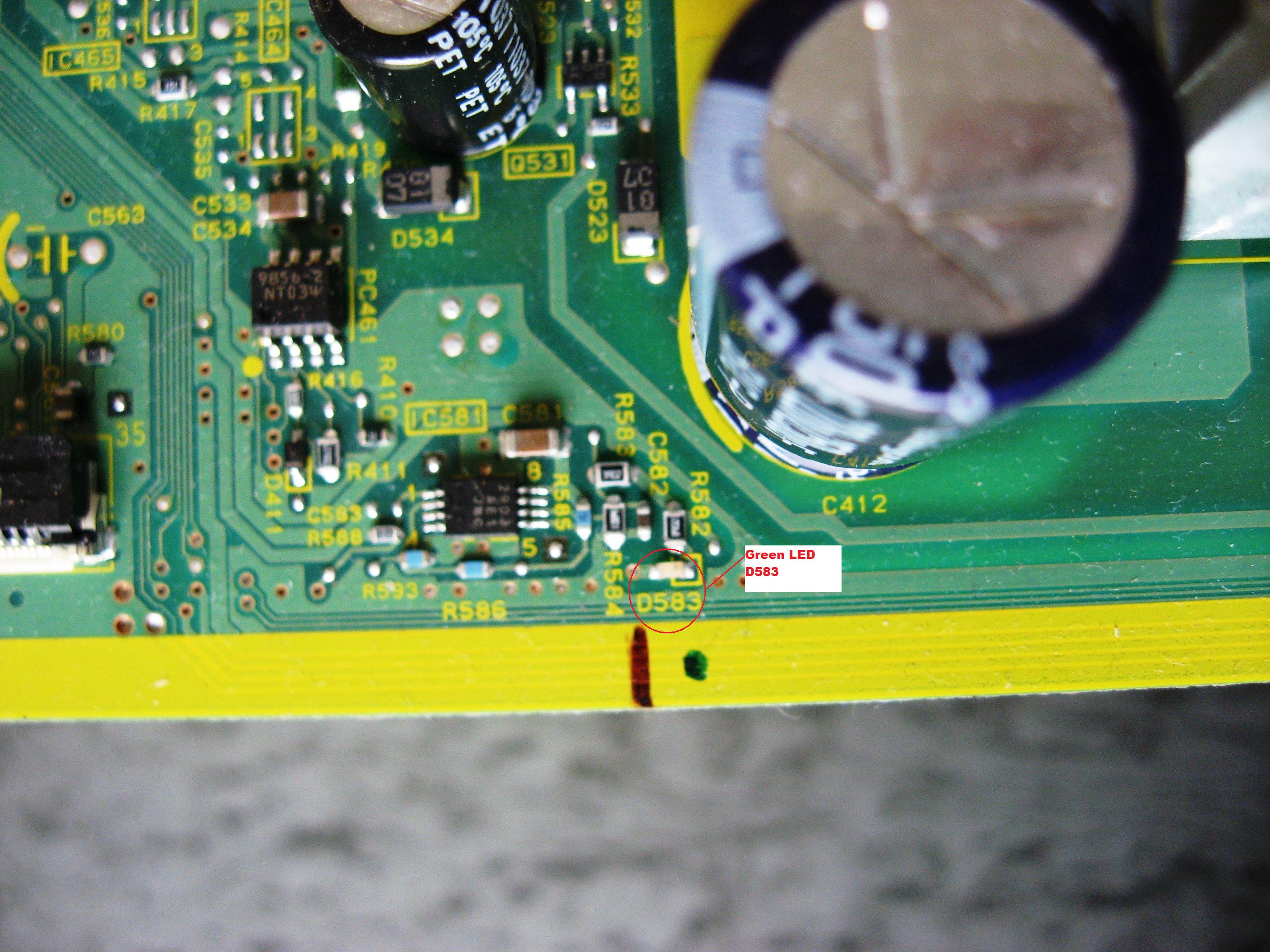

Hi!
I'm new here (and english is not my language at all).
I can repair many things such as an iPhone to my Jeep Wrangler but this time I'll gonna need help. My TC-P50G20 stopped working about a month ago (1 year and 10 months of lifetime). After some time waste speaking with Panasonic and $$ spent on diagnosis and travel I decided to fix it myself.
The TV was working fine till one morning when I decided to turn it on the power LED went blinking 10 times. Sometimes it also blinks 4 times but most of the time is 10.
I have read all comments of this post but I'm not sure wich board is defect on my TV. What can I do to make sure I'll order the right one?
Thank youComment
Re: Panasonic G20 Failure :/
10 blinks is usually shorted SN or SS.
Disconnect the SN board power connector. If you get 6 or 7 blinks, it is the SN board. If you still get 10 blinks, disconnect the SS board power connector. If you get 8 blinks, it is the SS board.

What is the SN board? I don't have this one on the parts list.
When I disconnect the SC power I got 7 blinks.
** I don't have any LED indicator either.Last edited by JosQuelqu1; 12-01-2012, 08:12 PM.Comment
Ah sorry this is a different design and uses an SC board with separate buffers SU and SD. The SN combines them all. On some older Panasonic designs, they used an SM and SC board -- the SM combined the SU/SD and the SC board was the same.
heu... yeah! lol
So you're saying that my SC board is the defect one?Comment
Both SS & SC have onboard LED.
I can say SC TNPA5081 Rev AF,AP & AW have. Board location D583 or schematic D16583.Attached Filesif you find these attachements useful please consider making a small donation to the site
