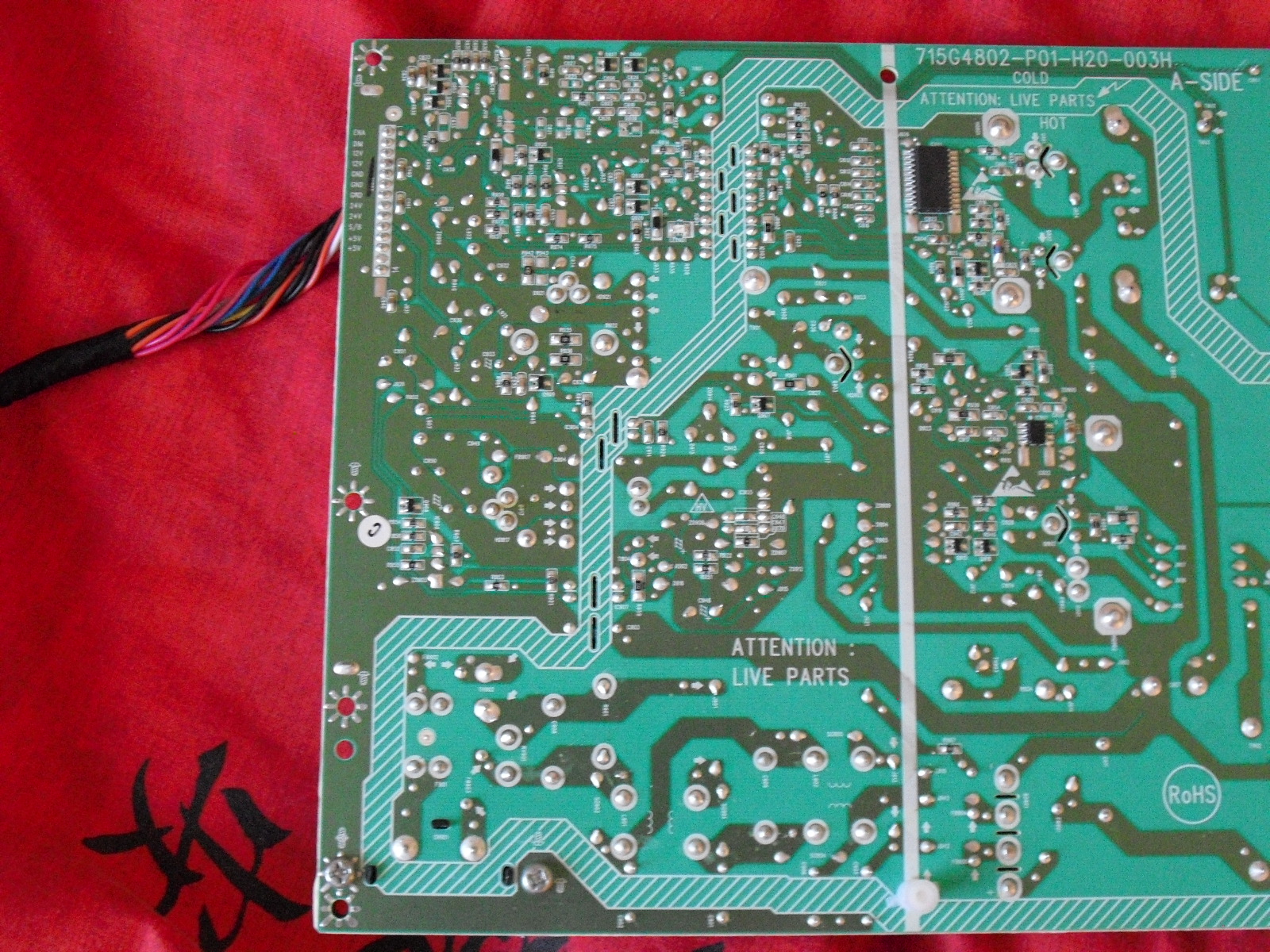

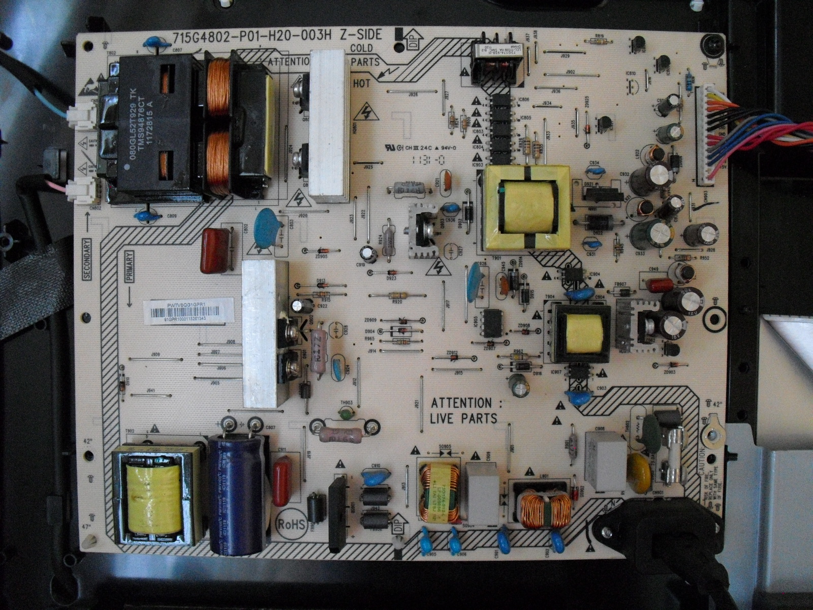

    Hey up people..got a philips 42pfl3606h/12 lcd with a 715G4802-P01-H20-003H Z side PSU..this set displays no sign of life..no led on front..no backlight..no nothing
    On the main pinout im getting the +5v readings & the DIM readings but no others..no 12v/24v or S/B
    The main fuse checks ok..the main cap reads short of 400v...ive not been able to find any schematics or fault findings on the net so any help with diagnosis & testing would be gratefully received..thx

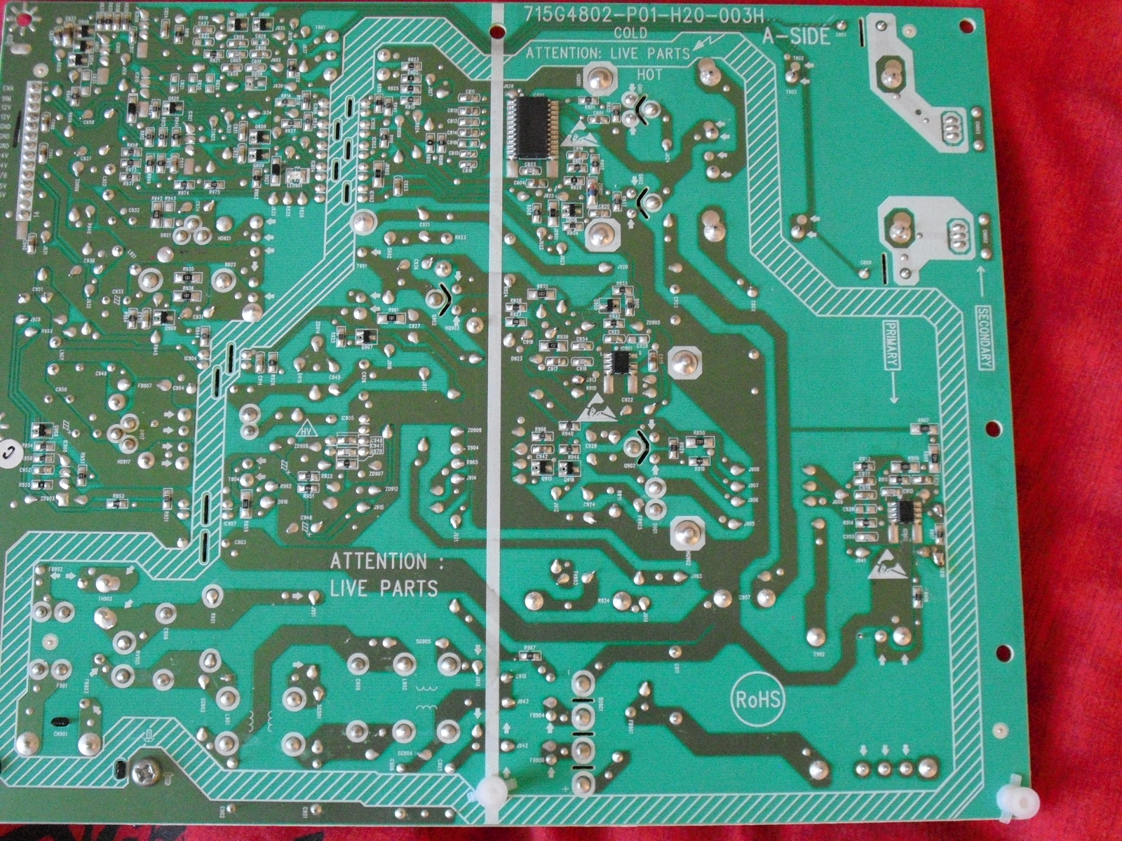

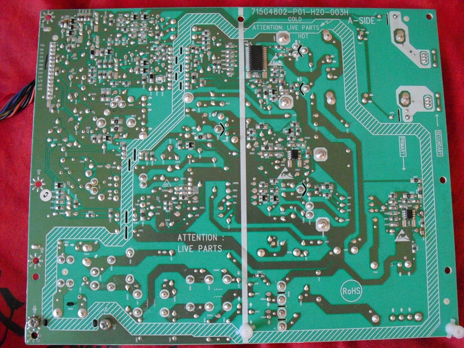

    Some underside pics of PSU..thx
      Re: Philips 42 lcd no power

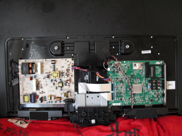

      Hi - can we have a pic of the main board - Is this a LED backlight?
      Backs of PS board are not really clear enough for troubleshooting cant read all the numbers. Were voltages taken with boards screwed in - there have been a few stories recently where boards were not grounded correctly. Also were they all connected up and with a source - video playing - was there any Audio.
      Try unpluging the lead from the main board to the panel (or tcon) and see if that lets the voltages come up.

            Got the jewellers eye out & found a few dry joints so applied fresh solder..the main fuse in the holder was sparking when moving end of power plug so re-soldered them points & all is good...thx for input guys

                    Ive replaced the small value caps & still no joy..i spent half hr plugging on & off & resoldering half of the psu..then eventually back to life again..should i replace the 1000uf caps?..ive no esr meter to measure their value & they not bulged..thx
