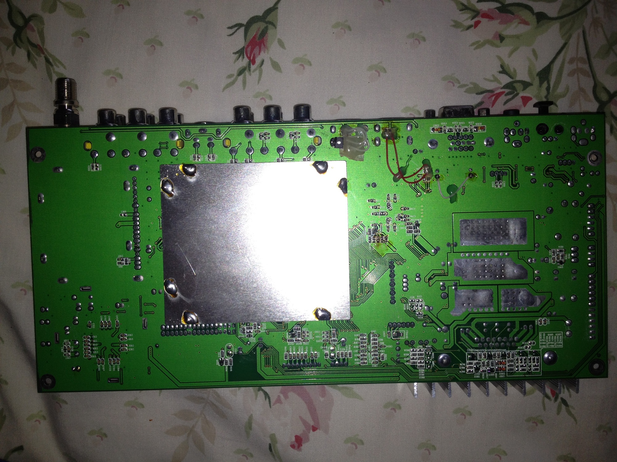

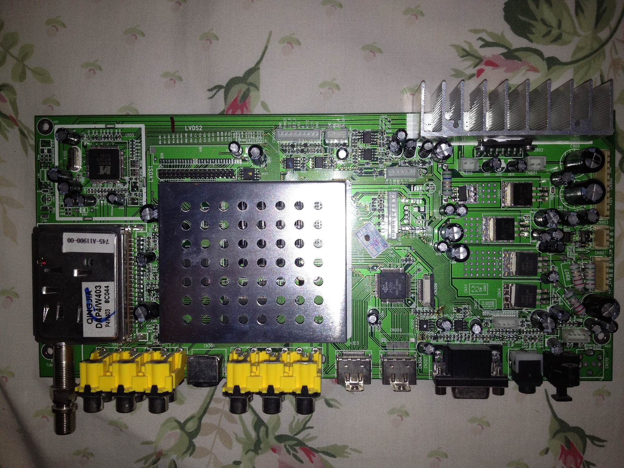

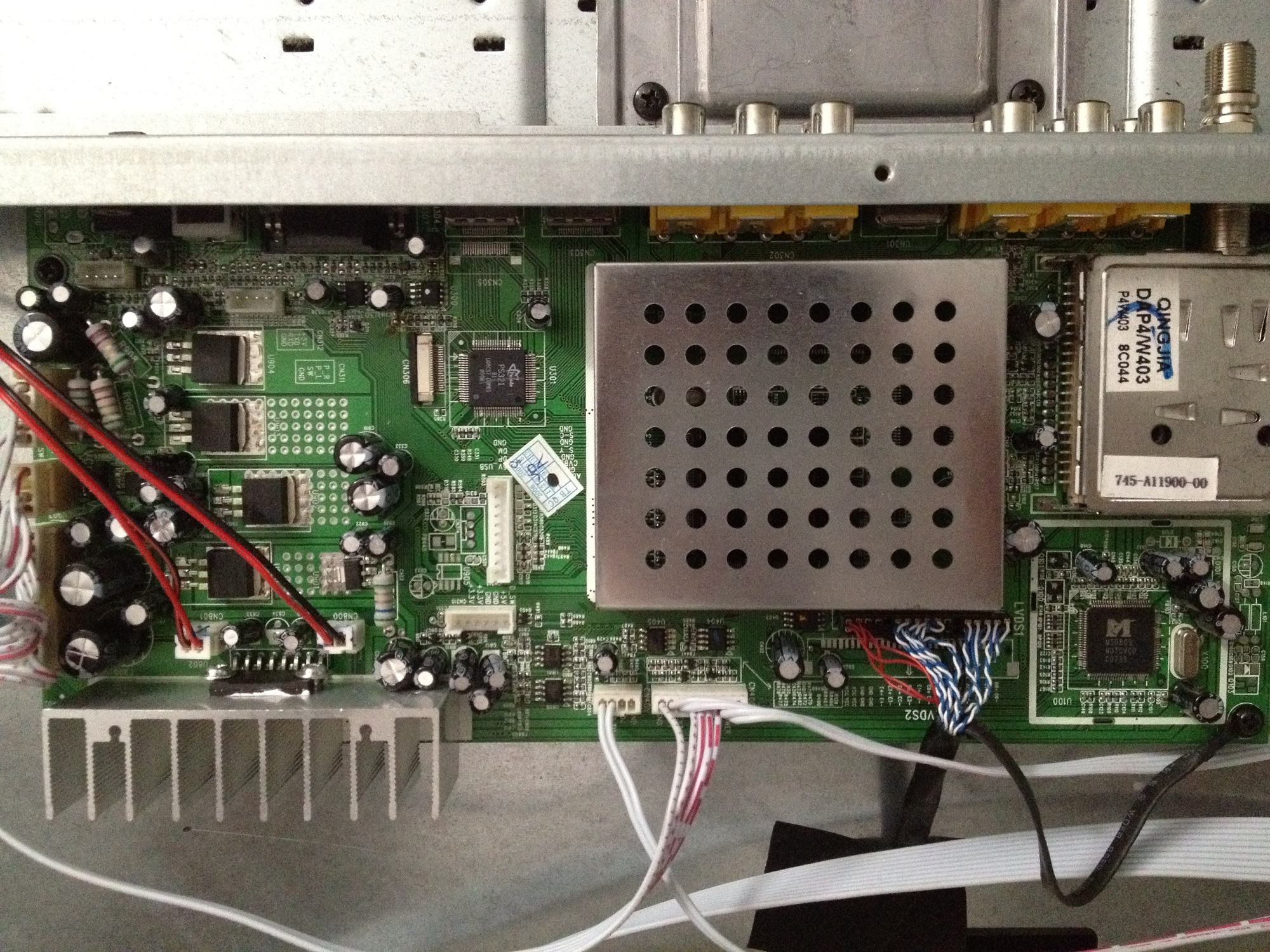

    Alright guys so i recently bought this used LCD tv and used it for only about a day. This happened just now, The TV had been on for several hours and I heard a popping sound from the TV and the picture flinched for a second and went back to normal. About 5 seconds later the TV turned off completely and I immediately unplugged the power cable to prevent any futher damage.
    I removed the back panel expecting that maybe it had been just a bad cap on the power board that blew but I do not see any obvious blown caps. So just wondering what else could make that popping sound?

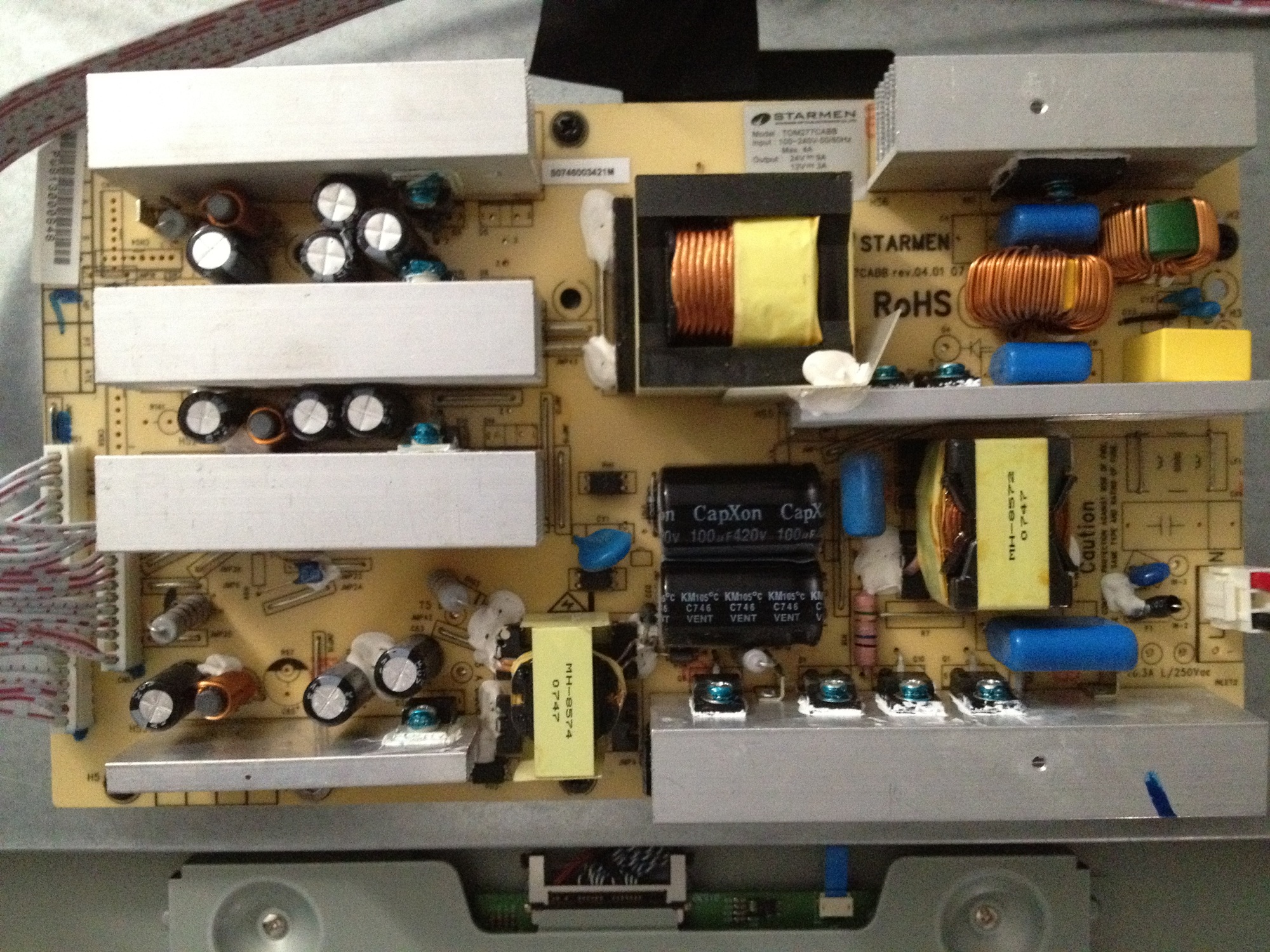

    Re: Arion AD-LC 42"F popping noise then powered off
    Fuse? what is the board model number pictures are too grainy for trouble shooting and need to see the backs- please can you update your profile with country and mains voltage.
    • tieny
      • Feb 2012
      • 478
      I checked one of the fuses, was only able to find one, but it had a reading of 10.4 ohms. Not sure about the fuse type I usually expect an open fuse. I'll upload newer pictures in a bit.

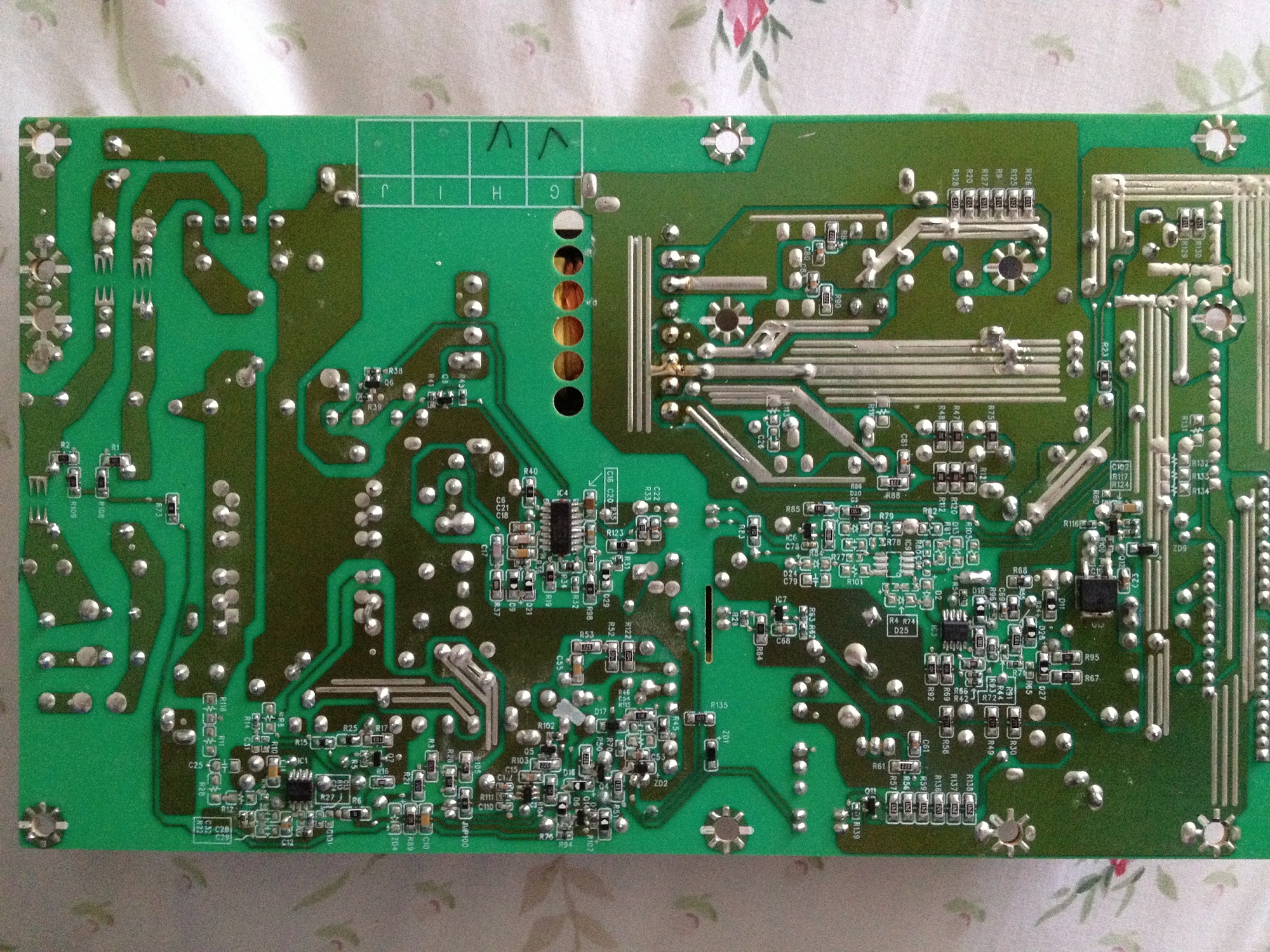

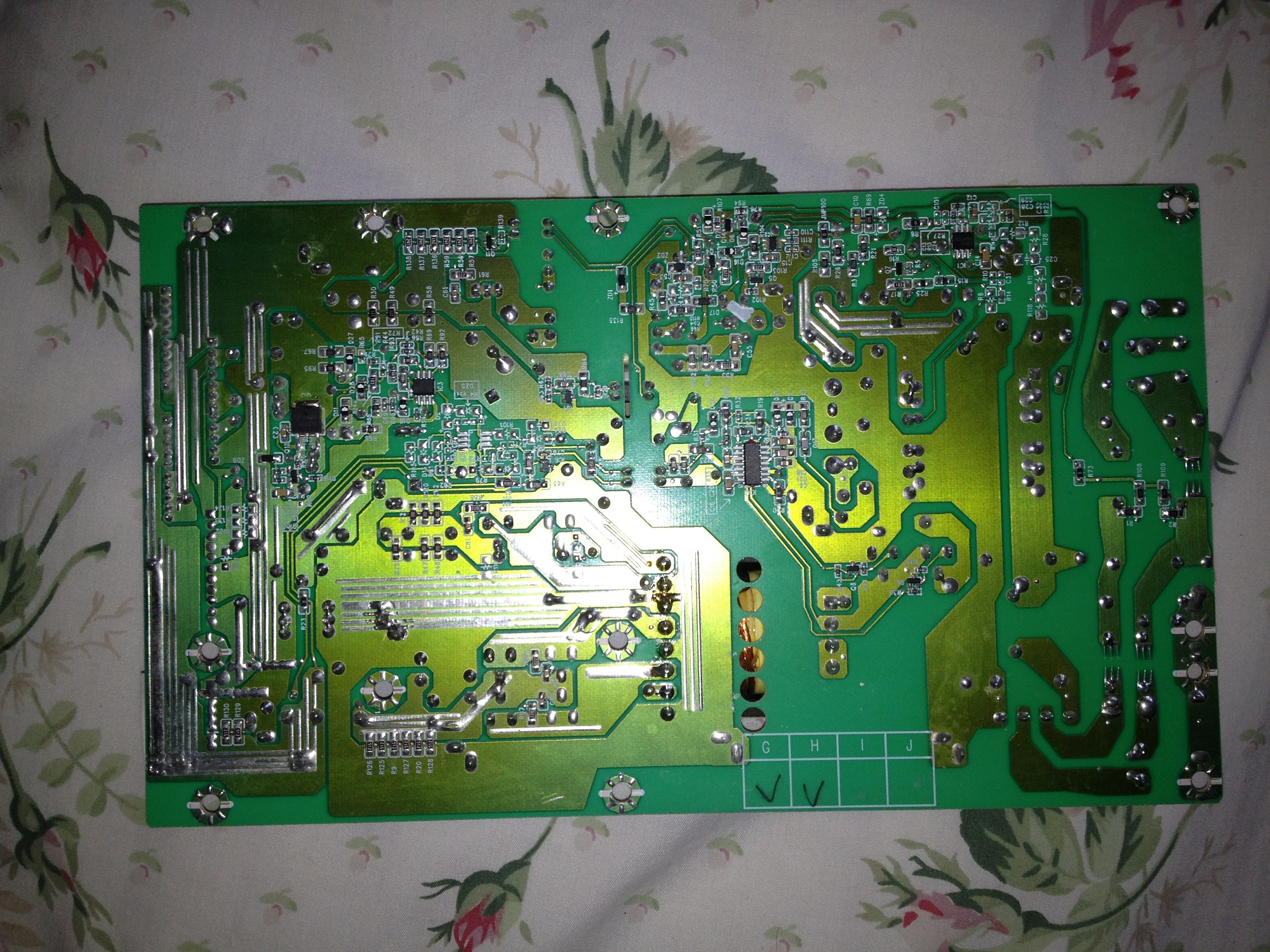

        Heres the back of the power supply board
        • tieny
          • Feb 2012
          • 478
          better pictures
            I can only see one fuse on the ps - is it the black sheathed one you have checked?
            Next check the voltage on the big caps HIGH voltage so care and observe polarity
            Red lead on positive leg Black lead on Negative leg - meter on 600VDC.
            Do not touch heat sinks.
            Also found this which might help http://www.ccl-la.com/blog/index.php...-tv/#more-2121
            • tieny
              • Feb 2012
              • 478
              Yes that was the fuse that I checked with 10 ohms. Both capcitors read 163 Volts in standby. Well this is weird, I just turned on the TV now and it seems to be working fine? Not sure how long it would last though I'm guessing the problem would eventually pop up again. Any ideas about this? Hoping I could fix it before it completely dies.
              I might try replacing the caps as shown from the link you gave me. Maybe it might fix it?
