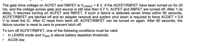

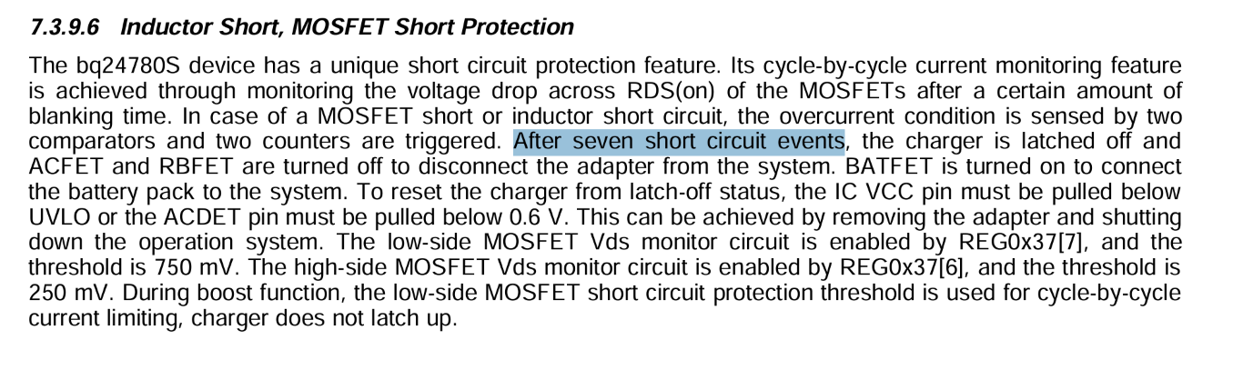

    Carefully measure the voltage to ground on each of the pins on the DCin mosfets:
    source (1-2-3)
    gate (4)
    drain (5-6-7-8)
    Most likely gate voltage is not ~25V which is required to power on (enable) the N-Channel mosfets used by the BQ charger ICs. Driven by the ACDRV pin on the charger IC.
