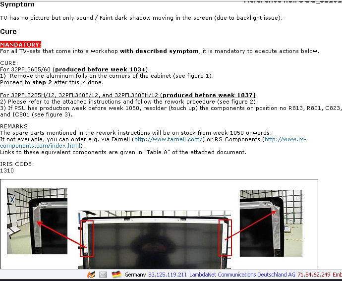

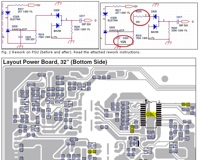

                              • RON_CET
                                • Jun 2012
                                • 217
                                Re: Philips LCD 32PFL6305 inverter sometimes hard to start
                                maybe this might help with your issues see attached
                                Ron Driver,BSEE,CET,ISCET,NESDA
                                • PowerAmpFreak
                                  • 982
                                  • Sweden
                                  Great Ron! This is exactly the kind of bulletin I was looking for. I will rework the psu according to instructions. Will let you know the result! Again Thanks!
