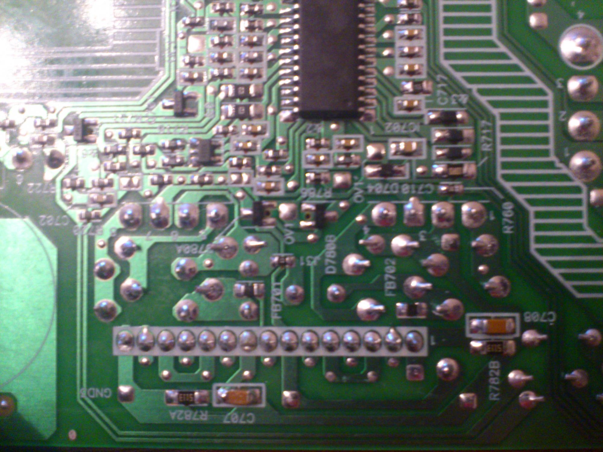

                                  #56
                                  Re: Philips 32PFL6606T 32" LED no back light
                                  the back,

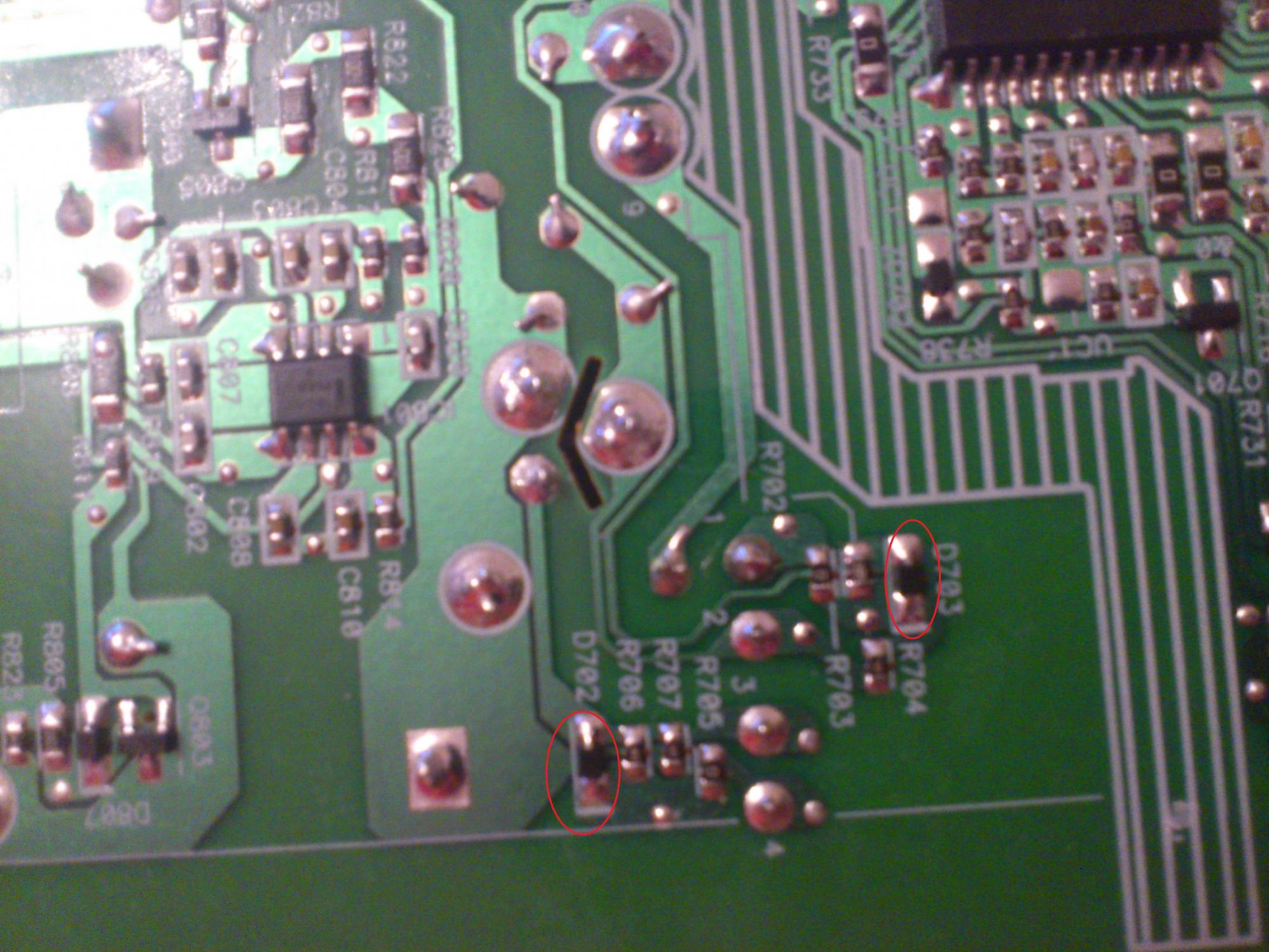

                                    just checked these 2 diodes and they are reading both ways at 0.08v and 1.1v but with them being surface mount im not too sure if i can change them,
                                    the markings on them looks like A6 (D702 and D703) thats if they are diodes,
                                    looks like they control a transistor that powers the primary coil for the LEDs along side another transistor further up the board, if 1 is working and the other isnt could this explain the fault? that the coil is only getting half the voltage to power the LEDs?
                                    • shepp
                                      • Mar 2012
                                      • 377
                                      • England
                                      #58
                                      also tested both transistors and they tested the same (good)
                                      help please
