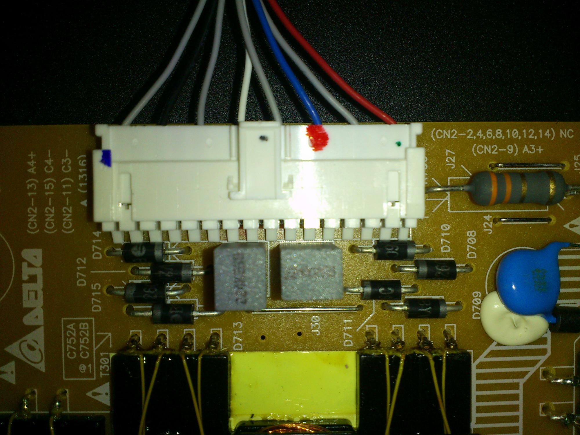

    hi folks, i havent picked this up yet so not sure wether its gonna be an easy fix or not, but the tv switchs on and sound and picture are ok but there is no back light
    anyone know what i should check? as in component wise that could cause this, apart from the obvious i.e. fuses on panels and caps on power board
  • shepp
    • Mar 2012
    • 377
    • England
    Re: Philips 32PFL6606T 32" LED no back light
    hi guys ive just got this to pieces and im not sure what to check? can anyone help me? the tv works but there is no led back light
      output voltages against there legends first.are they what they supposed to be?

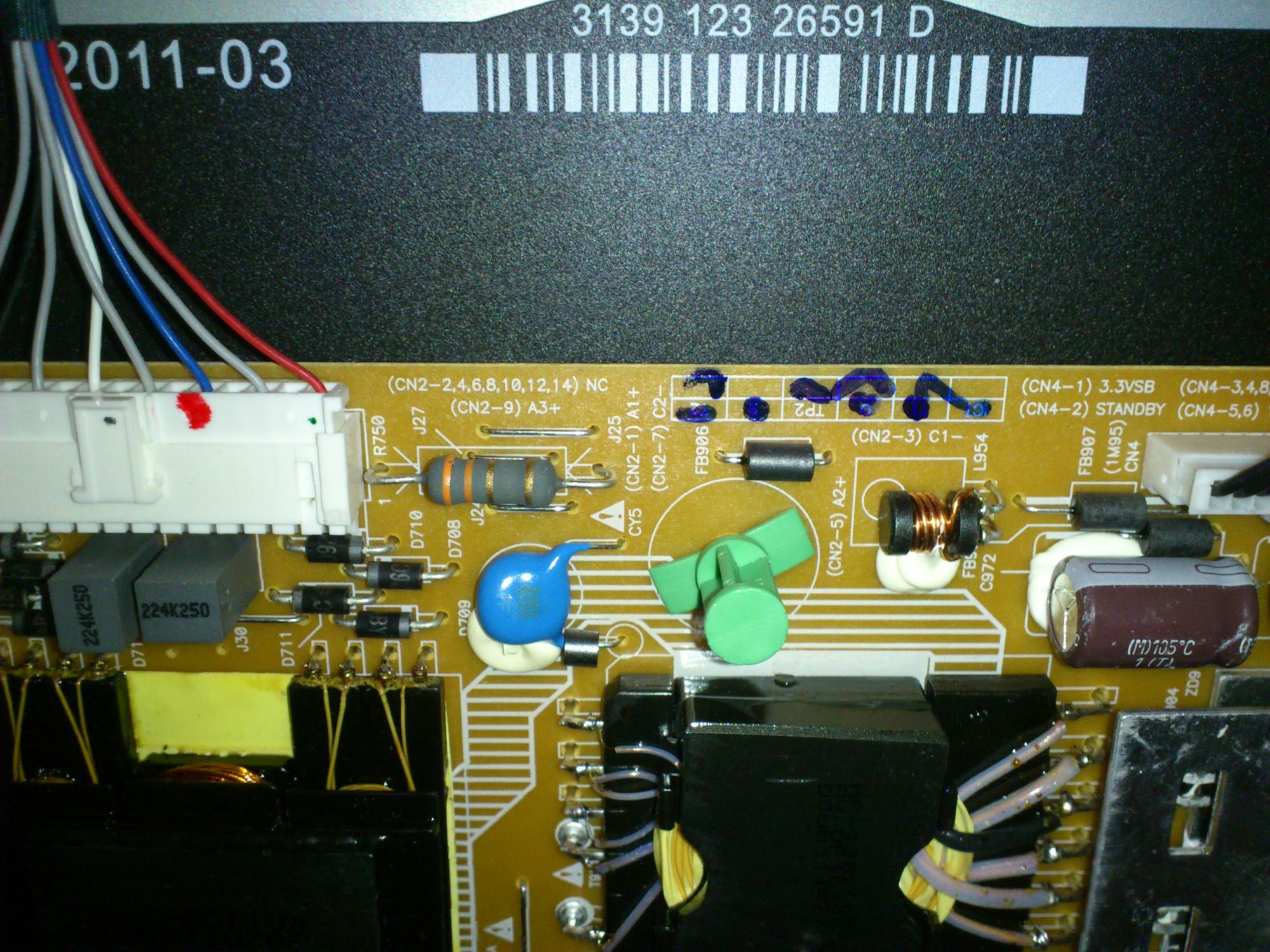

                this is the connector no voltages
                its really hard to see anything on the tv but ill try the service menu see if i can factory reset
                if the back light is lighting a little on the philips screen is this a good sign?
                    on your picture of the power supply ,the connector on the right hand side has voltages on it,i can just see them,what do they say?is it just a flash on the screen for a couple of seconds or does it last longer?

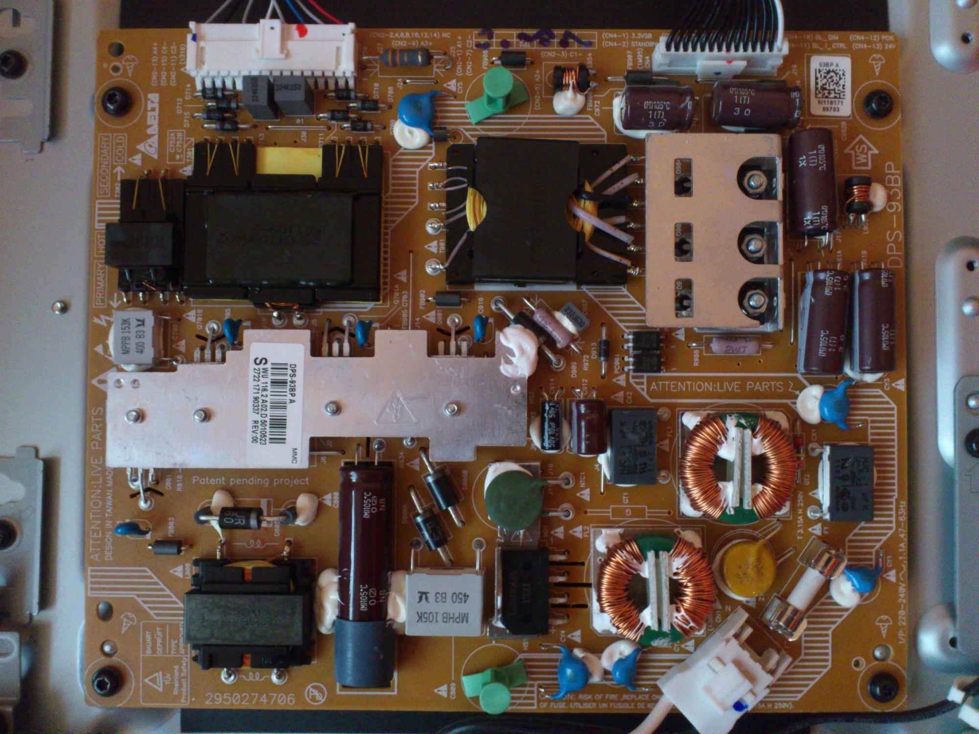

                        just uploading some more pics now
                          think ive uploaded same one twice, only voltages are on the other connector

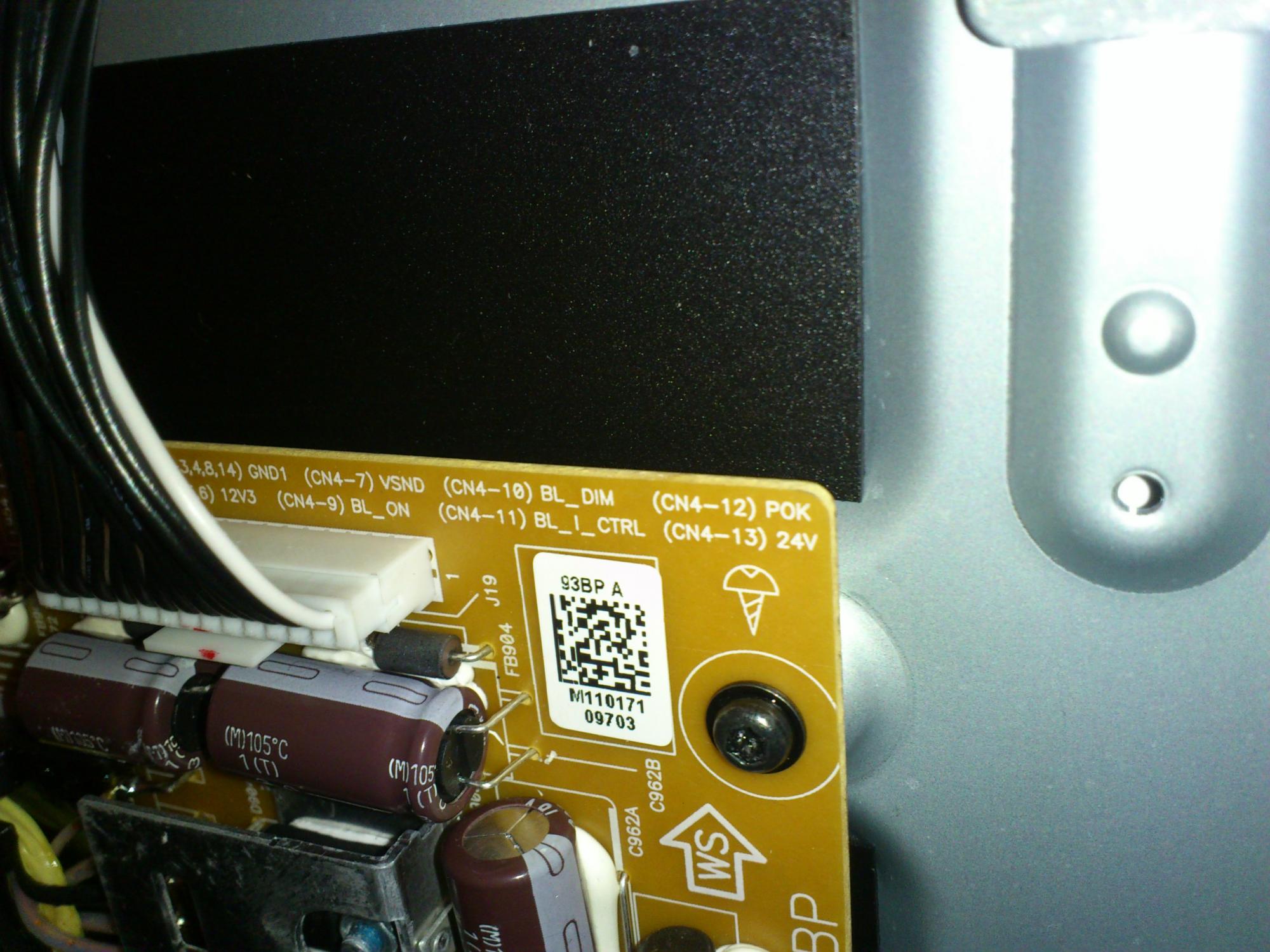

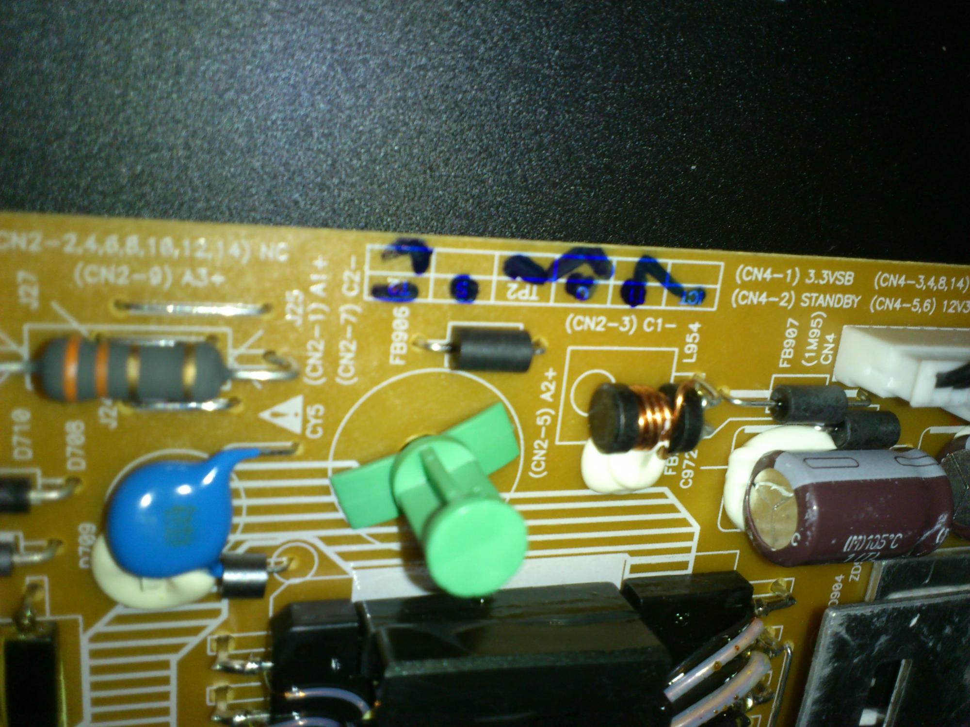

                            ok,the cn 4 is your main outputs to everywhere else ,the white lead is pin 1,the rest go from 1 to 14,measure those voltages ,write them down,using your black lead on a ground screw and red to each pin,(dmm switched to dc 200v or just above 20v if your dmm can do) ,with power lead plugged in but tv not switched on ,they should read zero,apart from a 3.3v or 5v standby,if all is good power the tv up fully then recheck, all voltages should be there
                              im interested to see if voltage is on the bl-on pin
                                1. 3.3
                                2. 3.2
                                10. -18v
                                11. -12v
                                12. -10v
                                rest are 0v
                                  how can i check when i power up? with the connector in?
                                      push your probe (red) in the top of the connector it will contact the terminal
                                        and post your reply like this..
                                        bl-on = 12v
                                        stb or standby = 5v
                                        write all the pin numbers down,with what they represent with there voltages next to it
                                        1,bl-on = 12v
                                        2,stb or standby =5v etc etc
                                        get the idea?
