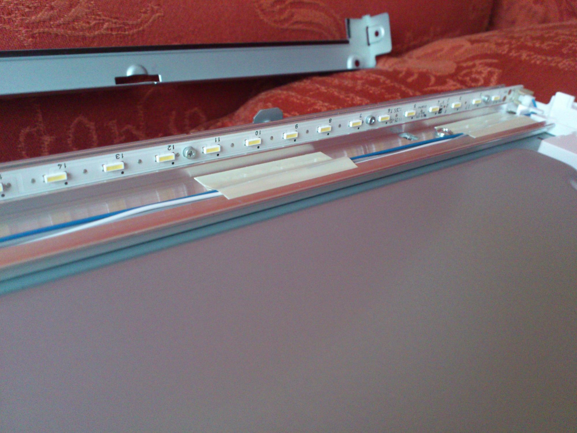

    Right then folks.......FIXED!!!! WHOOOO HOOOO!
    took the complete screen out and the glare sheets,
    1. set my meter to diode check and went through all LEDs at there test points = all were fine
    2. went from the connector that plugs into the board to the first and last LED and check them set at a time (A1 to Led 1 test point and C1- to LED 14(something like that))

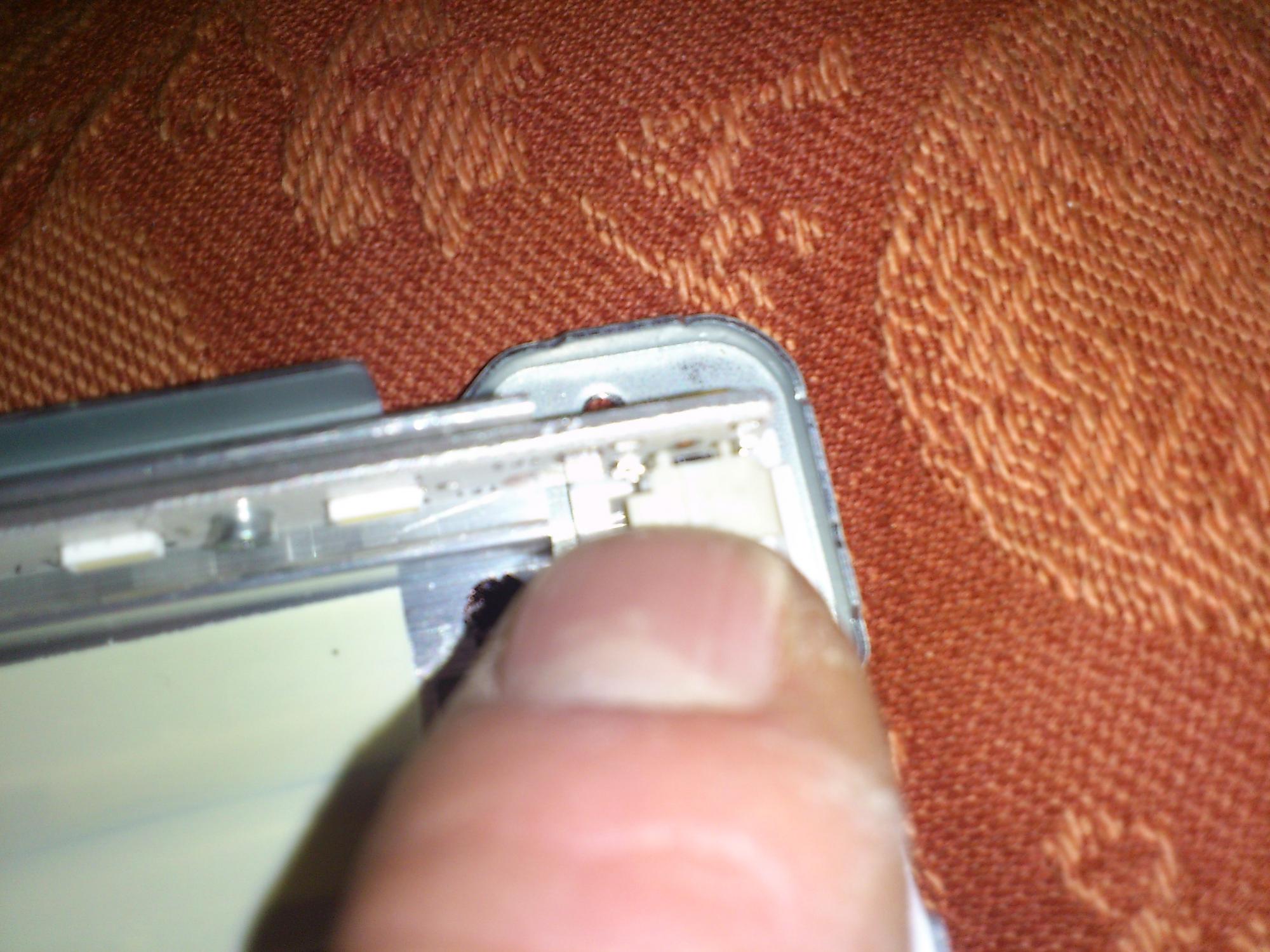

    3. found that the connector block on 2 of the LED boards had come away from the board
    4. re-soldered
    5. tested again on diode setting to check the first and last LEDs were working to the connector.....BINGO
    6. re-assembled and tested.....didnt work.......forgot to put the t-con ribbons back in for the screen
    7. put ribbon cables back in.....powered up and there she was in all her glory!!
    this looks like it could be a common fault because the connector blocks on the LED boards dont seem that great, the tv i would say is brand new, so i guess when its been delivered it must have took a small knock and bust it off its soldered joint
