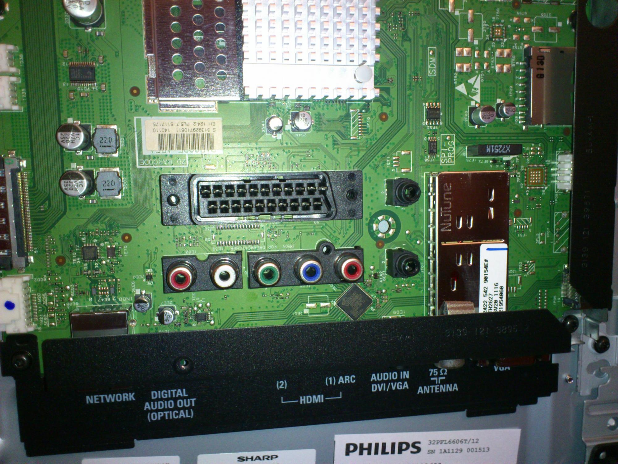

    managed it, i pulled the board forward and did it
    1. 3.3
    2. 94mV
    3. 22mV
    4. 24mV
    and more or less nothing on the others

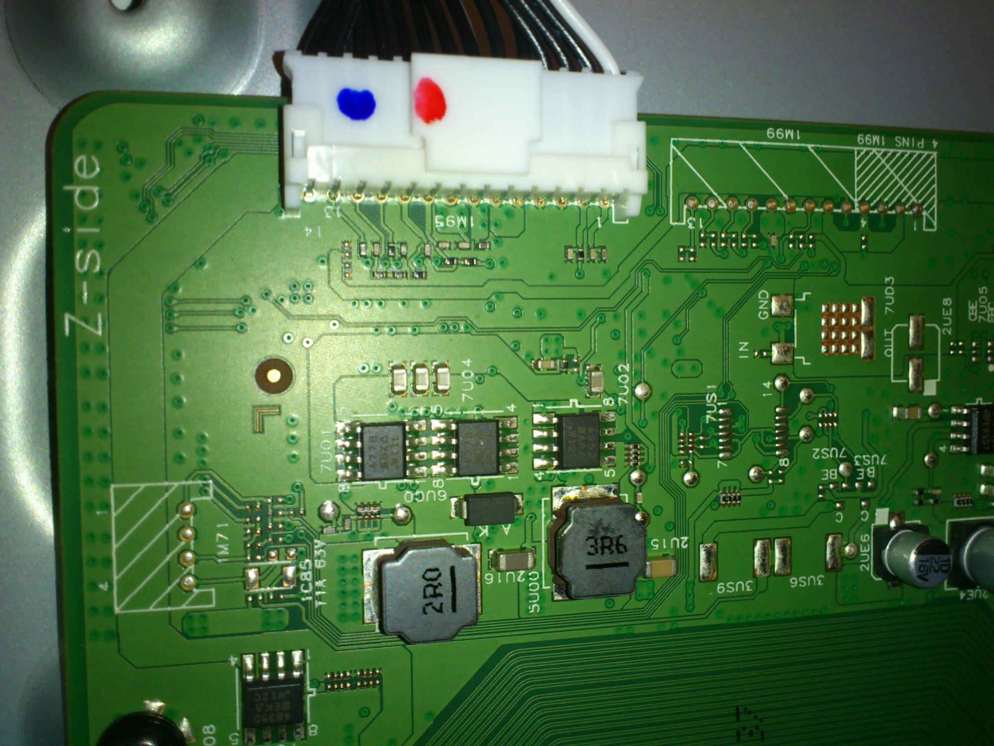

      Re: Philips 32PFL6606T 32" LED no back light
      sorry
      1. 3.3 vsb = 3.3
      2. stanby = 94mV
      3.4.8.14 GND 1
      5.6. 12V3 = 12v
      7.VSND = 24v
      9. BL_on = 3.1
      10. BL_Dim = 0
      11. BL_CTRL = 0
      12. POK = 0
      13. 24V = 24v
        Originally posted by shepp
        sorry
        1. 3.3 vsb = 3.3
        2. stanby = 94mV
        3.4.8.14 GND 1
        5.6. 12V3 = 12v
        7.VSND = 24v
        9. BL_on = 3.1
        10. BL_Dim = 0
        11. BL_CTRL = 0
        12. POK = 0
        13. 24V = 24v
        and that is with power on?
          yes
          should there be bl_ctrl voltage?
          • multimeter
            • Jan 2011
            • 739
            • united kingdom
            the bl_on signal i think should jump to the bl_ctrl pin,to activate the back lights,that control should come from the main board,have you a picture of the main board ,one of the connectors ,and an overall pic

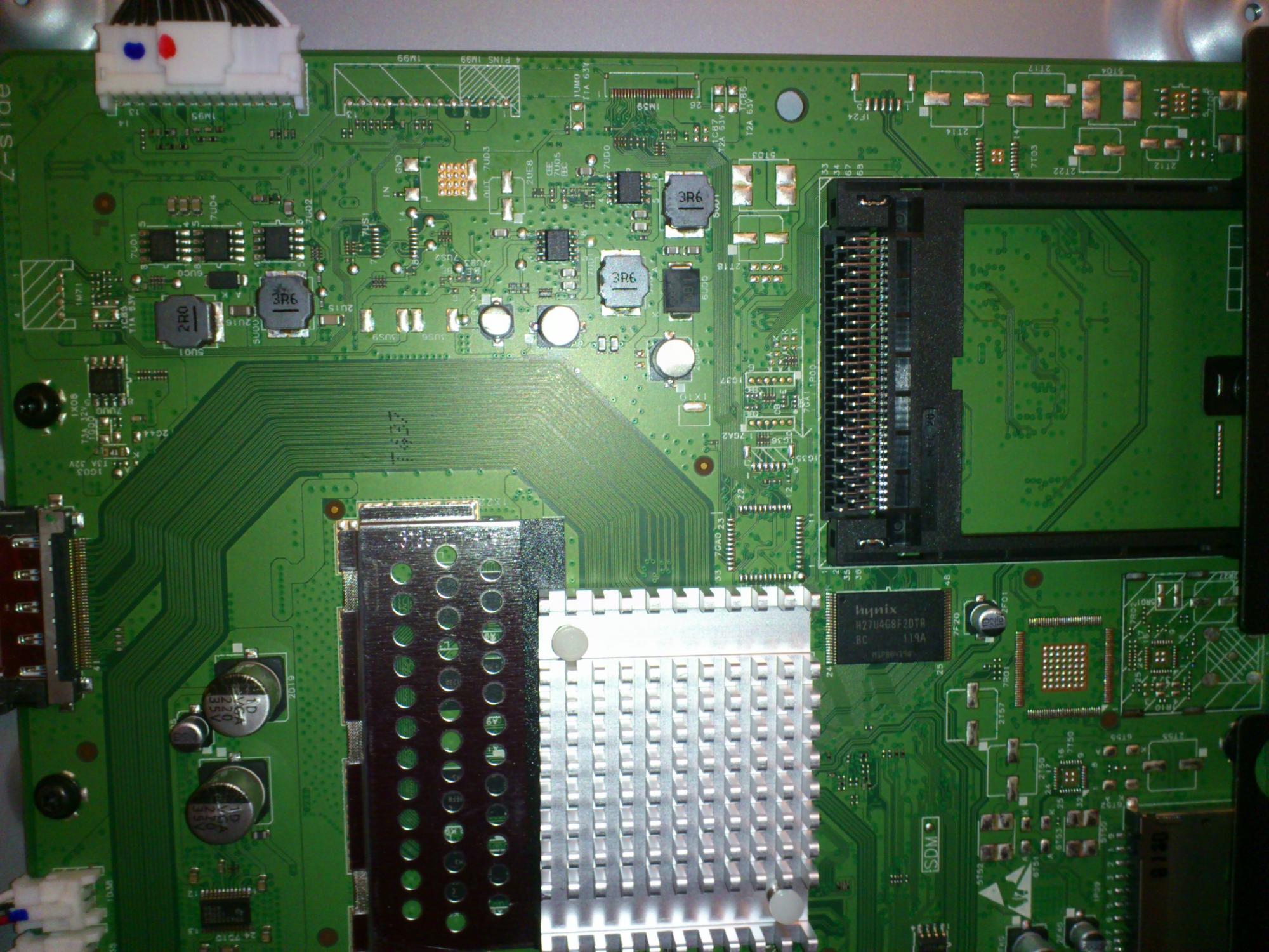

              do the 2 caps look dodgy to you? if thats what they are the 2 silver ones numbers : 1D VGA 220 35V they look a little dodgy to me but i dont know what they do or if they go like that with use on the last picture
                  those caps look fine

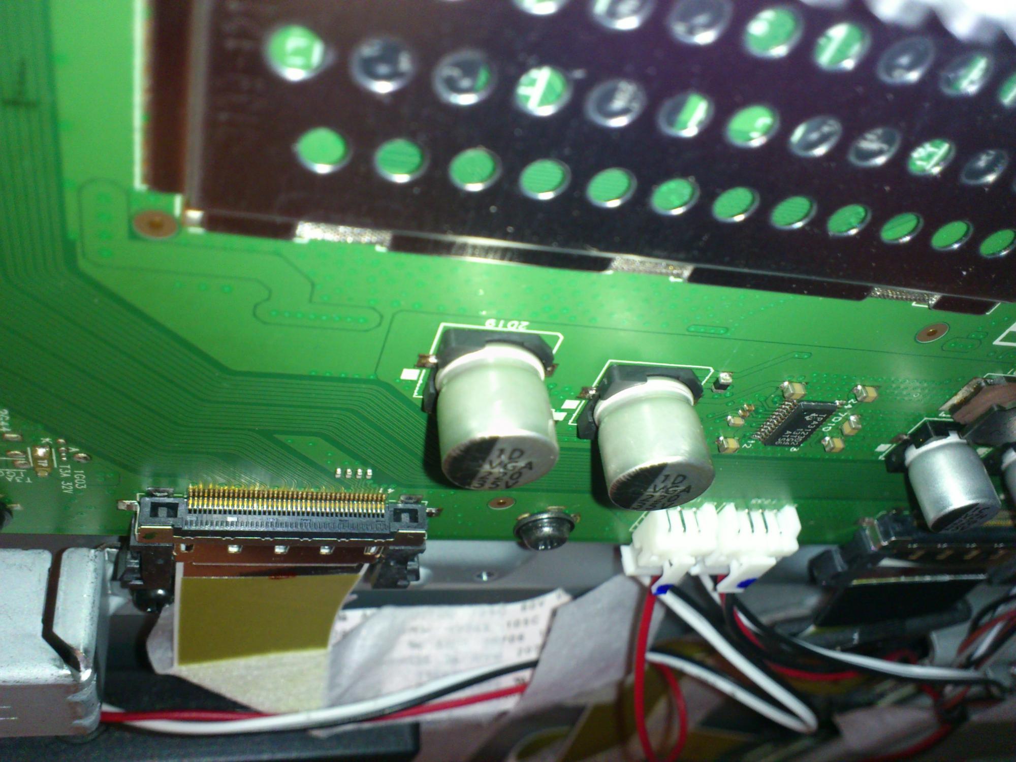

                              #34
                              done that already, first thing i did, then had a look around for fuses but the ones i found were ok they are marked FB and then the number but not sure if they are fuses but they measured 0ohms, they look similar to diodes but with no markings on and all black, theres about 6 in total scattered around the board, if you look on the pictures of the power board you can see them under the main board connector (3 of them)
                              post #13 picture 4 you can see one there FB904

                                #35
                                Those are ferrite beads.
                                Check all the diodes near the connector, see if any are short.

                                  #36
                                  they are all 0.4 v and OL so all good, and just rechecked all the other diodes and they are all ok
