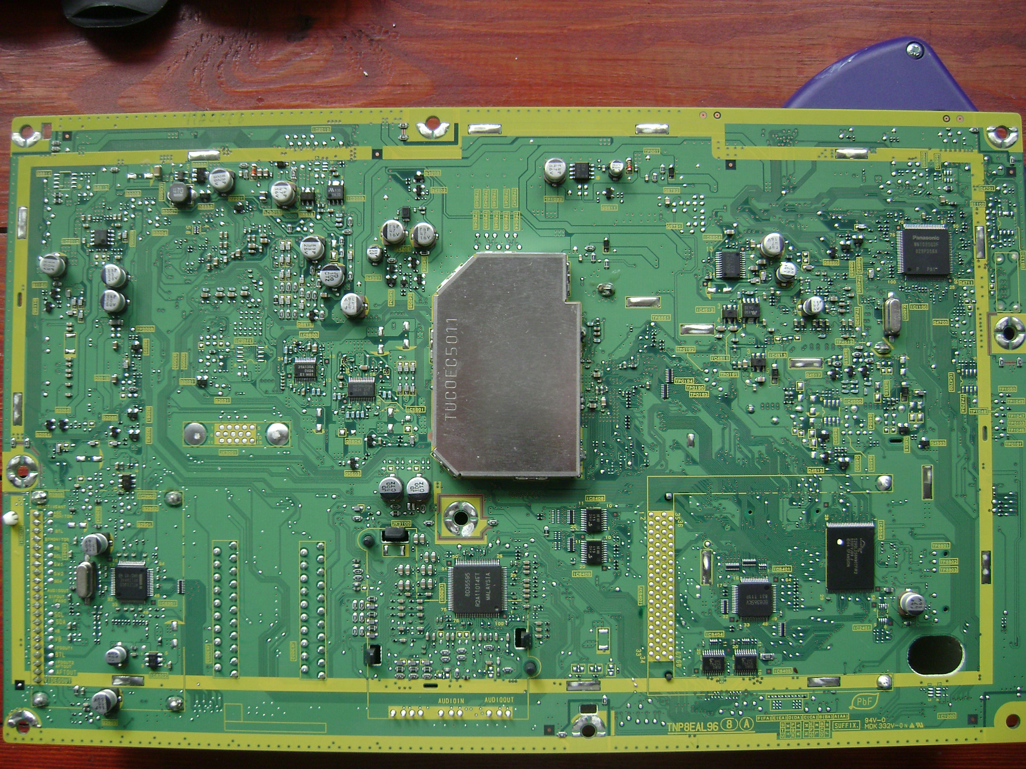

    Model - Panasonic TX-26LXD8.
    Mainboard - TNP8EAL96.
    Link to service manual - http://elektrotanya.com/panasonic_tx.../download.html
    Fault - When turned on Standby light lights up then goes off immediately. PSU clicking.
    Testing - The PSU has been tested and it is outputting the correct voltages to the mainboard and inverter as shown in the service manual. I also have another PSU that belonged to the previous owner that I have tried and the symptoms are the same.

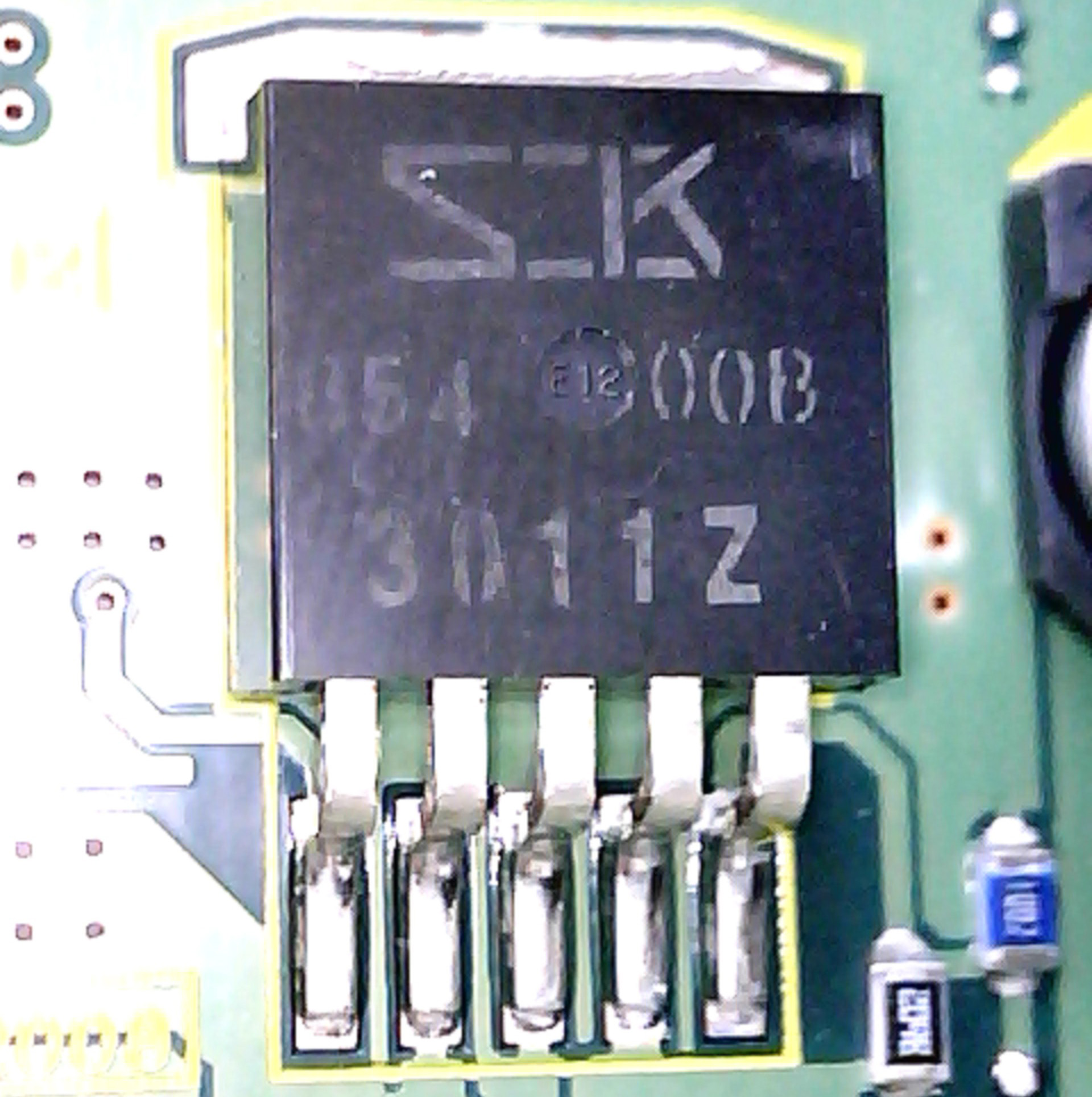

    On the mainboard I found that the voltage at SUB5V on connector A1 - pin 8 is unstable (page 19 service manual). Having bought this T.V to better my understanding of block diagrams, schematics etc. I started to investigate, here's what I have found so far.
    I traced back from A1 - pin 8. Which led me to IC8404 and IC8405. According to the SCH I should be reading 5v at pin 20 on both of these. I have no reading at both. Same goes for IC8401, no 5v reading at pin 33.
    Realising I might be going about this back to front I decided to trace back from connector A7 (PSU connector) pins 1 and 2. Which led me to IC5602, after checking I found that Vo on IC5602 is unstable (previous convo with budm I said no reading, I have found with all connectors connected it's unstable). Here is where the thread in the link at the top comes in.
    Now.
    @ budm.
    IC5602.
    Pin 1. Vc - Unstable
    Pin 2. Vin - 5v
    Pin 4. Vo - Unstable
    Vo ohm to ground - no short (no beep, does read 2K ohm on resistance setting on meter? interested as to why this is if you can be bothered explaining)
    So it looks like IC5602 is o.k like you mentioned, as it isn't getting a stable 2v at VC pin 1.
    I have begun tracing back from here, I will update my findings, lol. I am determined to find the fault with this board. It is slowly peeling back the curtains to my being able to use SCH and I admit it, I am thoroughly enjoying it!
    Relevant pictures below.

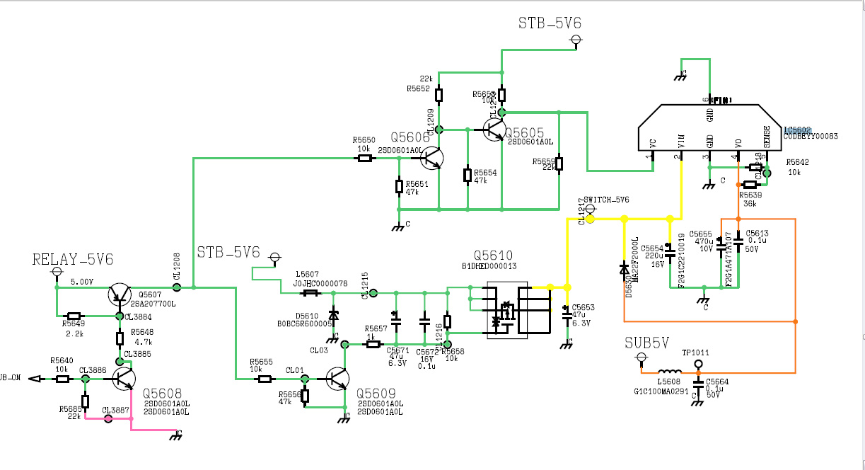

      Re: Panasonic TX-26LXD8 stuck in standby.
      Is the VIN stable? If it is, you can force the IC5602 to turn on by forcing Q5605 to turn OFF by short out R5654, this will cause the Collector voltage of Q5605 to go high toward 5V.
      The IC5602 is trun on when the following happens:
      Q5608 is turn on when 3~5 is applied to the resistor R5640 (left leg, I cannot read the lable on the SCH), which will turn on Q5607 whick will allow 5V on the Emitter of Q5607 to appear at the Collector or Q5607, this voltage will then turn on Q5606, hwich will turn off Q5605, so the Collector of Q5605 to go high and turn on IC5602 5V REGULATOR.
      at the same time the 5v from the Collector of Q5607 is also fed into Q5609 which will turn it on causes the Collector of Q5609 to go LO which in turn will tun on the P channel MOSFET Q5610 which will allow STB_5V6 to appear at the VIN of the IC5602.
      So for you to get 5vdc at the output of IC5602,the above actions have to happen.

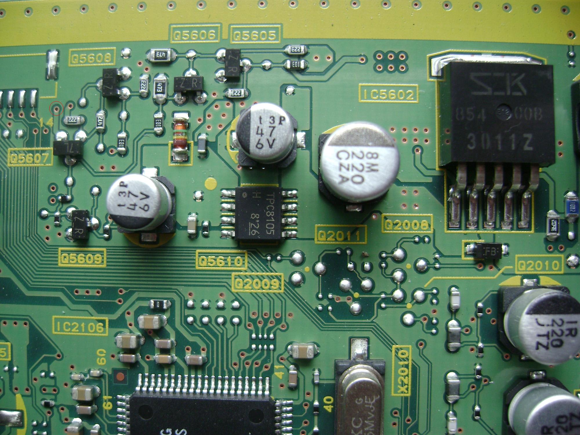

              @budm

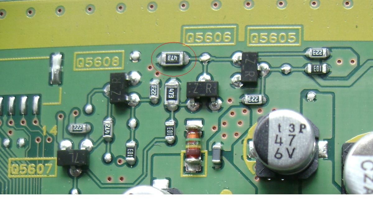

              Just to double check, is the resistor circled in the attached picture the correct one I want to short.
                That is, great clear picture!
                  @budm
                  Shorted R5654, no change, still clicking going Hi-Lo.
                  Took voltage readings at the left and right pins of R5654.
                  Left pin - 0v
                  Right pin - 0.5 - 0.65 Hi-Lo.
                  Took some other V readings not sure how helpful they will be.
                  Q5608 -
                  0v - 5.55v Hi-Lo @ collector.
                  C5671 -
                  5.55v @ Top pin/Pos
                  0v @ Bot pin/Neg
                  Q5610 -
                  Pin 1/Source - 5v stable
                  Pin 4/Gate - Hi-Lo.
                  Pin 5/Drain - Hi-Lo.
                  Pin 8/Drain - Hi-Lo.
                    If that resistor is shorted out (both ends of the resistor are tied to ground when we short out this resistor) then there cannot be any voltage on it.
                    If Q5608 Collector is going Hi and LO then the Base must be driven HI-LO also, this Collector voltage sholud be 0.6vdc or less when Q5608 is on.
                    And If Q5608 Collector voltage is going up and down, then Colloector voltage of Q5607 must be going up and down also.
                    Are these voltages steady at the following points: RELAY_5V6, STB_5V6
                    You should use the ground points (such as the Emitter of Q5608, Q5609, or Q5605) as shown in the diagram as the ground ref for troubleshooting this section of the circuits.
                    It must be the way you are attaching the meter probes to the circuits.
                        To make it easy, see PDF.
                        These voltage MUST be steady: RELAY_5V6, STB_5V6
